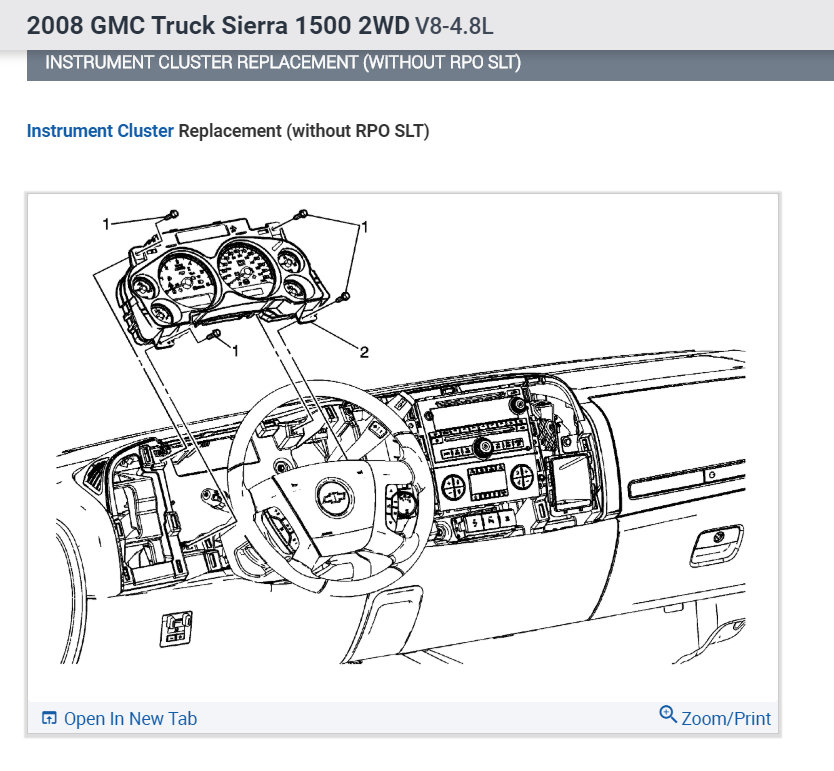

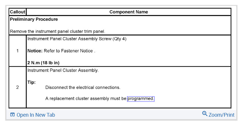

This is common when the cluster goes out. here is a video of the job being done on a similar car and instructions in the diagrams below to show you how on your car:
https://youtu.be/_HEC44xENxw
Be sure to give the re-builder your mileage so they can program the unit. Check out the diagrams (below). Please let us know what happens.
