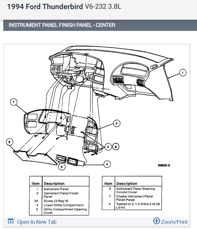

I need to remove this in order to get the clock that has been broken off of the bezel. I have researched how to do it with no results. Any information will be greatly appreciated. Thank you in advance.
Jul 17, 2024 at 10:23 AM

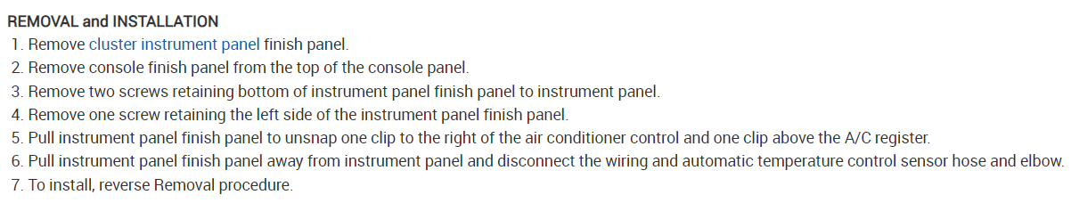

Here is how to remove the dash finish panel, if this doesn't help, please upload images of the clock and its location so I can find which images you need. Check out the images (below). Let us know how it goes.
Jul 17, 2024 at 11:30 AM
SUZY ALLEN
  • 5 POSTS
Thank you for your help. Now my question is looking at the diagram is my understanding that I will have to remove the whole instrument panel in order to get to the dash radio finishing bezel. That's the only way to get to where I want to get to. If so, then I will have to take it somewhere and have it done too much for me. Thank you.
