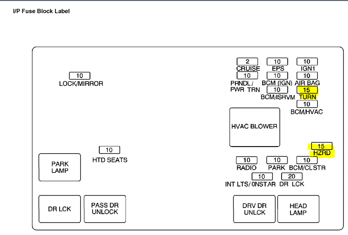

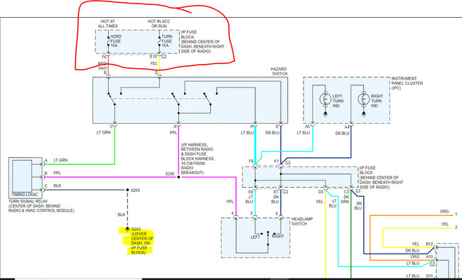

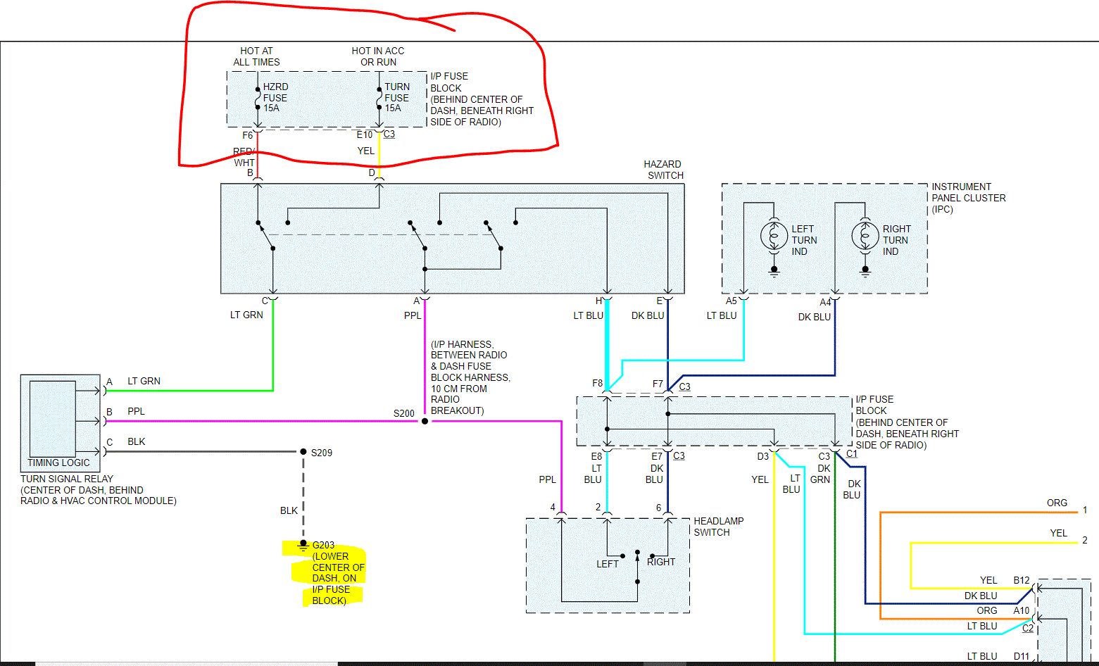

First, there are two fuses involved. One is the signal and the other is the hazard. I have a feeling the signal may be blown. Also, there is a ground under the dash, at the center, which will affect all the things you mentioned. I need you to check that as well

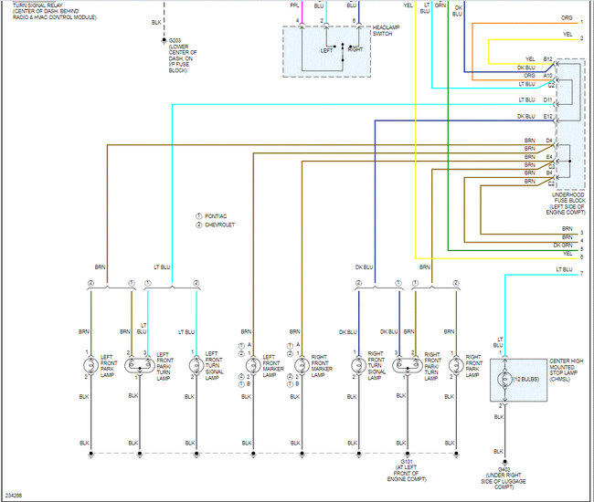

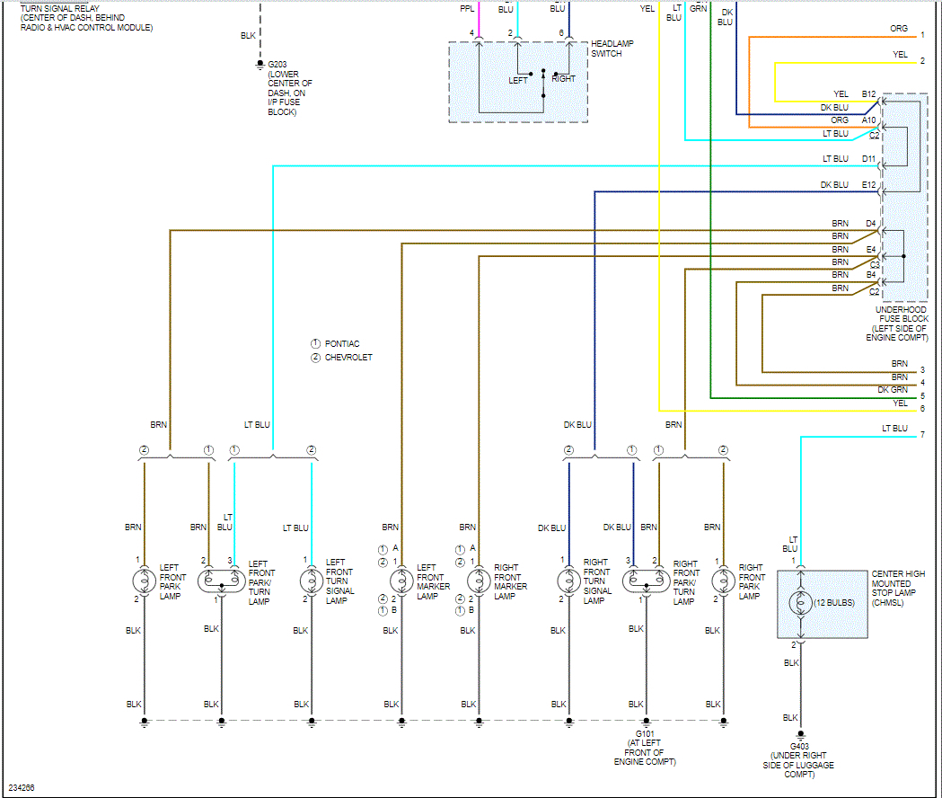

If you look at the attached pics below, they include the entire wiring schematic for the exterior lighting. In pic 1, I circled the fuses and highlighted the ground I need to be tested.
When testing the fuses, conform there is power to and from them. Here is a link you may find helpful:
Also, pic 5 shows the locations of the fuses.
If the fuses are good, confirm the black wire under the dash to ground is properly fixed and tight.
