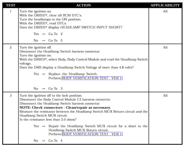

Chances are the switch is bad. However, it could be related to the body control module. Do me a favor. Take a look through these diagnostics and let me know if it is something you feel comfortable doing.
____________________________________________
2006 Chrysler Pacifica V6-3.5L VIN 4
Headlamp Switch Input Shorted-BCM
Vehicle ALL Diagnostic Trouble Codes ( DTC ) Testing and Inspection Manufacturer Code Charts Lighting Headlamp Switch Input Shorted-BCM
HEADLAMP SWITCH INPUT SHORTED-BCM
Test 1 - Test 3
see pic 1

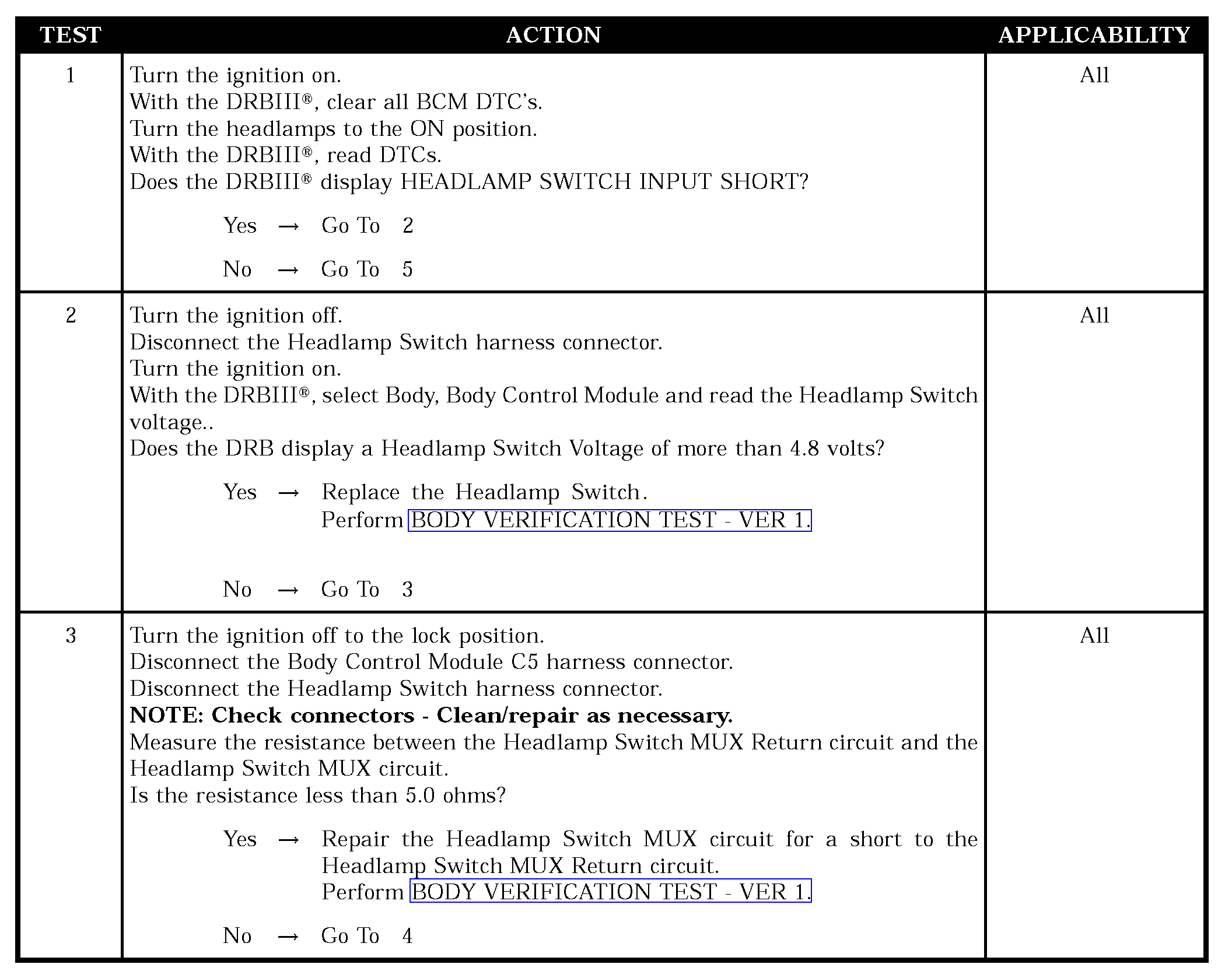

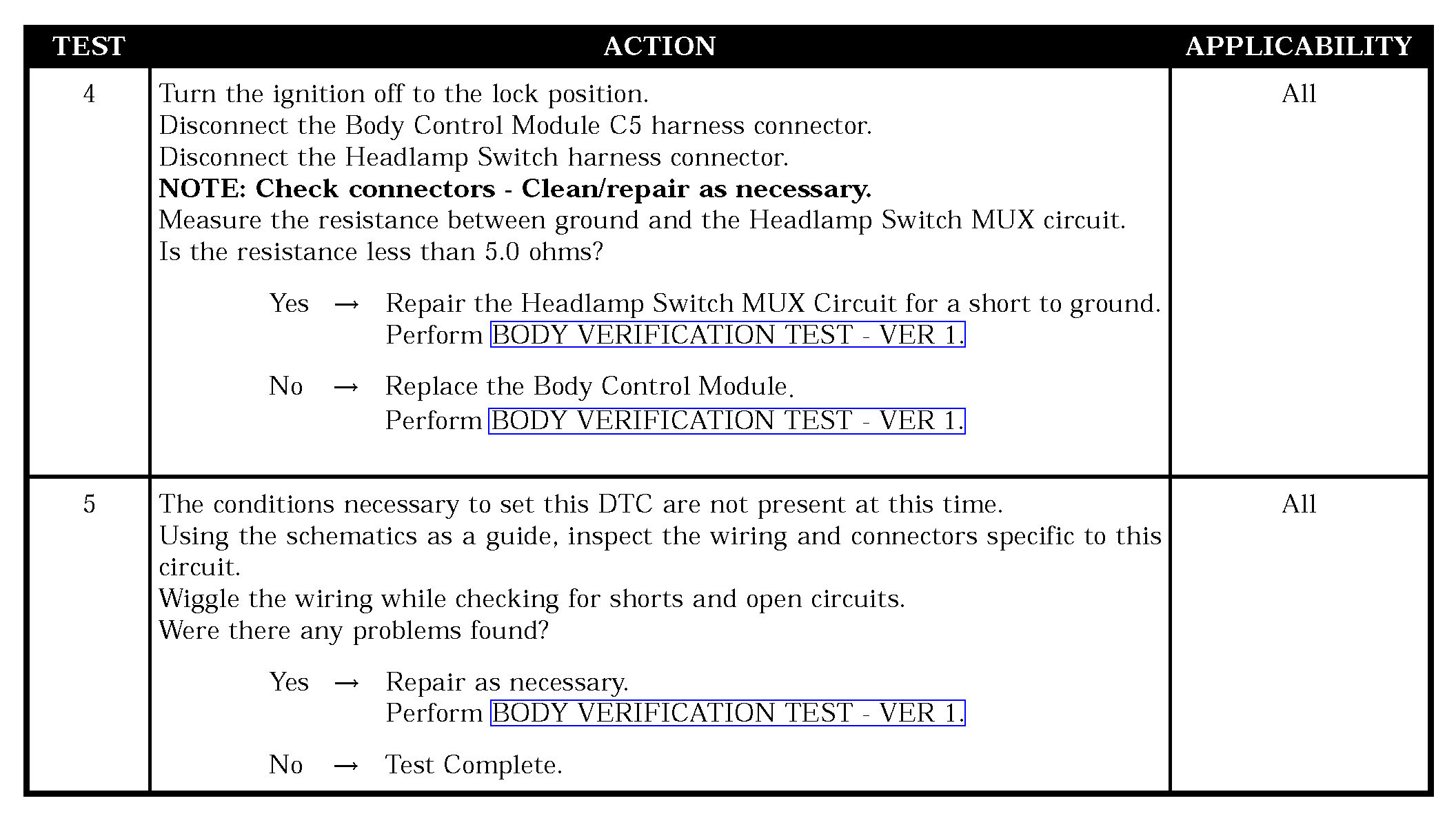

Test 4 - Test 5
see pic 2
SYMPTOM
HEADLAMP SWITCH INPUT SHORT-BCM
POSSIBLE CAUSES
- Headlamp switch shorted
- Headlamp switch MUX circuit short to MUX return circuit
- Headlamp switch MUX circuit short to ground
- Intermittent wiring and connectors
- Body control module
