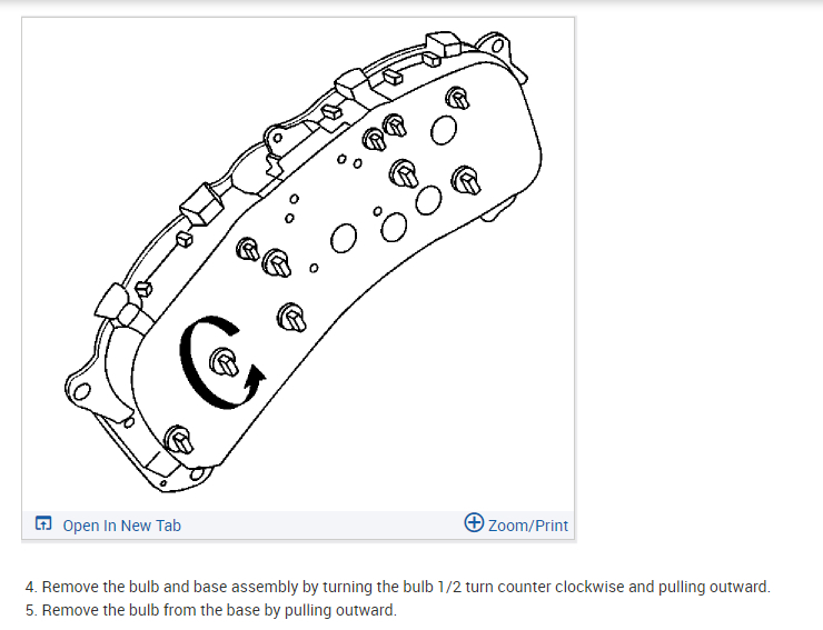

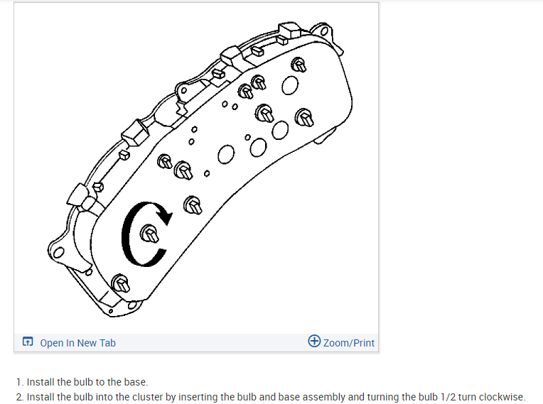

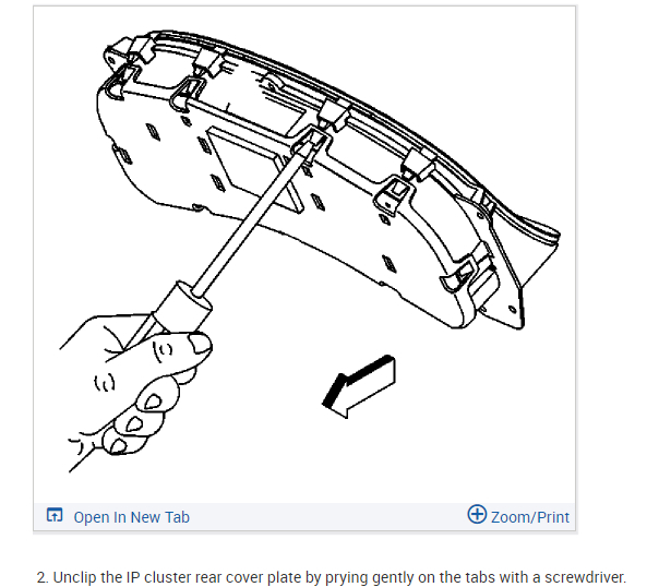

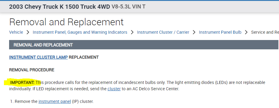

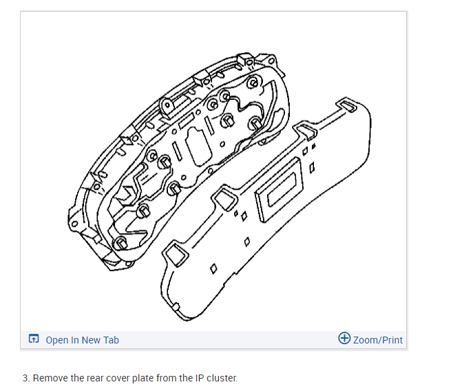

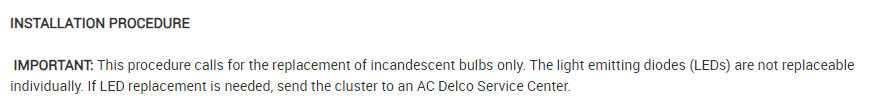

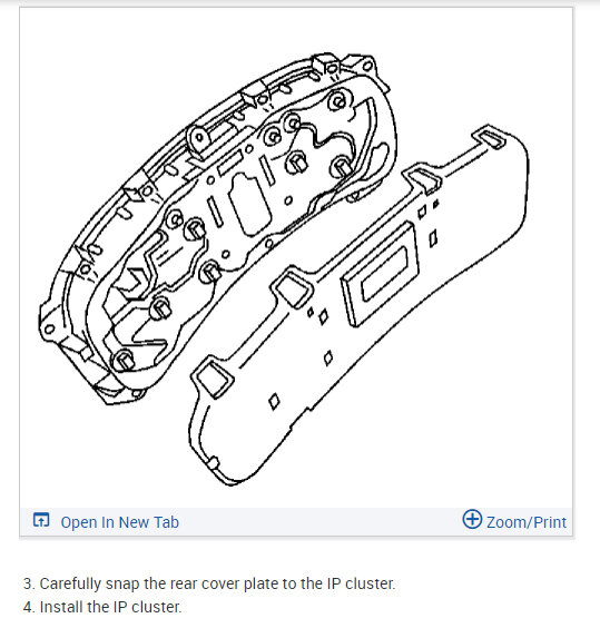

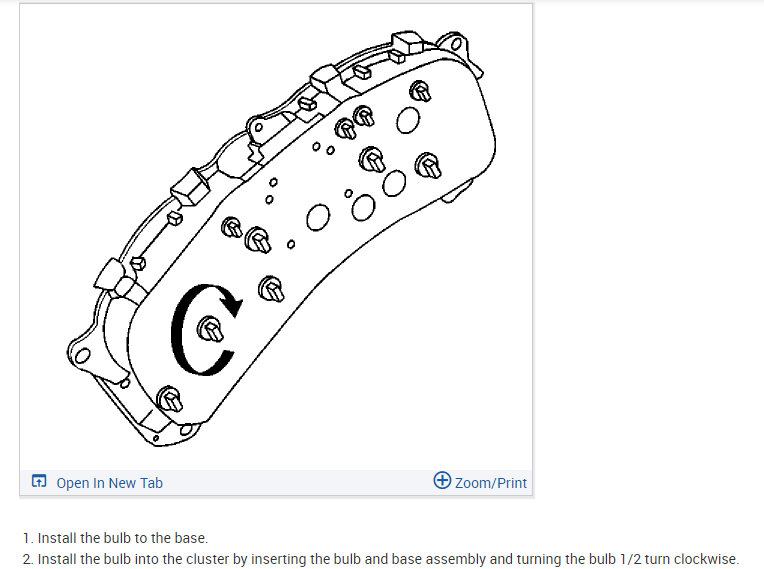

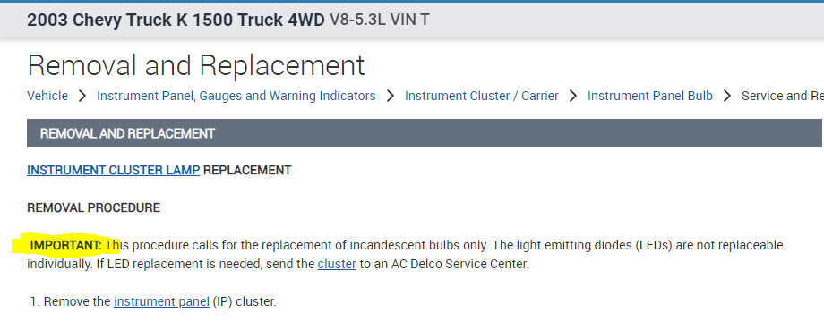

I can help with the instrument cluster bulbs, but the small switches are likely LED bulbs. See the highlighted note in the directions below.
Take a look through the directions and let me know if they help or if you have questions.
See pics below.
