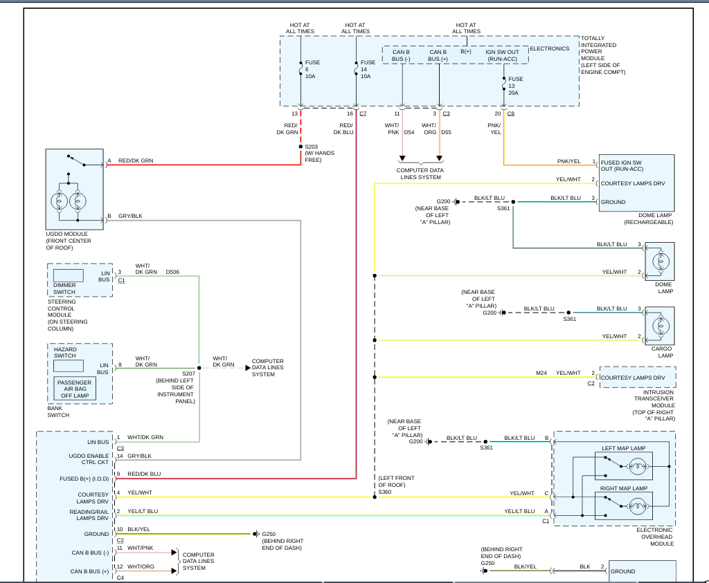

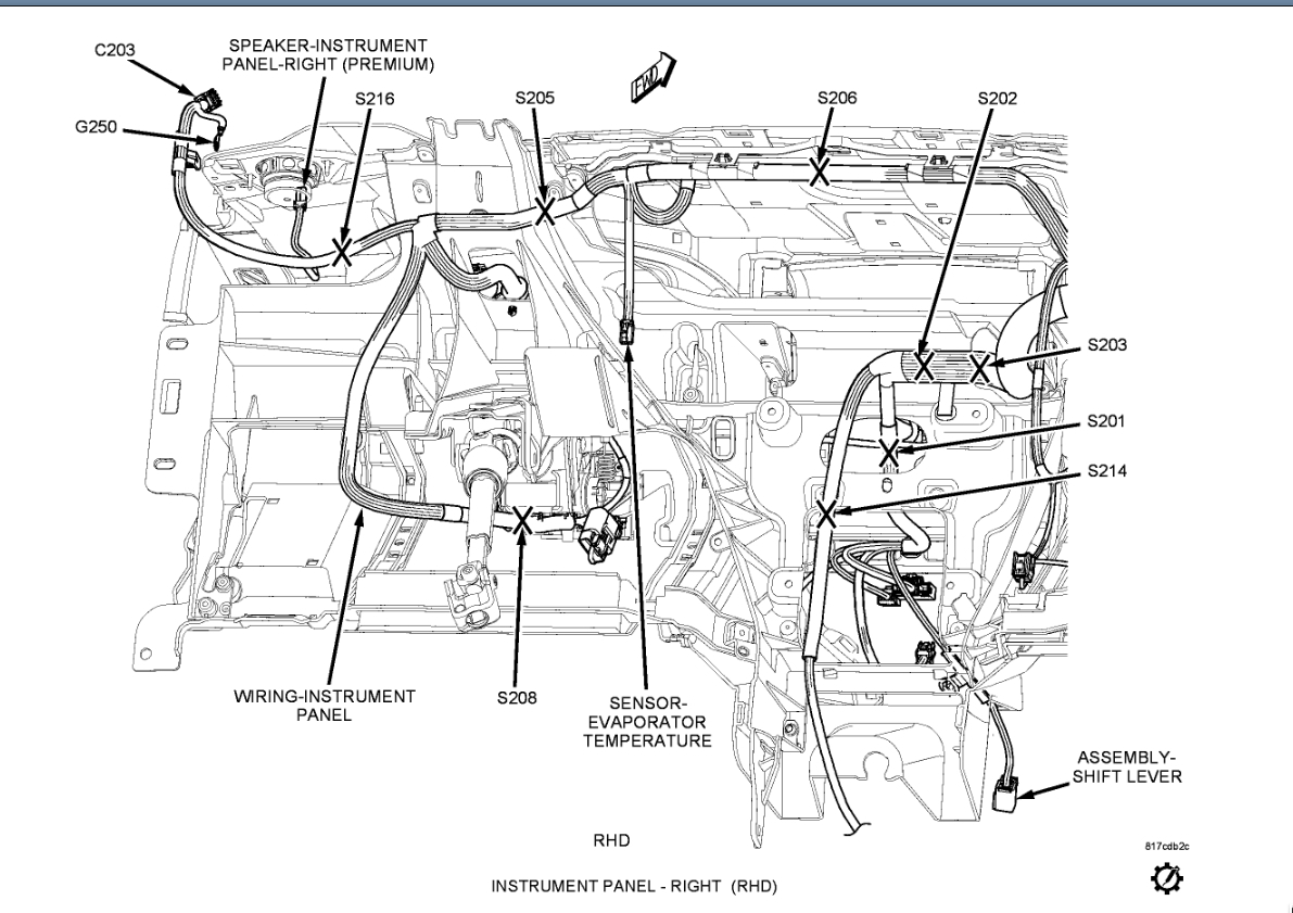

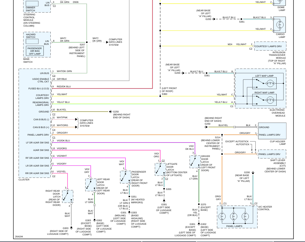

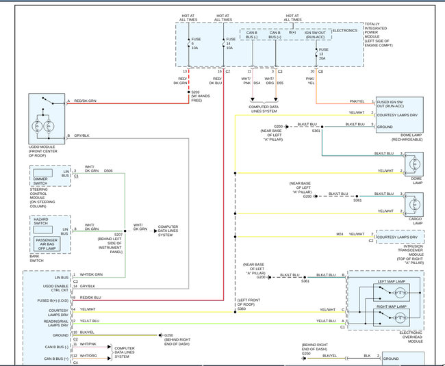

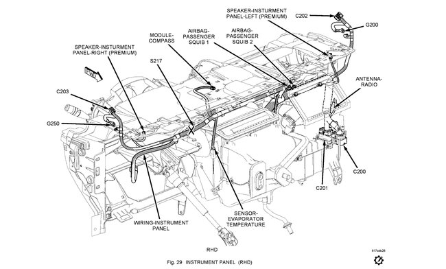

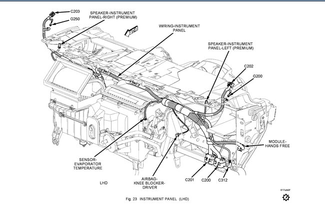

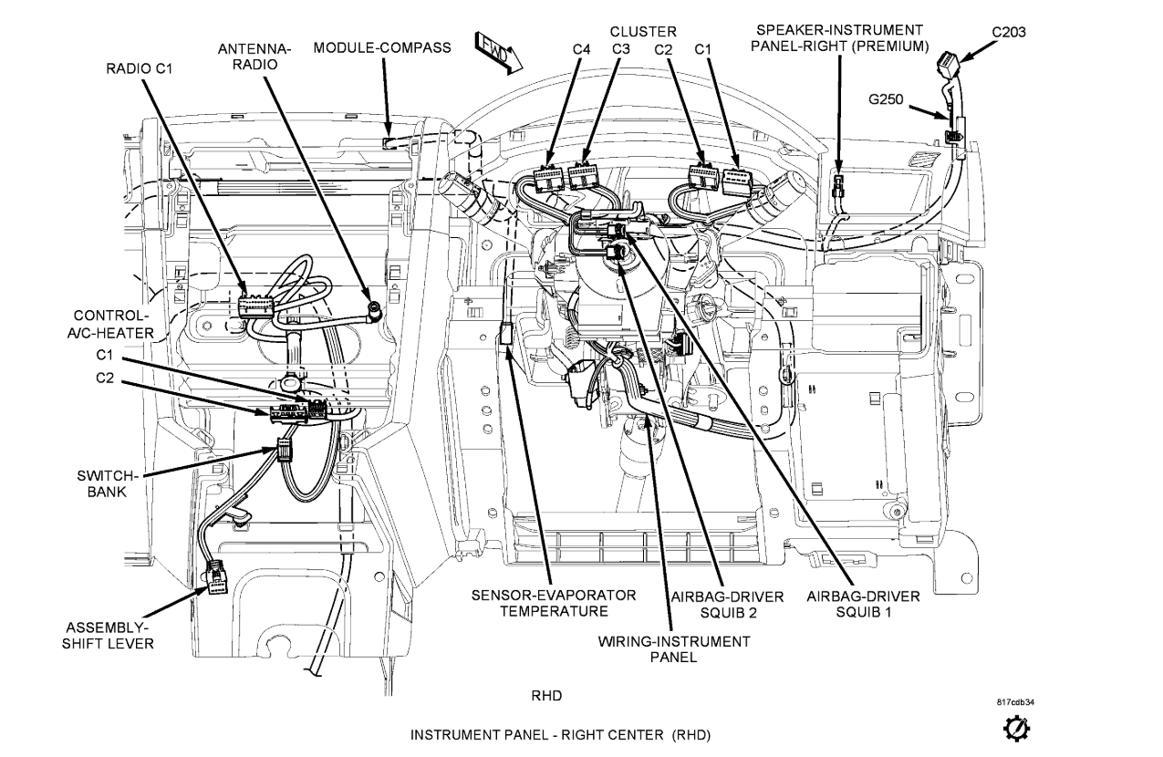

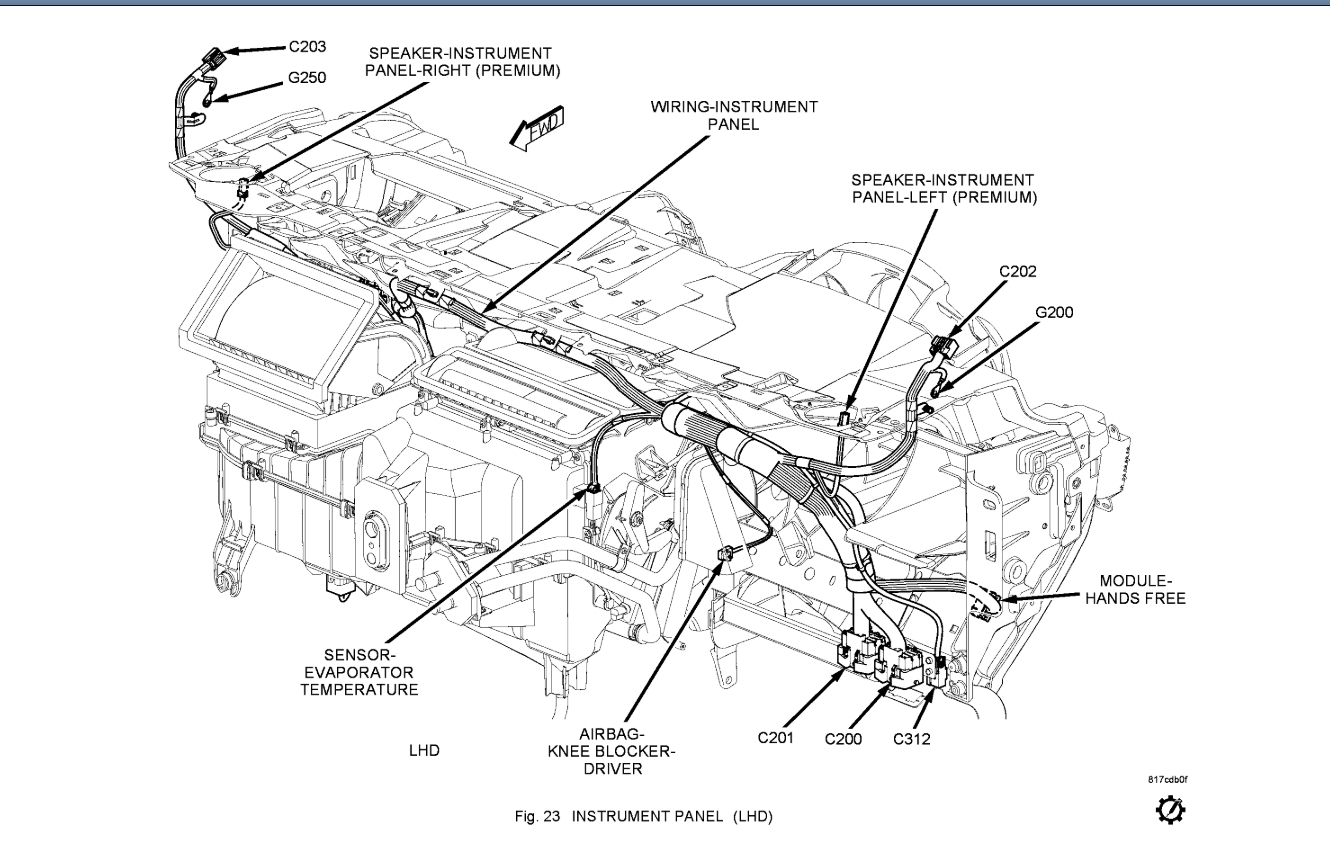

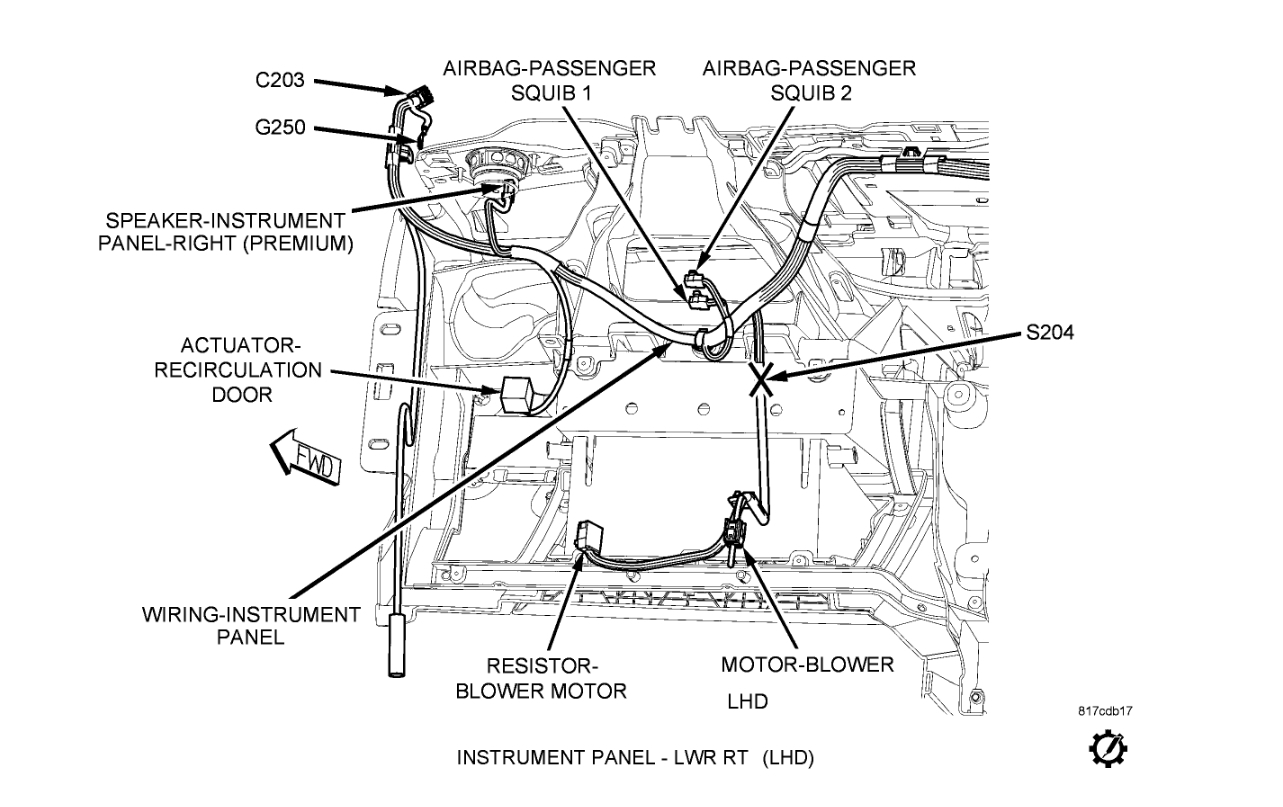

This sounds like you could have a problem with Ground #250 being loose. In the diagrams down below I have included the wiring diagram for the interior lighting of your vehicle as well as the location of Ground #250. Please make sure that the ground is clean, tight, making good metal to metal contact, and is corrosion free and then get back to us with what you find out.
Thanks,
Alex
