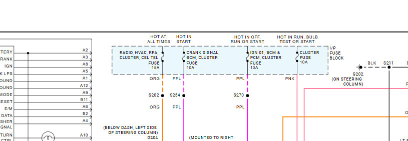

I would check the four fuses that run the cluster first and if they are okay chances are the cluster itself is bad. What happens is the LED board or the driver goes out so the cluster will need to be rebuilt, you can search google or ebay for a rebuilder but lets check the fuses first this guide can help with the fuse location in the images below.
