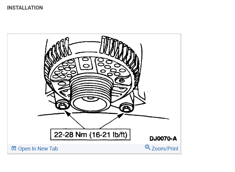

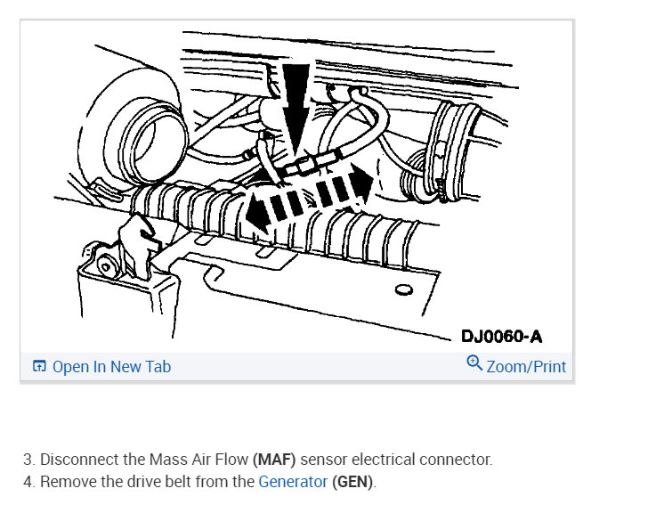

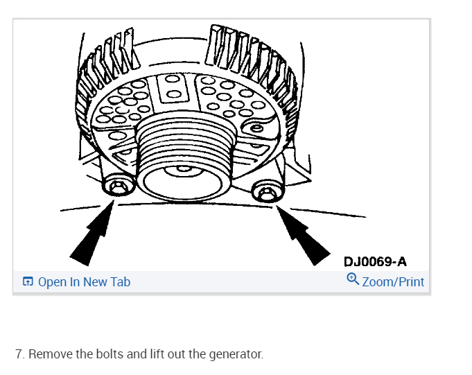

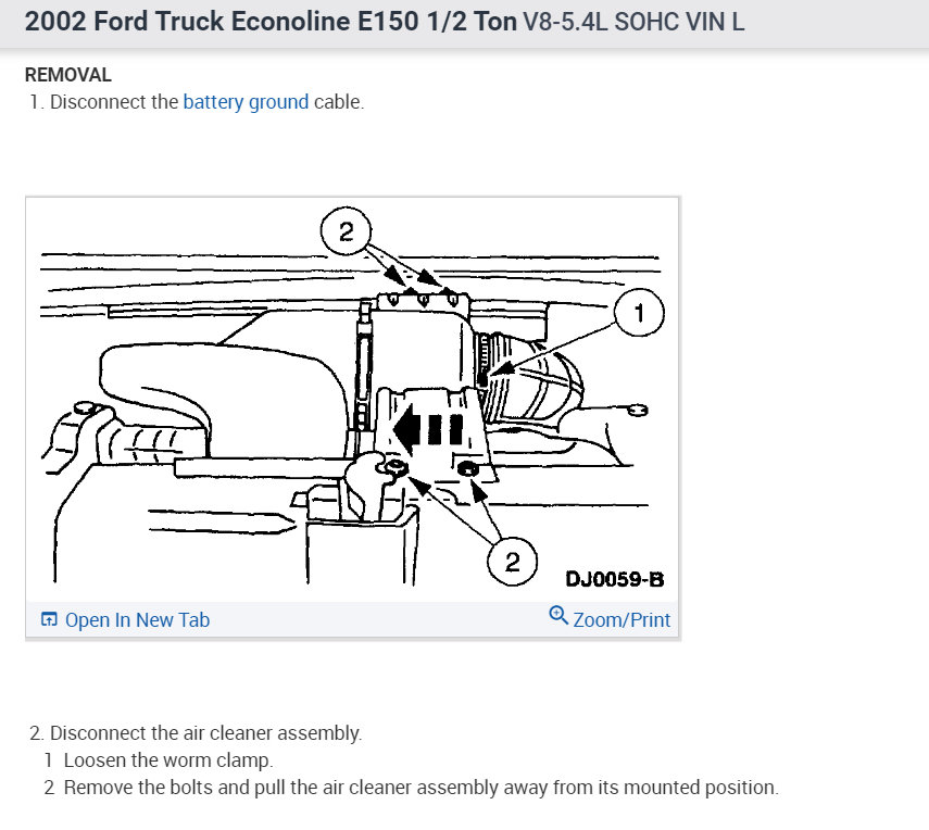

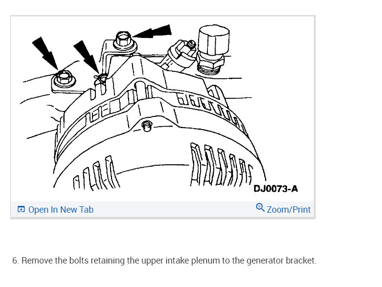

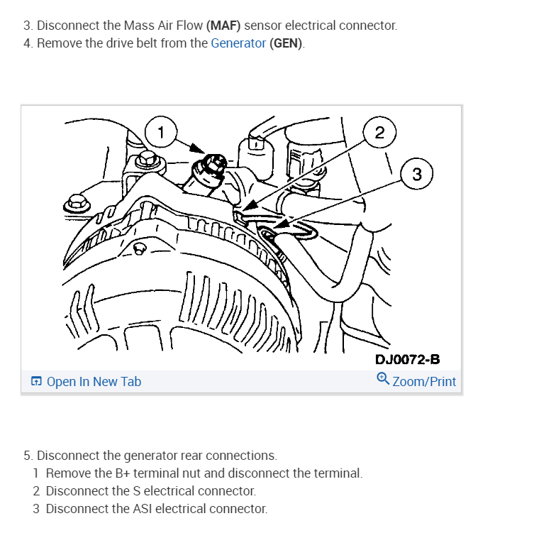

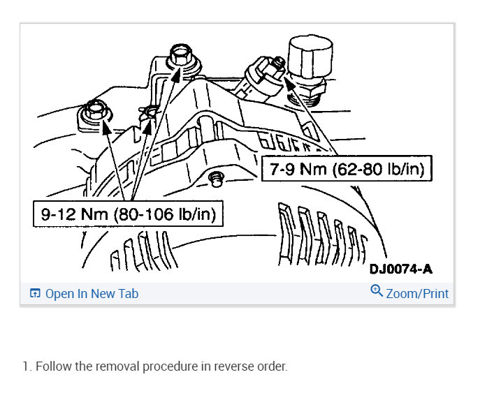

If it is not charging here is how you can change the alternator out in the diagrams below. Check out the diagrams (below). Please let us know what happens.
