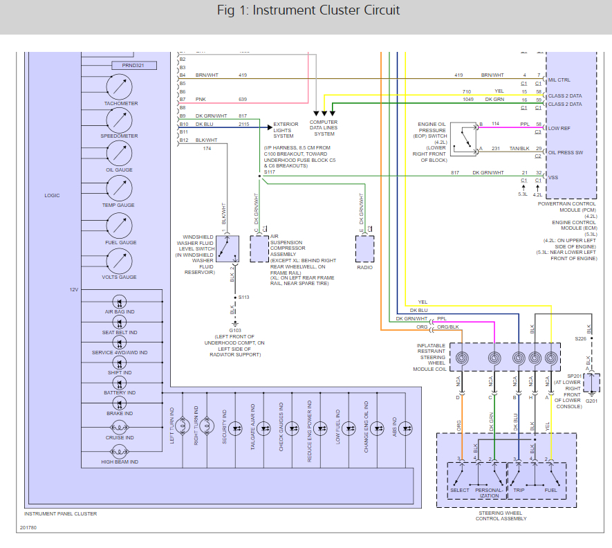

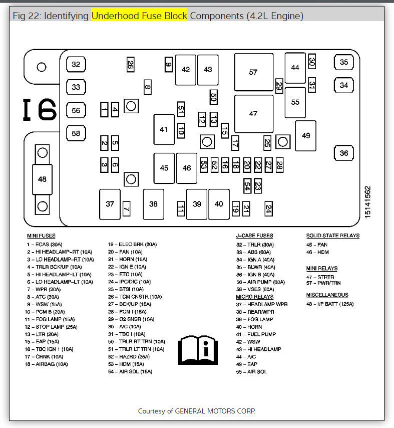

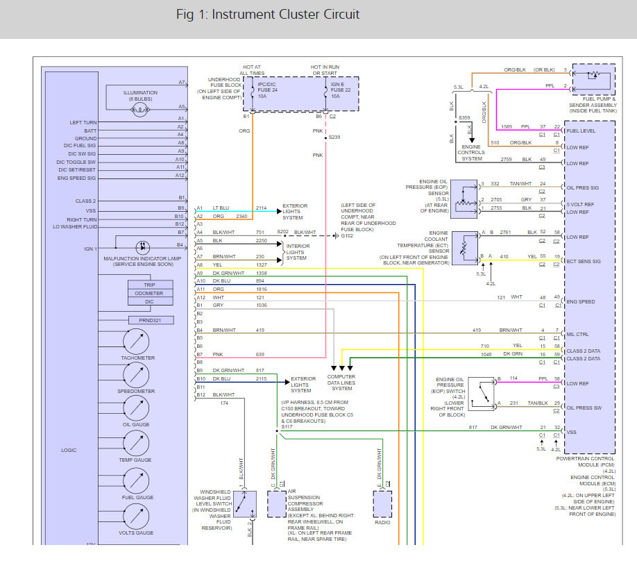

There are two fuses ( #24 IPC-DIC and IGN E) that need to be checked first. Here are the wiring diagrams so you can see how the system works and the fuse location along with a guide to help you test the fuse for power:

ken fig 22 you sent me is for a 4.2 is the 6.0 the same location
Oct 26, 2018 at 2:15 PM
Yes, should be. Let me know.
