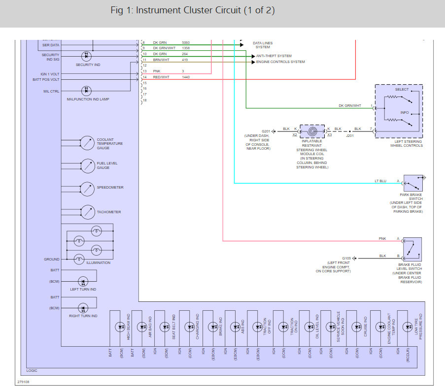

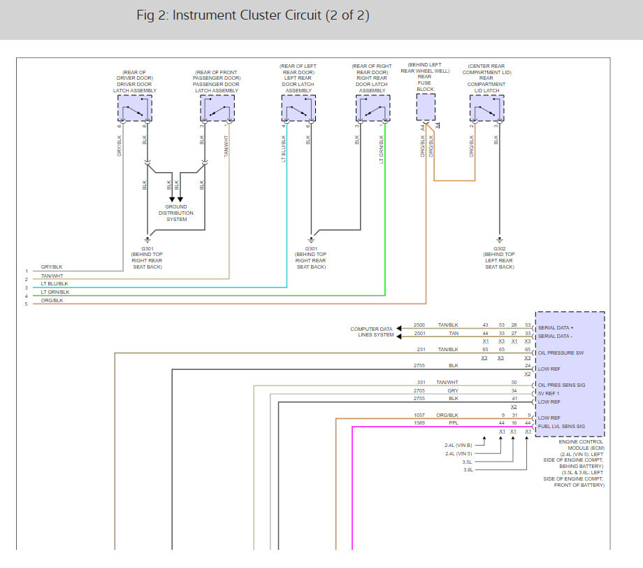

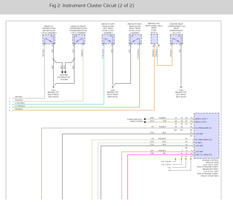

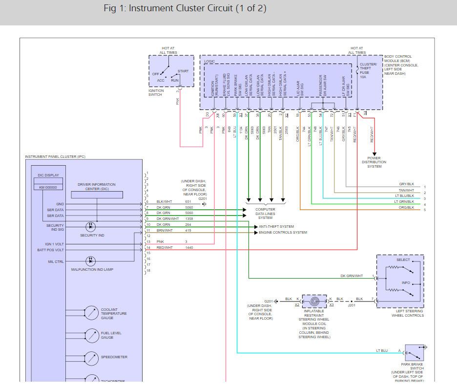

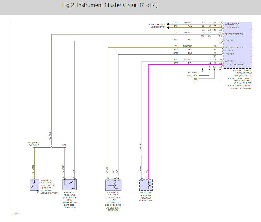

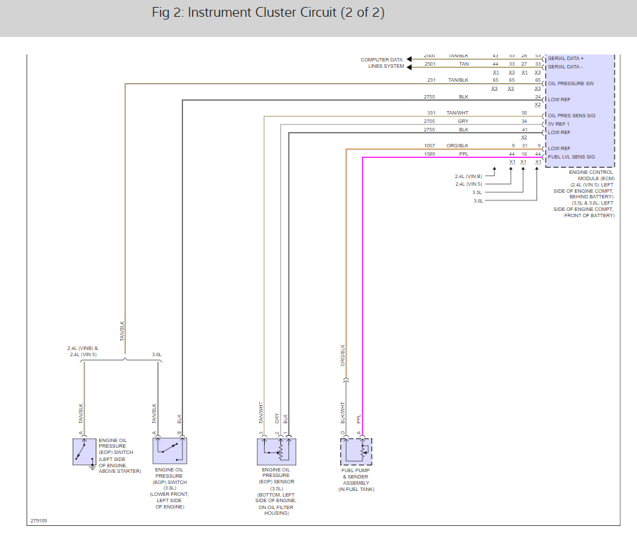

This sound more like the cluster is no good. I would test the power and grounds and then get a used cluster and install it. Here are the wiring diagrams so you can see how the system works and a guided to help you test for power and grounds with a video showing how to get the cluster out (not the same car but the process is the same:
https://youtu.be/_HEC44xENxw
and
Check power and grounds. Check out the diagrams (below). Please let us know what happens.

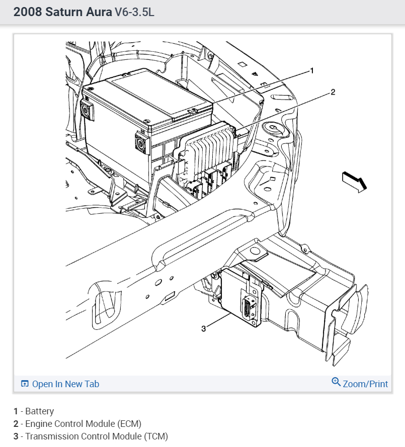

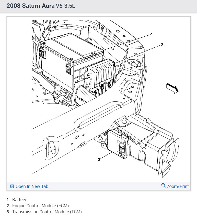

The gauge is controlled by the PCM so that is possible the new PCM did not get programmed correctly or it is bad. Here is the location of the PCM. I would try to find a used one or get a reprogrammed unit. Let me know what happens please.
