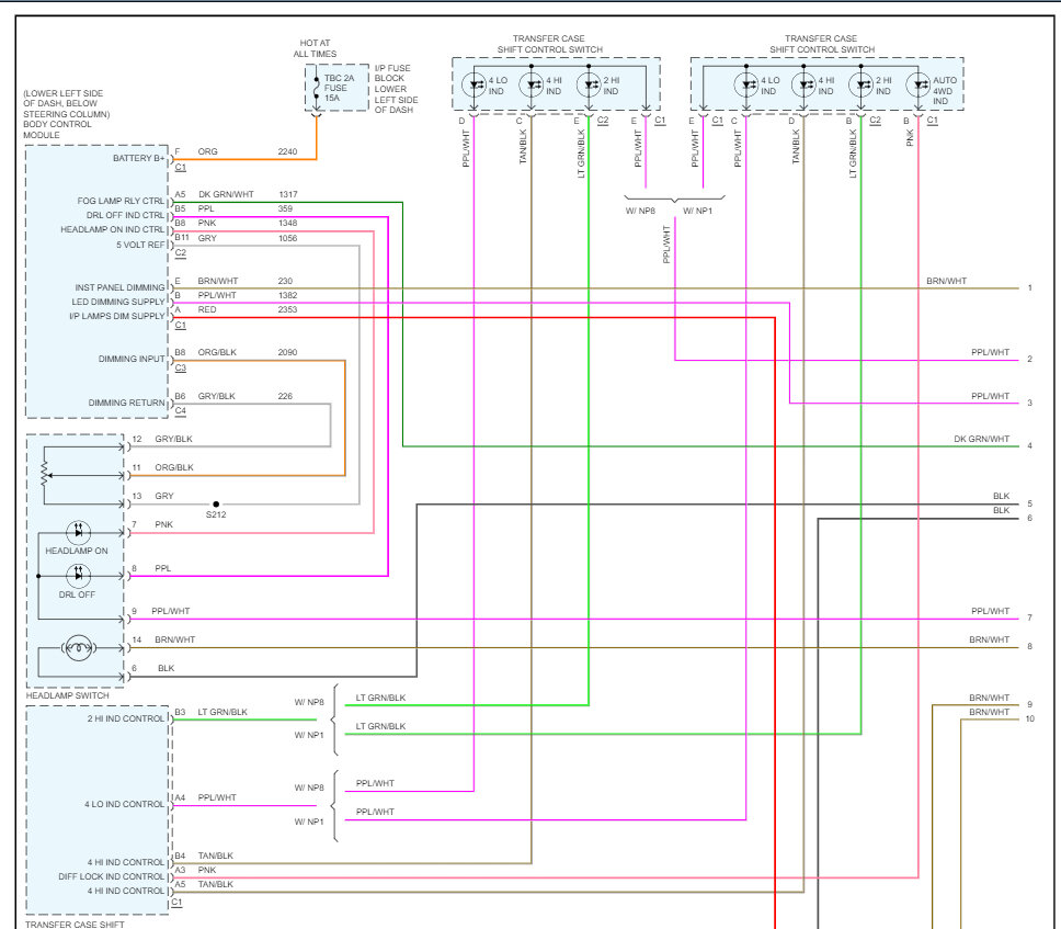

My dash Cluster will not light up during the daytime, but at nighttime when the Headlights are on it works fine. The dimmer switch works, and it is backlit great. I cannot see during the daytime. Why does it not light up in the daylight hours?

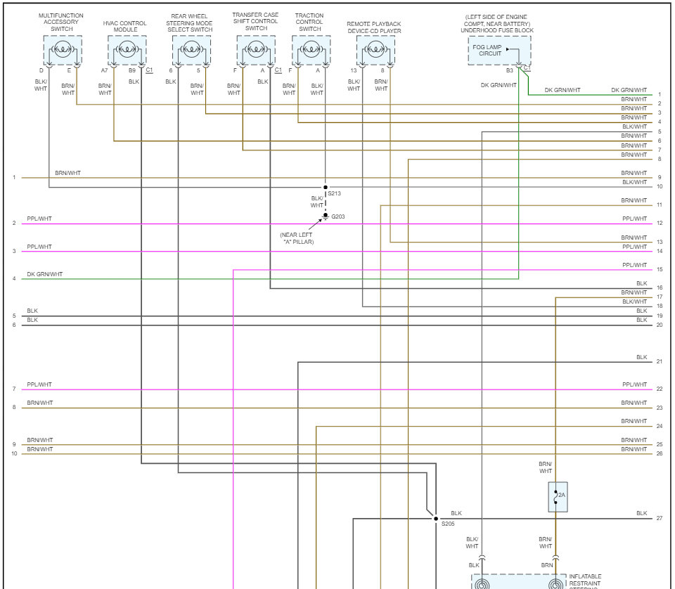

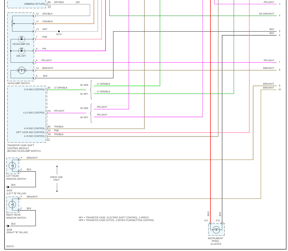

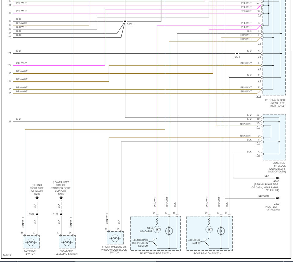

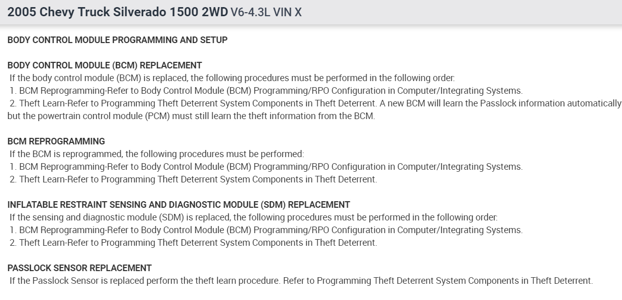

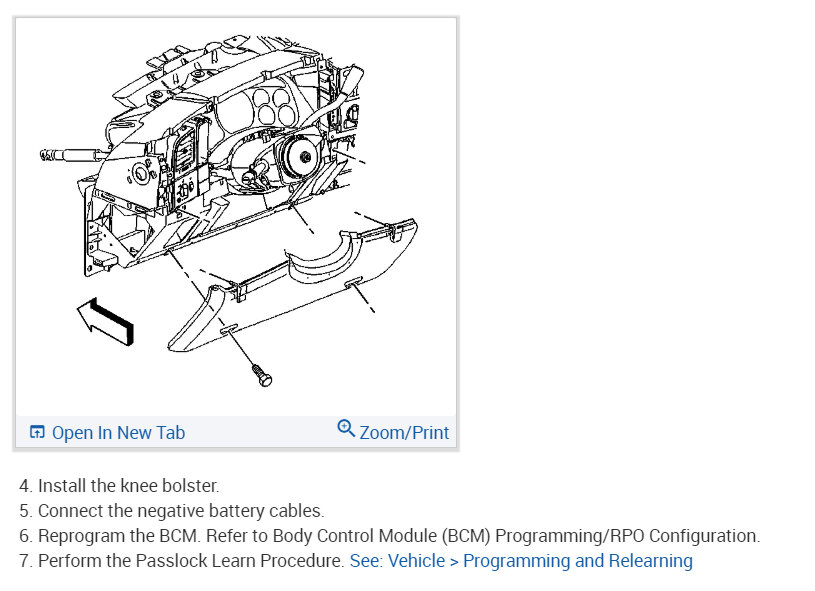

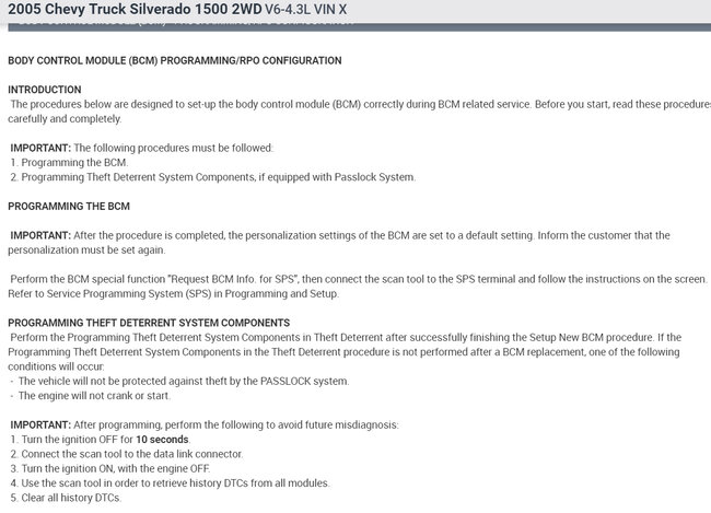

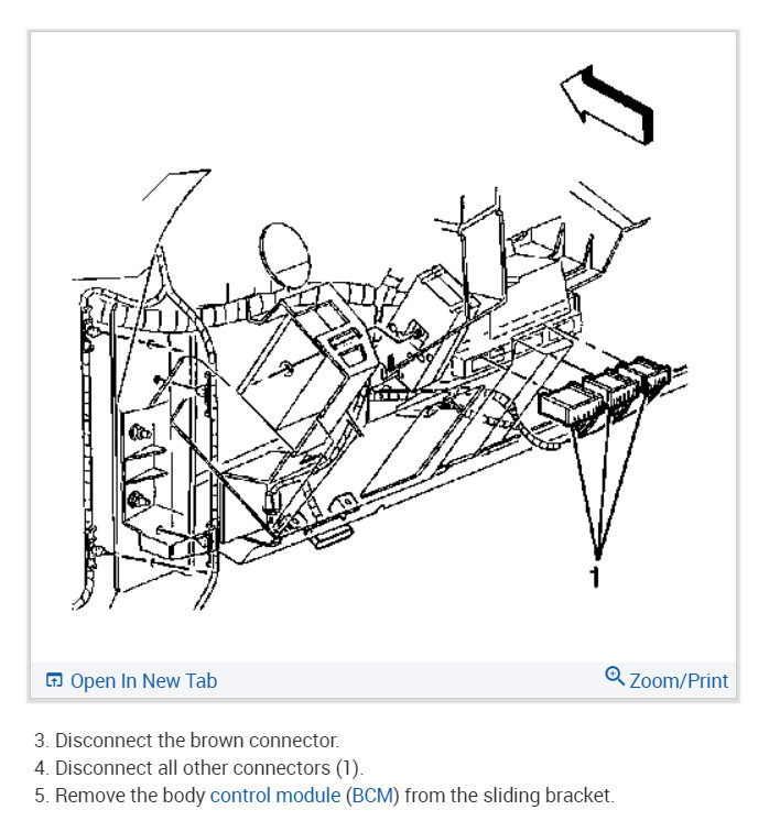

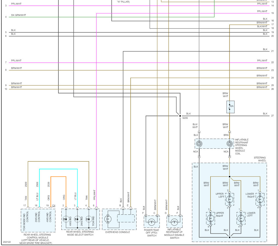

I would check the TBC 2A fuse on the left side of the dash fuse panel, here is a guide to help:

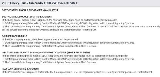

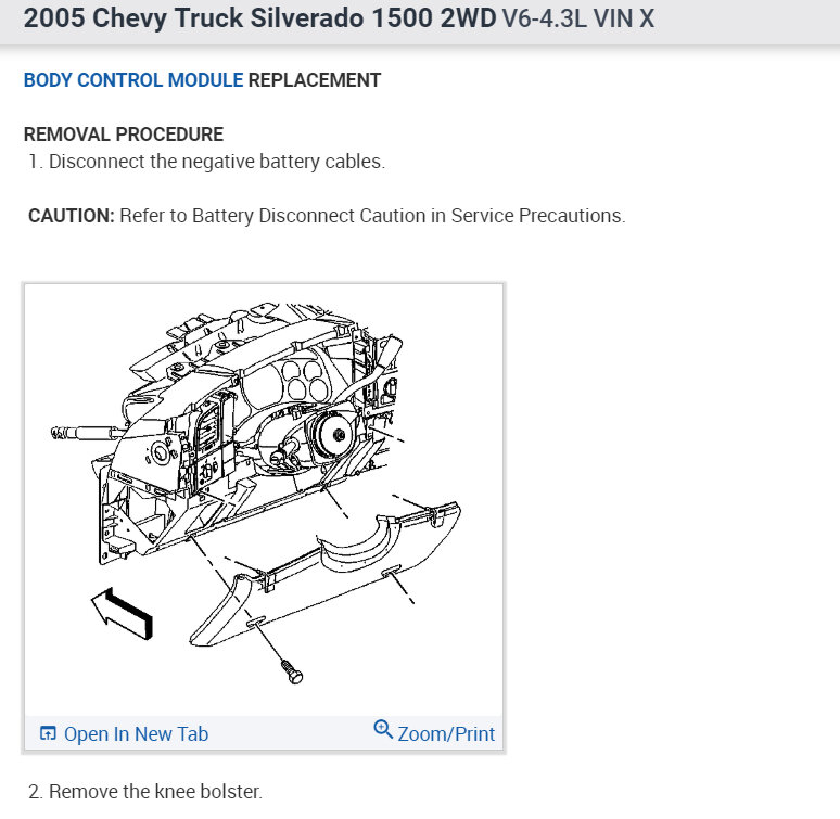

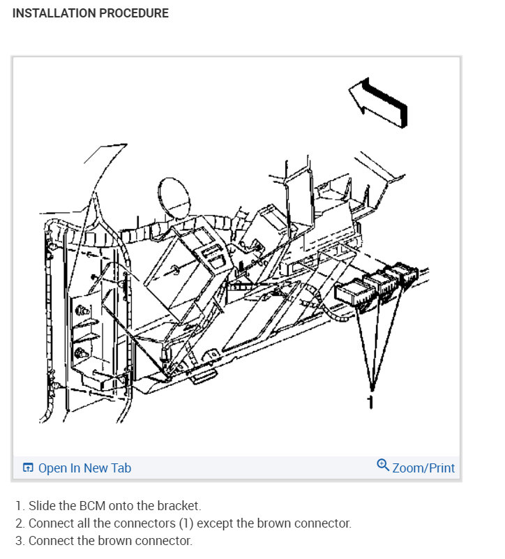

If the fuse is okay, it sounds like the BCM is going out but to be sure we should do a CAN scan. You can get a CAN scanner (Controller Area Network) which will work on most cars from Amazon.
Here is a video to show you how:
https://youtu.be/u-4syLc-ifQ

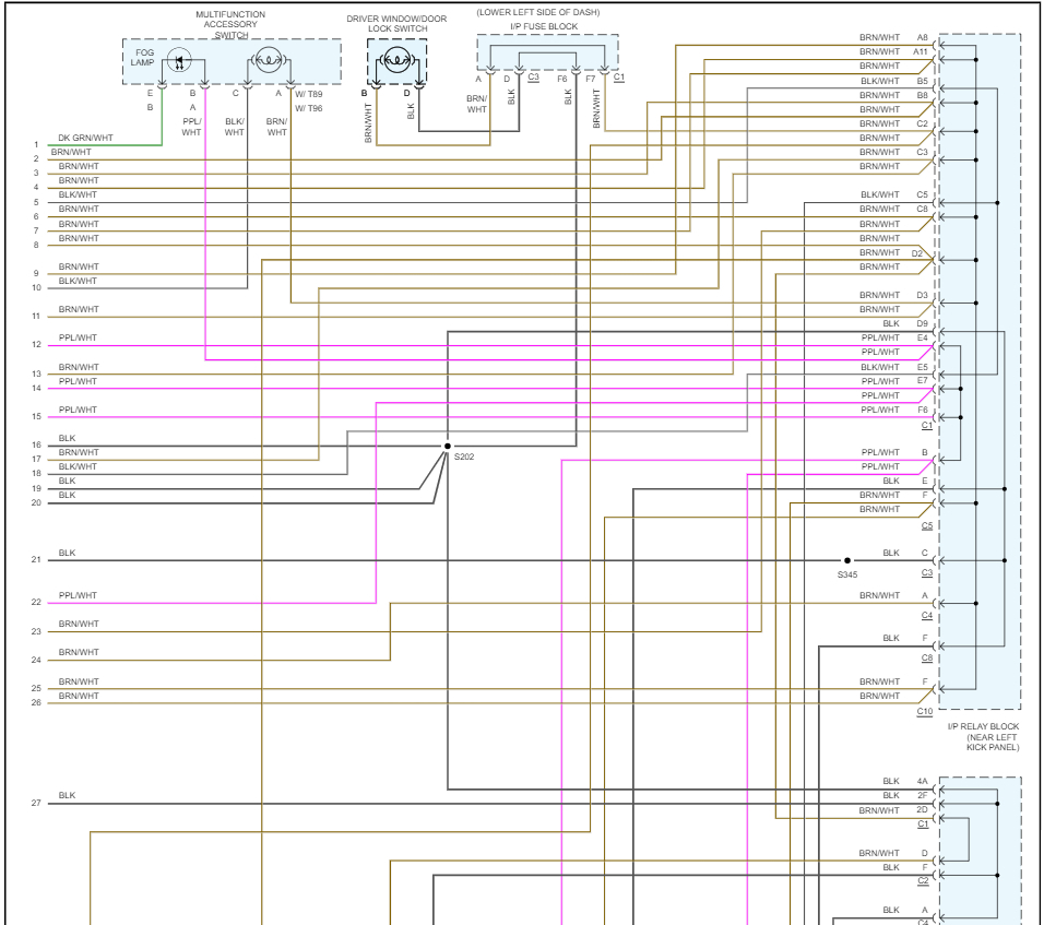

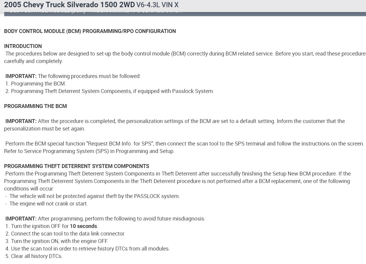

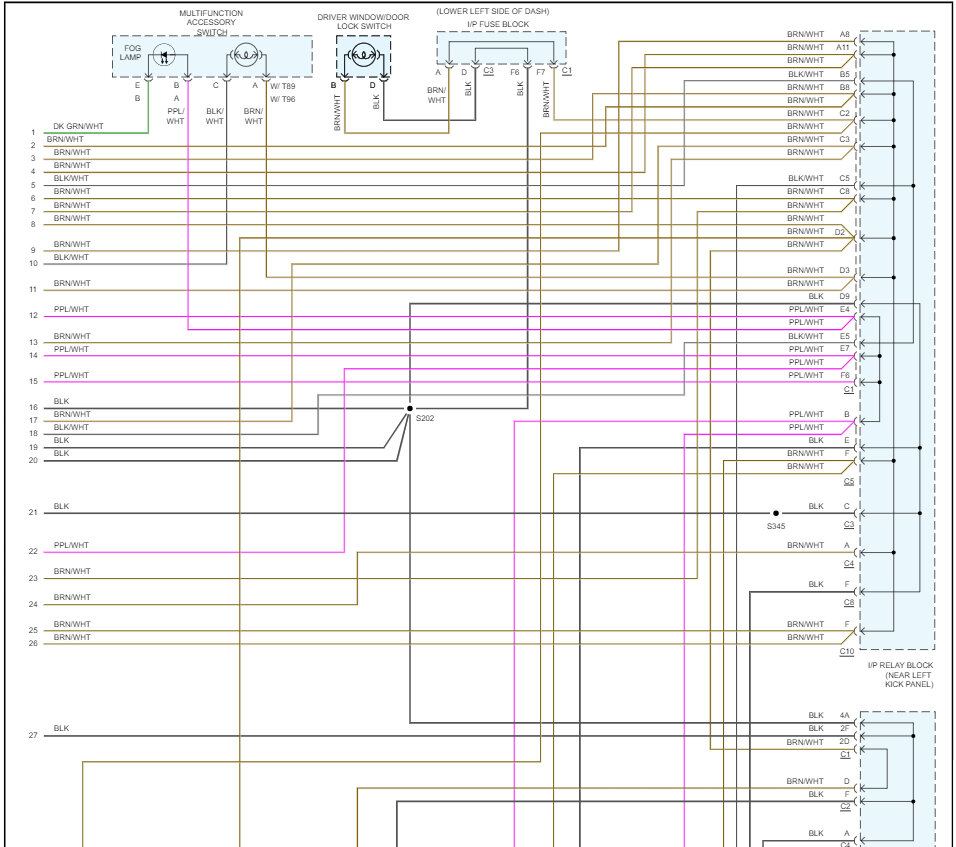

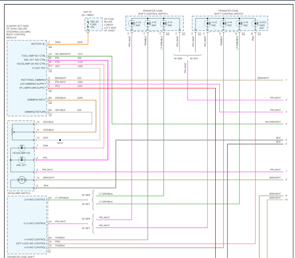

Here is how to change the BCM out and the instrument cluster wiring diagrams so you can see how the system works. You can get a preprogrammed unit by searching Google or Ebay. Check out the images (below). Please let us know what happens.
