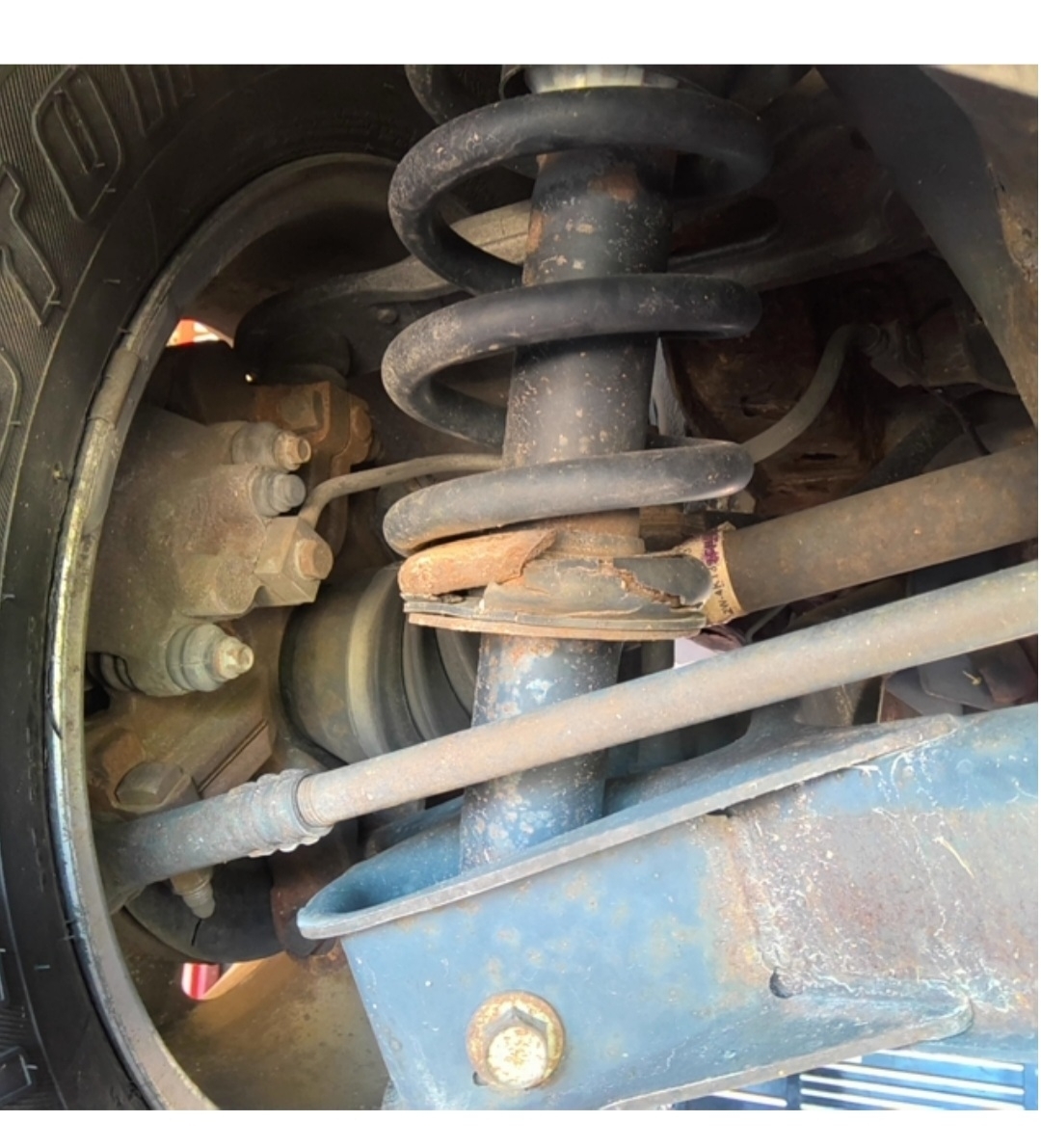

Please see picture attached. I will be replacing rear struts. Questions...can I drive locally with this damage for another week...also when I drive, I have noticed when I use brakes to turn corner or go around a curve the steering wheel seems to "freeze: for a second then gets loose. Could this cause that or would it be another issue such as brakes. The steering fluid is black but the guy at shop said that's normal for this type of vehicle when I requested a steering fluid flush. When I drive and let go of steering wheel the car doesn't pull to one side...it goes pretty straight. I originally took to shop due to steering issue. please advise if picture did not attach.

Hi, thank you for your quick response. Please see attached. And how bad/dangerous would it be to drive like this for about a week in town. top speed 40 -45 MPH.
Oct 6, 2024 at 3:27 AM

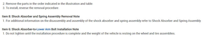

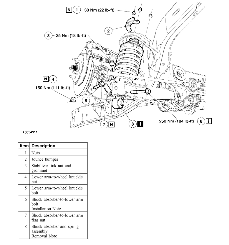

No, I would not drive the car, this is a broken suspension spring and can be dangerous. Here is a new strut for $142.00:
https://amzn.to/3NdB7Po
Here is how it is installed. Check out the images (below). Please let us know what happens.
