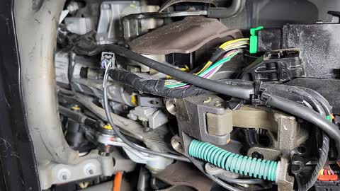

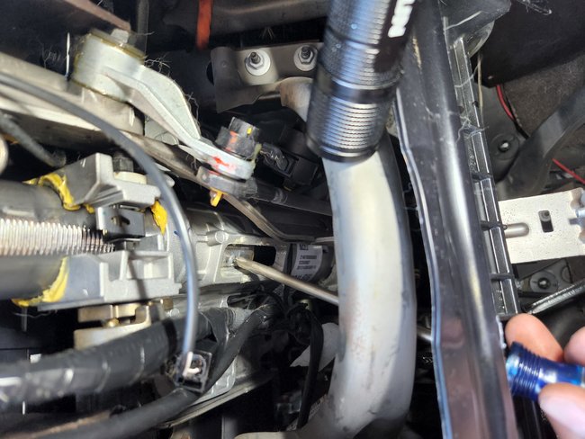

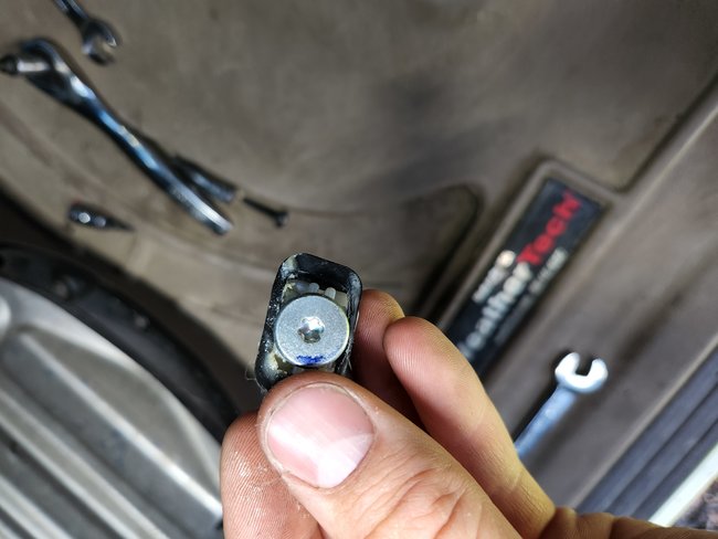

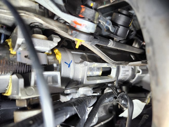

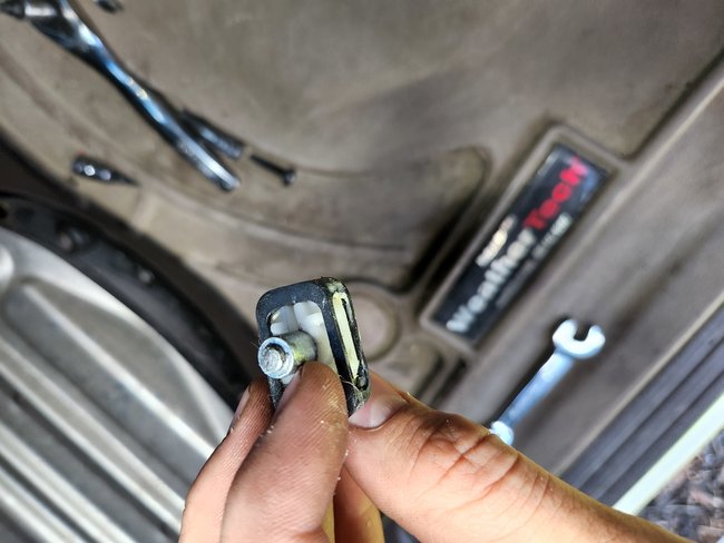

I was attempting to tighten my steering column. The steering wheel would turn slightly even when locked. While turning the steering wheel to see what was loose, I sheared off a bolt from the underside of the column. It appears to be a bolt which prevents the steering column from being pulled too far out when it is adjusted. I don't know exactly what it does or how important it is, and I can't find the bolt online. The pictures show the sheared off bolt from the underside of the steering column.

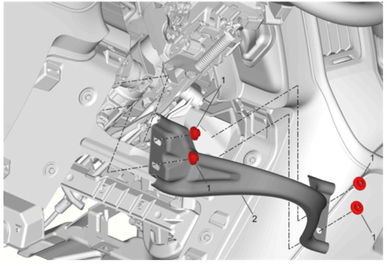

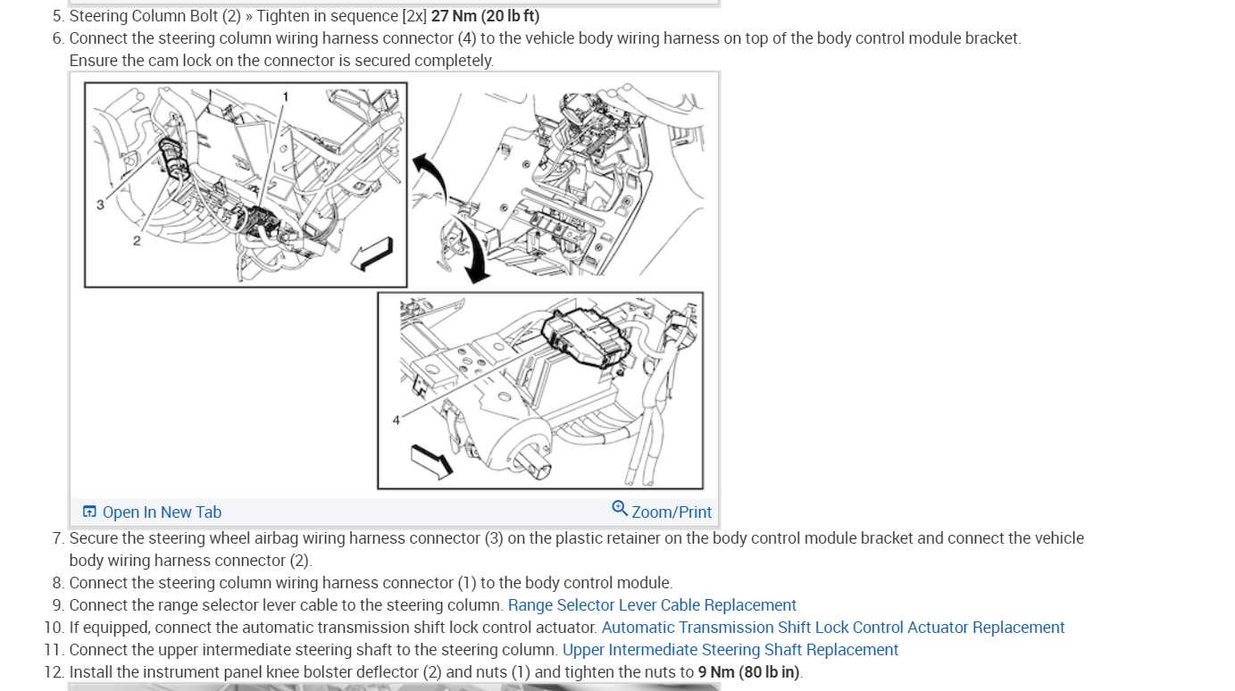

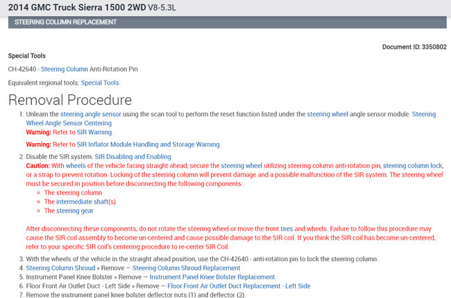

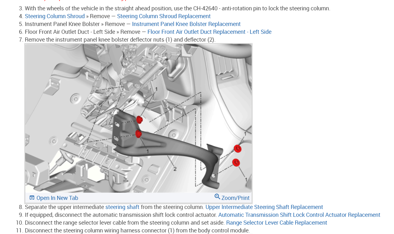

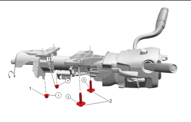

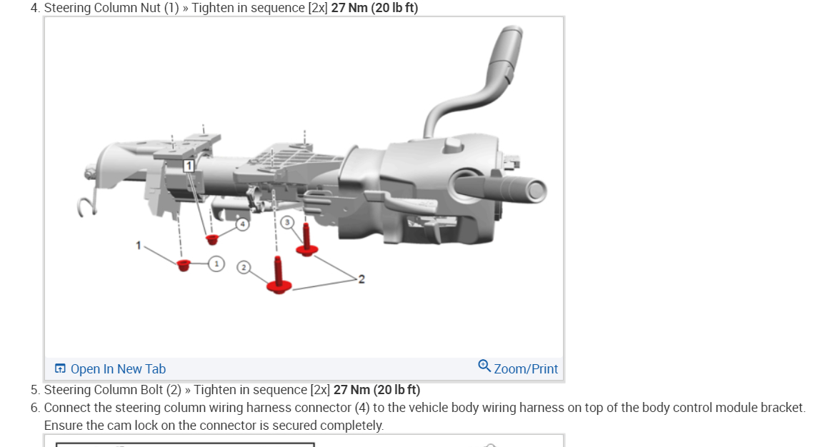

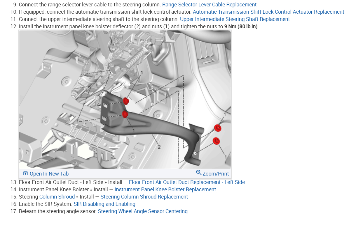

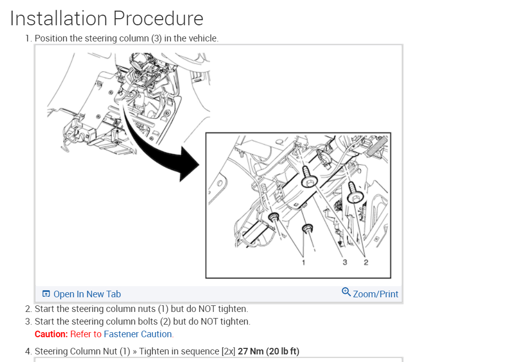

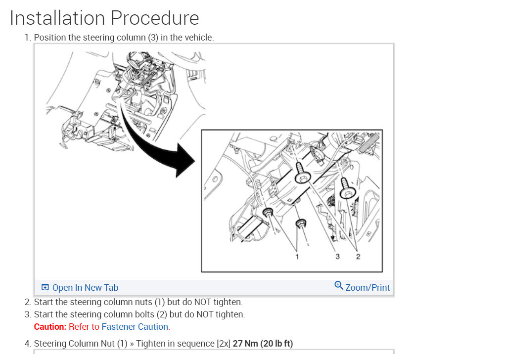

I'm not sure which bolt you are referring to. I attached pics below. Take a look at them and let me know if you see it.
Also, if you could upload a pic of where it is, that may help me.
See pics below.
Aug 9, 2022 at 6:50 PM

It's a little difficult to tell from those diagrams. Here are the pictures. For some reason they are slightly rotated, but hopefully this makes it clear.

Hopefully these pictures will help.

Does this have a telescopic steering column? That appears to be the locking mechanism for it.
Aug 9, 2022 at 8:59 PM
AUSTINLEFE
  • 8 POSTS

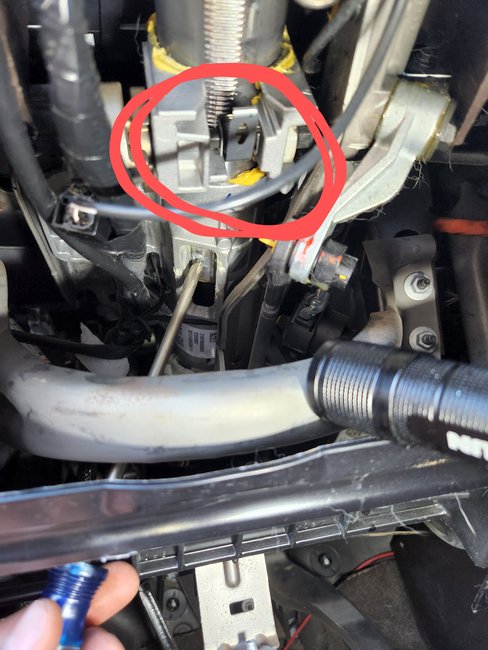

Yes, it is. It has a manual telescopic steering column. The locking mechanism is actually in this picture below and still works. This bolt seems to have been to keep the steering wheel from pulling too far out, but I'm not completely sure. I don't know if it serves another purpose and how important it is.
Aug 9, 2022 at 10:19 PM
To the best of my knowledge, that is the only purpose for it. Looking at the pics I have and what you have provided, it doesn't appear it was responsible for anything other.

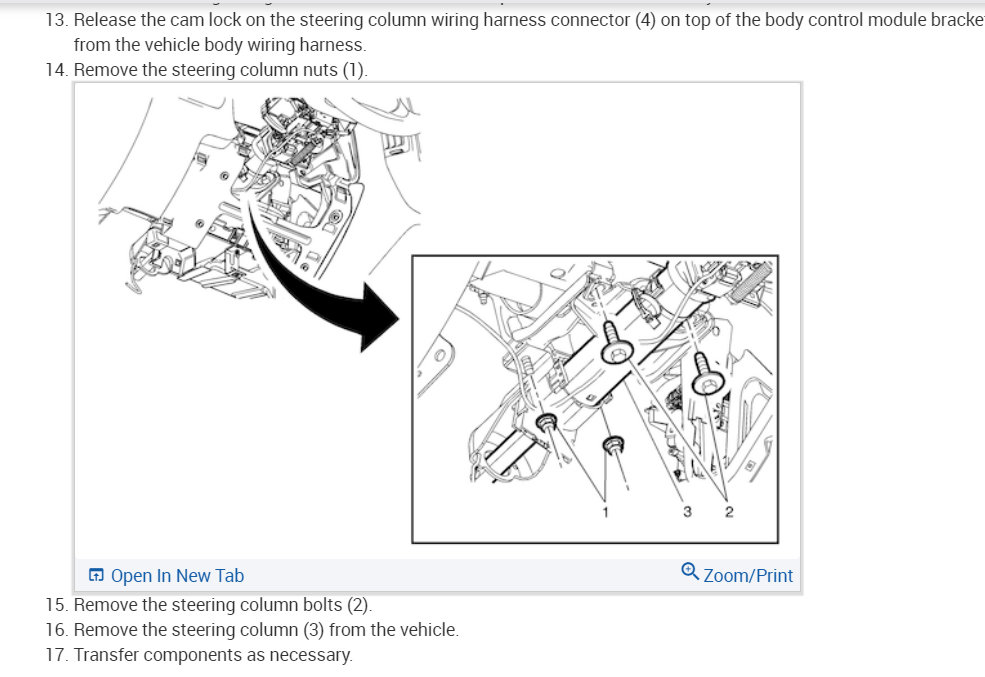

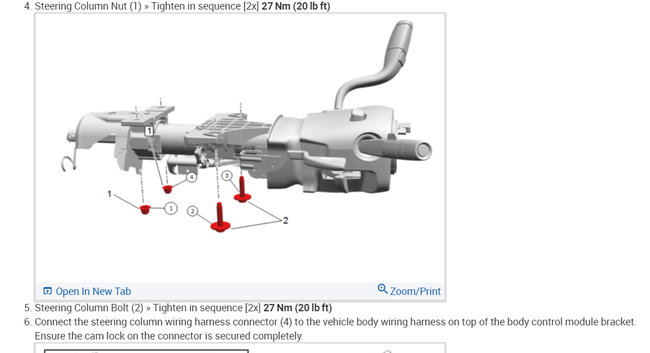

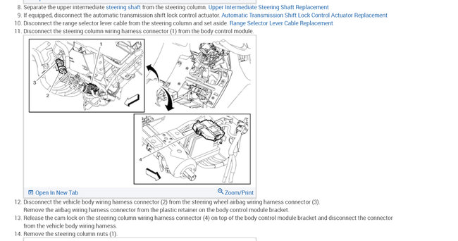

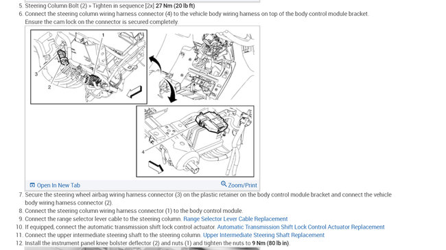

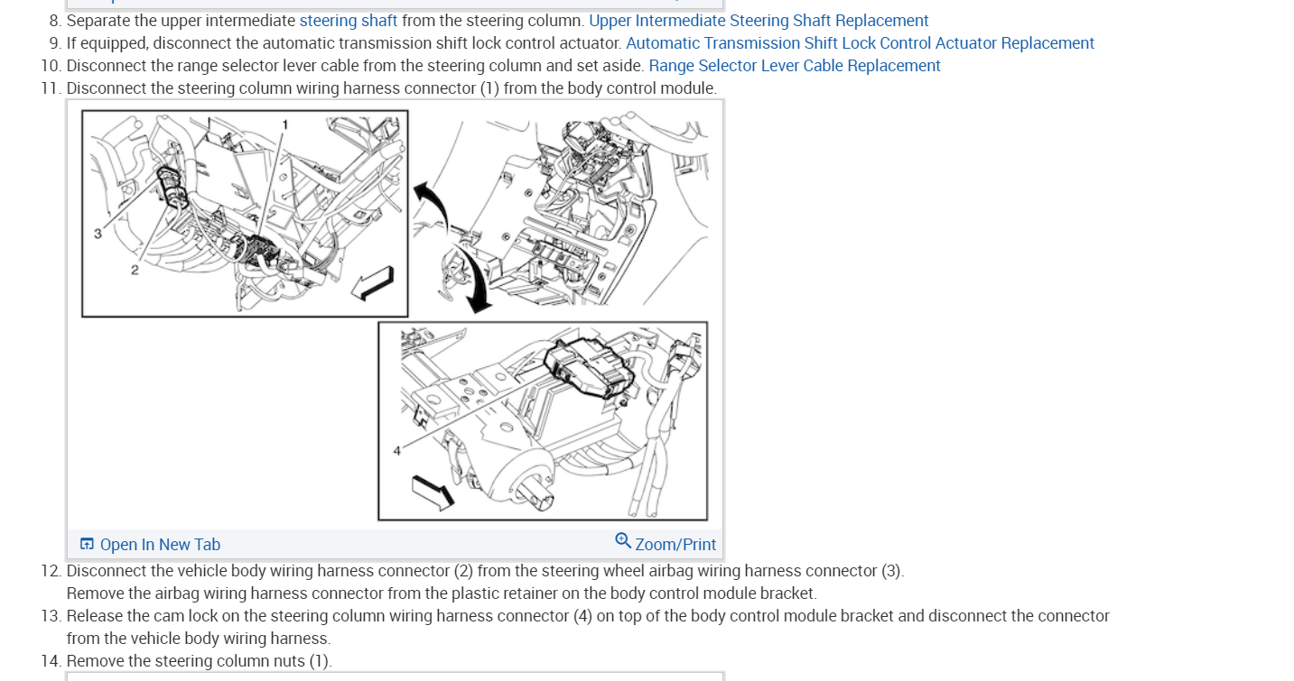

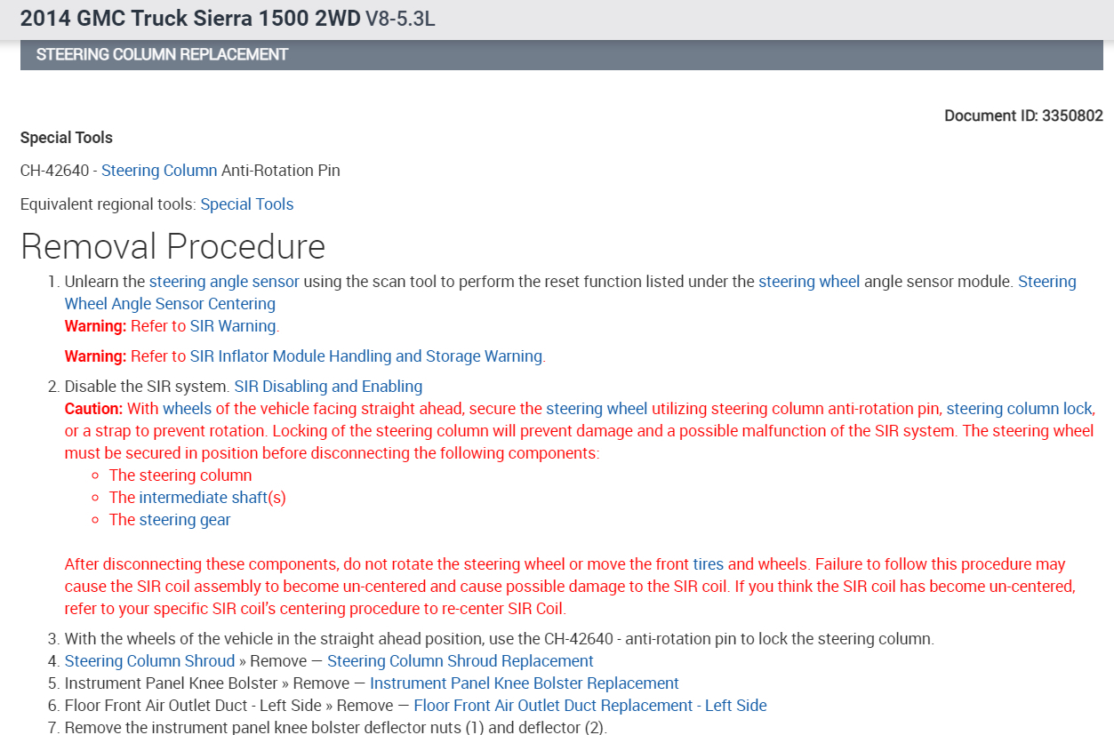

Thanks for the video, it looks like this problem has nothing to do with the steering column, the mount that is welded to the dash mount is broken. You will need to remove the column and either reweld it or you might be able to drill holes to bolt it, either the weld was bad from the factory, or someone really muscled the wheel or the tuck as in an accident at one point. Here are the instructions on how to remove the column. Check out the diagrams (below). Please let us know what happens.

I just got back. Ken is correct. The column isn't properly mounted anymore. The steering column needs to be removed to repair the mount. Have you tried removing it yet?

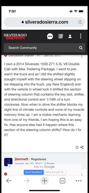

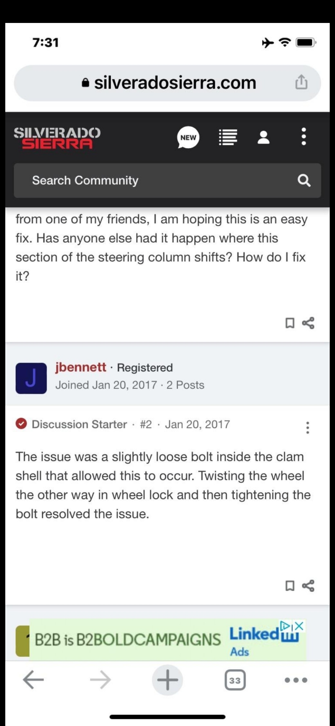

Thank you for the replies. I haven't dug into it yet, but that will be next weekend's project and I will update how it goes. I found this short forum from a few years ago but couldn't determine what exactly was referenced with the bolt in the clam shell. I'm not sure if either of you know what's being talked about? I've never taken out a steering column and I'm a DIY mechanic at best. I'll be working on the column next weekend, and I'll let you know.

If I had to guess, they are referring to the bolt you attached prior. I made a copy of it and re-attached it below.
Other than that, I'm not sure what they referred to.
