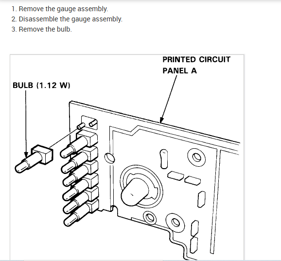

I was having a problem with my fuel pump relay, the main one. I then replaced it but now my D4 light won’t come on. I get d1d2d3 But I do not get d4. I was reading up a little bit and it says it may be the transmission control unit, but I can’t find out where it is as anybody else had this issue.
Apr 22, 2025 at 5:38 PM

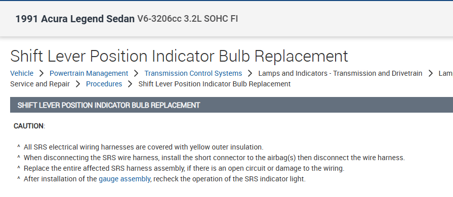

Does the transmission shift normally when placed in D4? I ask because there are individual bulbs that can fail. See pics below.

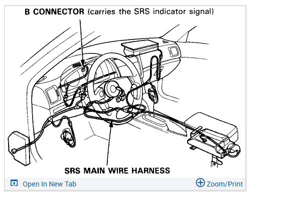

See pics below.
