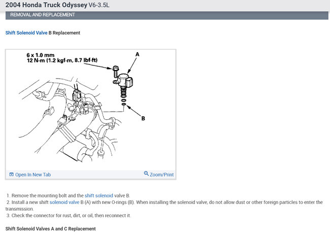

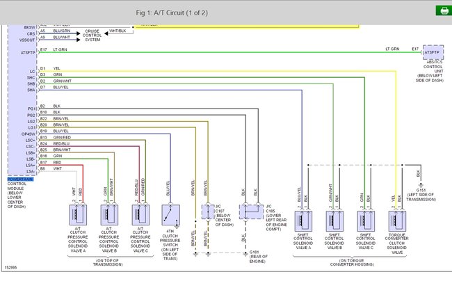

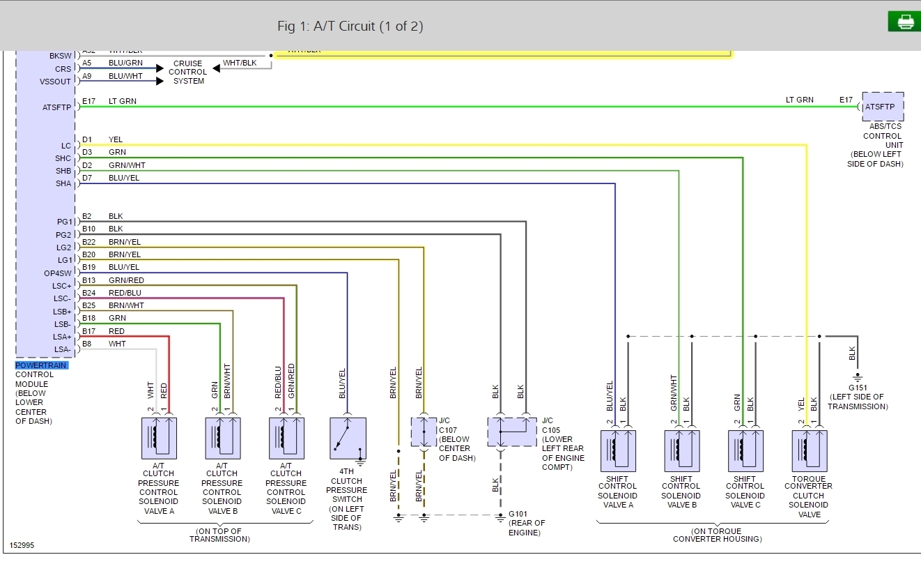

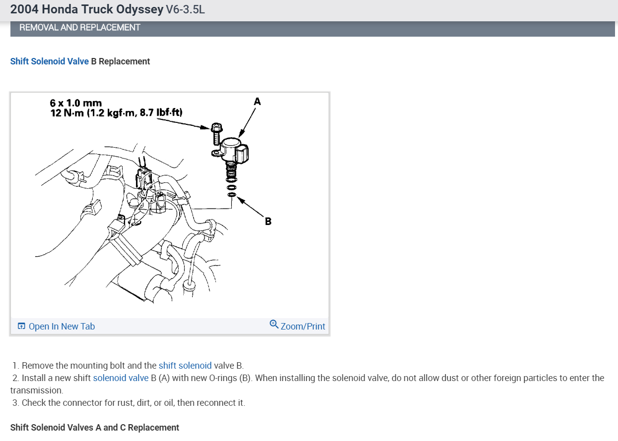

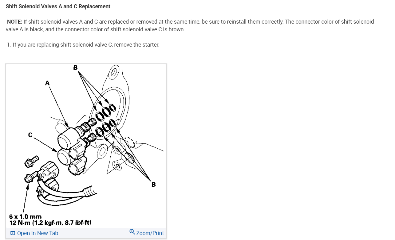

Hey LON1952,
Yes you need this solenoid to work. I found the locations for you in the diagram below. Check out the diagrams (Below). Please let us know if you need anything else to get the problem fixed.
