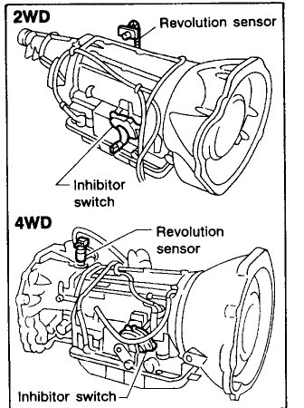

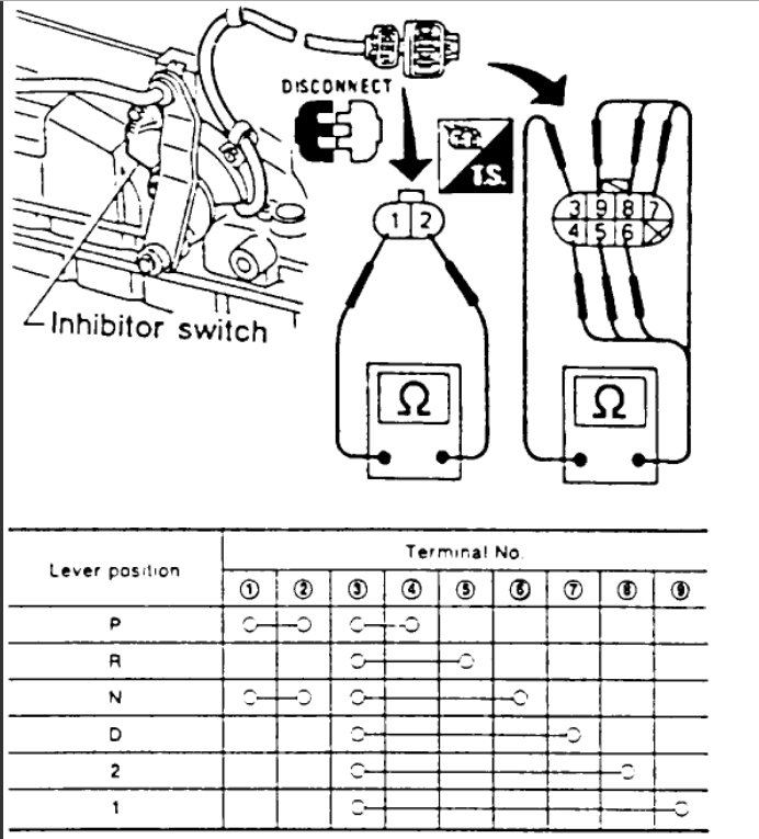

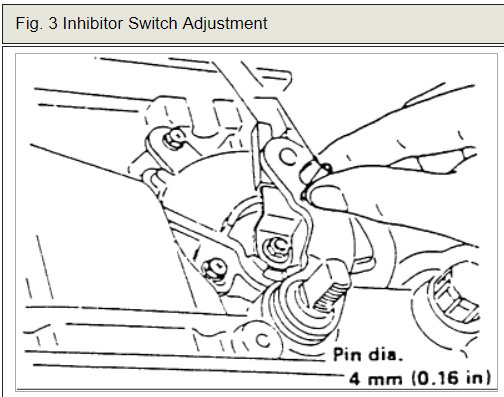

Yes, it sounds like your transmission range sensor has gone out. Here is a guide and the sensor location so you can confirm the issue:
https://www.2carpros.com/articles/how-a-neutral-safety-switch-works
May 21, 2018 at 10:41 AM
SILASLOPEZ18
  • 4 POSTS
I am not sure what that is but I will try. It went from one night to next morning not working did not even feel it go out or anything. The "P" "D" "1" and "2" all work except "R" (reverse).
May 21, 2018 at 8:47 PM
Yes, it is going to be the transmission range sensor or a reverse shift solenoid. Lets check the easier part first. ;)

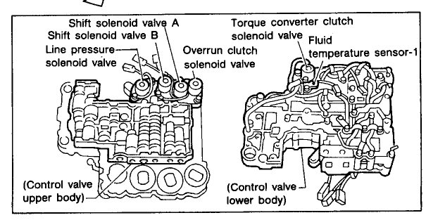

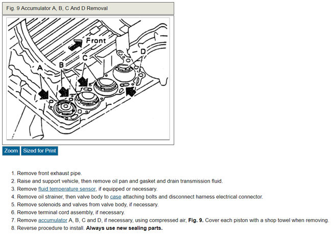

The reverse lights work. Could it be a latch in the shift stick (automatic P R D 12)?
May 24, 2018 at 6:44 PM

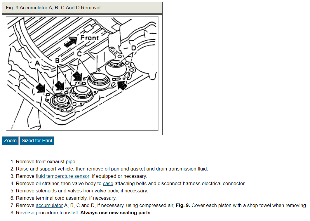

Yes, that is where I was headed next. Here is a diagrams to show you what the shift solenoid are and the turbine speed sensor.

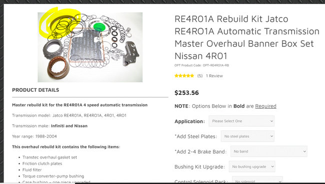

Next, if you decide to replace the transmission, you can get remanufactured transmissions from a parts store. I just checked AutoZone and they have three or four to pick from. They aren't cheap, but if you get one that is bad, they normally will pay the additional labor cost.

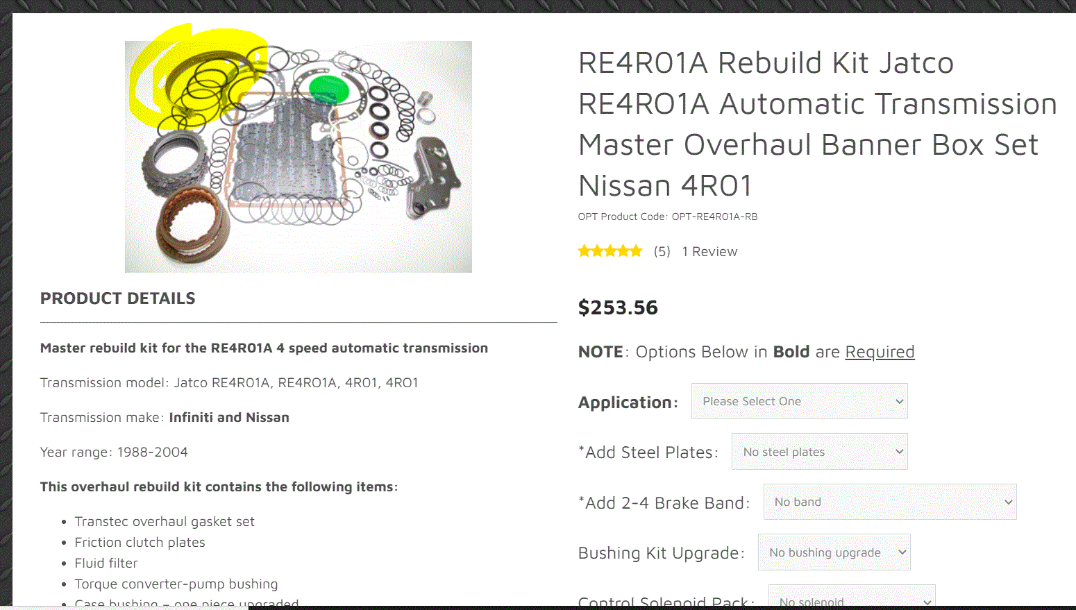

As far as parts, I found complete rebuild kits online. If you look at the pic below, it shows a kit and I highlighted the band in question. Here is the link:
https://www.oregonperformancetransmission.com/product/OPT-RE4R01A-RB.html
Again, confirm this will work for your vehicle, but I suspect it will.
