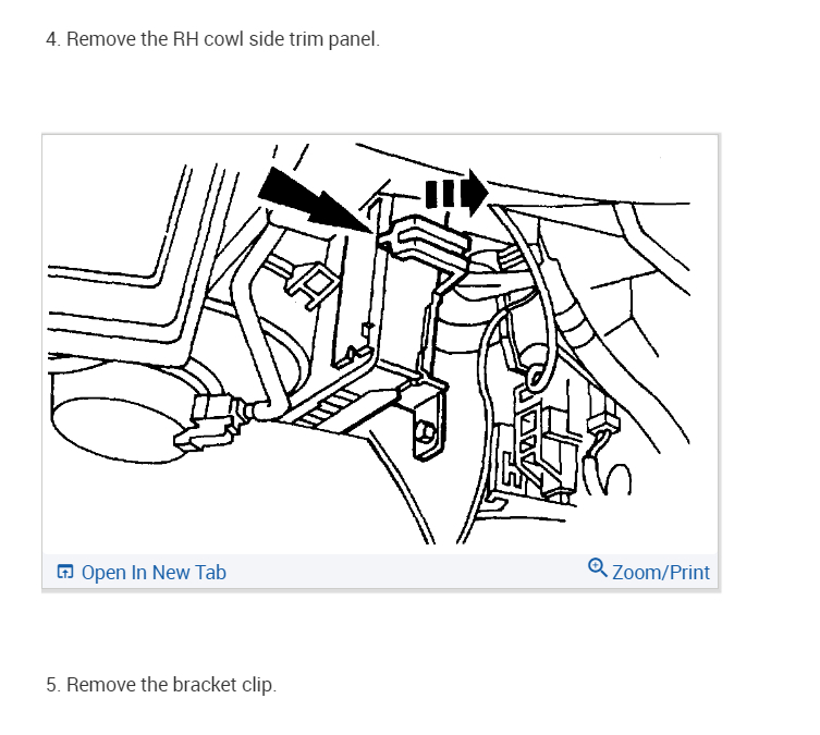

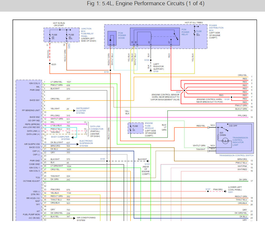

Yep, we should get it running so you can get top dollar for it, it sounds like the PCM has failed but I have found the wiring diagrams so you can check it out.

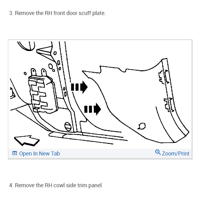

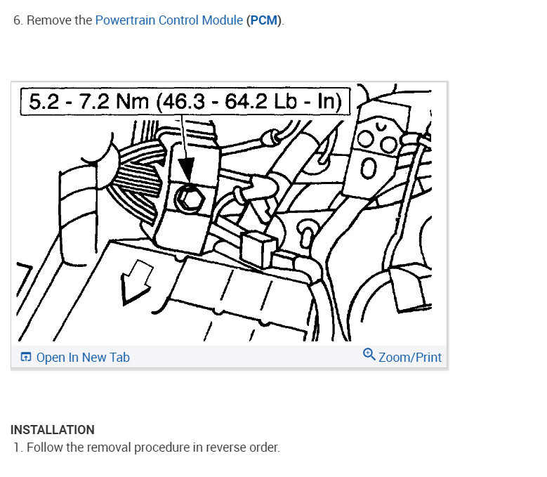

Here is a guide to help you check the wiring and connections:

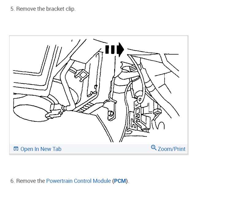

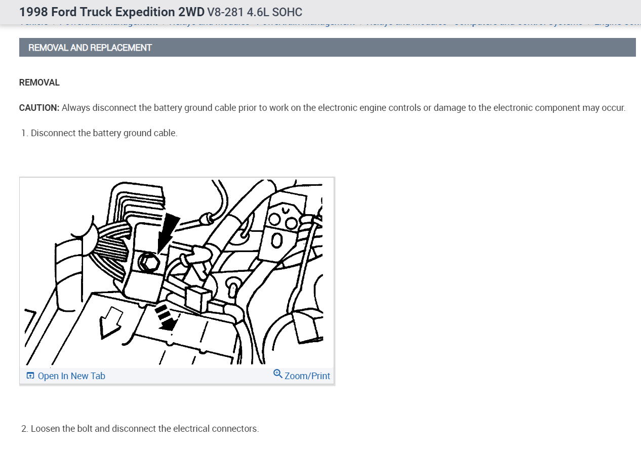

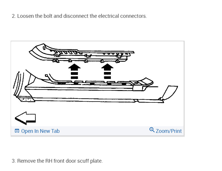

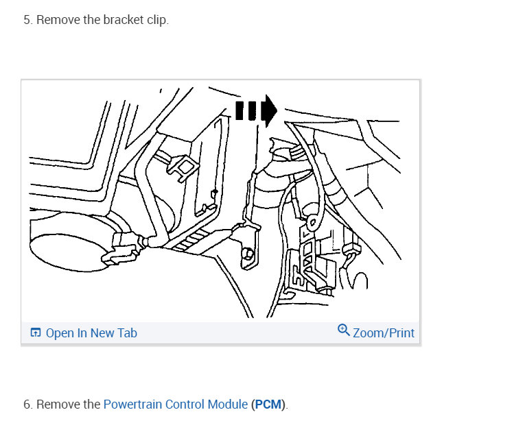

Here is how to change out the PCM in case you need it as well. BTW the PCM is plug and play, no programming is needed. Check out the images (below). Please let us know what you find. We are interested to see what it is.
Jan 29, 2023 at 1:05 PM

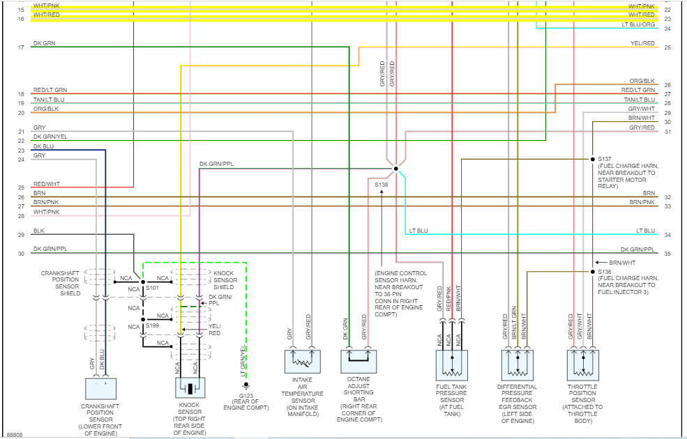

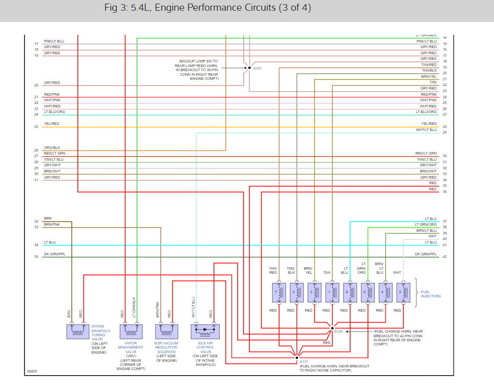

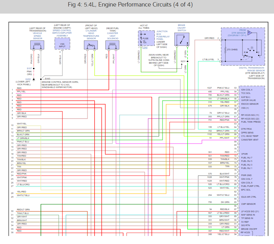

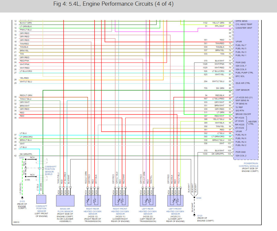

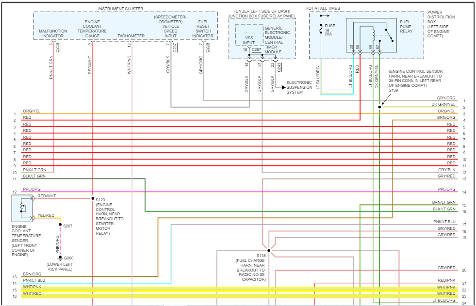

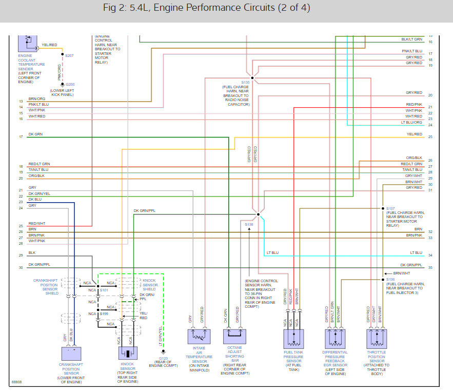

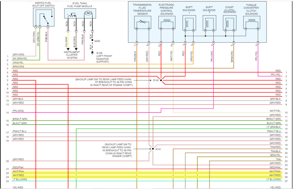

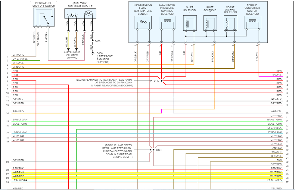

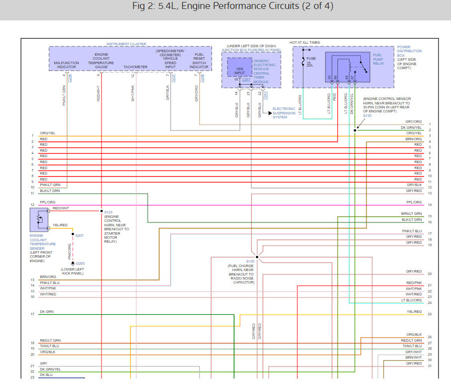

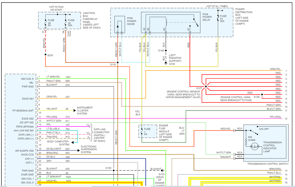

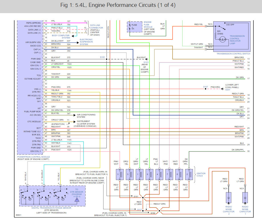

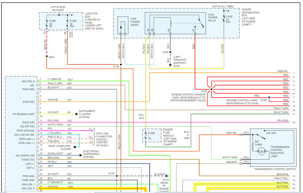

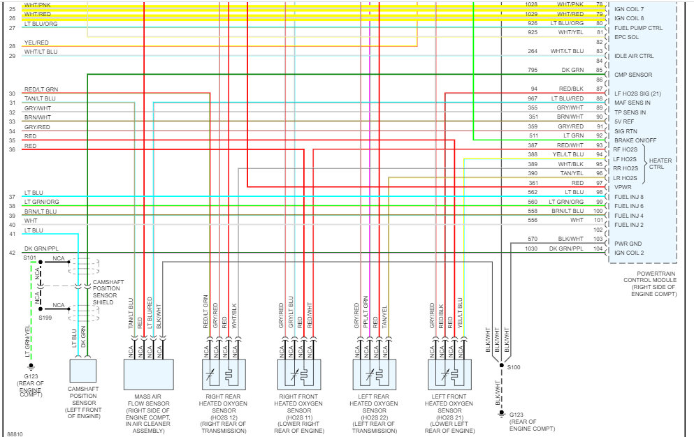

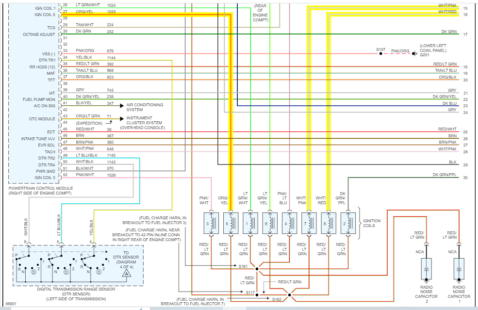

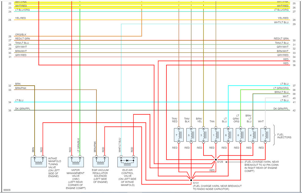

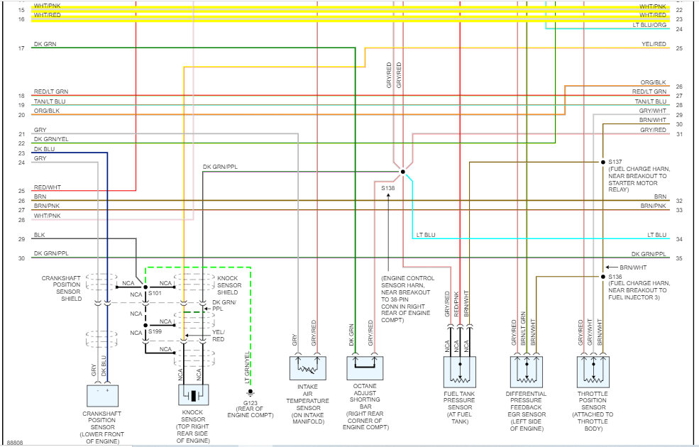

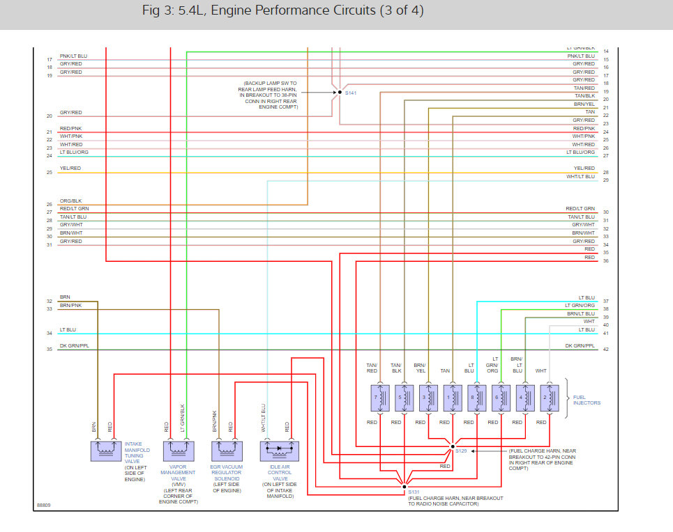

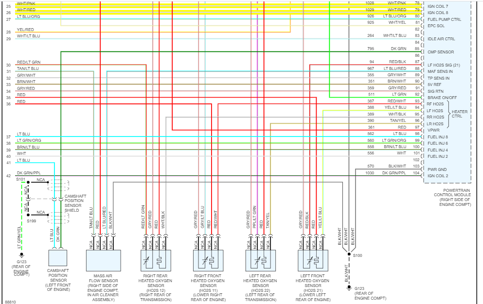

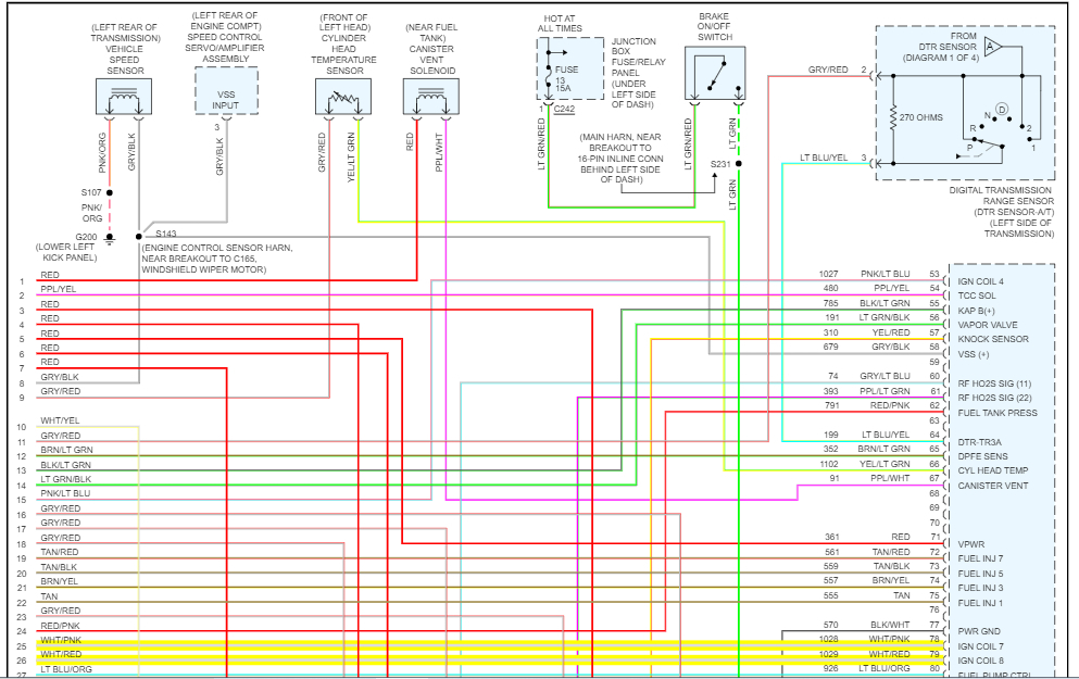

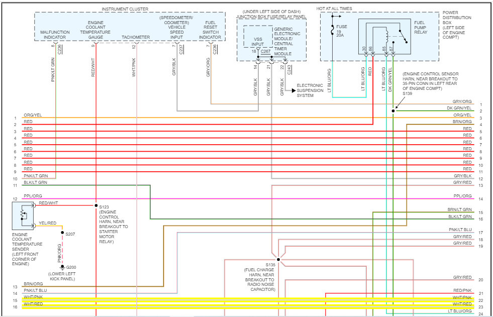

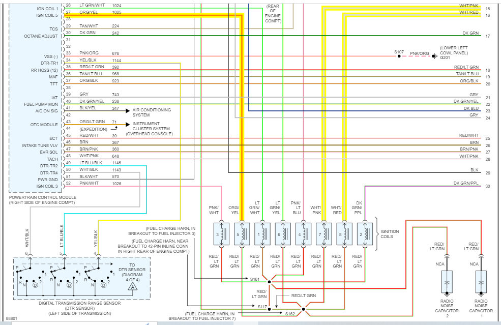

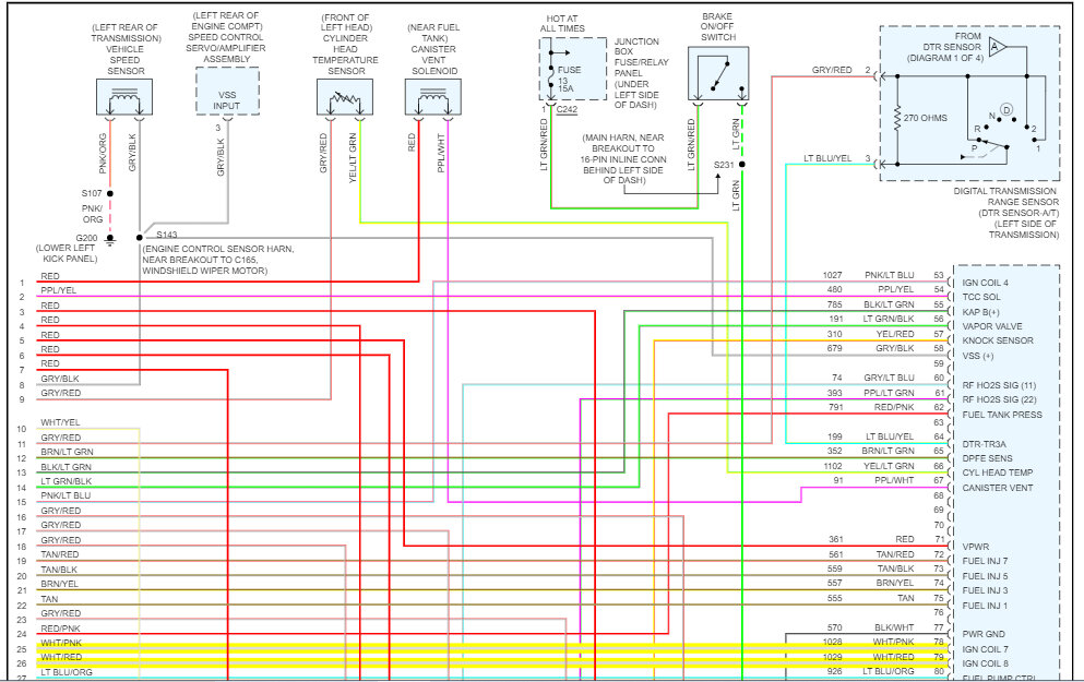

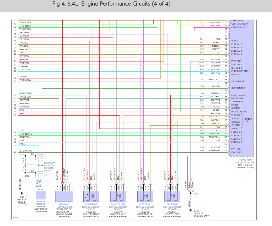

The ignition coils receive power from the same location. However, each coil has a separate ground path provided by the PCM.
I attached the entire powertrain wiring schematic below for you. I highlighted the ground wires for the affected coils. Since the vehicle sat unused for a year, I have a feeling a mouse got at the wiring.
Take a look through the schematic and let me know if it helps.
Take care and let me know what you find,

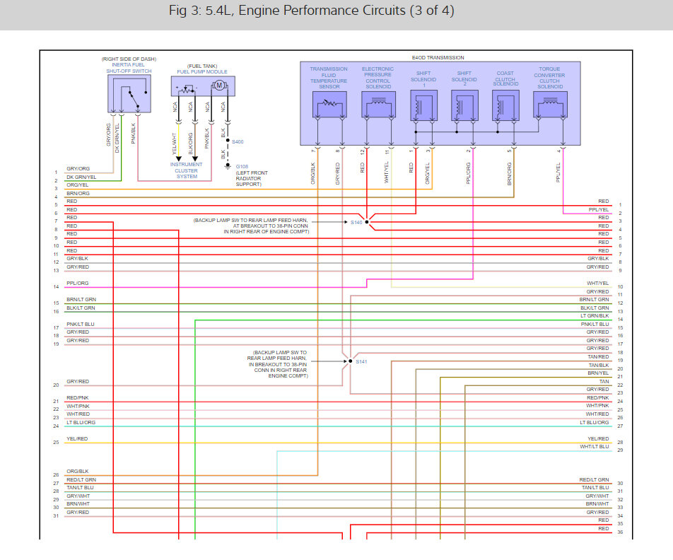

See pics below. Note: The schematic is 4 pages long. I had to cut each page in half to make it readable for you. I did overlap them so you can follow from one to the next. With that in mind, in order, every two pics below equals one page from the manual.
