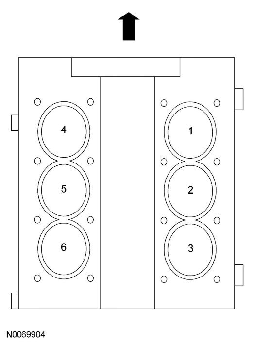

I need the location of each cylinder.

This is the layout on the 3.0. 1-2-3 is the right side 4-5-6 are the left side.
Image (Click to enlarge)
