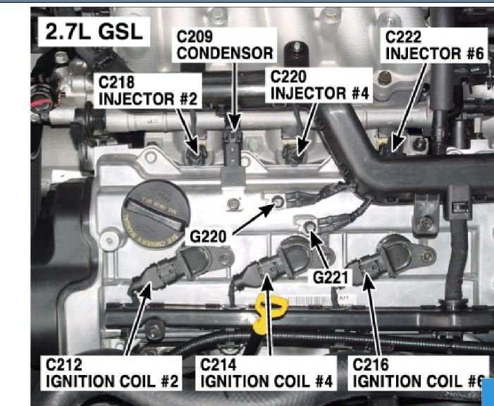

I attached the cylinder order for you.
The front bank is 2-4-6.
As far as the misfire, make sure you test the compression.
