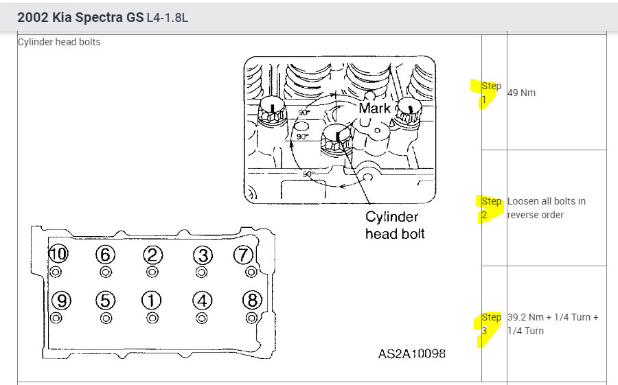

I attached the torque specs below related to the cylinder head. Make sure to follow the sequence indicated. Also, the torque should be done in three steps. See the area that I highlighted.
See pic below.
