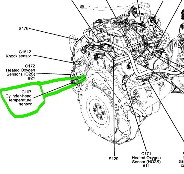

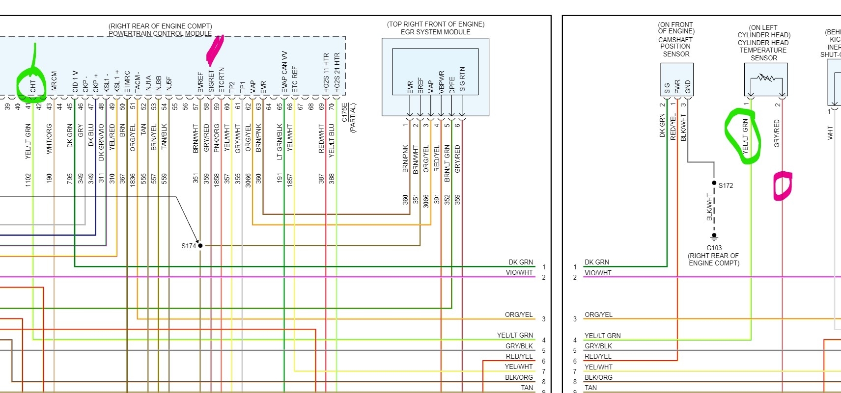

We replaced the cylinder head temperature sensor, plugs and wires, PCV valve, oil pressure sensor/switch, upper radiator hose and the temp gauge is still pegging out in the
red but no check engine light at all and it’s not overheating because there is no water anywhere on the ground or under the hood. would the codes P1285 and P1299 be there without the check engine light on and how do
We clear them to see if the computer will reset. I need to know ASAP, please.
