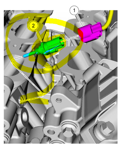

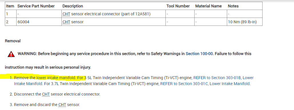

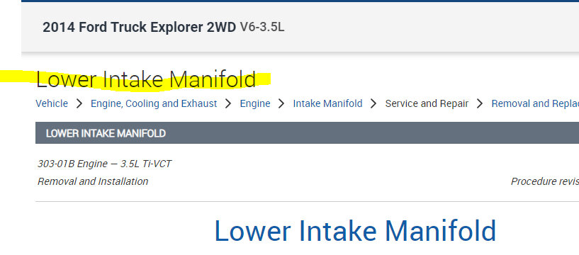

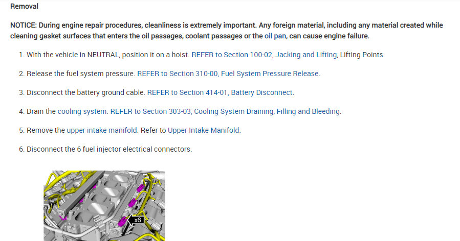

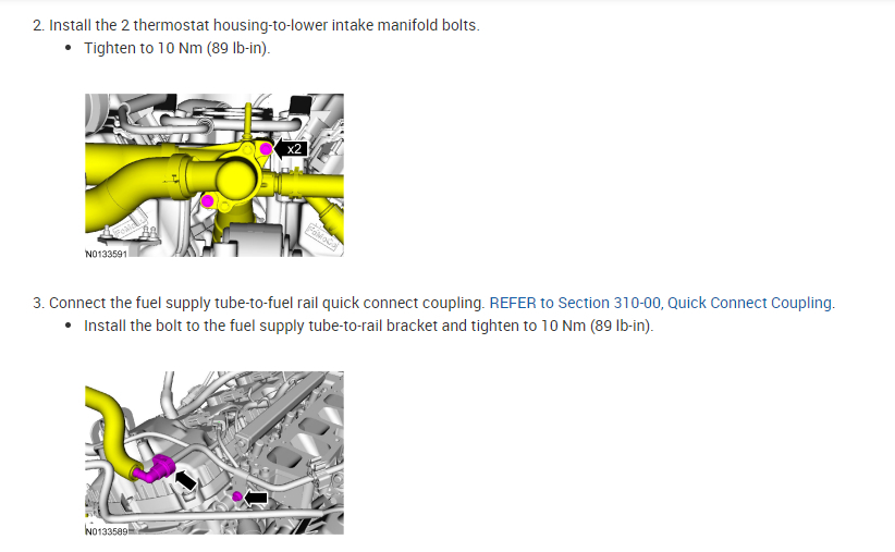

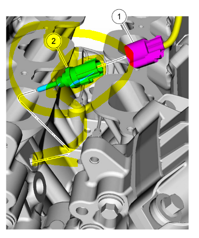

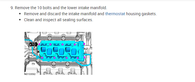

The cylinder head temperature sensor (CHT) is located under the intake manifold. It requires the removal of the manifold. Basically, a simple job has turned into a major job.

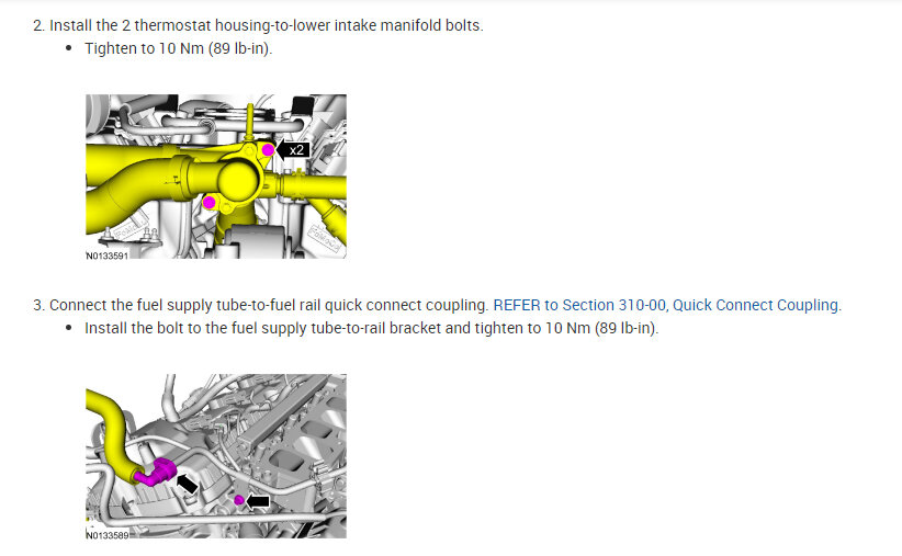

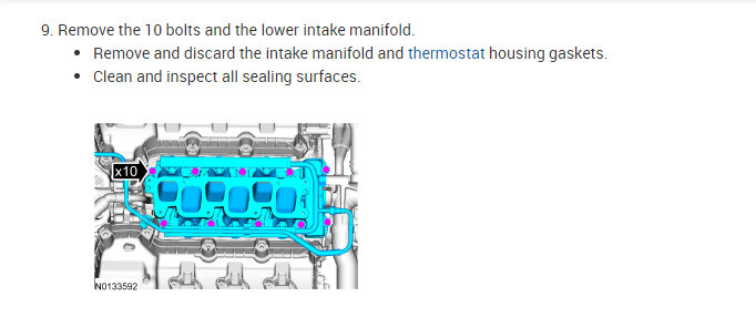

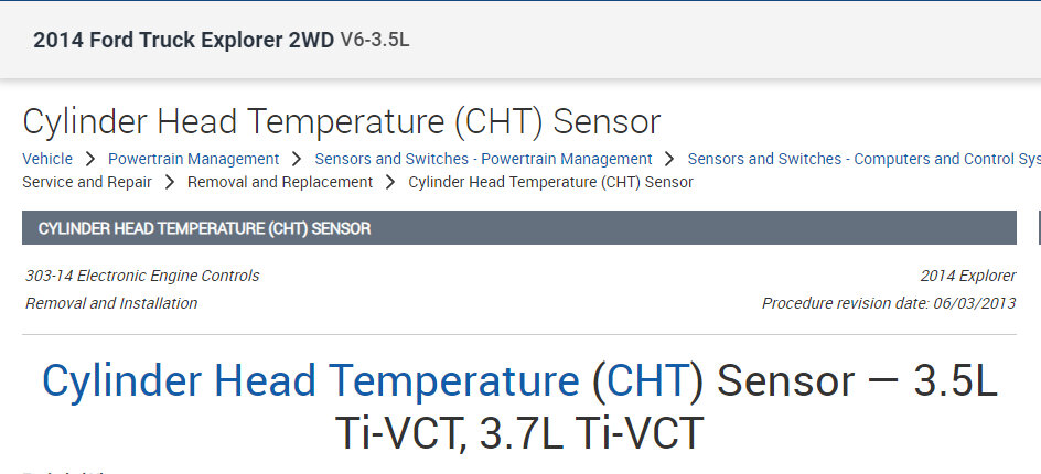

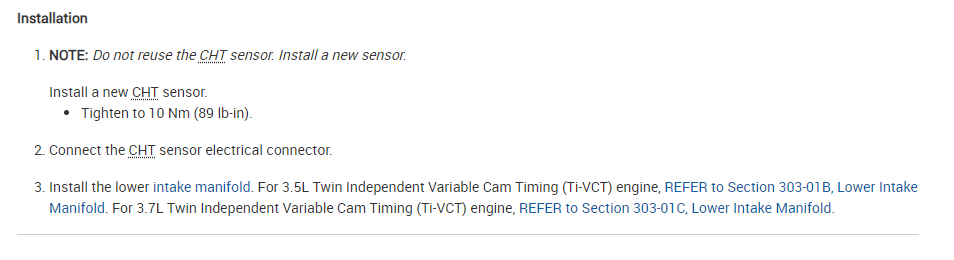

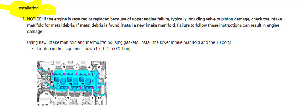

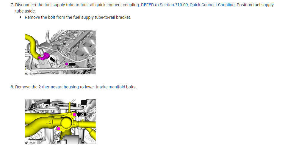

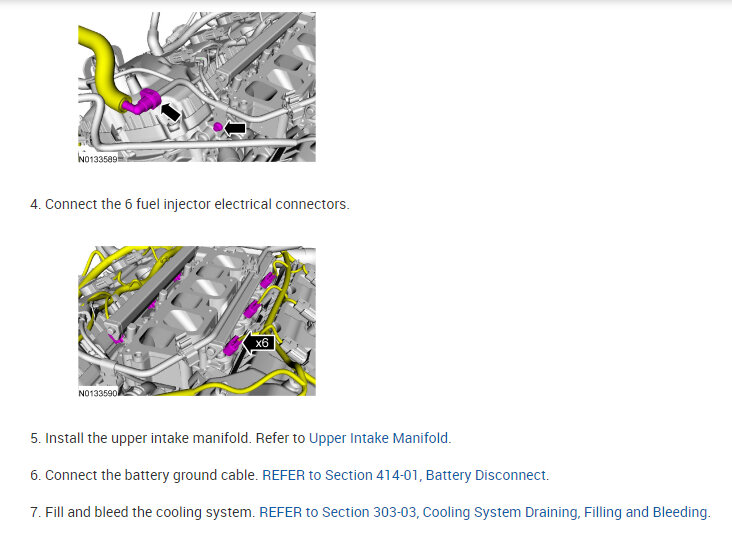

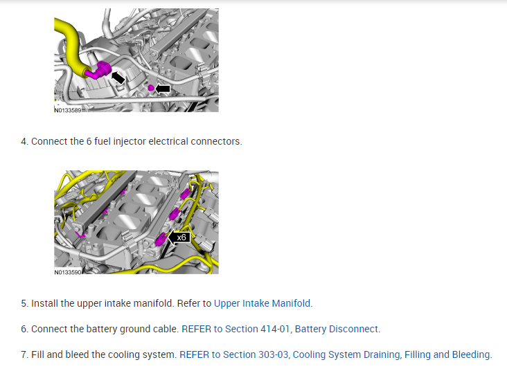

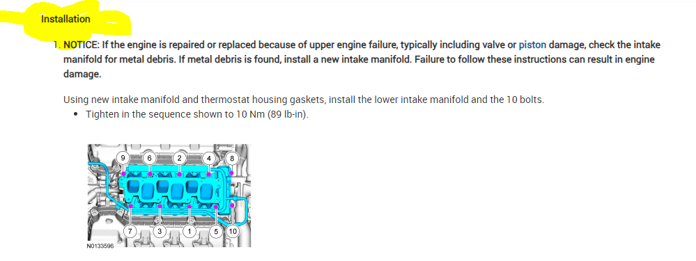

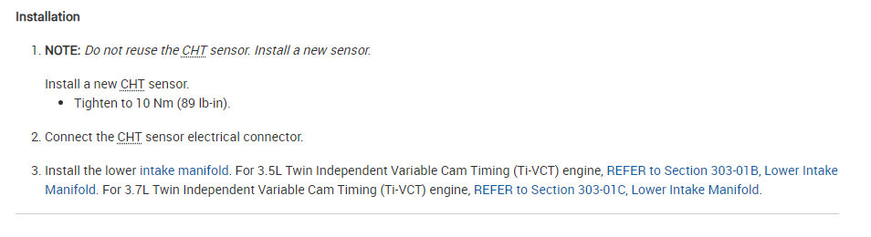

I attached the directions below. Pica 1-4 are for the sensor once the manifold is removed. The remaining pictures are for the removal of the lower manifold. Take a look and let me know if you are comfortable performing them or if you have other questions.
See pics below.
