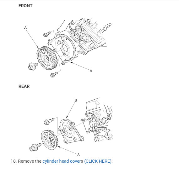

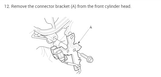

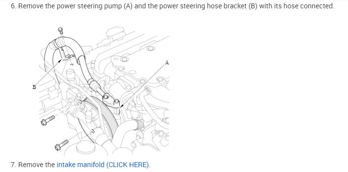

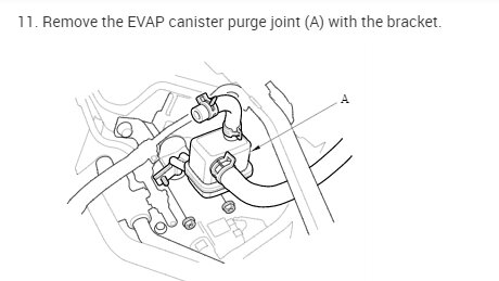

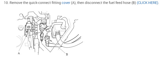

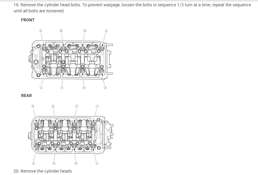

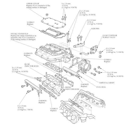

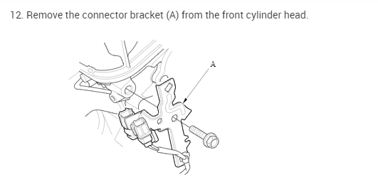

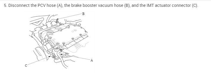

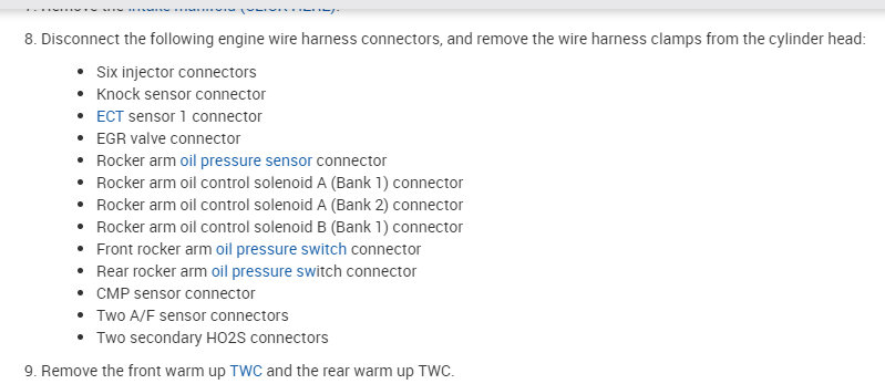

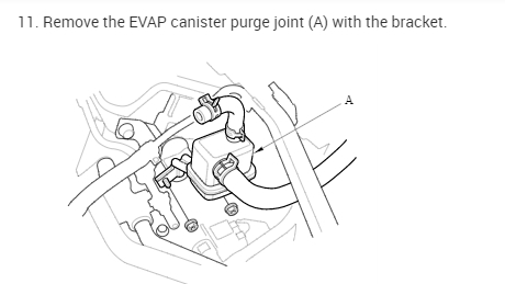

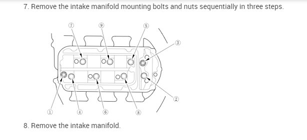

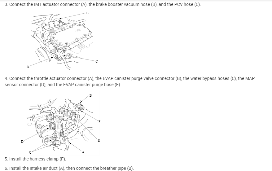

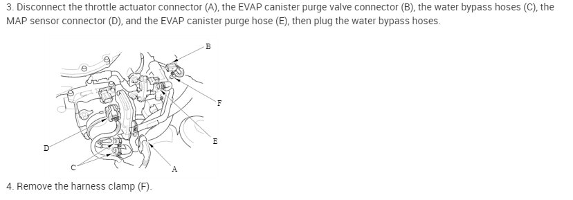

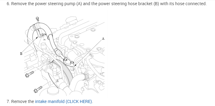

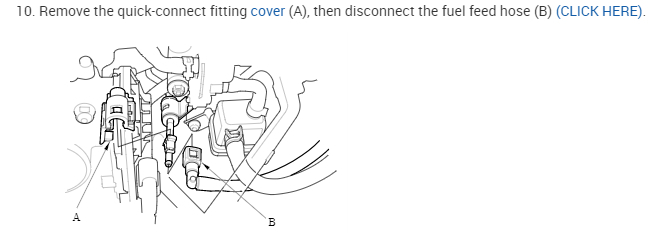

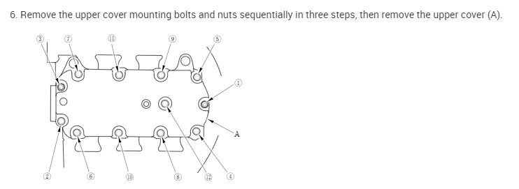

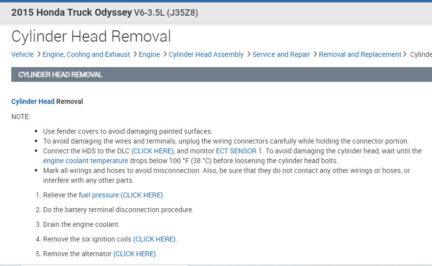

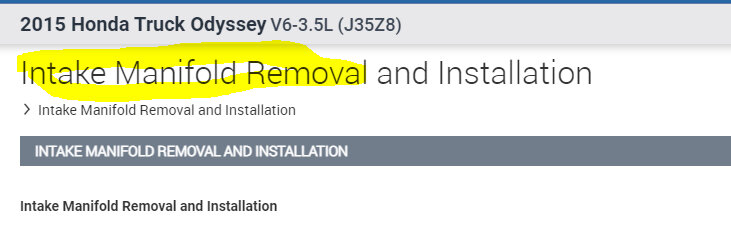

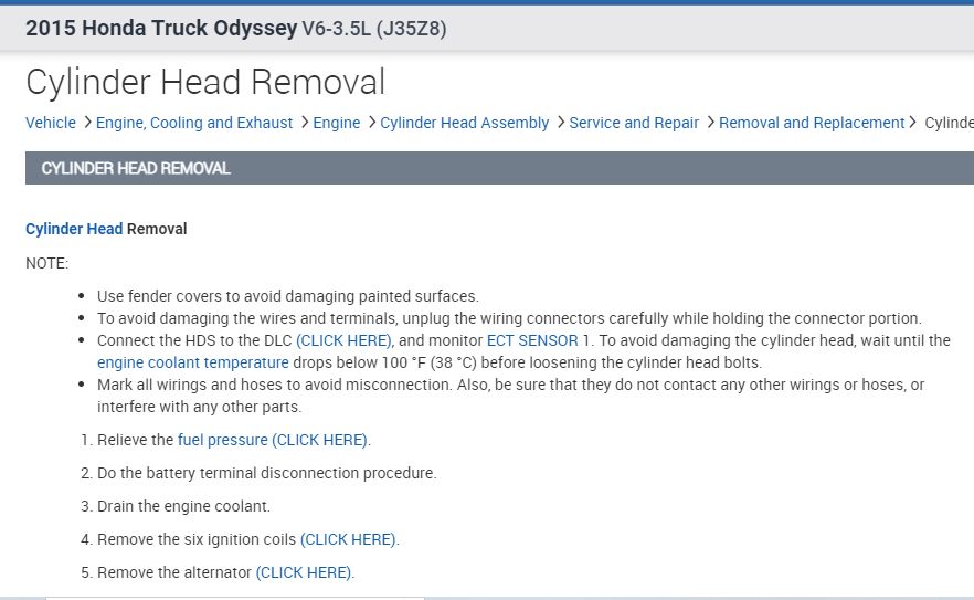

When you remove the head, make sure the pistons were not damaged. Check for cracks or anything that can prevent them from functioning as designed.

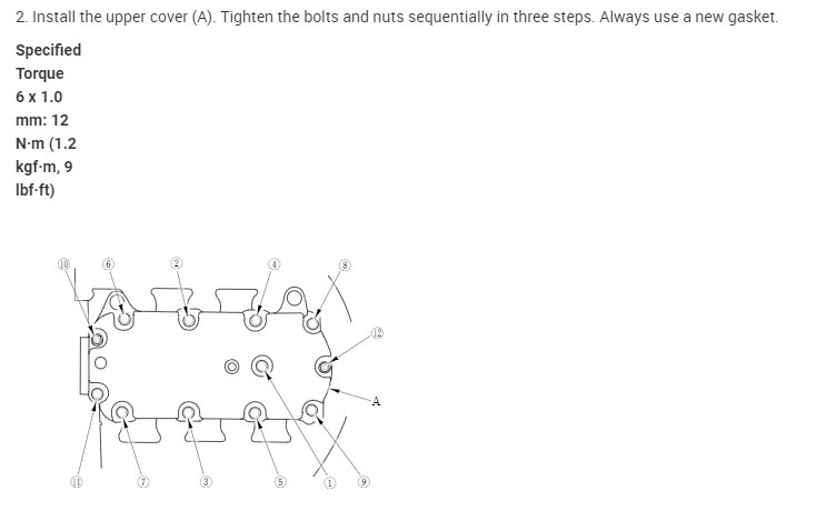

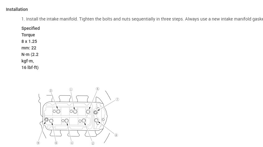

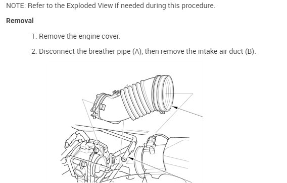

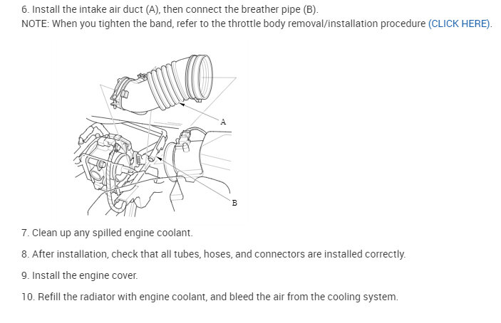

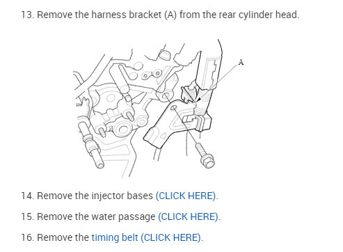

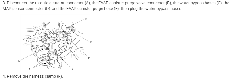

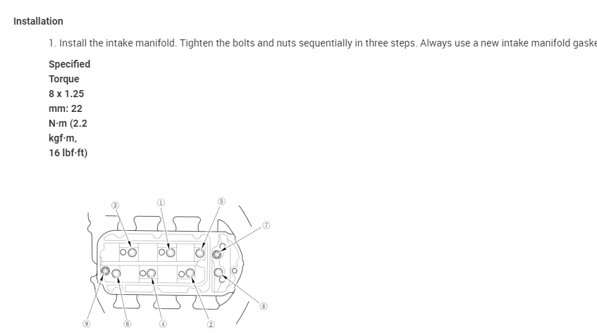

As far as the directions, I attached them below. You need to remove both the upper and lower intake manifolds. I added that in where it was needed.
See pics below. Also, let me know if you need help with the timing belt.
