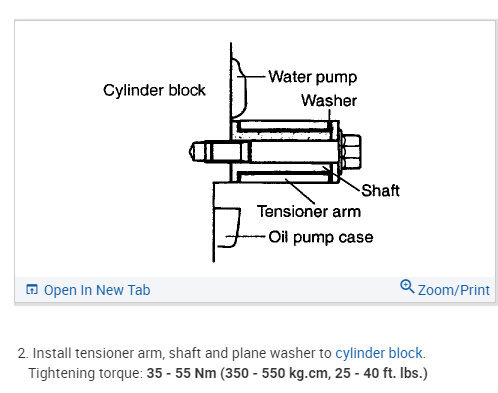

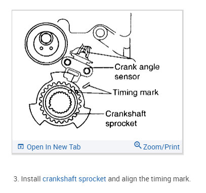

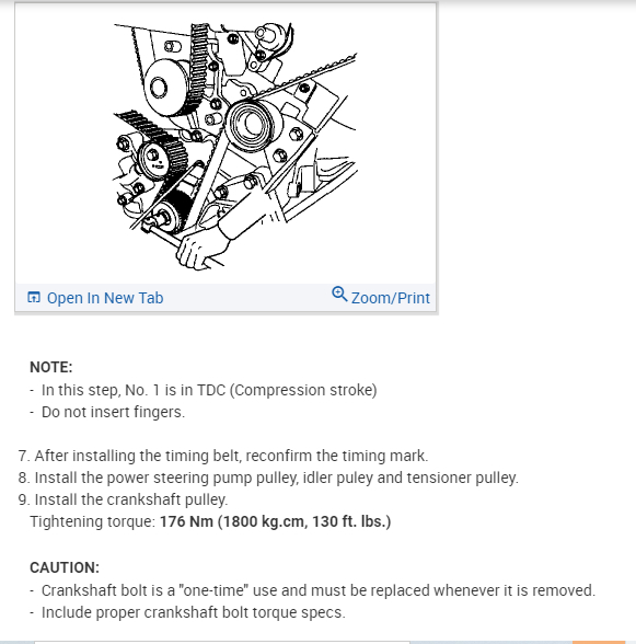

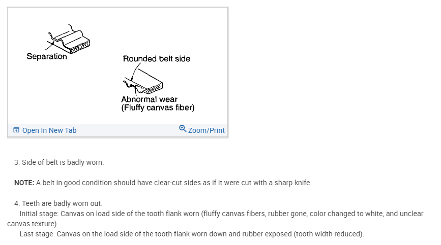

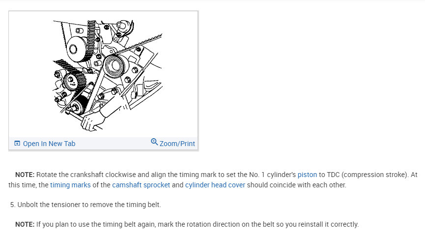

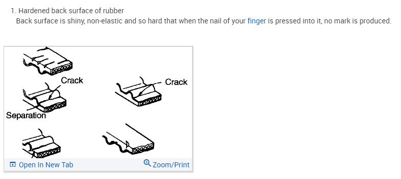

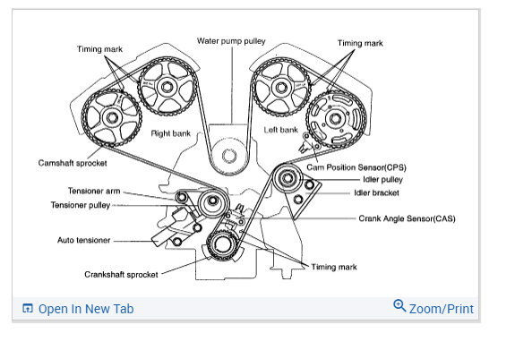

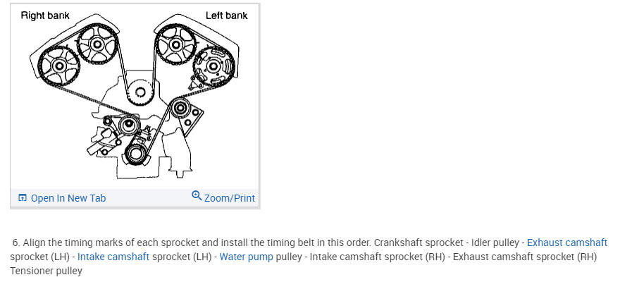

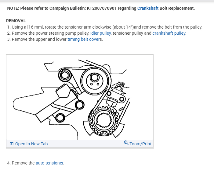

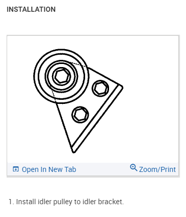

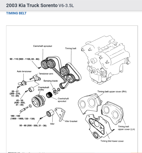

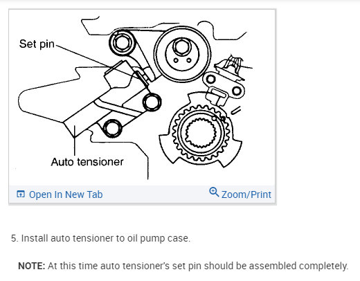

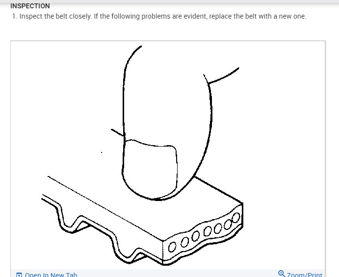

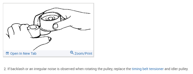

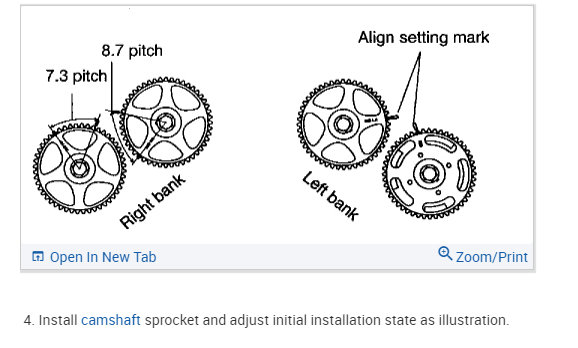

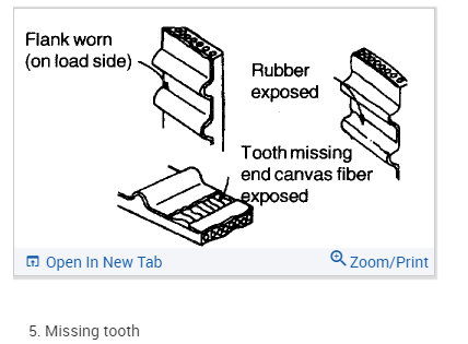

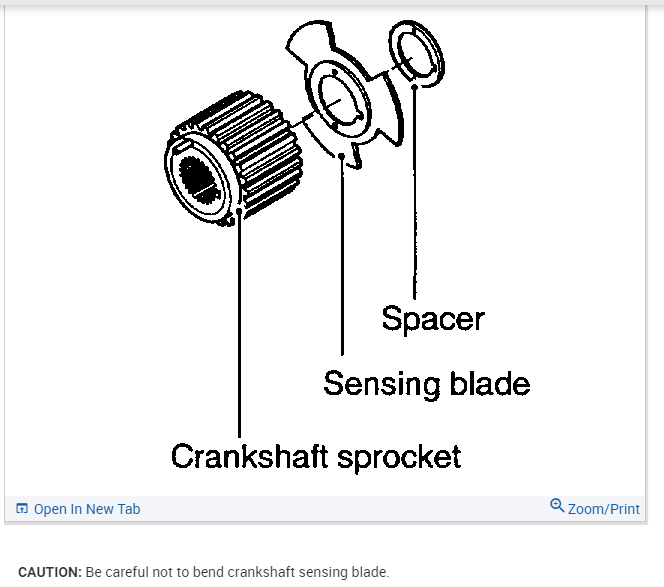

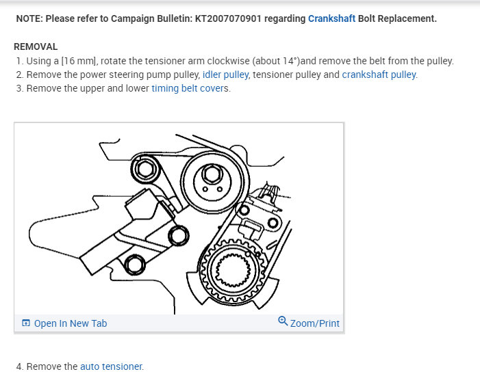

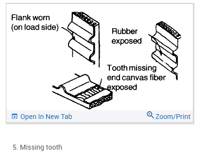

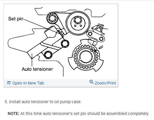

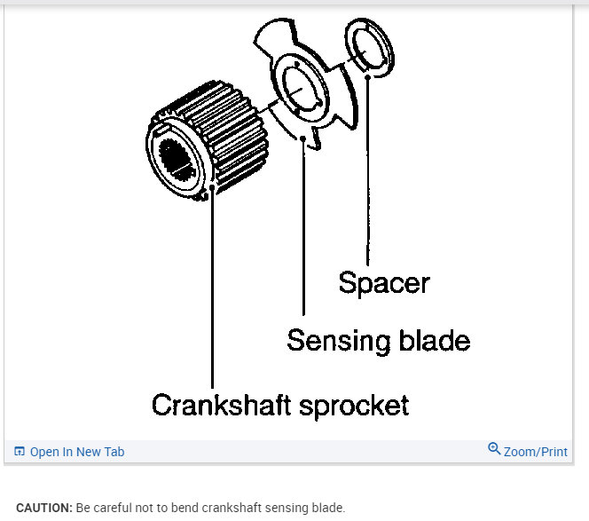

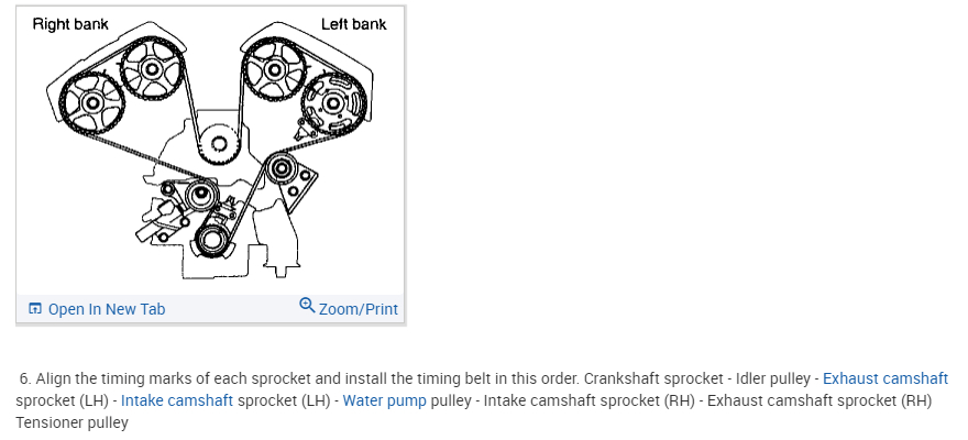

It sounds like the automatic tensioner isn't released. Did you pull the retaining pin on it?
Do me a favor. I attached the directions for the removal and replacement of the timing belt. Take a look through them to see if anything was missed.
Let me know what you find or if you have questions.
See pics below.
