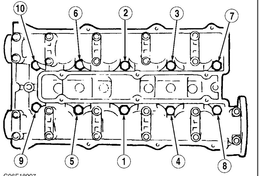

Need to fined out what torque is on head bolts.
Dec 31, 2015 at 5:32 AM
HMAC300
  • 48,601 POSTS

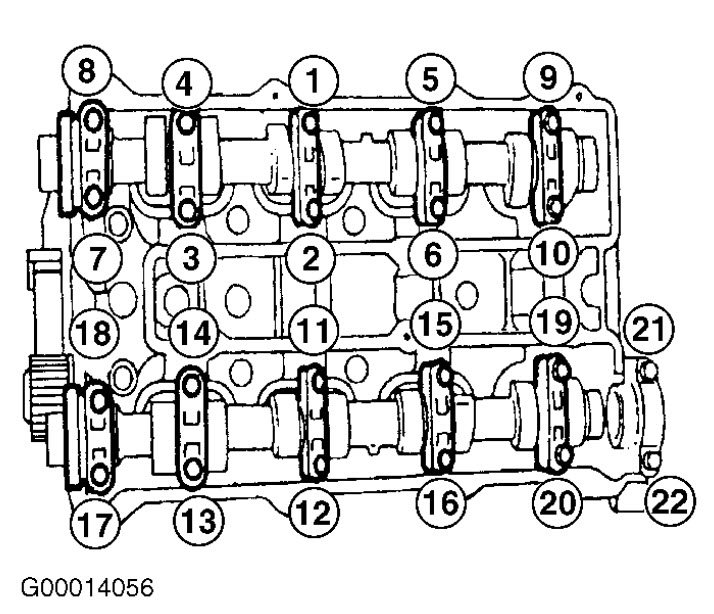

if camshafts were removed 16 ft lbs in sequence cylinder head bolts 62 ft lbs in 3 equal torques in sequence. Check out the images (below). Let us know if you need anything else.
Dec 31, 2015 at 6:19 AM

i need the head bolt torque specifications for a 2000 kia sportage 2.0 liter engine as well as the timing marks for the same vehicle
Nov 16, 2019 at 2:45 PM (Merged)
BLUELIGHTNIN6
  • 16,542 POSTS
https://www.2carpros.com/forum/automotive_pictures/261618_Noname_1037.jpg
https://www.2carpros.com/forum/automotive_pictures/261618_Noname2_294.jpg
https://www.2carpros.com/forum/automotive_pictures/261618_Noname3_111.jpg
https://www.2carpros.com/forum/automotive_pictures/261618_Noname4_57.jpg

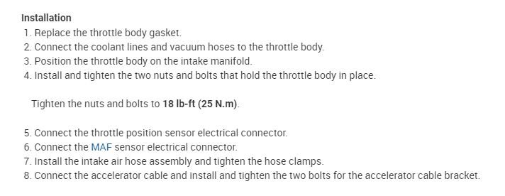

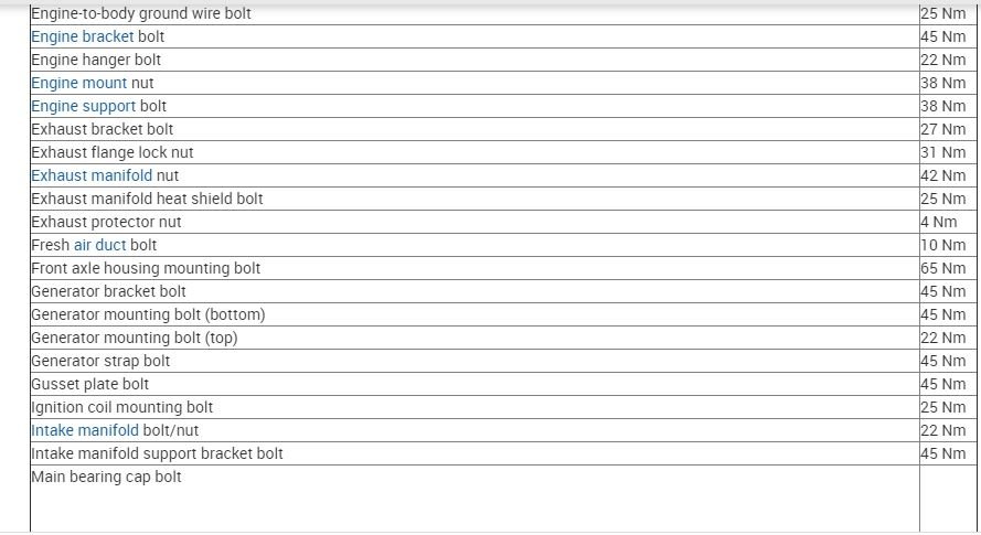

Putting head back on need torque values intake to head and intake to throttle body.
Oct 10, 2020 at 9:40 AM (Merged)
Good morning,
I attached the torques for you below. let us know if you need any other information. Check out the diagrams (Below). Please let us know if you need anything else to get the problem fixed.
