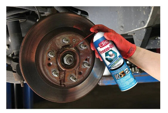

I'm sorry to hear you are still dealing with this. It sounds like you've tried a lot of different things. There is one product that may help. It is called Freeze-off. It is made by CRC. I attached a pic below.
It is designed to lower the temp of steel causing it to contract. It has helped me out of a lot of situations. I don't know if it would work for you, but it may be worth trying.
See pic below.
