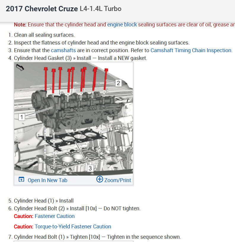

I have the car listed above L with the new version of the 1.4L turbo and can’t find anything reliable with the proper torque specifications on the cylinder head bolts. This is not the 2011-2016 1.4L. There are only 10 head bolts. Any info would be greatly appreciated.
Feb 11, 2025 at 10:30 AM

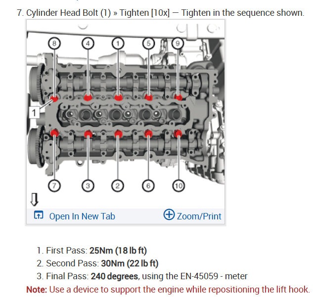

No problem we got you covered, here are the torque specs and tightening sequence, these are toque to yield bolts so you will need new head bolts before you can put it back together. Check out the images (below). Let us know if you need anything else.
