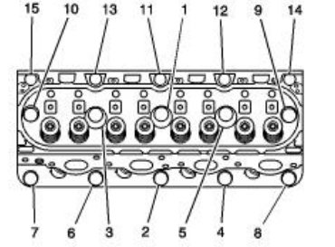

I need to install the head bolts but need to know where the two smaller bolts go.

2003 on 5.3 engines use 10 11mm head bolts which need to be replaced and 5 8mm head bolts which can be reused.

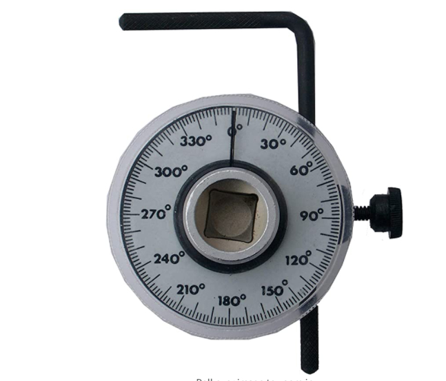

Next 2 steps you will need to use an angle gauge, see image 2
2nd step: (1-10) turn an additional 90 degrees
3rd step: (1-10) turn an additional 70 degrees
8mm bolts, (11-15)
22 ft/lbs, apply liquid Teflon paste or similar sealant to these bolts
See image 1 below for tightening sequence
