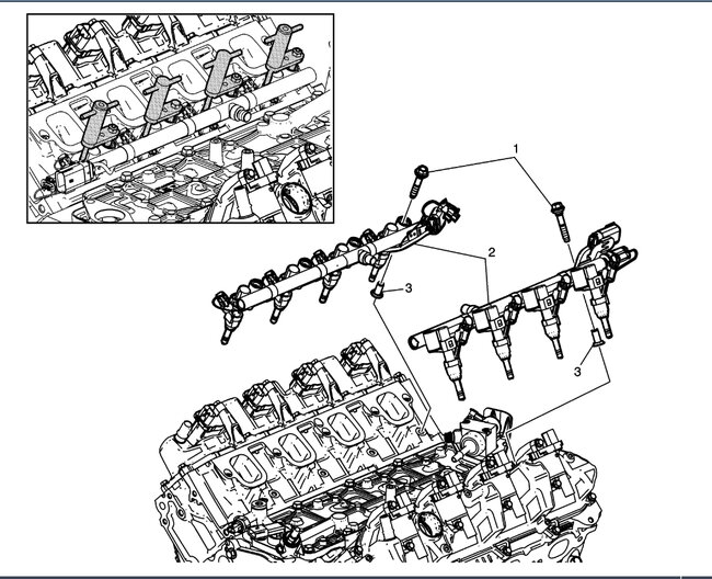

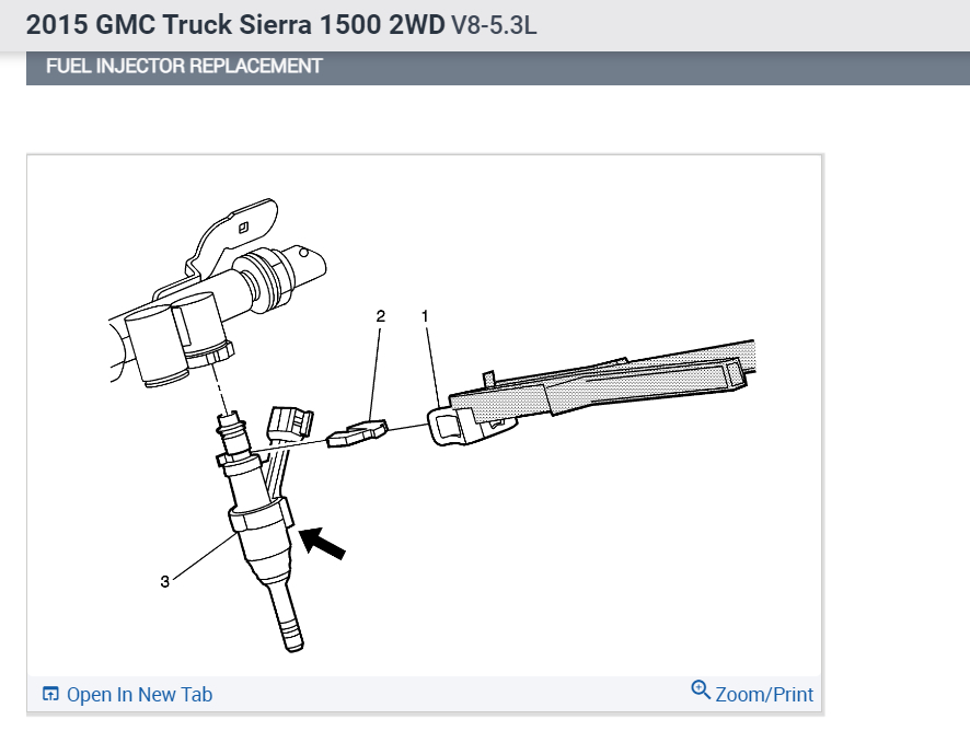

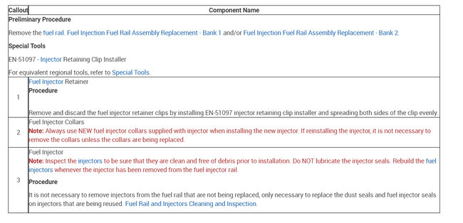

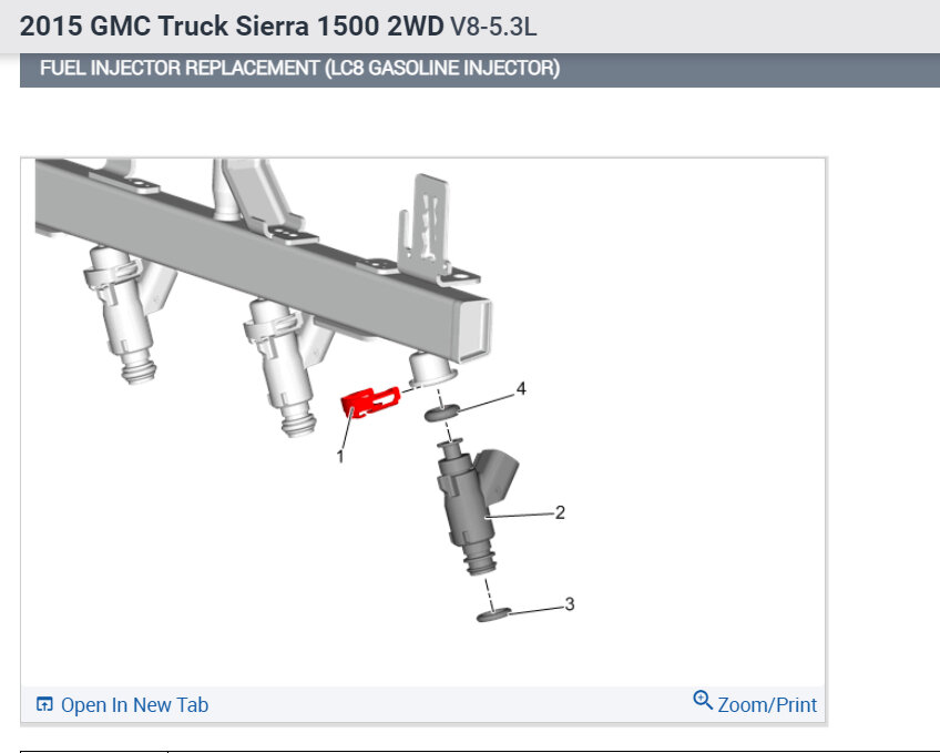

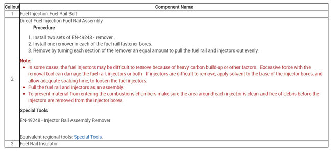

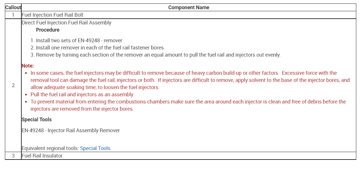

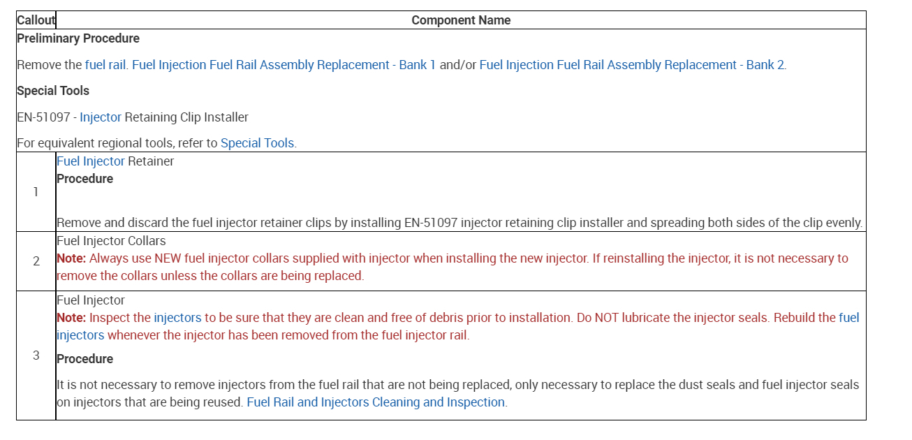

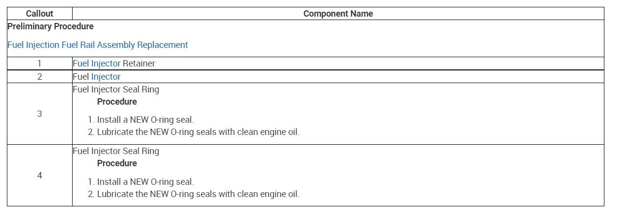

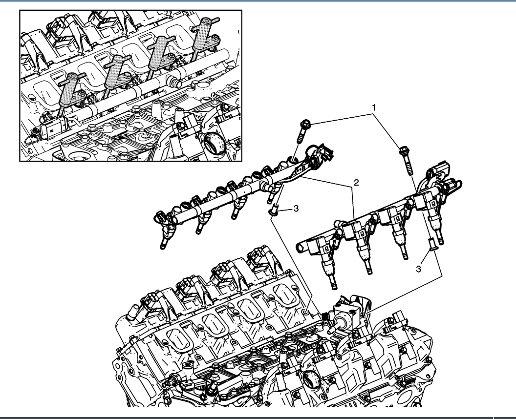

Yep, that was going to be my next suggestion. here is how to change it out, I would use AC Delco parts. Check out the images (below). Please let us know what happens.
Oct 4, 2022 at 2:19 PM
