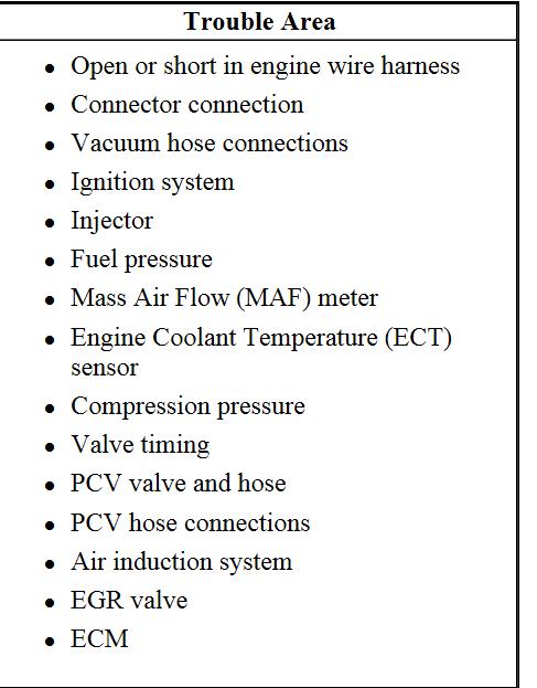

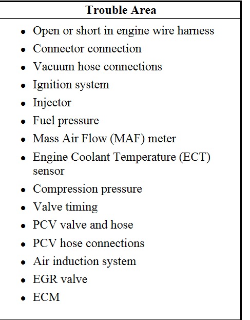

check the injector for resistance it may be leaking or leaning out on propane as it's a gas not a solid. also check compression. Misfires are extremely hard to diagnose and on propane it may be even harder or some type of cylinder leakage that while on fuel is fine but a gas may not be. resistance shold be 11.6-12.4 ohms. Maybe trying some injector cleaner when on gas may straighten it out. also in pic here are causes for your problem.
