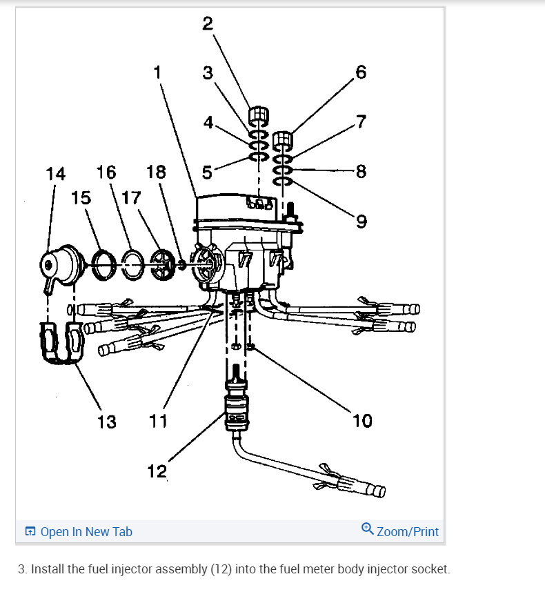

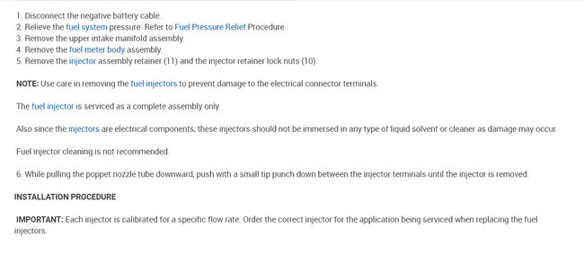

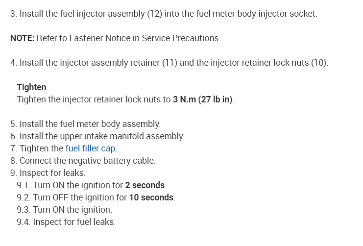

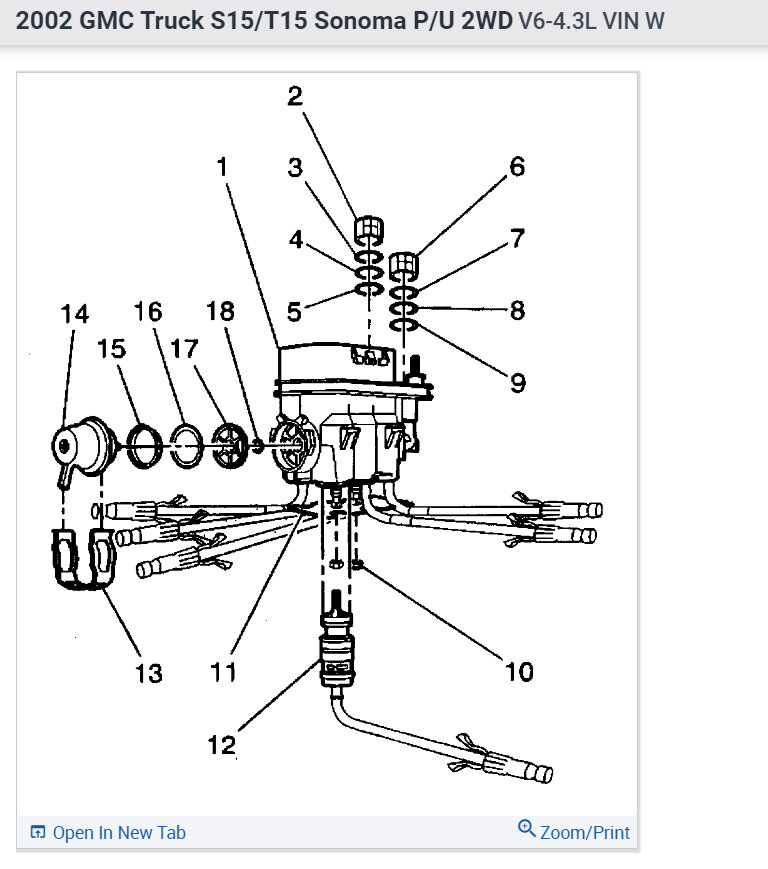

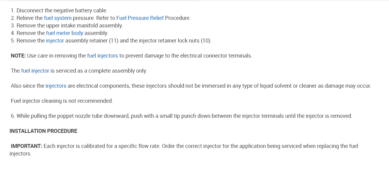

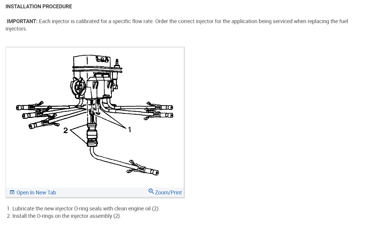

My truck listed above runs and drives fine with the misfire codes it’s throwing, but you can tell at idle it definitely has a miss. has new plugs, wires, injectors, rotor, and cap points cleaned, new MAF and it still has cylinders 3 and 4 misfire. There is no gas or coolant in the oil, not burning any coolant and no oil in coolant. I'm kind of at a loss and don’t know what to do next.
