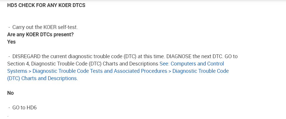

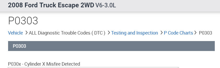

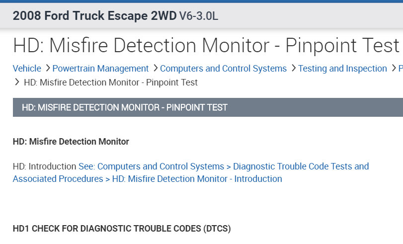

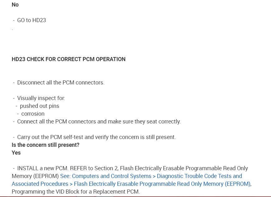

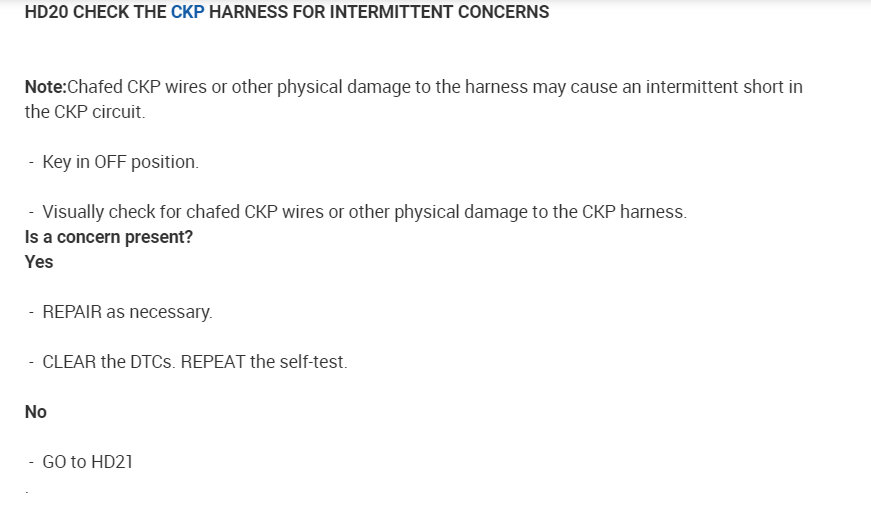

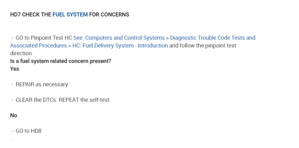

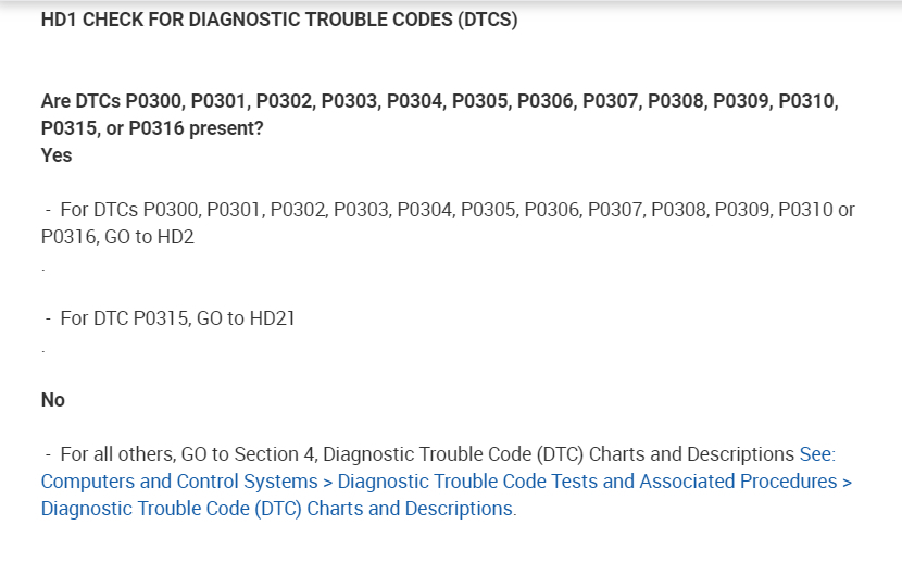

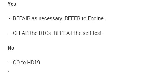

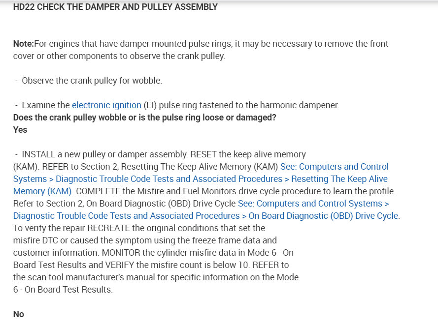

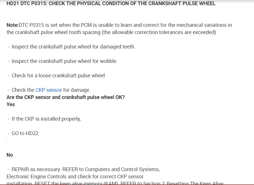

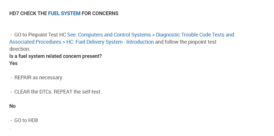

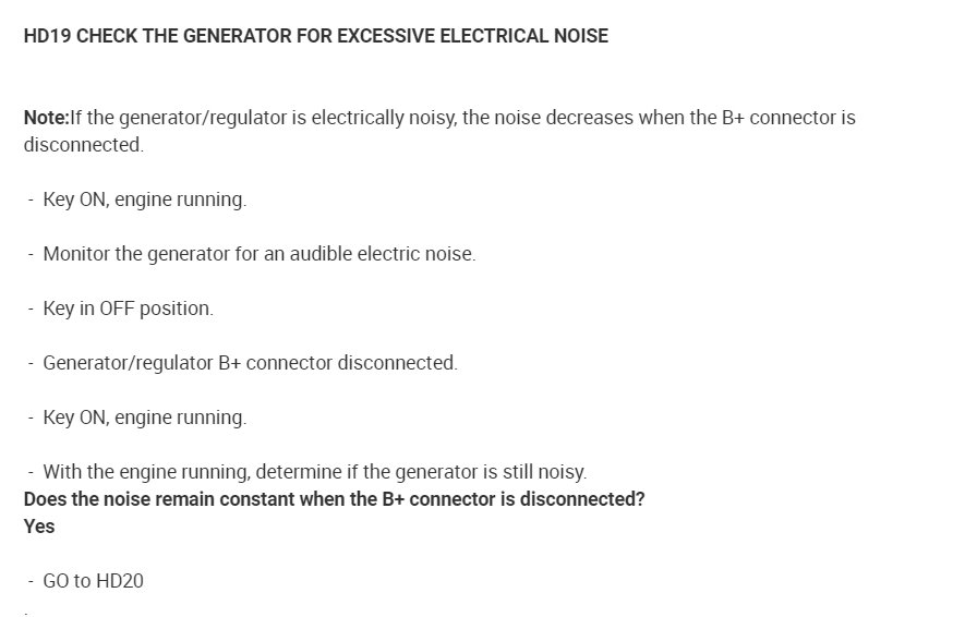

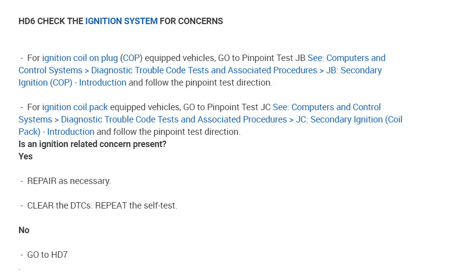

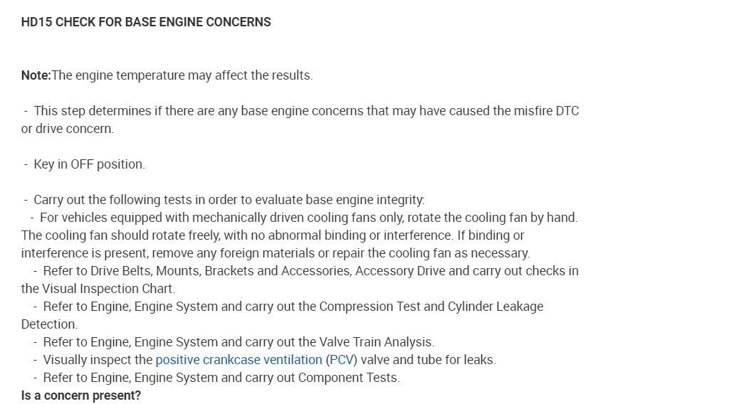

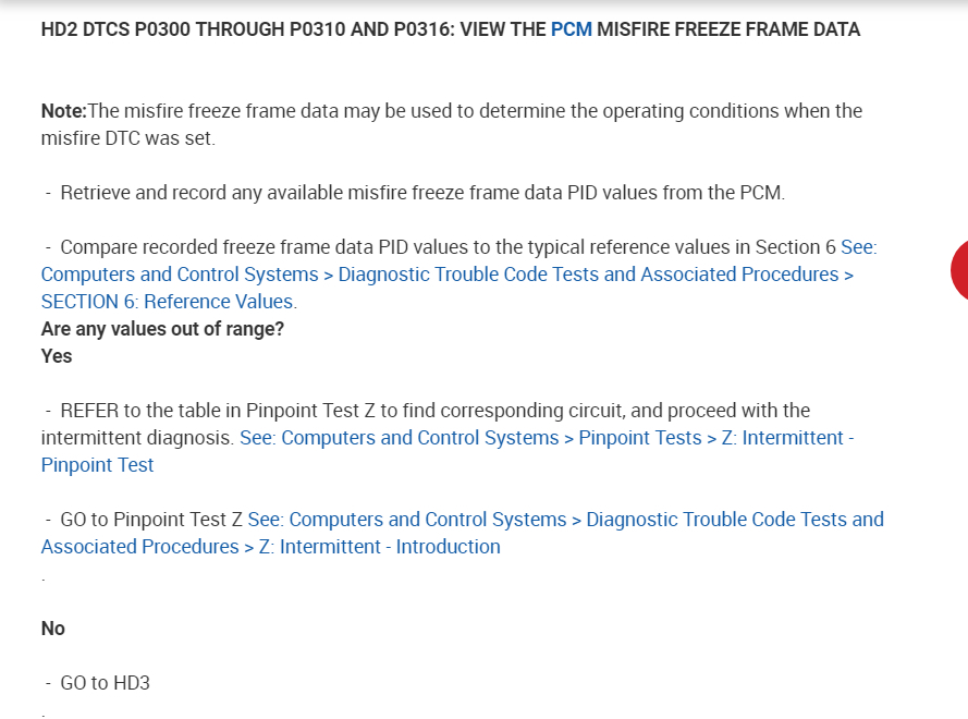

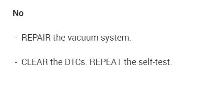

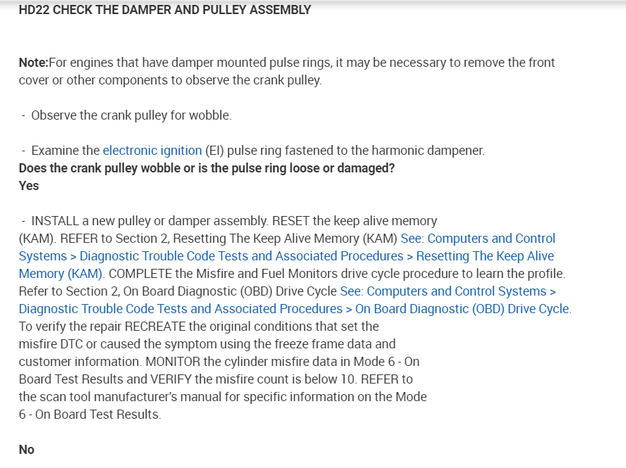

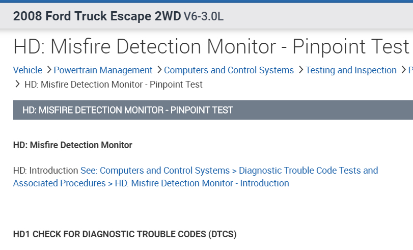

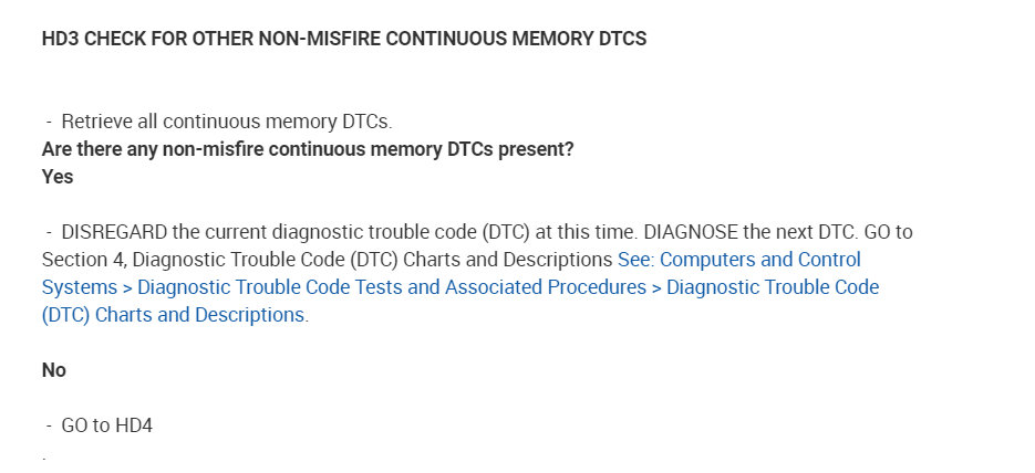

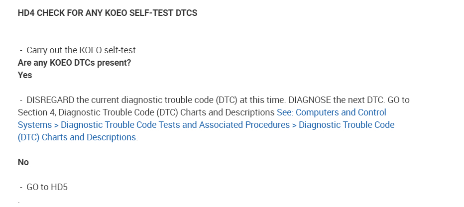

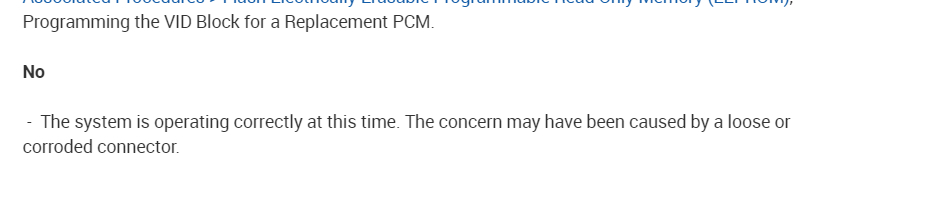

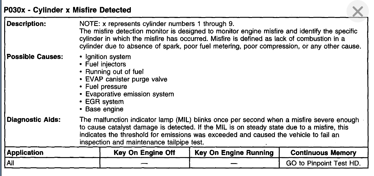

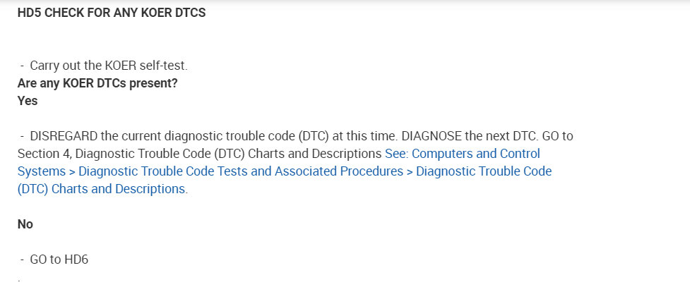

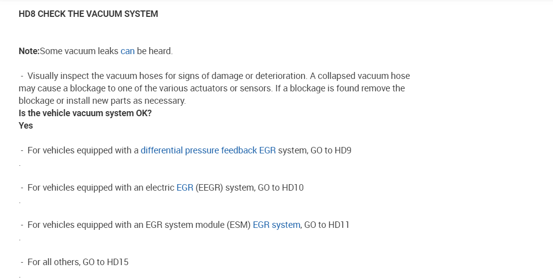

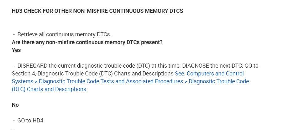

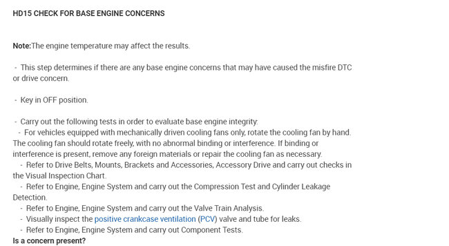

In the diagrams down below I have included the factory diagnostic troubleshooting guide for DTC P0303. Please go through this guide and get back to us with what you are able to find out. The guide is quite comprehensive, so if you come to spot where they ask you to go to to another pinpoint test, just get back to us with the number on this guide and we will shoot that information to you. There's just too much to include it all at once.
Thanks,
Alex
