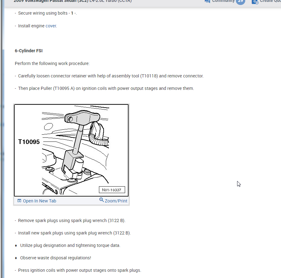

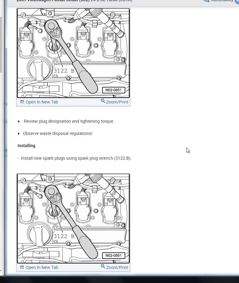

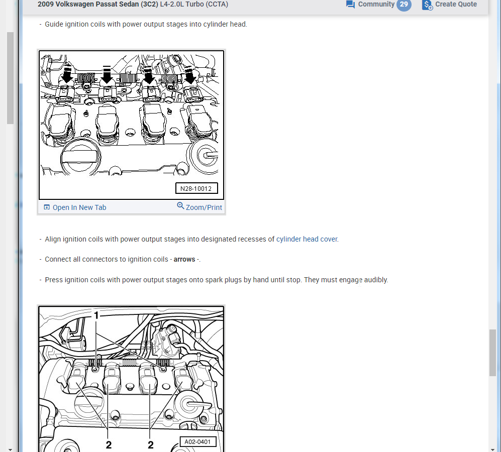

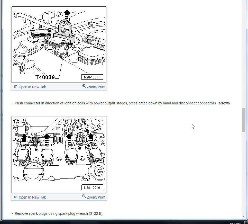

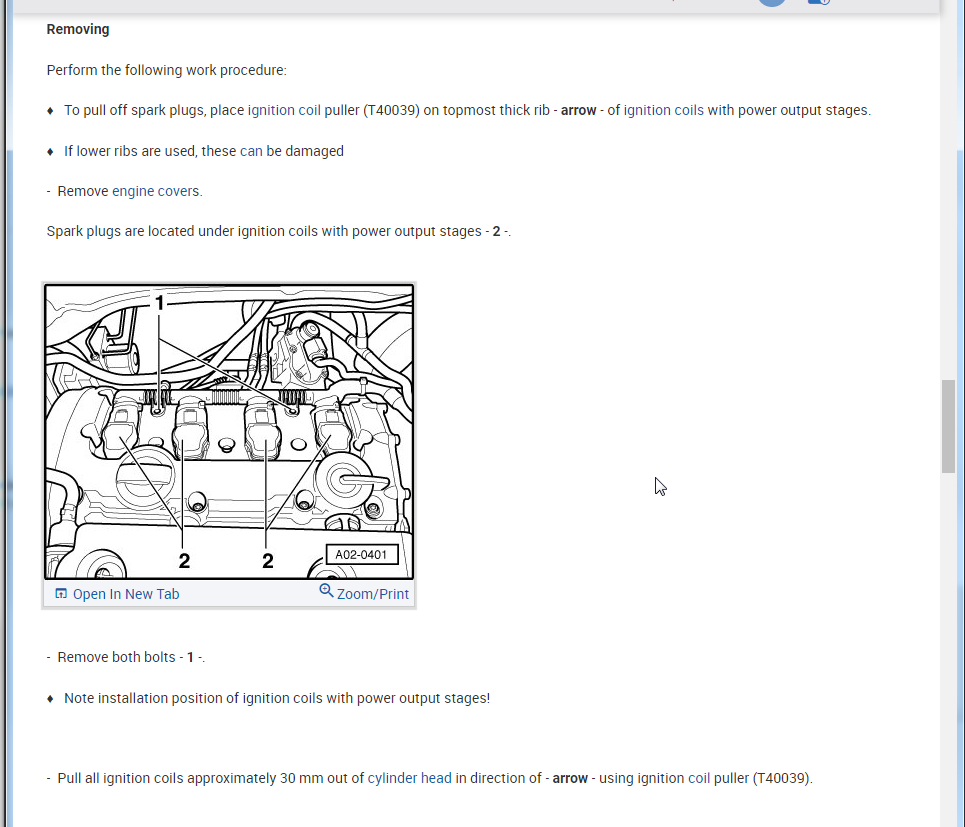

I attached the process below for the coils and plugs. Let me know what questions you have. Thanks
