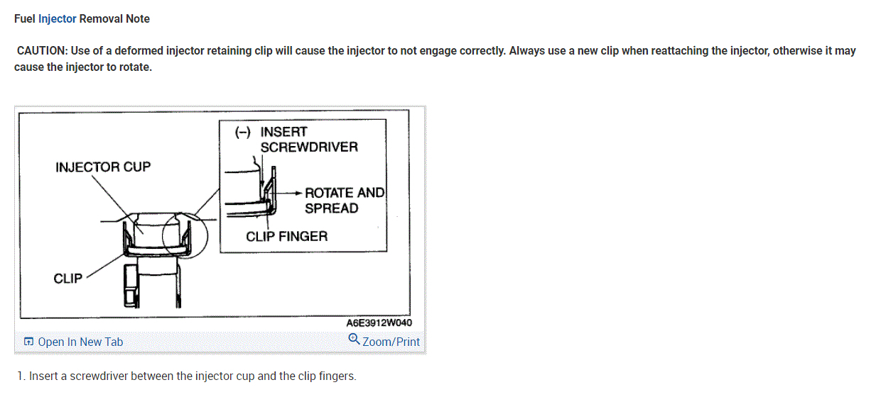

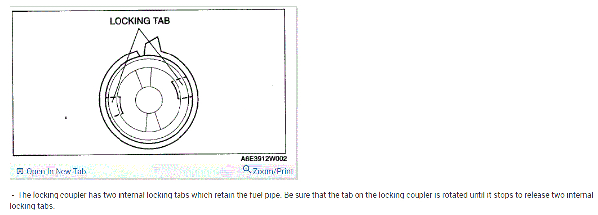

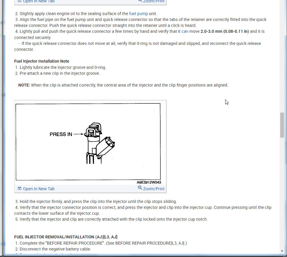

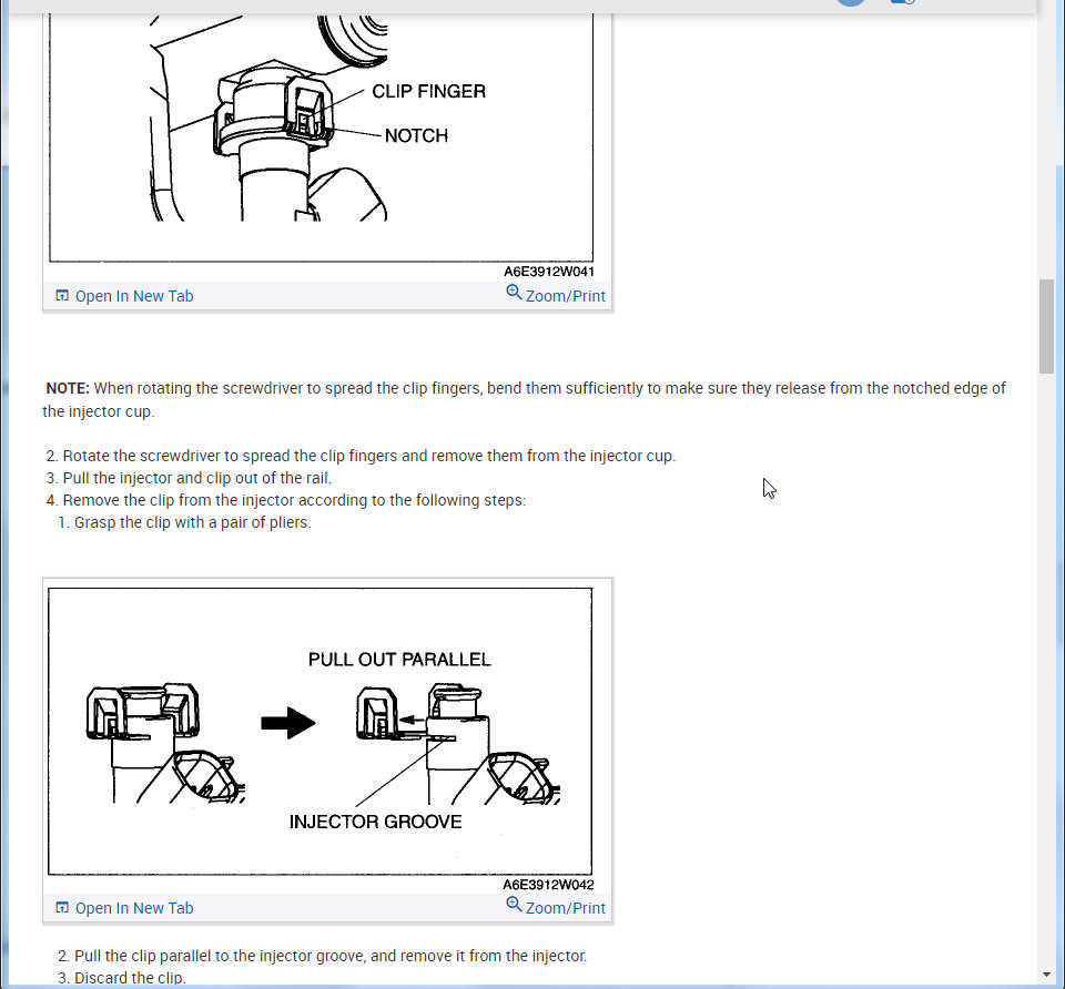

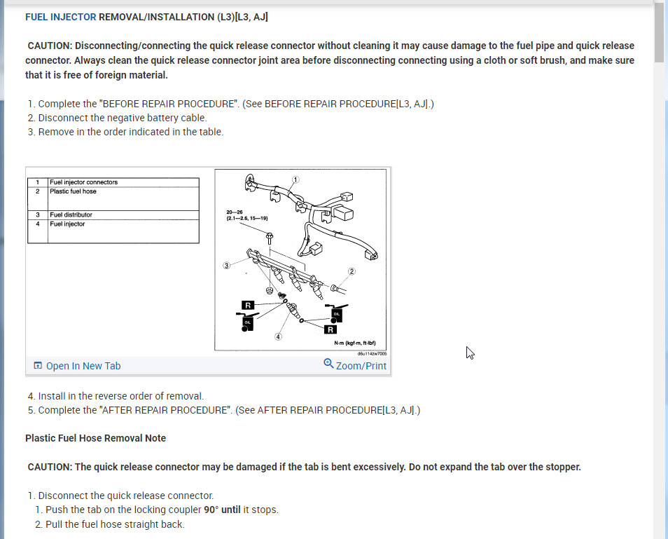

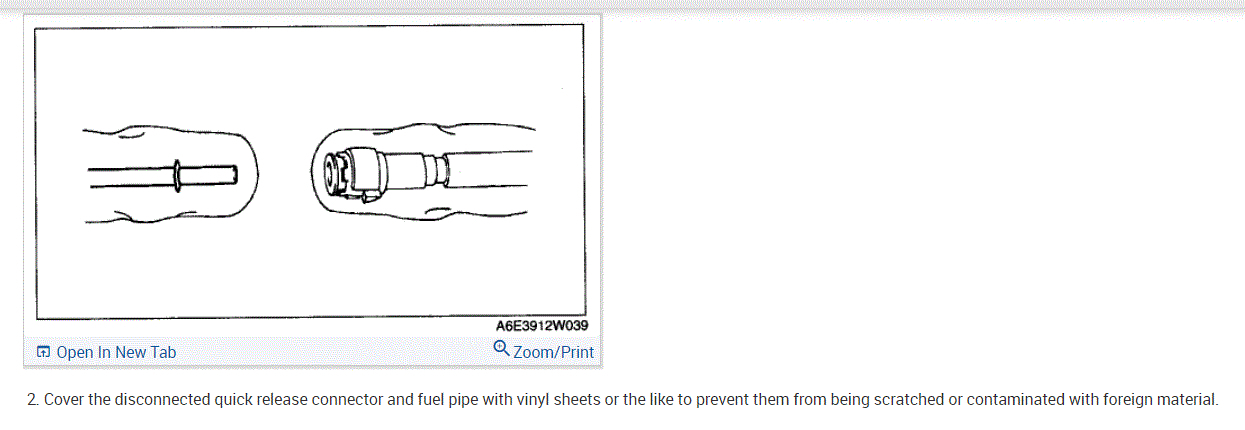

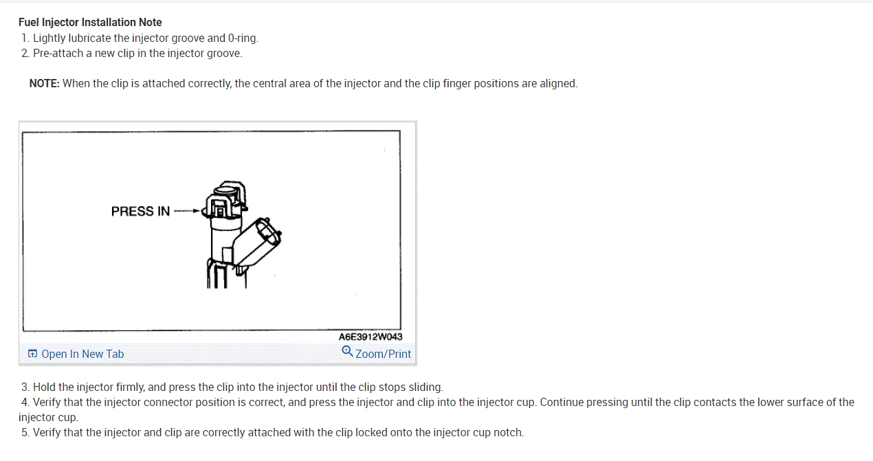

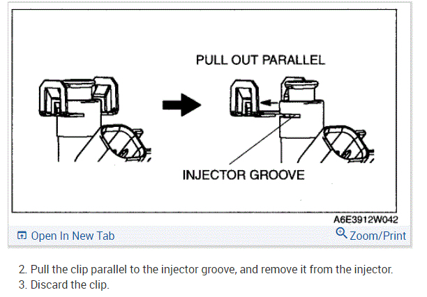

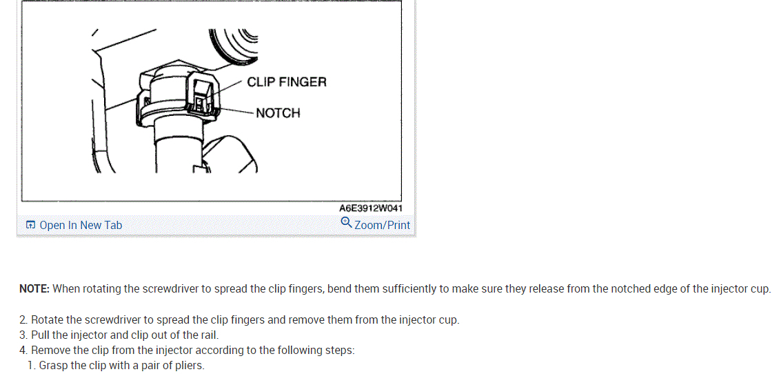

Do you feel the misfire and is the check engine light flashing?
It could be a fuel pressure issue or a fuel injector issue. Is a P0302 the only code that is found?

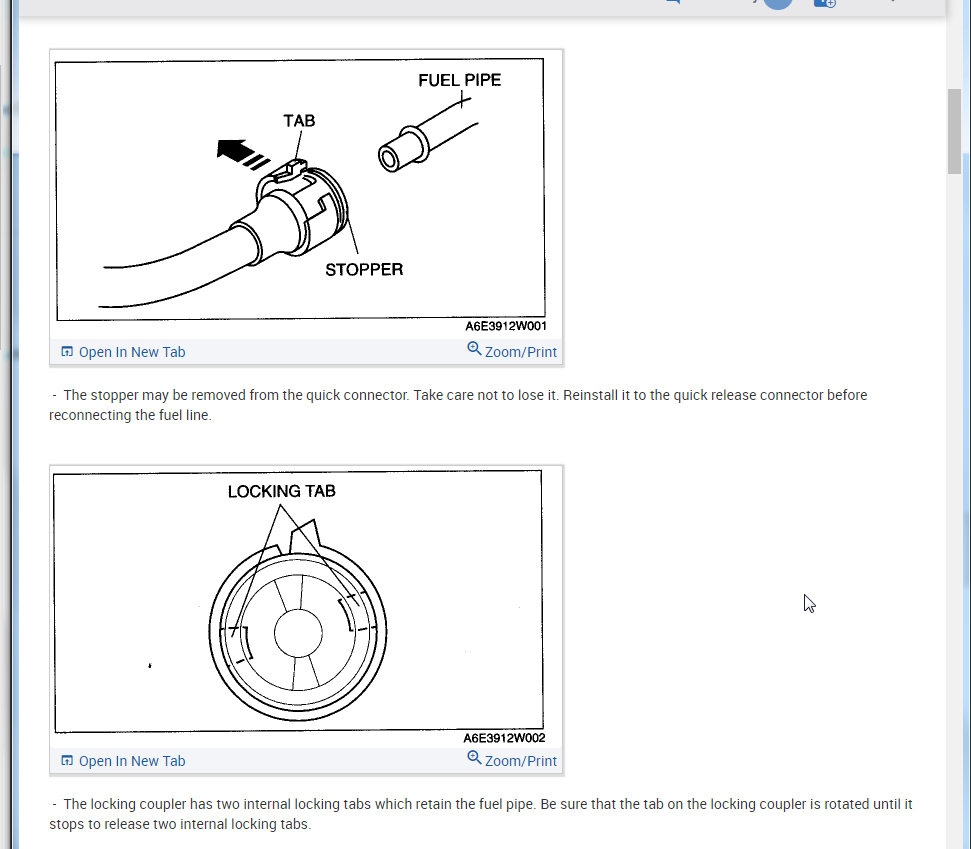

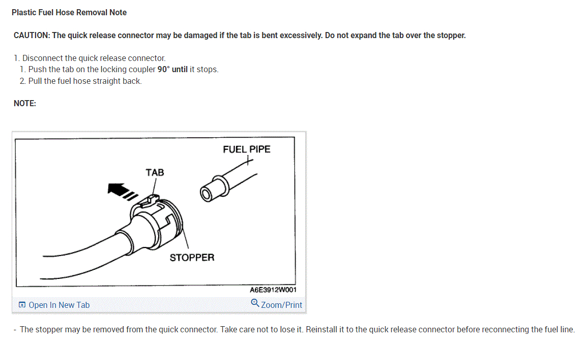

If it is, then we need to try something. What I want you to do is switch the cylinder 2 fuel injector with a different cylinder to see if the misfire changes cylinders.

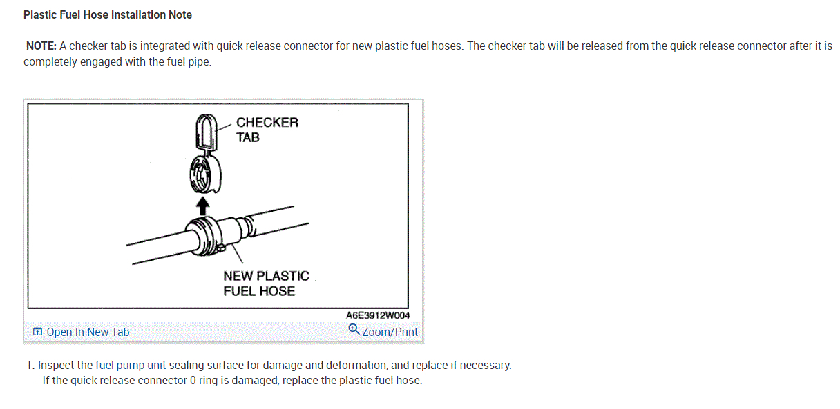

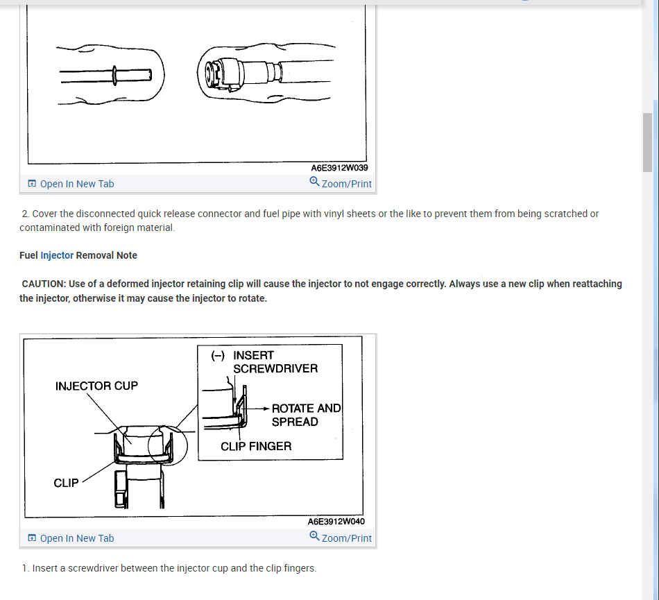

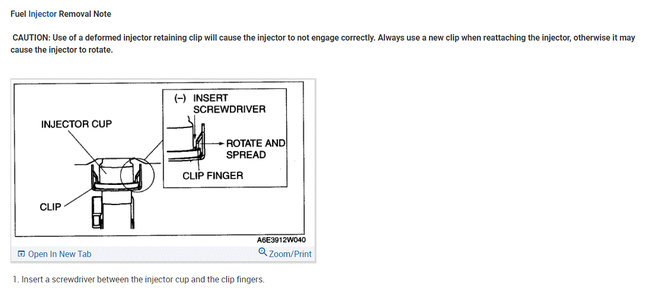

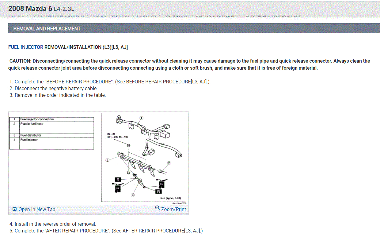

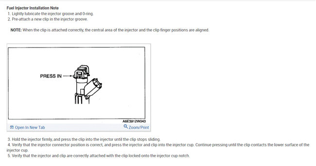

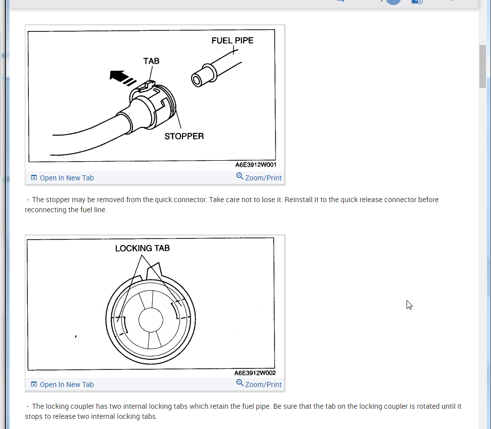

If you look at the attachments below, they provide the directions and pics specific to his vehicle for injector replacement.
Try this and let me know what happens.
See pics below.
