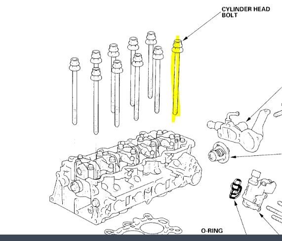

Where does the longer cylinder head bolt go and what is the torque?
Nov 30, 2019 at 9:26 PM
If I recall, it's the first one on outside front of engine. See the attached pic. It is specific for your vehicle and even based on the pic, it appears to be the longer one.

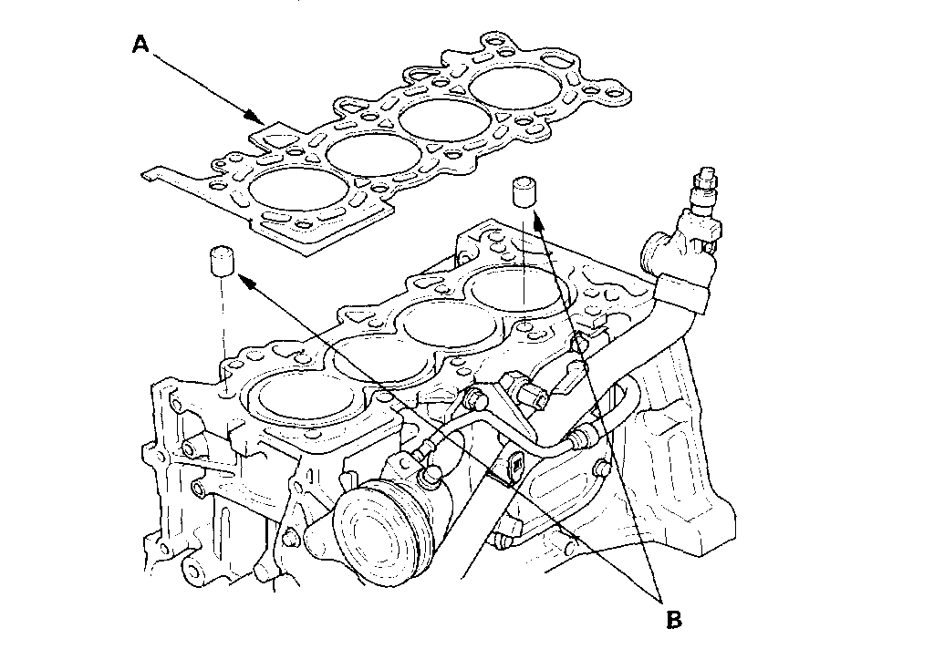

1. Clean the cylinder head and block surface.
pic 2
2. Install the new cylinder head gasket (A) and dowel pins (B) on the cylinder block. Always use a new cylinder head gasket.

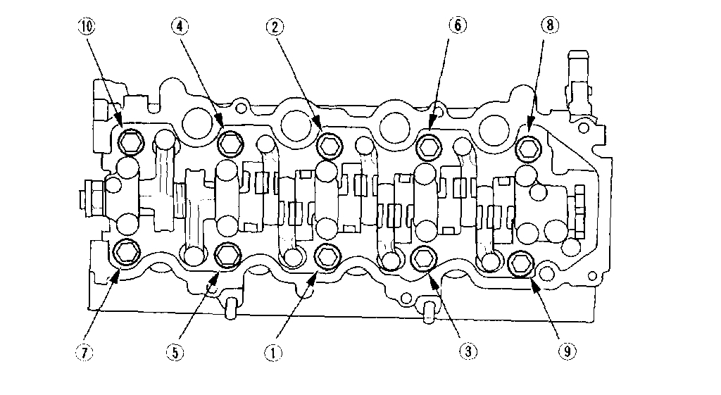

5. Apply engine oil to the threads and under the bolt heads of all cylinder head bolts.
pic 3
6. Tighten the cylinder head bolts in sequence to 29 Nm (3.0 kgf-cm, 22 ft. lbs.), use a beam-type torque wrench. When using a preset-type torque wrench, be sure to tighten slowly and do not overtighten. If a bolt makes any noise while you are torquing it, loosen the bolt and retighten it from the first step.
7. Tighten all cylinder head bolts an additional 130°
____________________________________________________
Make sure to follow the sequence indicated above and in pic 3. If you need help with timing, let me know.

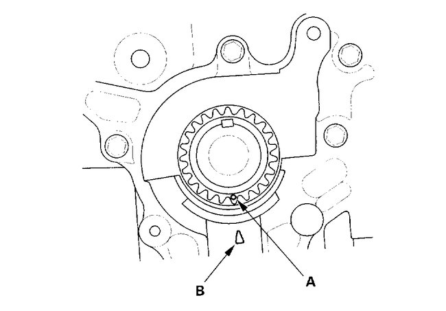

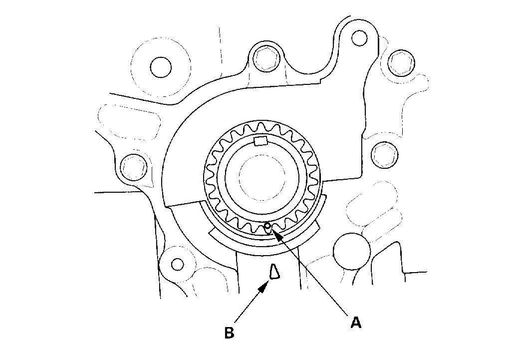

1. Set the crankshaft to top dead center (TDC). Align the TDC mark (A) on the crankshaft sprocket with the pointer (B) on the oil pump.

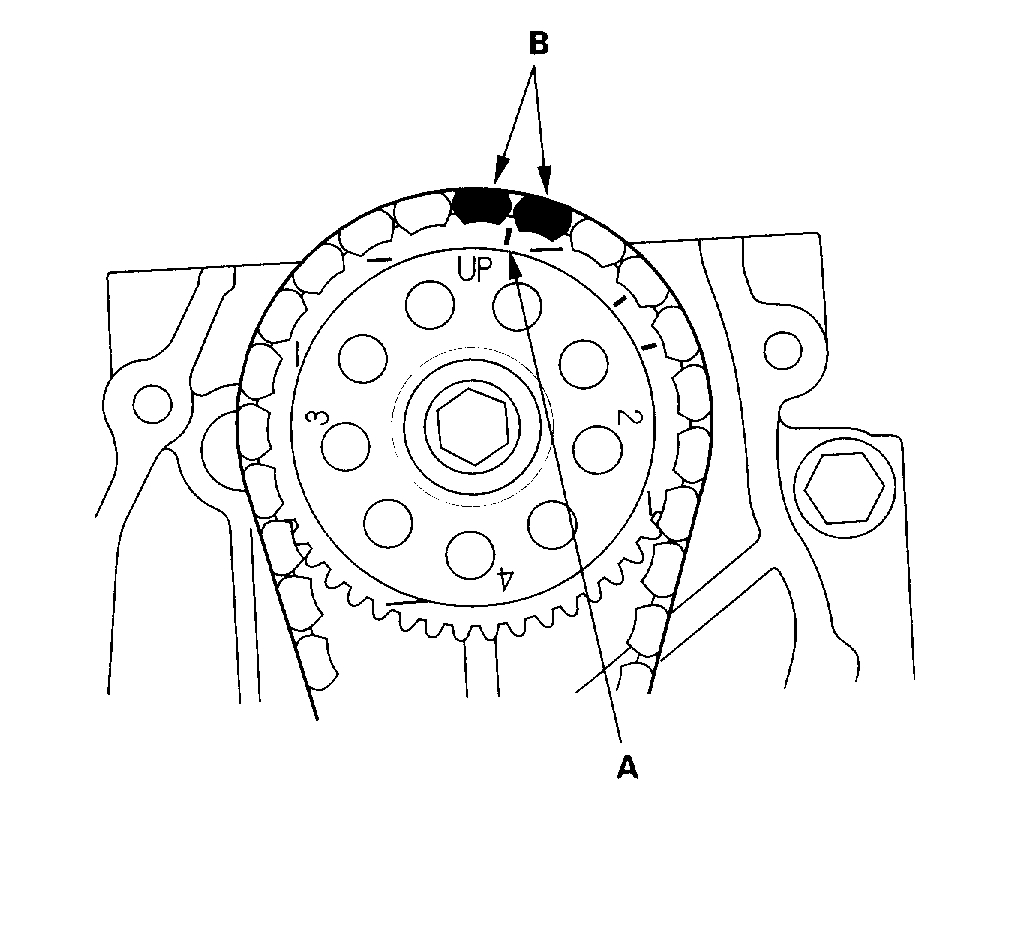

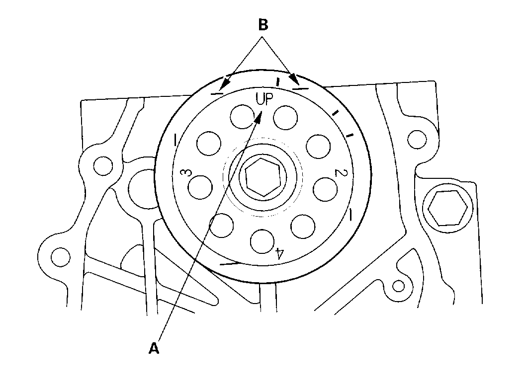

2. Set the No. 1 piston at TDC. The "UP" mark (A) on the camshaft sprocket should be at the top, and the TDC grooves (B) on the camshaft sprocket should line up with the top edge of the head.

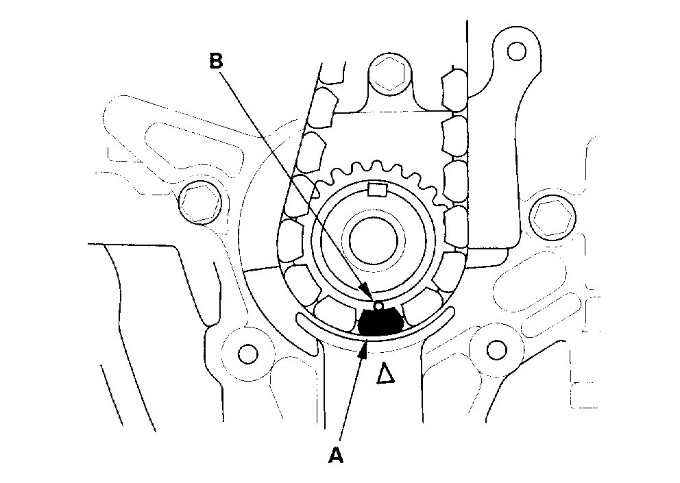

3. Install the cam chain on the crankshaft sprocket with the colored piece (A) aligned with the TDC mark (B) on the crankshaft sprocket.

4. Install the cam chain on the camshaft sprocket with the pointer (A) aligned with the center of the two colored pieces (B).

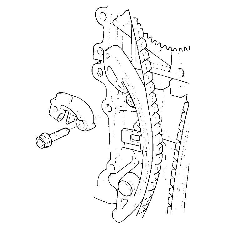

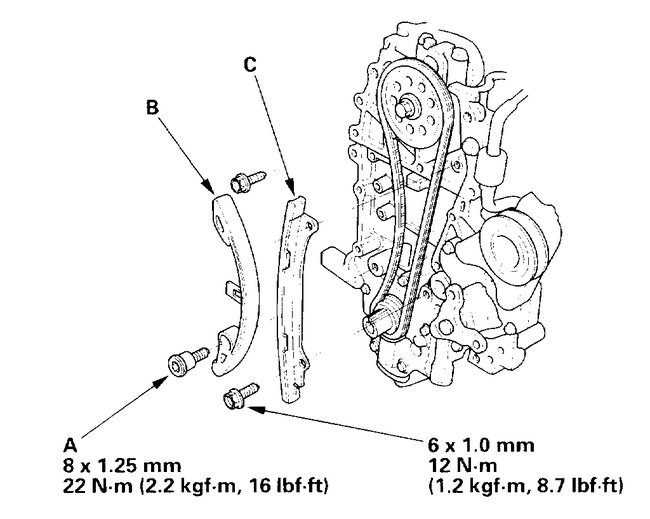

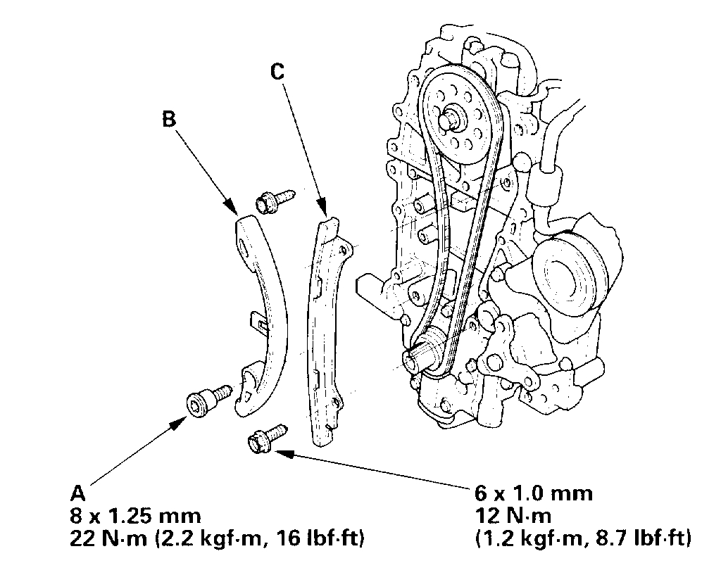

5. Apply engine oil to the threads of the cam chain tensioner rail mounting bolt (A).
6. Install the cam chain tensioner rail (B) and cam chain guide (C).

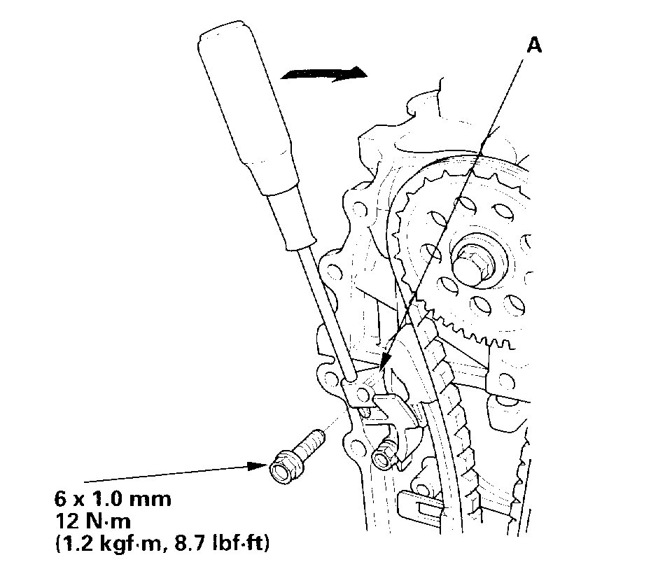

pic 6

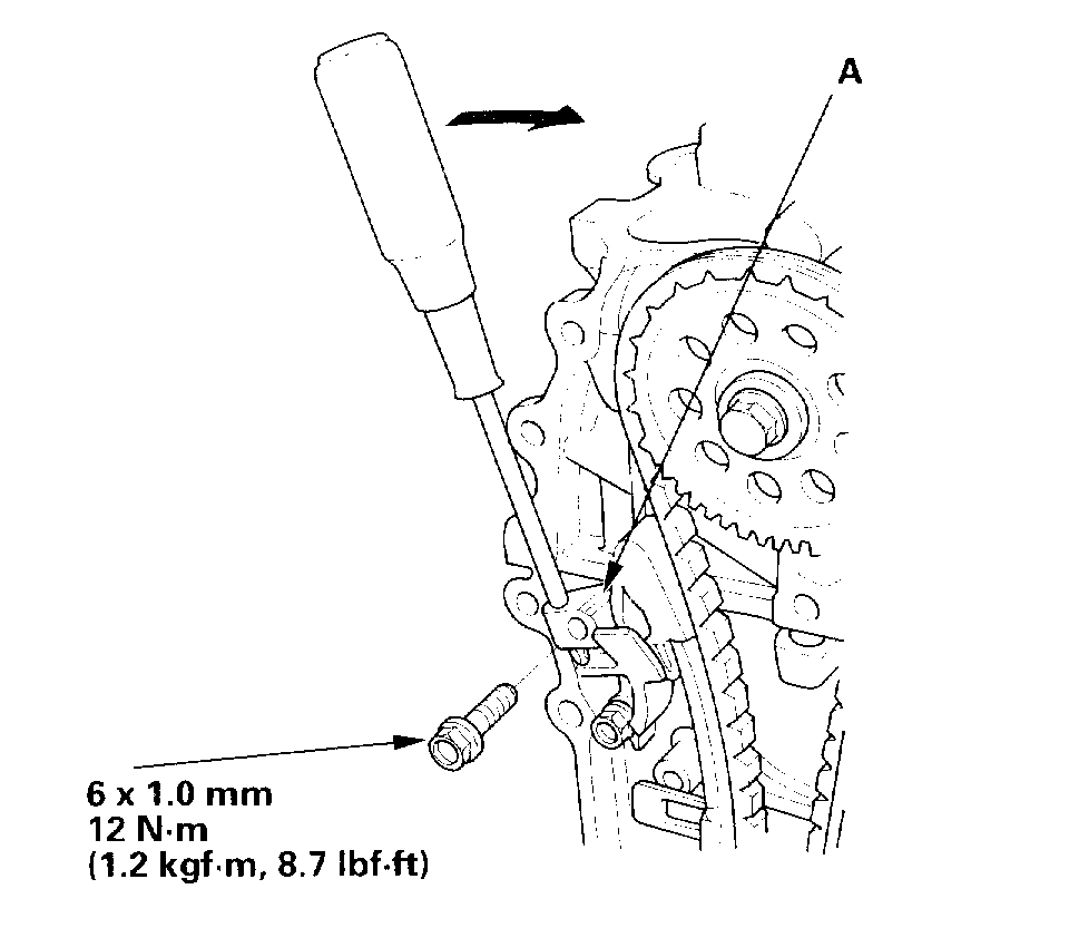

7. Install the cam chain tensioner, and tighten the bolt loosely.
pic 7
8. Apply engine oil to the sliding surface of the cam chain tensioner (A).
9. Turn the cam chain tensioner clockwise to compress the cam chain tensioner rail. Install the remaining bolt, then tighten the bolts.

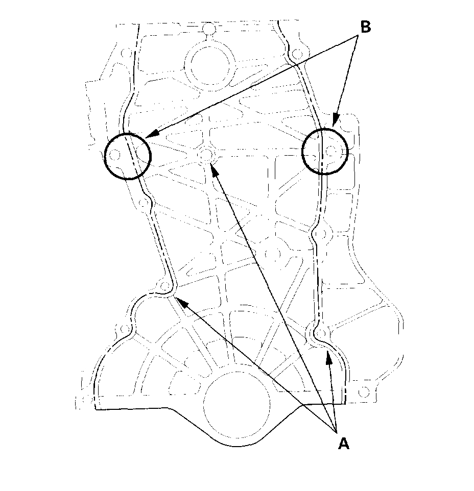

pic 8
13. Apply liquid gasket, P/N 08718-0009, to the cylinder block mating surface of the chain case and the inner threads of the holes.
NOTE:
^ Apply a 1.5 mm wide bead of liquid gasket along the broken line (A).
^ Apply a 3.0 mm wide bead of liquid gasket to the cylinder block upper surface contact areas (B) on the chain case.
^ Do not install the parts if 5 minutes or more have elapsed since applying liquid gasket. Instead, reapply liquid gasket after removing old residue.

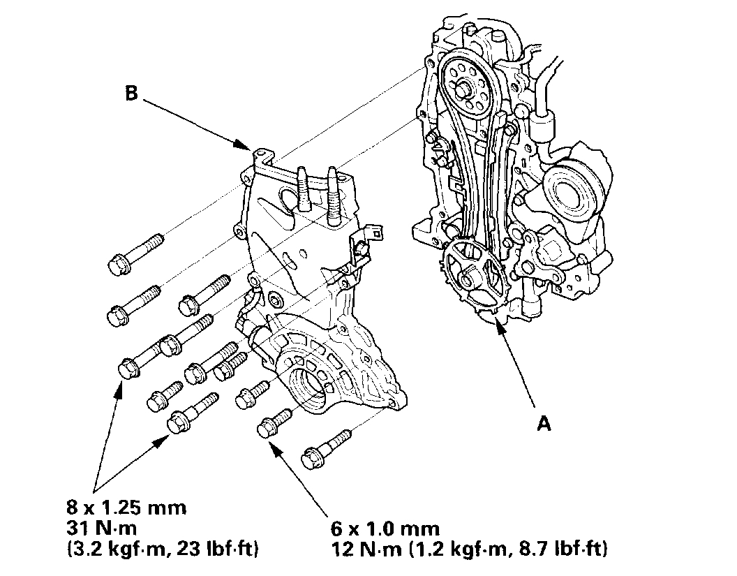

pic 9
14. Install the pulse plate (A) and chain case (B).

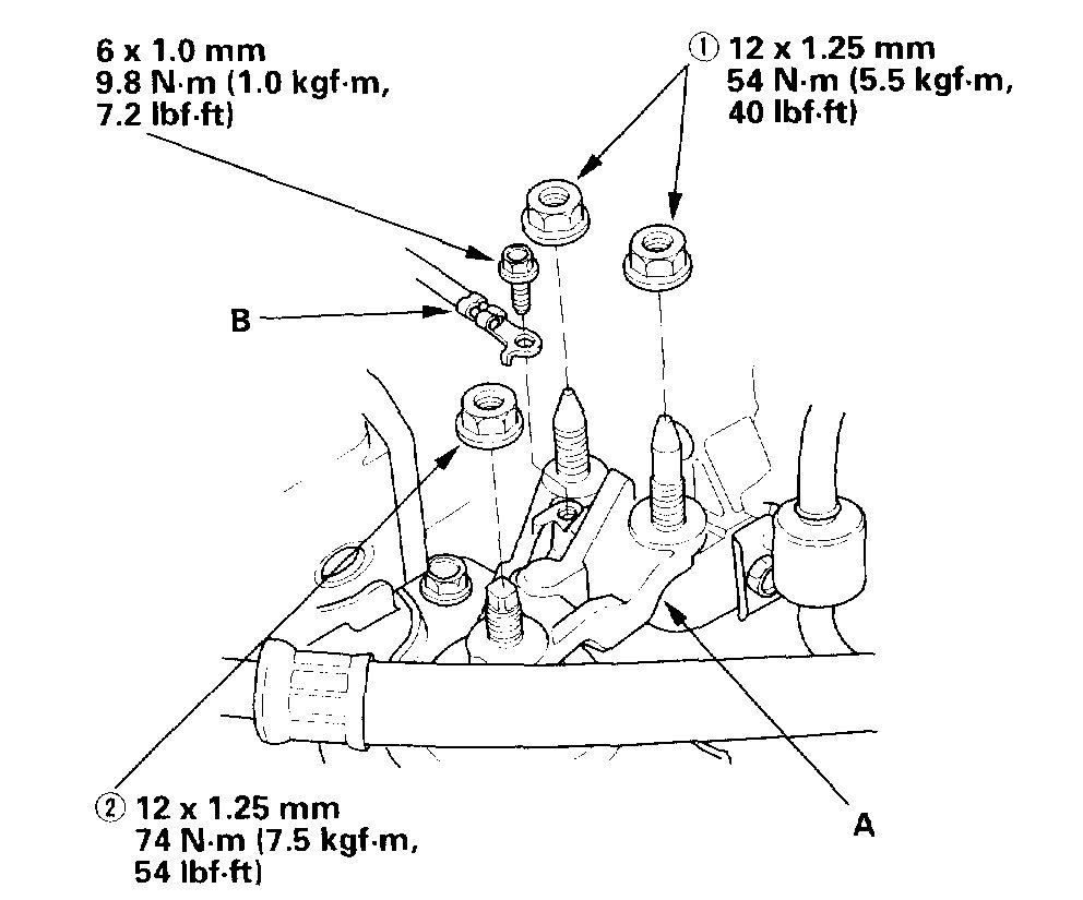

pic 10
15. Install the upper bracket (A), then tighten the mounting nuts in the numbered sequence shown.
16. Install the ground cable (B).
