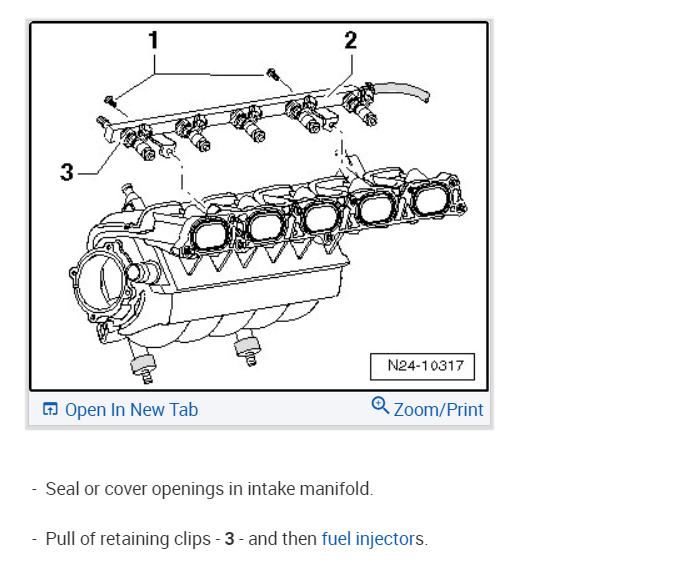

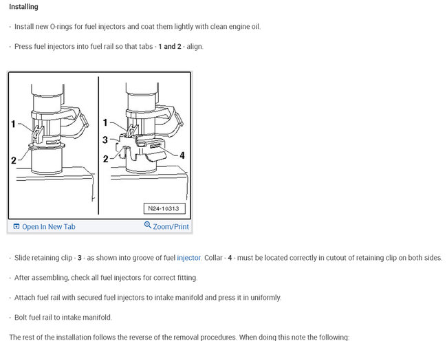

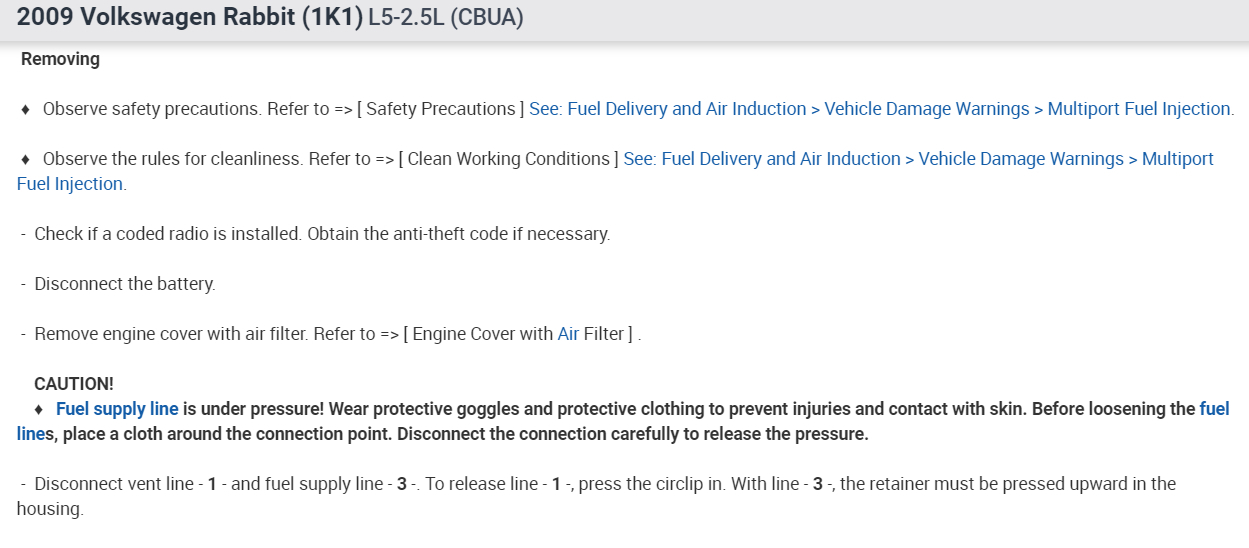

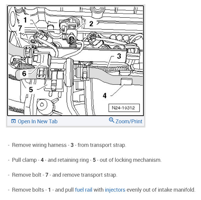

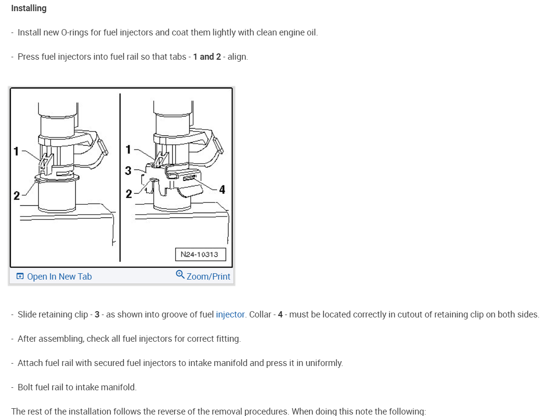

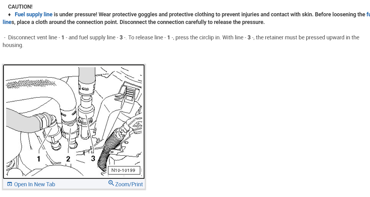

It sounds like when the engine is cold the #1 fuel injector is not working. To be sure here is a guide to help test it with instructions below to help you replace the injector on your car:
https://www.2carpros.com/articles/how-to-test-a-fuel-injector
