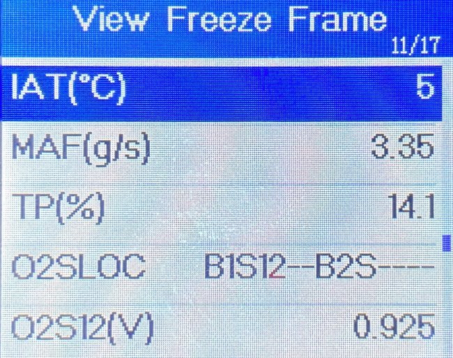

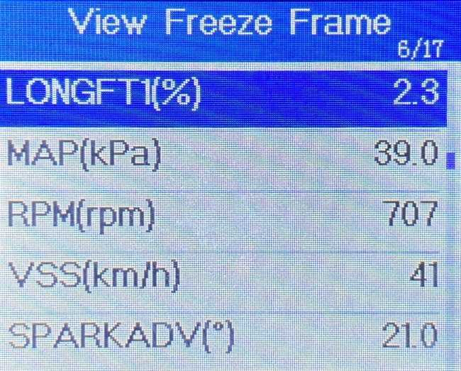

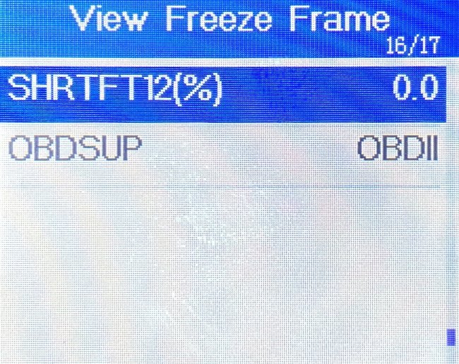

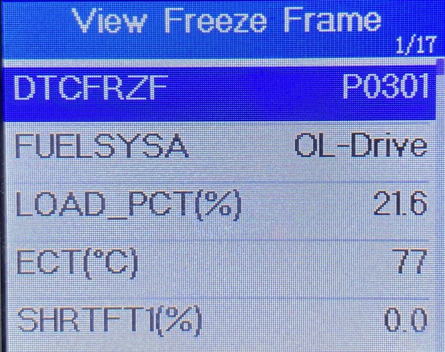

I have not had my battery tested, and have only scanned for codes with my basic tester since the nearest parts store is a fair distance from me. I have attached my latest freeze frame data from code reader.
