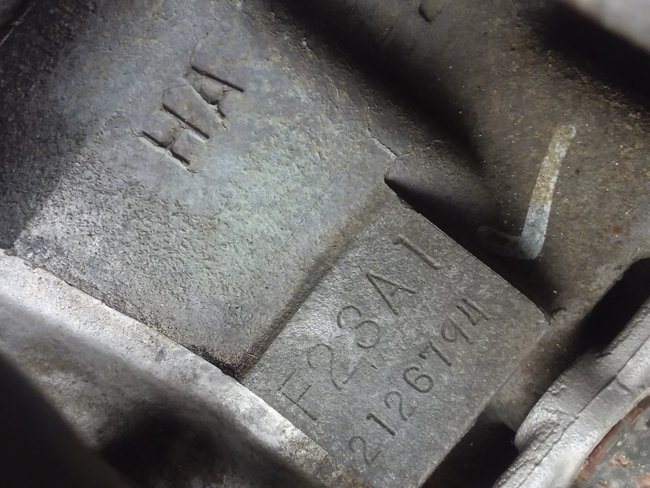

That appears to be a 2.3L. Here are the directions I have for it. These are for the single overhead cam engines. If you have something different, let me know.
These directions are from start to finish. The attached pics correlate with the directions. They will indicate timing marks.

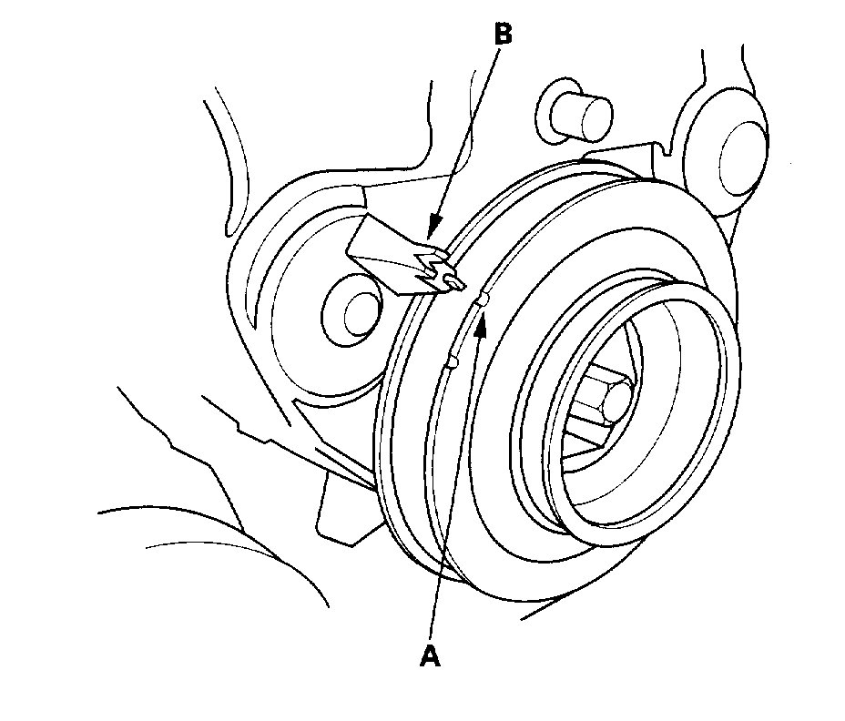

pic 1

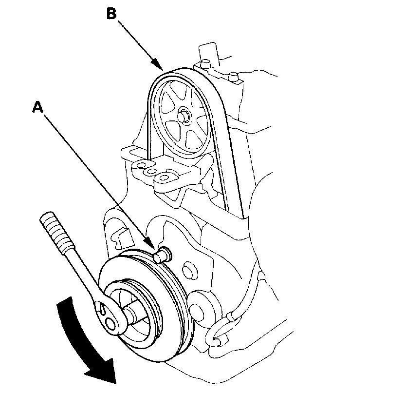

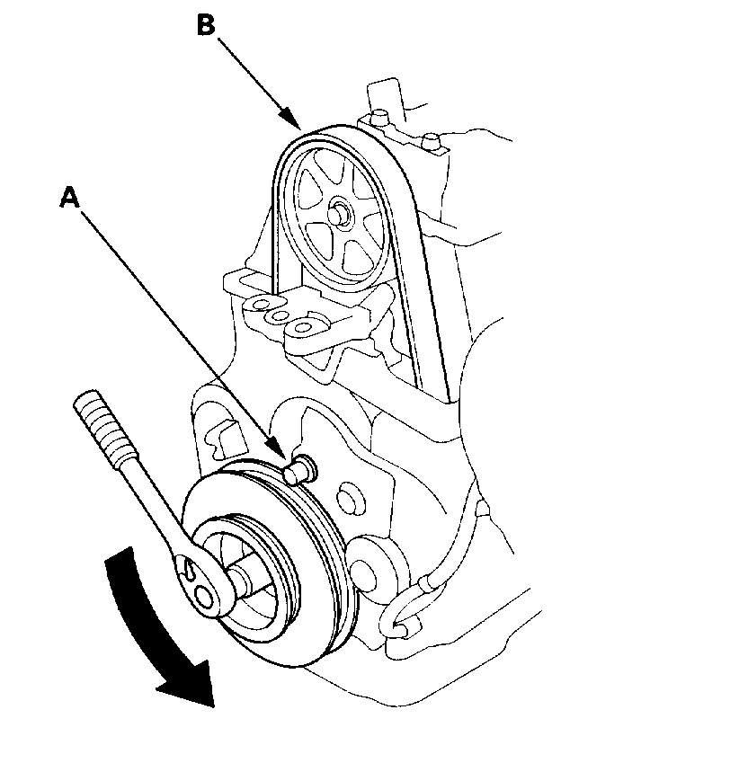

3. Turn the crankshaft pulley so its TDC mark (A) lines up with the pointer (B).

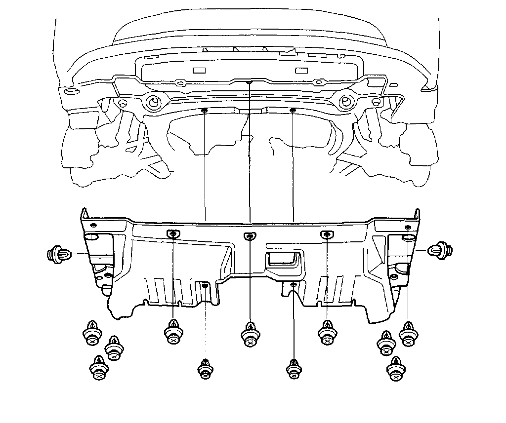

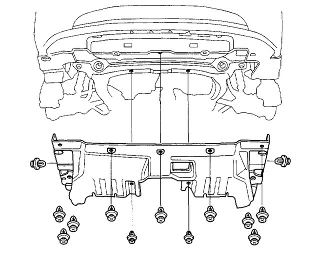

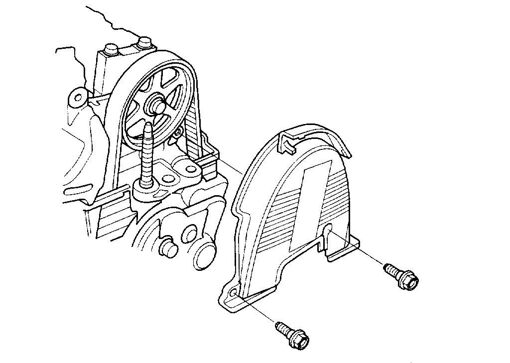

5. Remove the splash shield.
pic 3

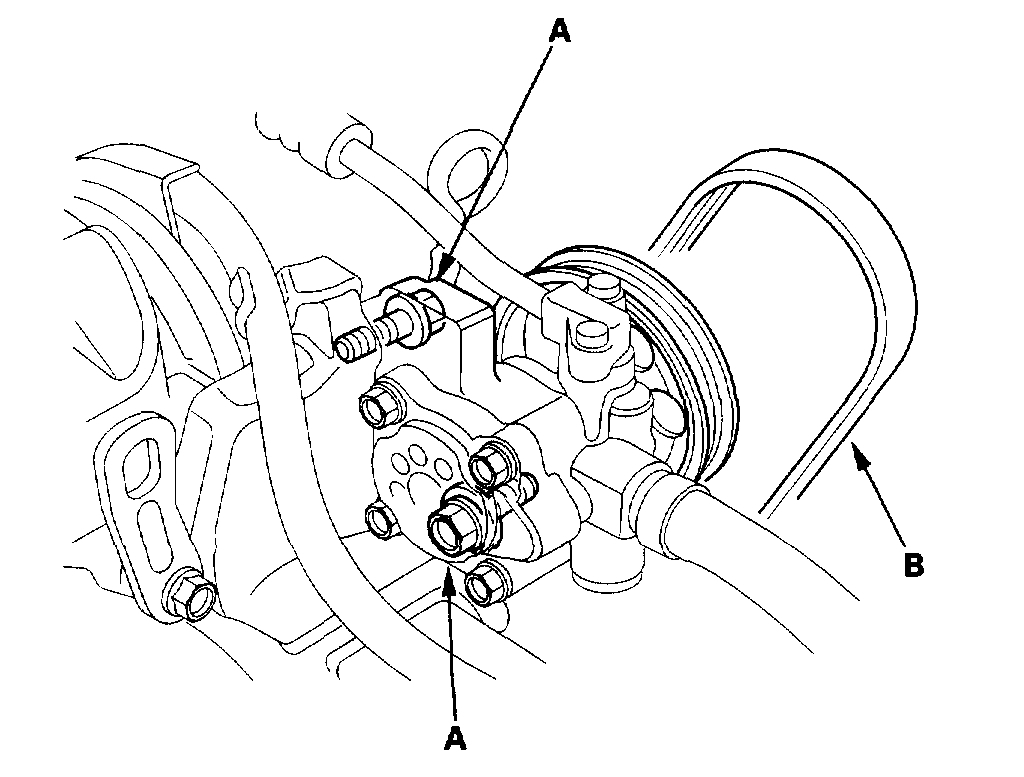

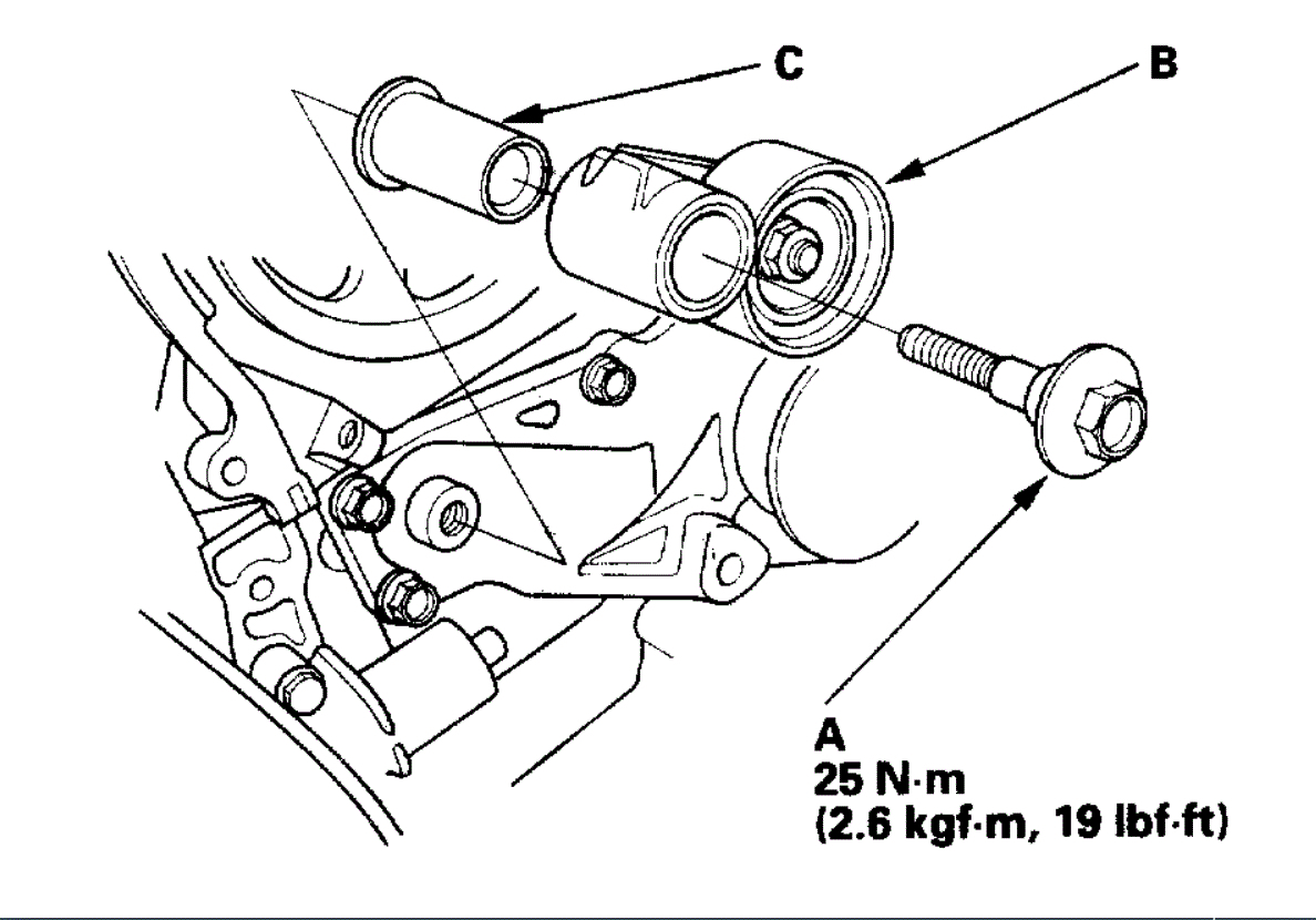

6. Loosen the mounting bolts (A), then remove the P/S belt (B).
pic 4

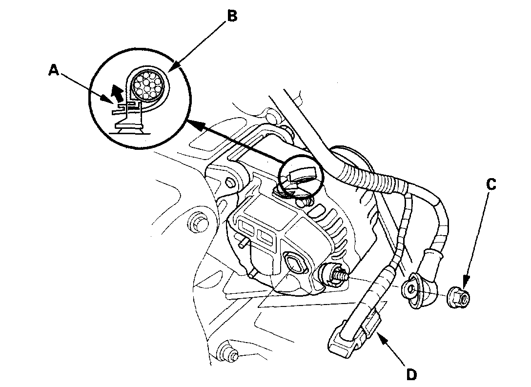

7. Disconnect the alternator wire harness.
- 1 Pull up the lock (A), then release the wire harness tie (B).
- 2 Pull back the boot and remove the 6 mm nut (c).
- 3 Disconnect the connector (D) from the alternator.

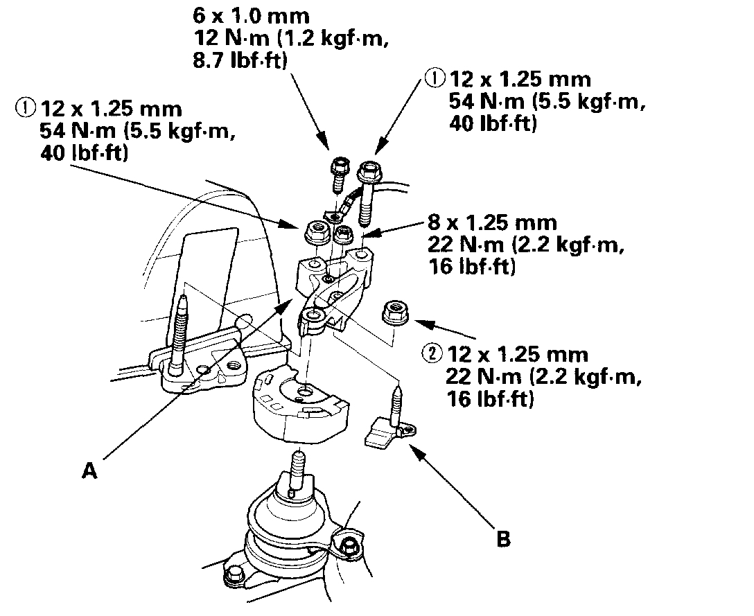

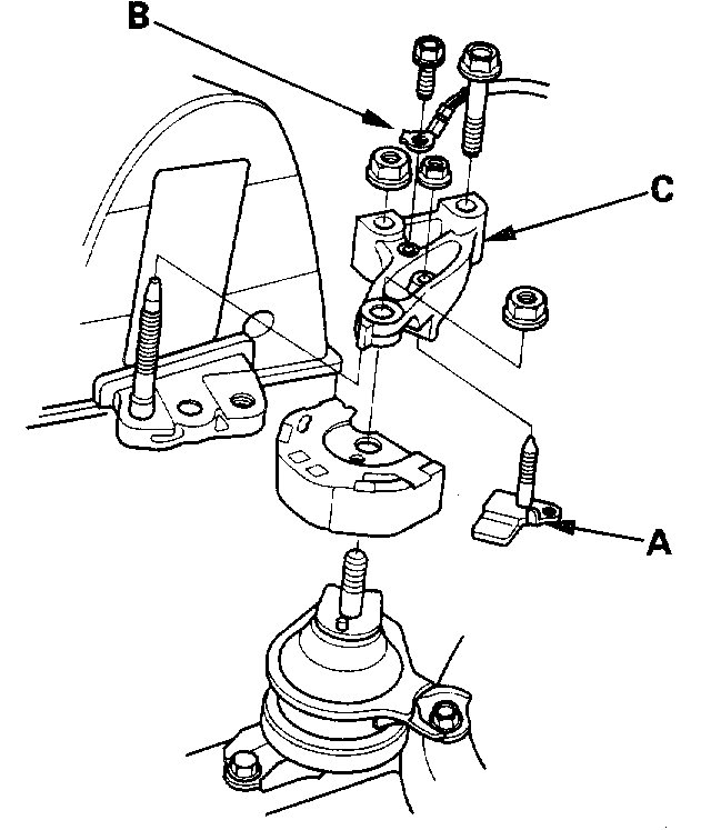

10. Support the engine with a jack and wood block under the oil pan.
pic 5
11. Remove the stopper (A) and ground cable (B), then remove the upper bracket (C).

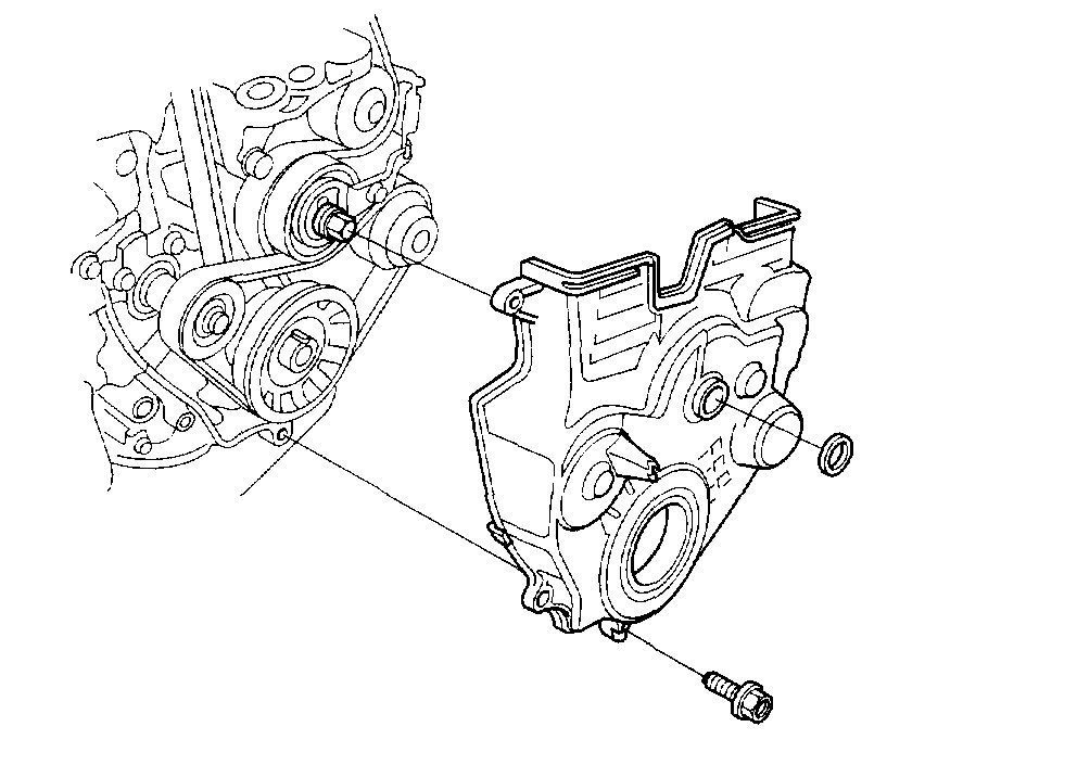

13. Remove the upper cover.

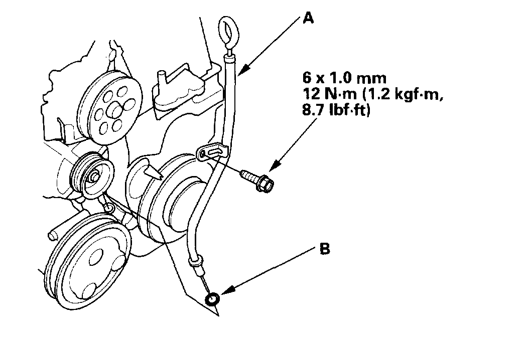

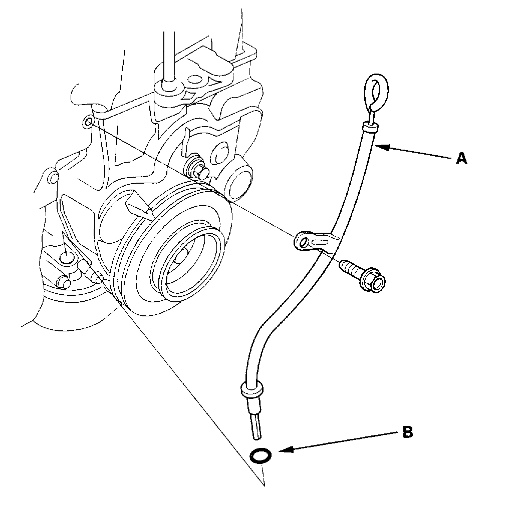

14. Remove the dipstick and tube (A). Discard the O-ring (B).

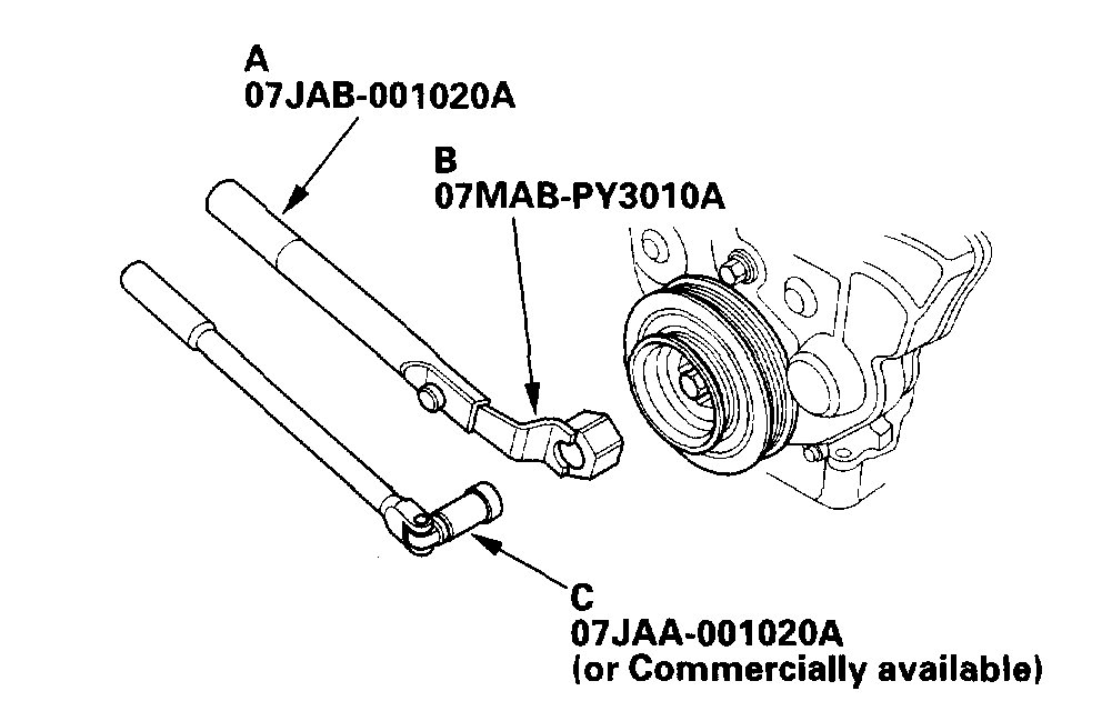

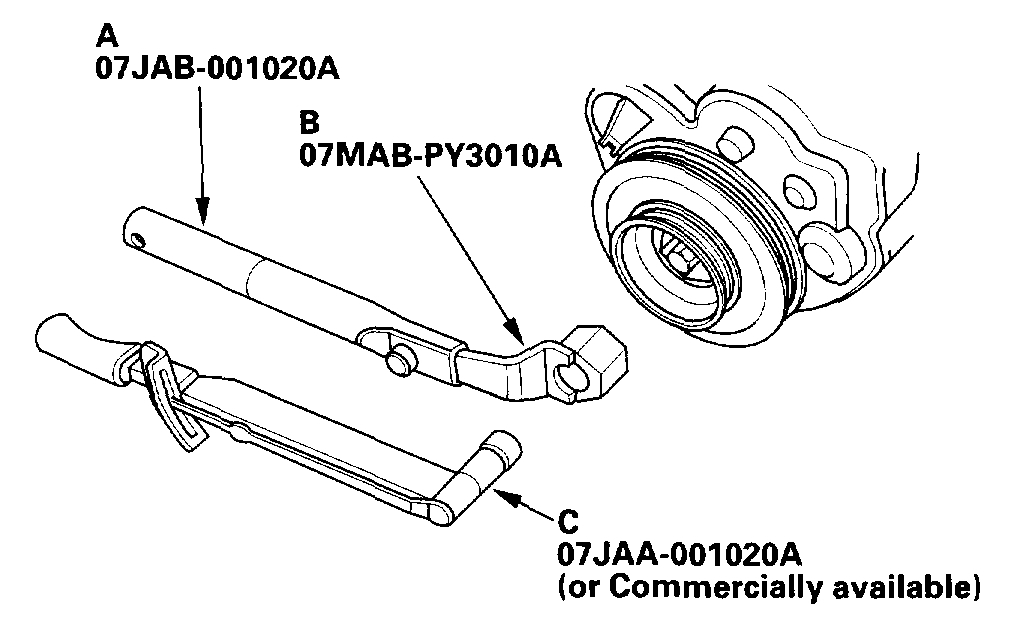

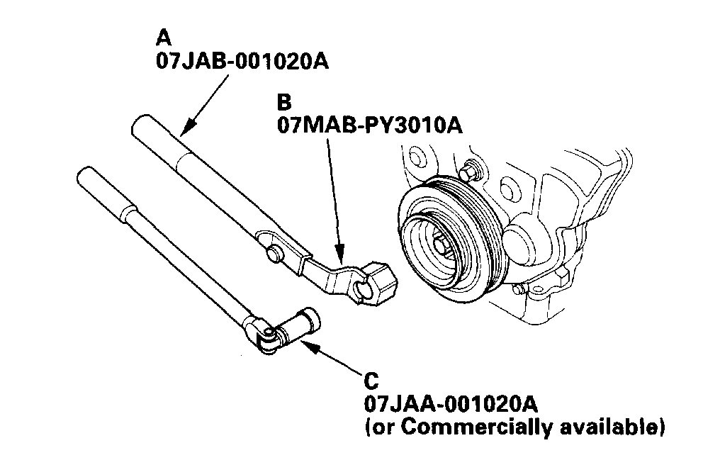

15. Hold the pulley with holder handle (A) and holder attachment (B).
16. Remove the bolt with a heavy duty 19 mm socket (c) and breaker bar.

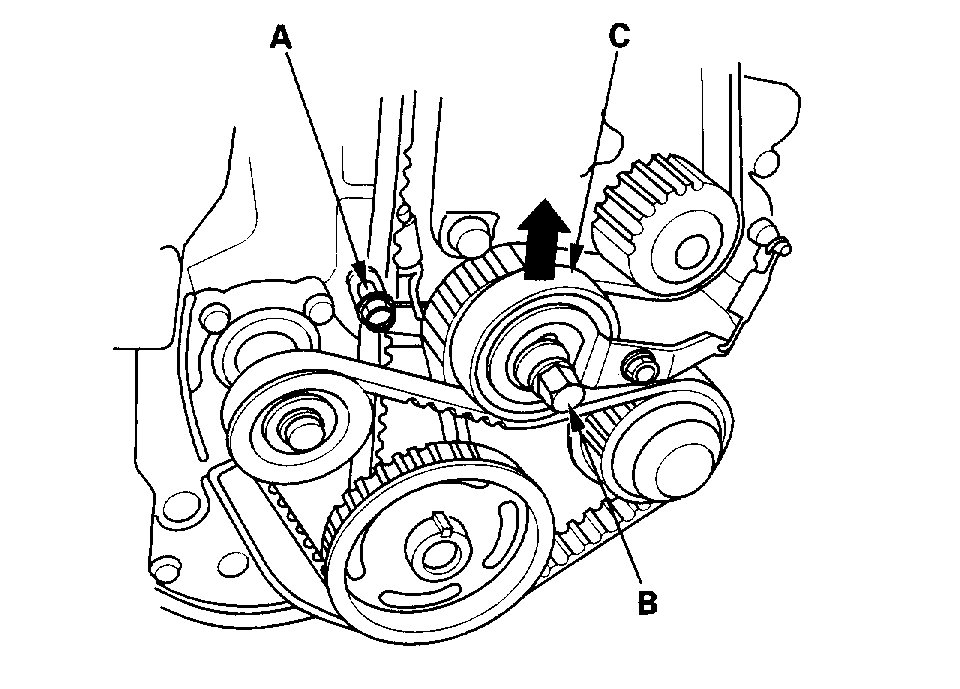

pic 11

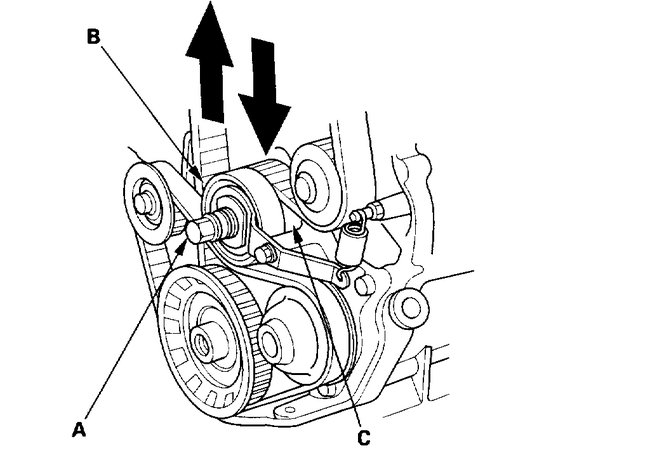

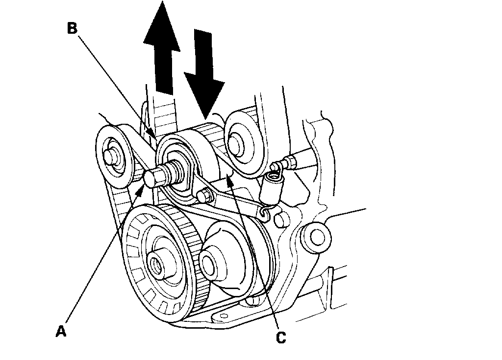

20. Release tension from the balancer belt and the timing belt:
- 1 Loosen the adjusting nut (A) 2/3 - 1 turn.
- 2 Push the balancer belt tensioner (B) up to take tension off the balancer belt.
- 3 Push the timing belt tensioner (c) down to take tension off the timing belt.
- 4 Retighten the adjusting nut (A).
21. Remove the balancer belt.

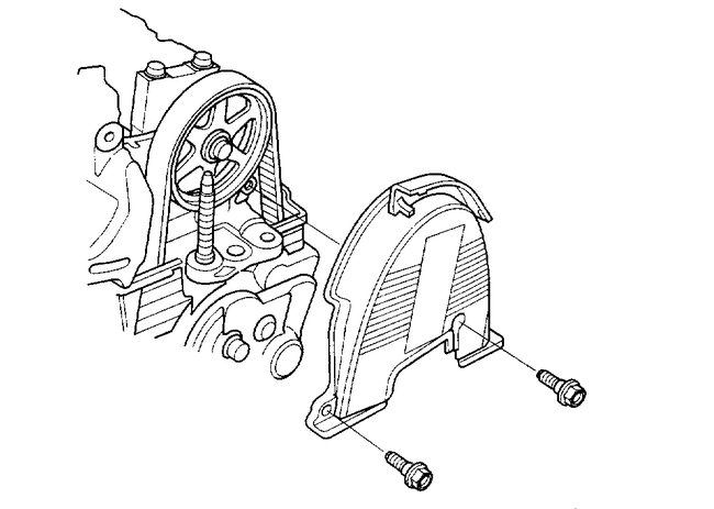

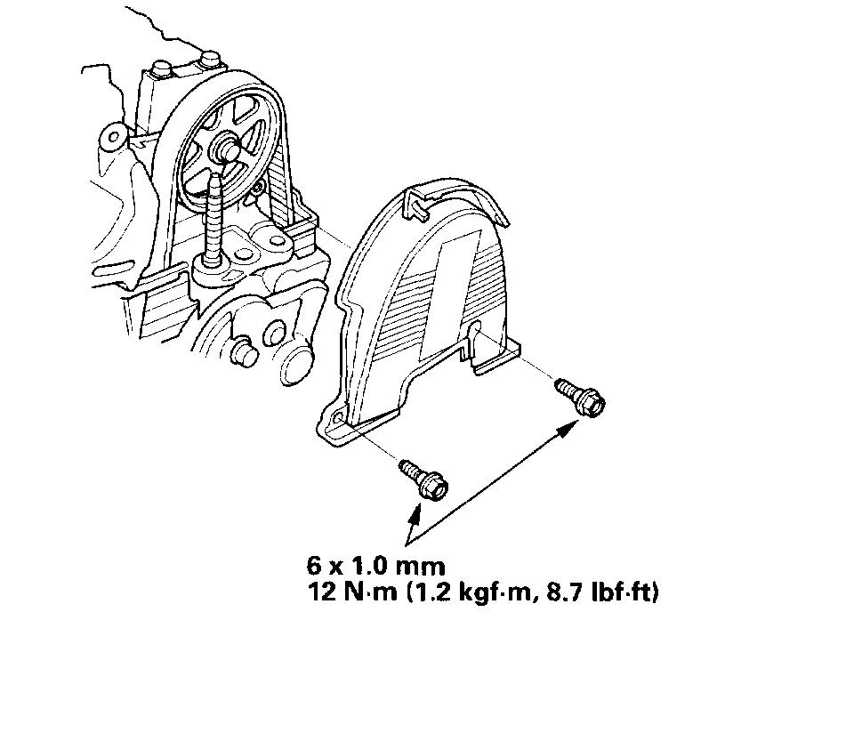

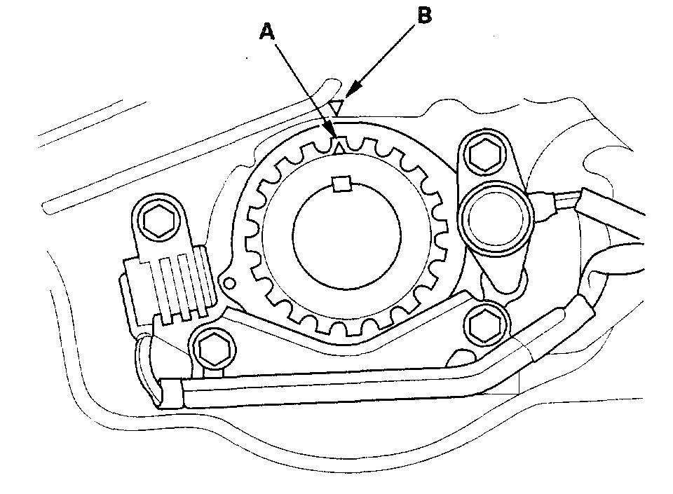

pic 12

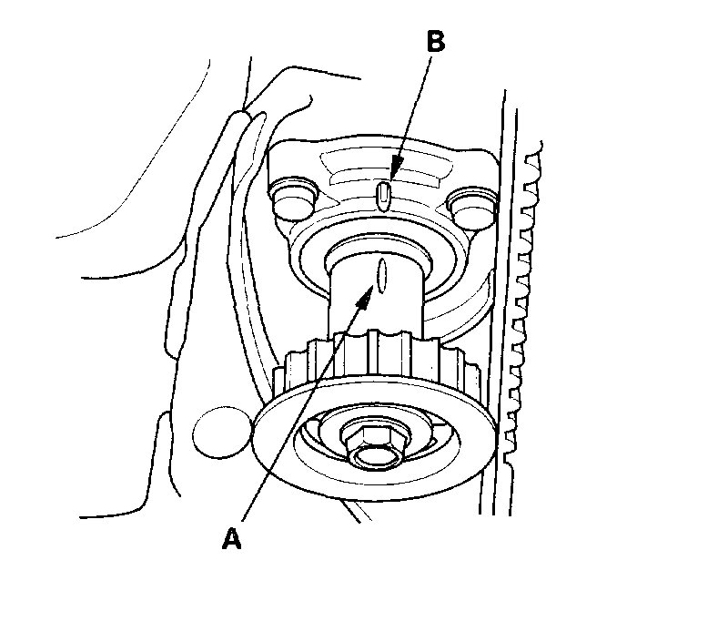

3. Set the crankshaft to TDC. Align the dimple (A) on the tooth of the timing belt drive pulley with the pointer (B) on the oil pump.
pic 13

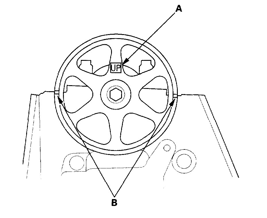

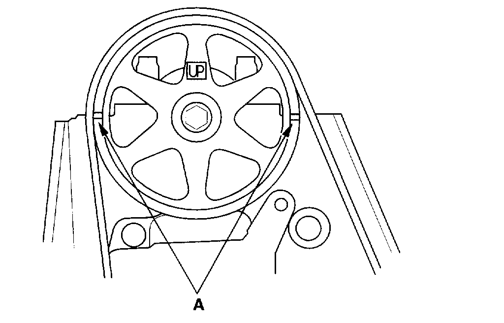

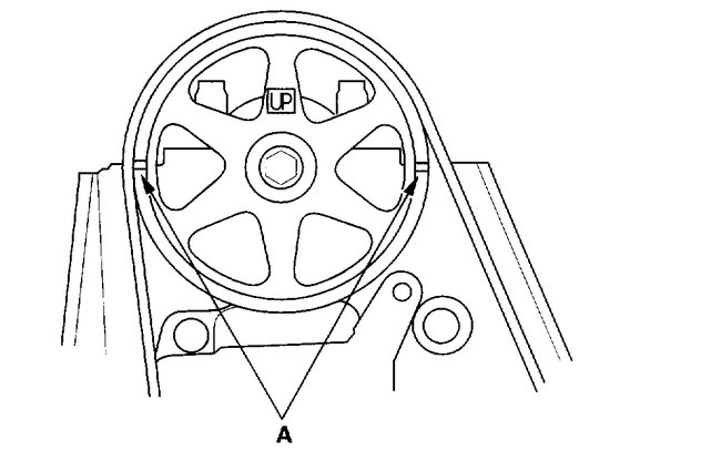

4. Clean the camshaft pulley and set it to TDC.
- 1 The "UP" mark (A) on the camshaft pulley should be at the top.
- 2 Align the TDC grooves (B) on the pulley with the too edge of the head.
pic 14

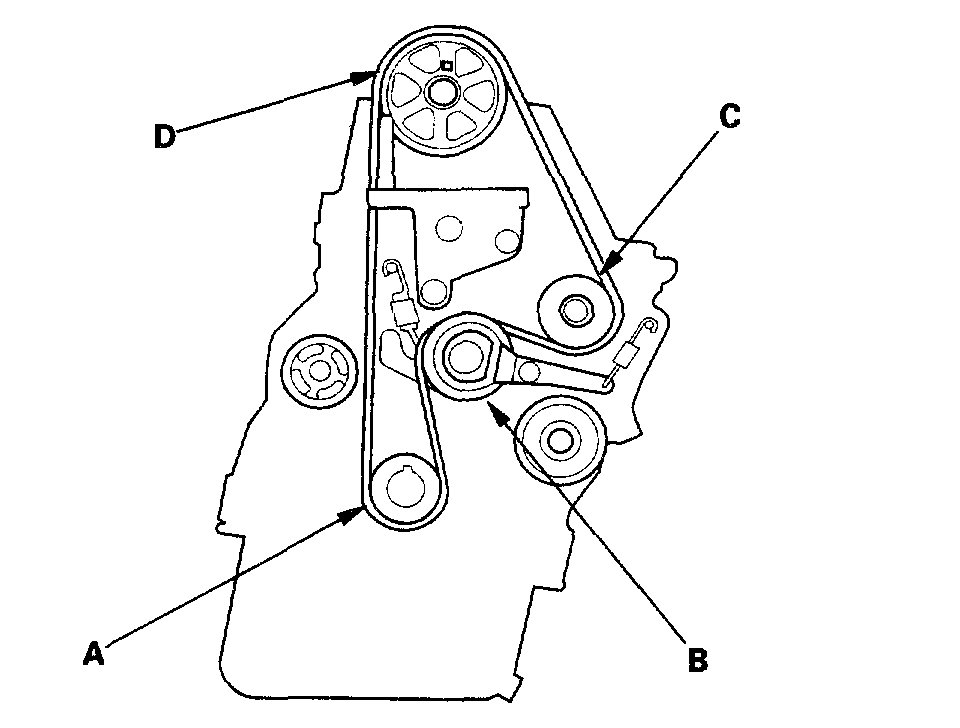

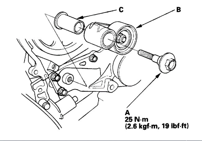

5. Install the timing belt in a counterclockwise sequence, starting with the drive pulley.
- 1 Drive pulley (A).
- 2 Tensioner pulley (B).
- 3 Water pump pulley (C).
- 4 Camshaft Pulley (D).

13. Turn the crankshaft pulley so its TDC mark (A) lines up with the pointer (B).
pic 17
14. Check the camshaft pulley marks.
- If the camshaft pulley marks are also at TDC, go to step 15.
- If the camshaft pulley marks are not at TDC, remove the timing belt and repeat steps 3, 4 and 5.

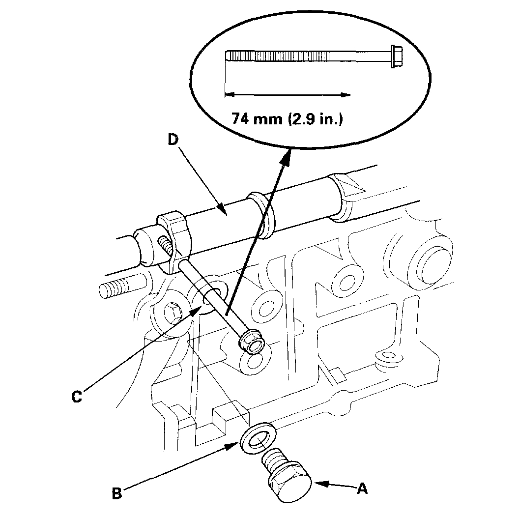

19. Align the rear balancer shaft pulley with a 6 x 100 mm bolt (or equivalent).
- 1 Remove the bolt (A) and washer (B) from the maintenance hole (C).
- 2 Scribe a line on a 6 x 100 mm bolt, 74 mm (2.9 inch) from the end.
- 3 Insert the bolt in the maintenance hole and into the hole in the balancer shaft (D) up to the line you scribed.

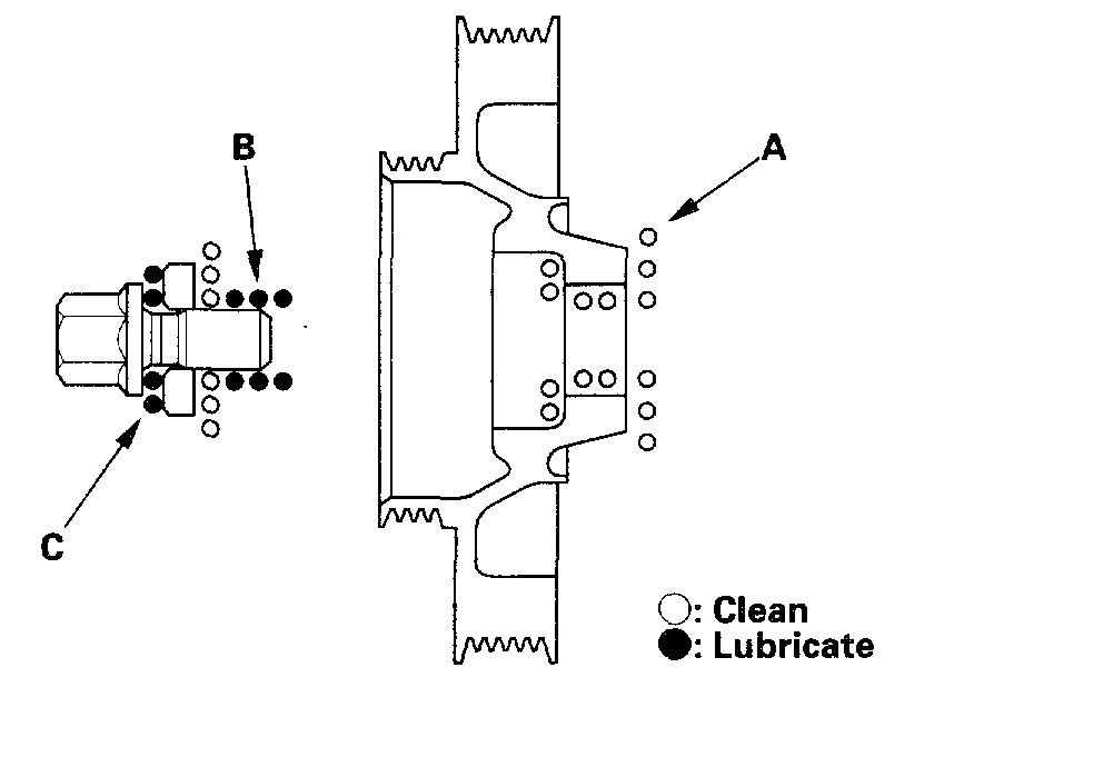

28. Clean the crankshaft pulley bolt and washer.
pic 20
29. Clean all oil off the inside face (A) of the crankshaft pulley, and apply lubricant to the pulley bolt (B) and washer (C).
pic 21
30. Install the crankshaft pulley, and hold with holder handle (a) and holder attachment (B).
31. Tighten the bolt to 245 Nm (250 kgf-m, 181 ft. lbs.) with a torque wrench and 19 mm socket (c). Do not use an impact wrench.

32. Install the dipstick and tube (A) with a new O-ring (B).

pic 24
40. Install the upper bracket (A), then tighten the bolt and nuts in the numbered sequence shown.
41. Install the stop (B).
