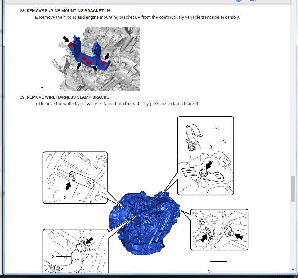

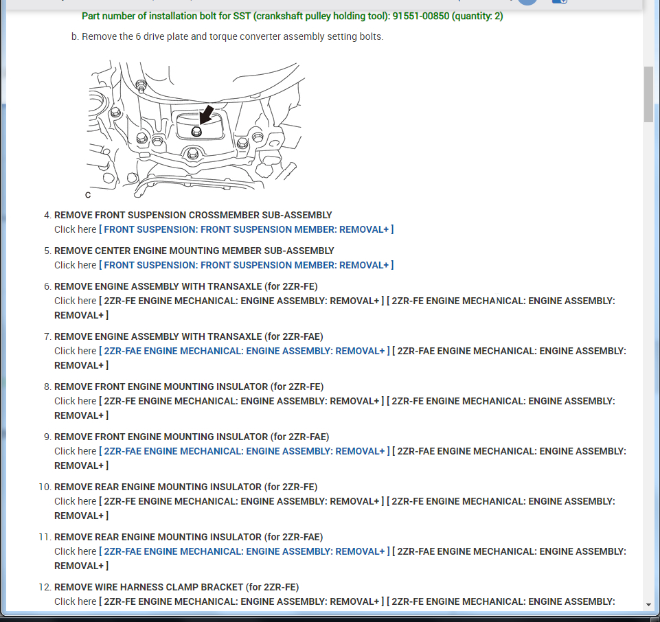

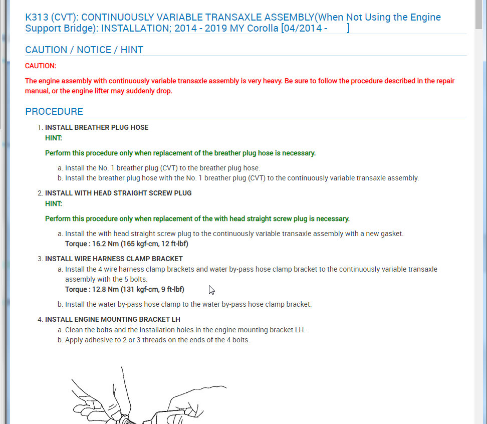

I have a Japanese Toyota Axio 2011 with a bad four wheel drive CVT transmission. I need to install it can you help?
Jan 1, 2018 at 11:17 AM
CERTIFIED EXPERT
18,907 POSTS

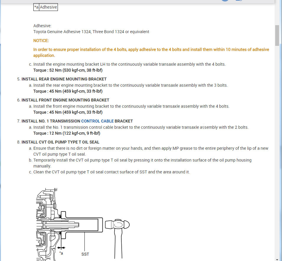

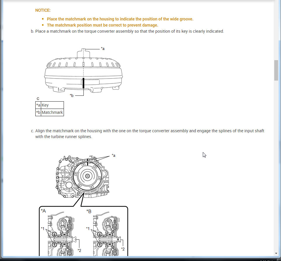

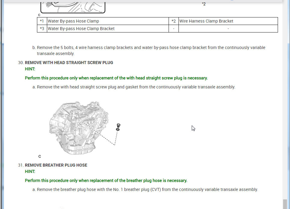

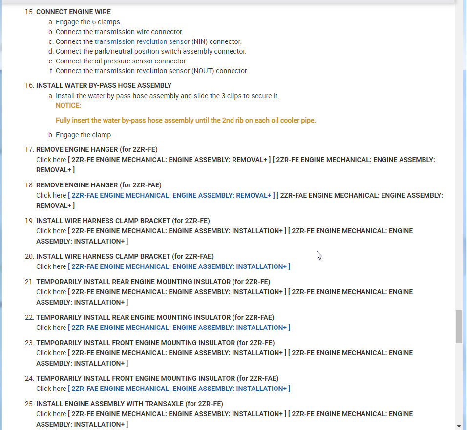

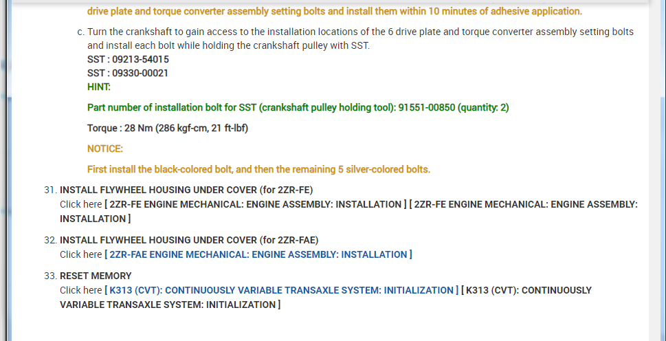

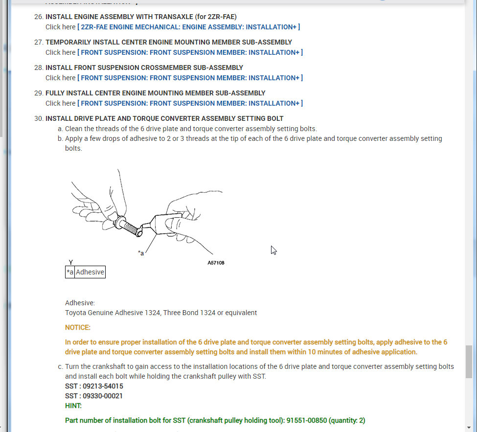

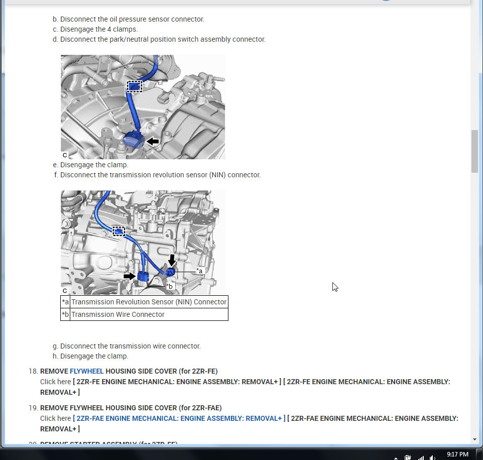

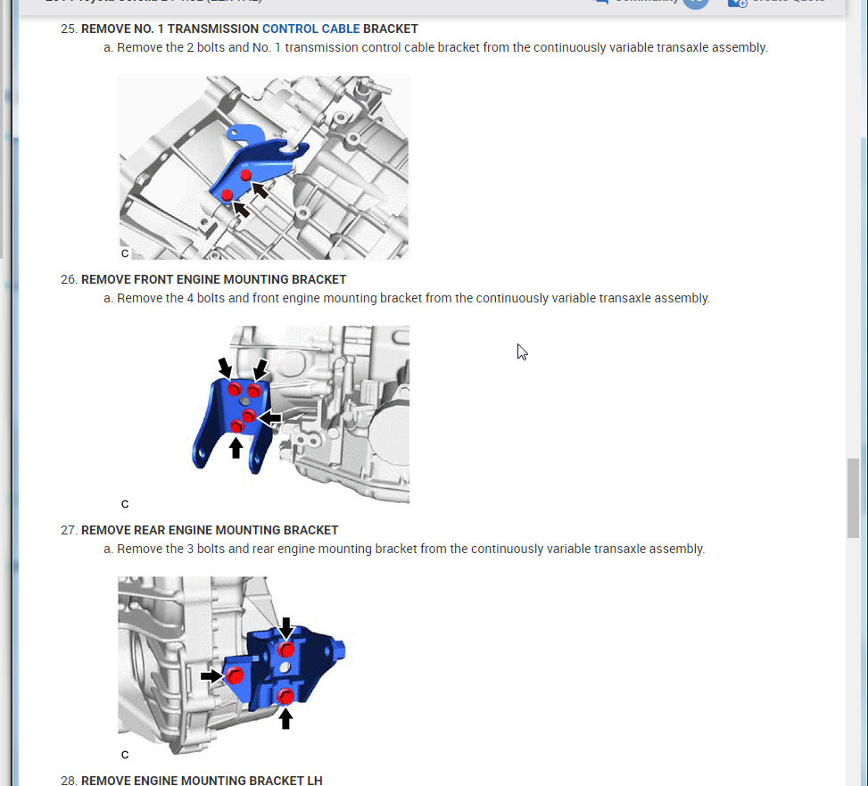

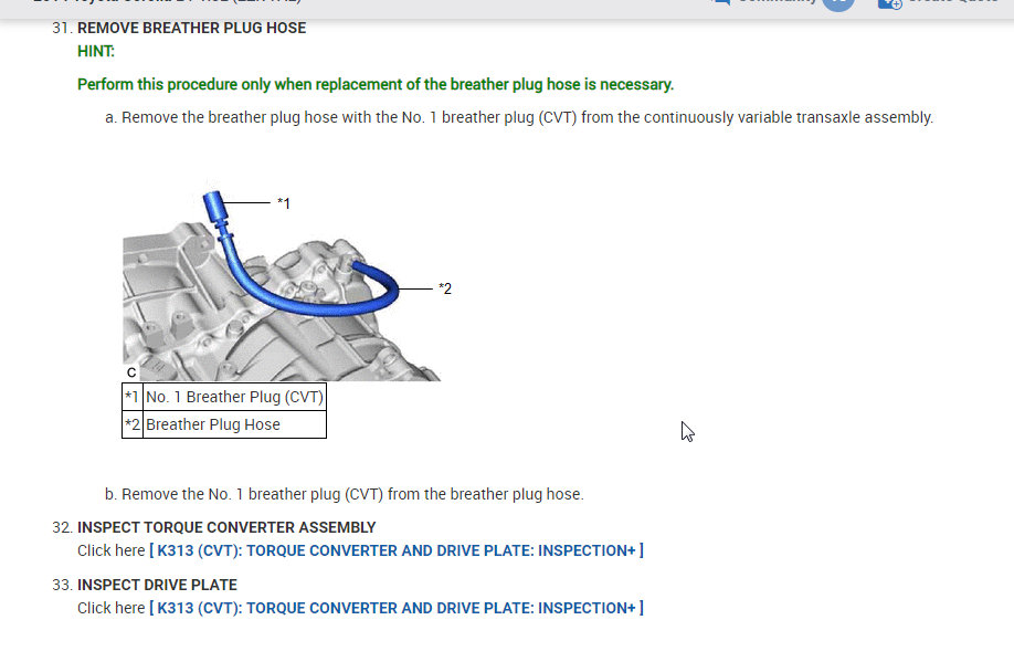

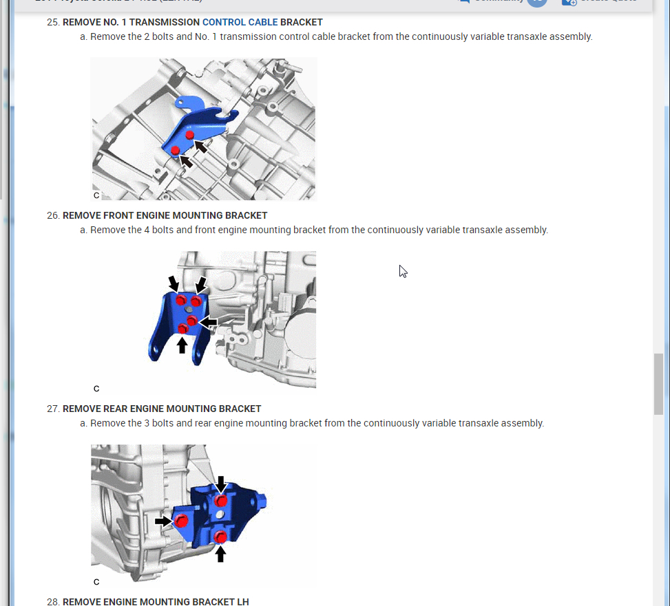

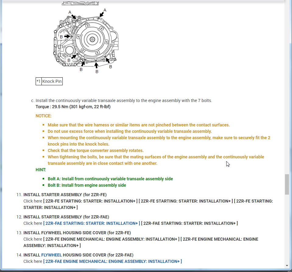

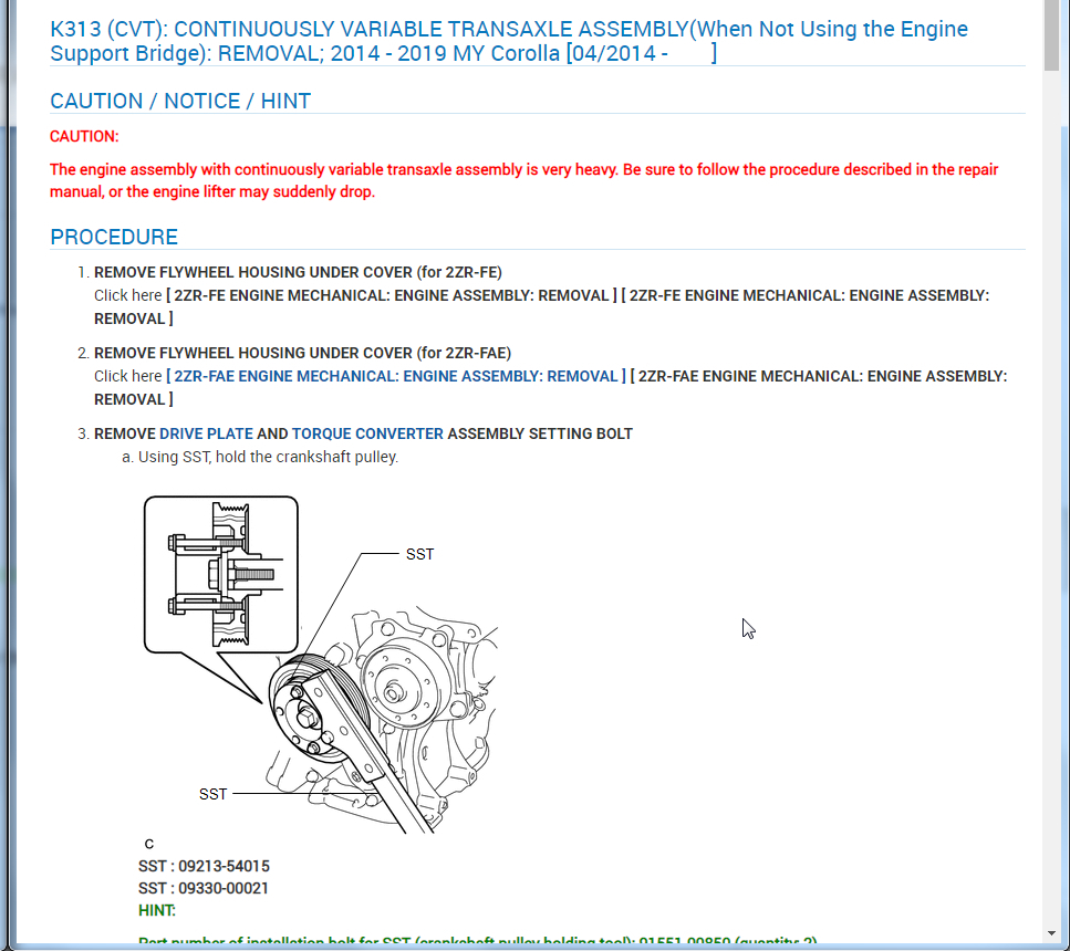

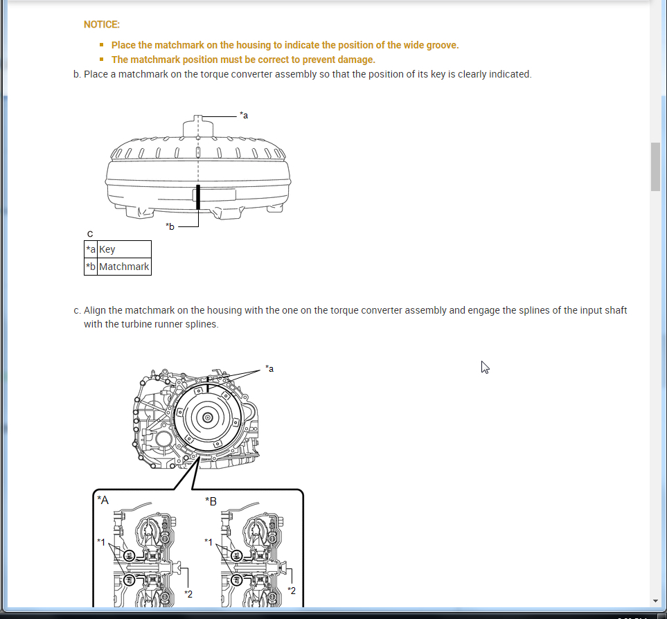

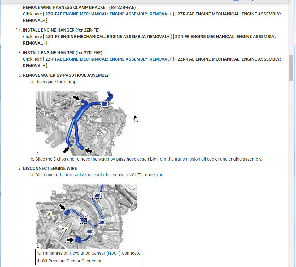

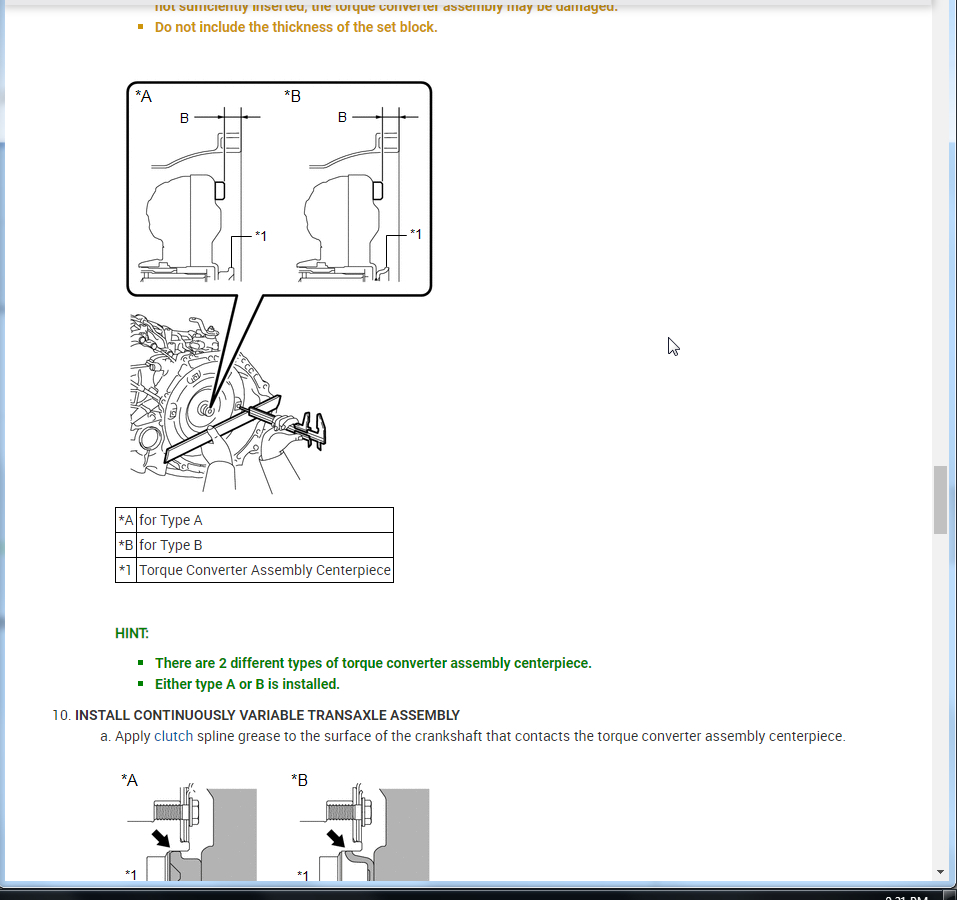

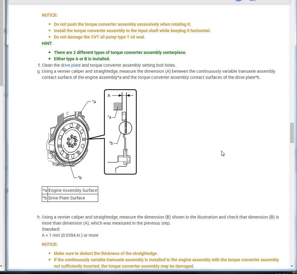

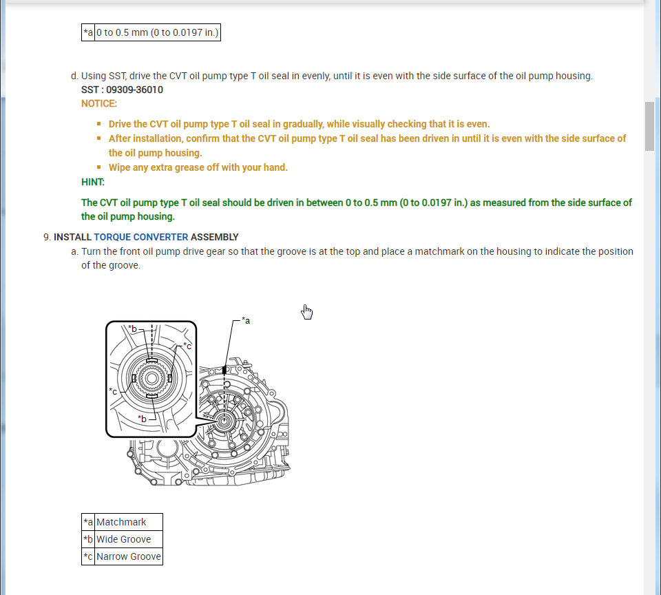

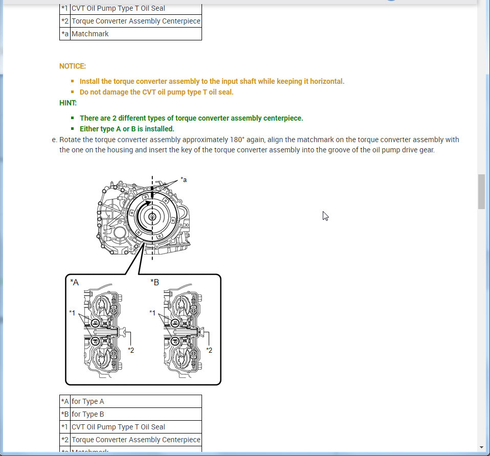

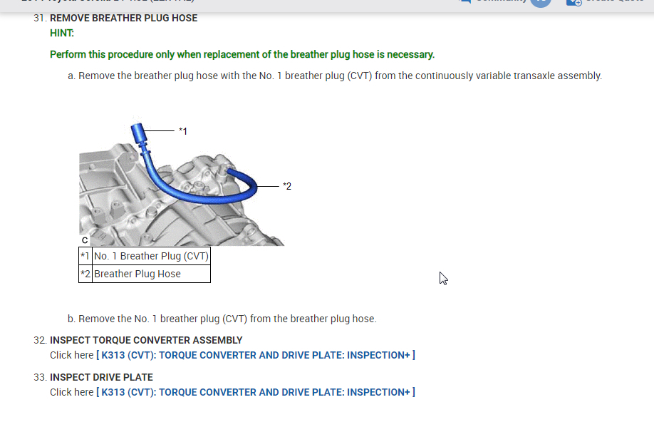

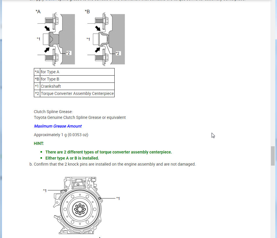

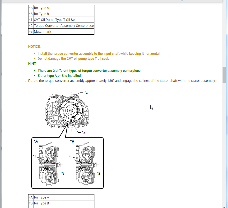

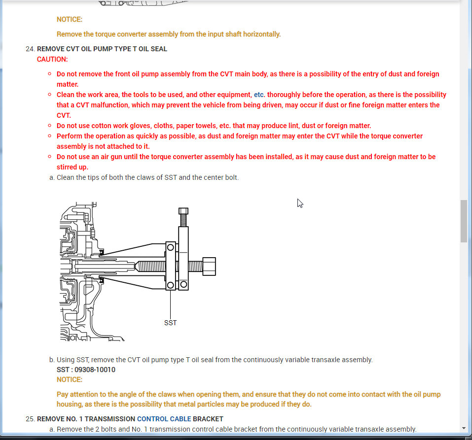

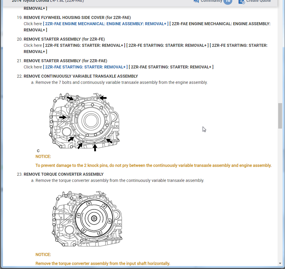

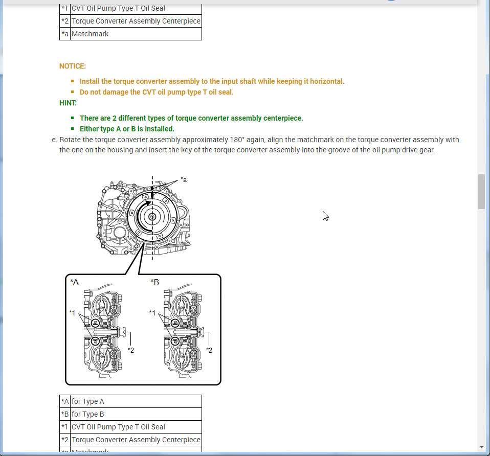

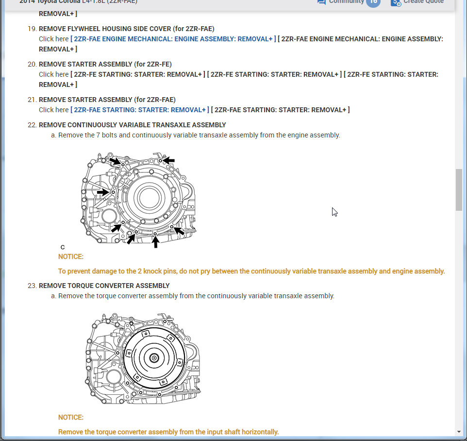

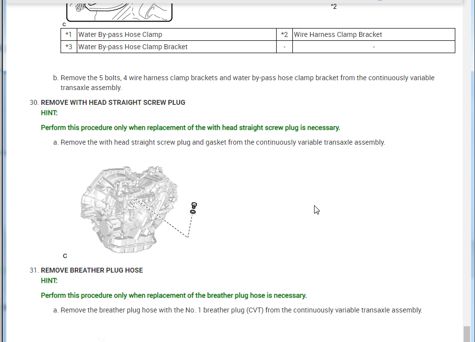

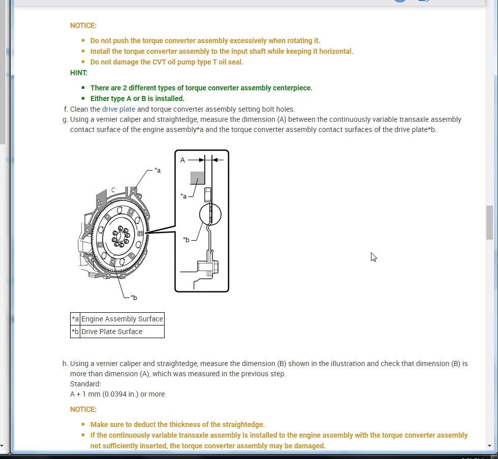

No problem. Here are the instructions from the manual that will help with replacing the transmission on this vehicle.
Also, here is a guide that will help with replacing an automatic. While this is a CVT it is still similar to this process.
https://youtu.be/3vJAojsrfuU
Below is the process from the manual that will help. Please let us know if you have other questions. Thanks
