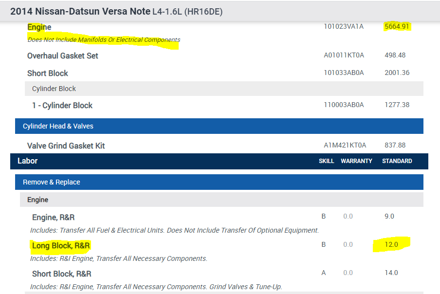

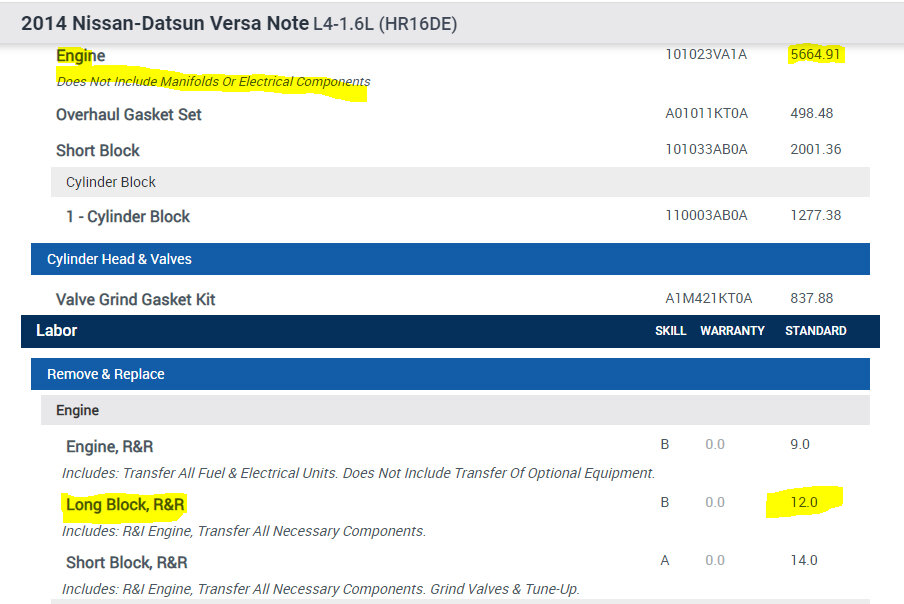

As far as the engine locking, there are a number of things that can cause it. However, although there are many causes, ultimately the lock-up is caused by internal engine damage. You mentioned the term Magna Flux. That is a product used to check for cracks in engine blocks and cylinder heads. You also mentioned a rod knock. That is caused by excessive clearance between a bearing and what it is connected to, the crankshaft. The noise doesn't cause the failure, but rather, it is an indication there is a problem that will ultimately lead to failure.
Next, on many of the newer vehicles, a failed timing belt or timing chain can cause internal damage to the engine. Today's vehicles have very limited clearance between the top if the engine piston and the valves in the cylinder head. If timing is off or there is failure to the belt or chain, the top of the pistons can hit an open valve bending it. As a result, you would lose engine compression and likely need to replace the cylinder head. Can that happen to your vehicle's engine? It can. All modern Nissan engines are considered interference engines.

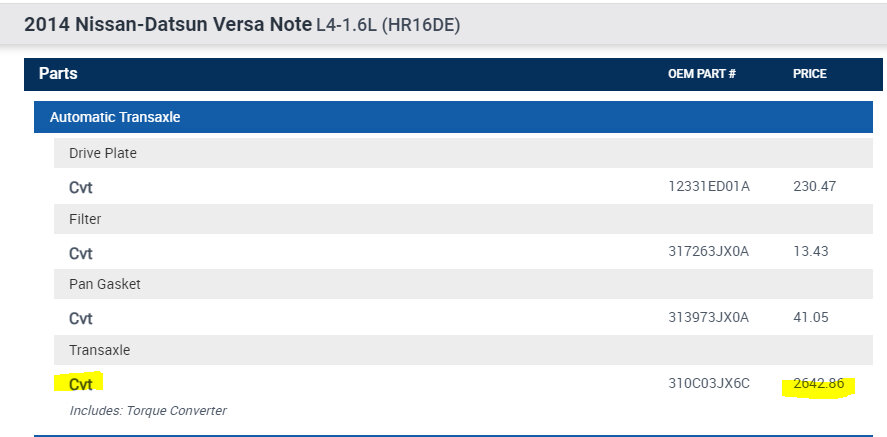

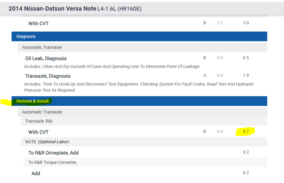

I do have a suggestion. When you purchase your next vehicle, try to stay away from the ones that have a CVT transmission. They are known to fail much faster than a traditional automatic transmission. Also, when one fails, in almost all cases, the repair is the replacement of the transmission.
