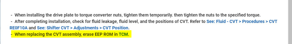

Had the CVT transmission replaced with a used one from the same month/year.
The new one makes a scraping/bearing, whining noise. Other wise it functions perfectly. The place I bought it from says that the TCM needed to be programmed, but I don't think so. Please advise.
