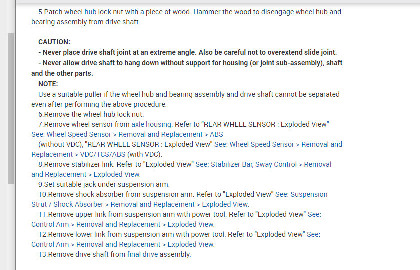

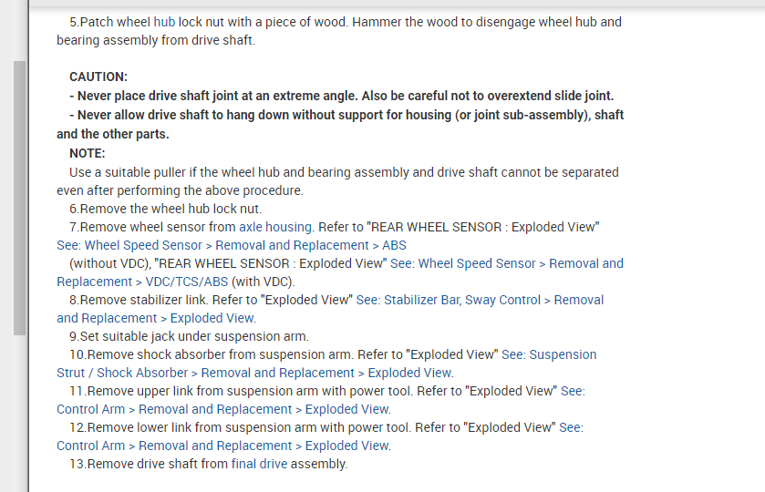

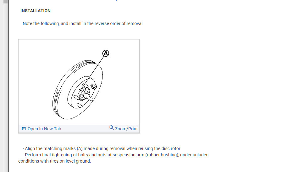

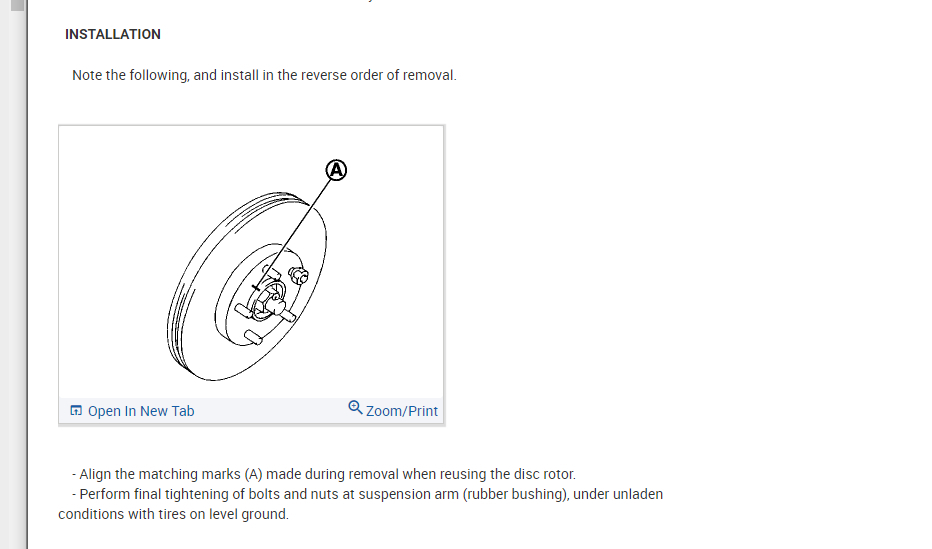

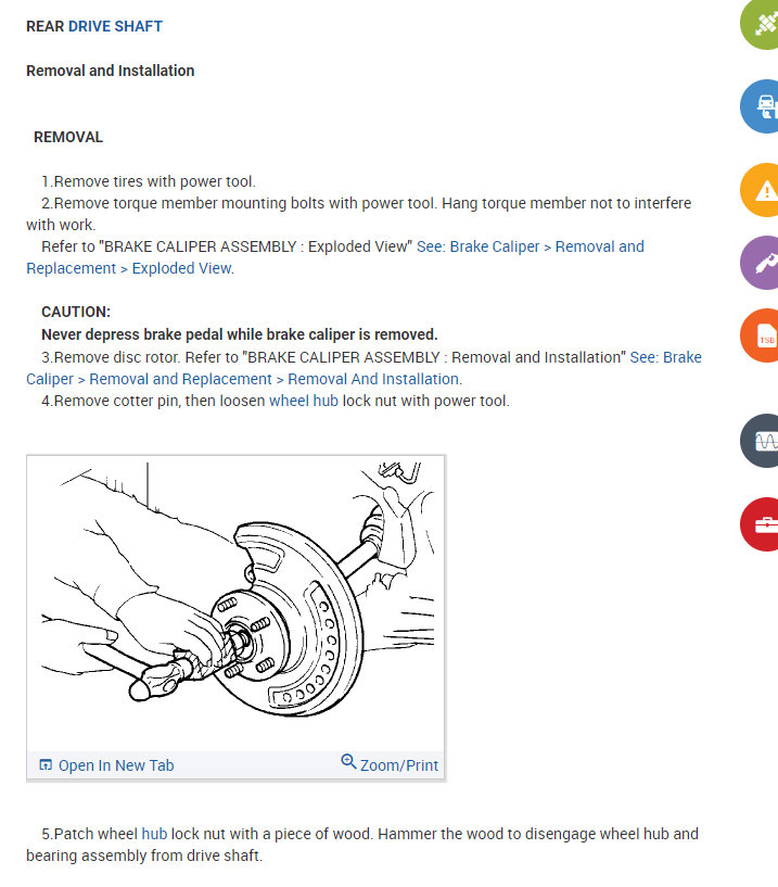

I am also attaching the info from the manual below on the rear axles. You need to remove the caliper, but it appears the cable can stay attached.
Please run through this info and let us know what other questions you have. Thanks
