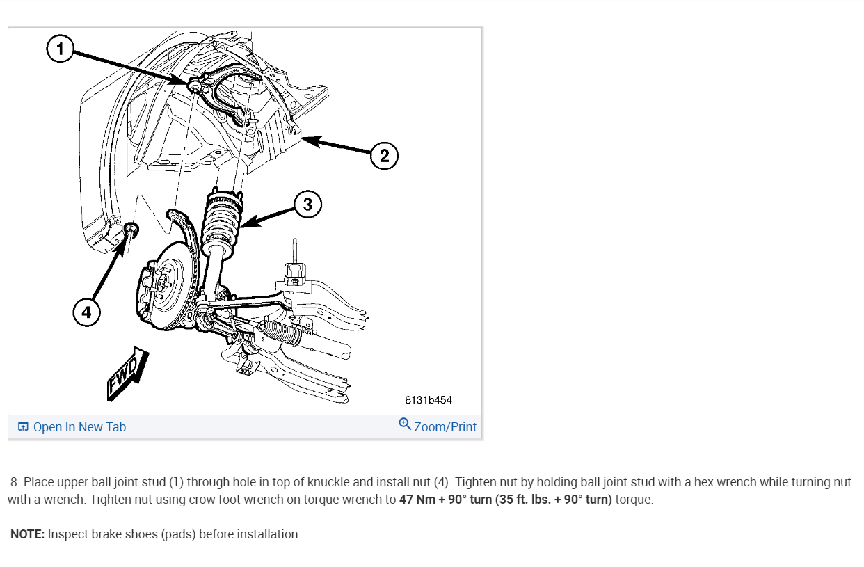

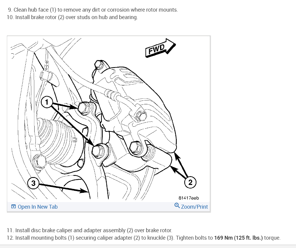

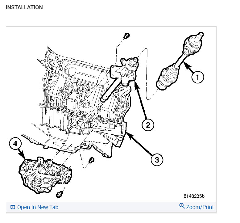

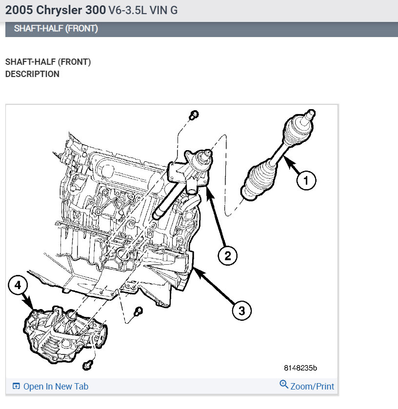

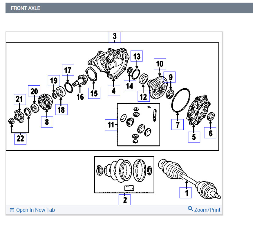

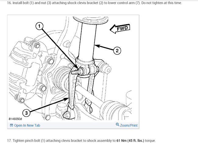

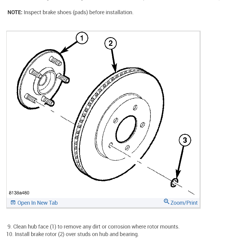

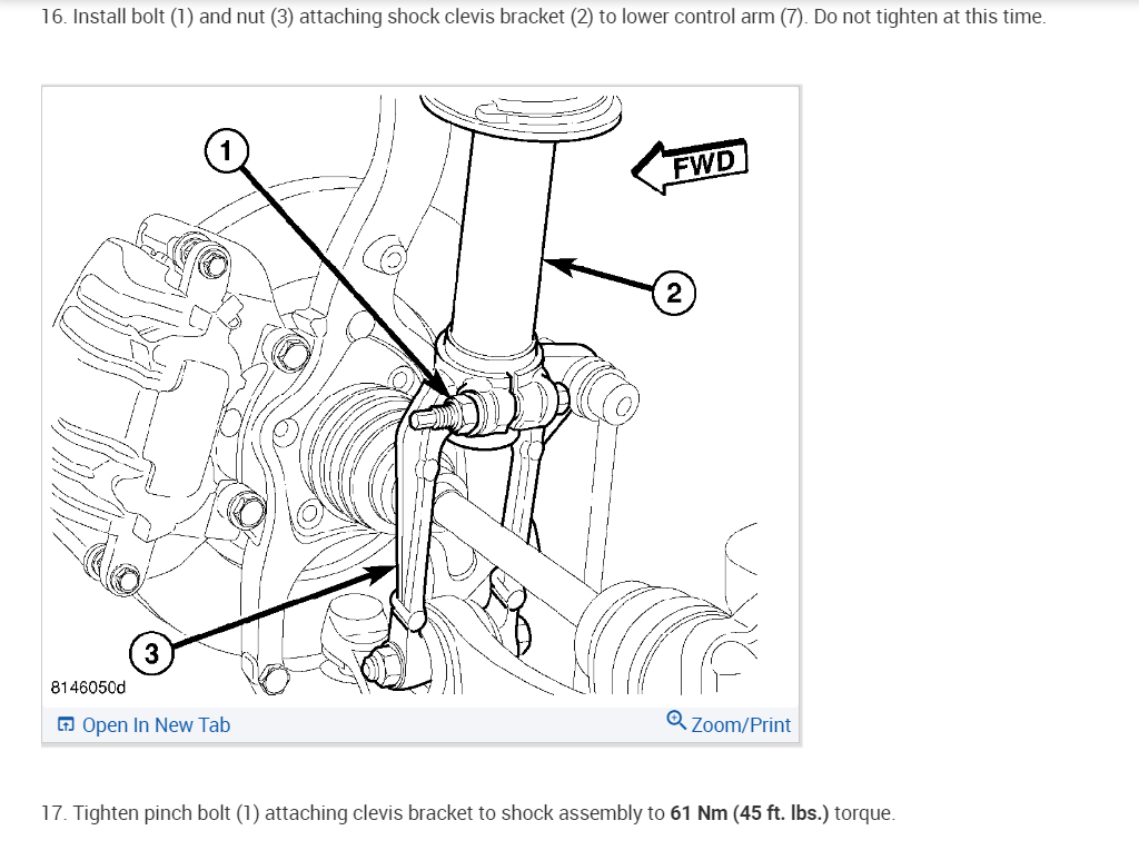

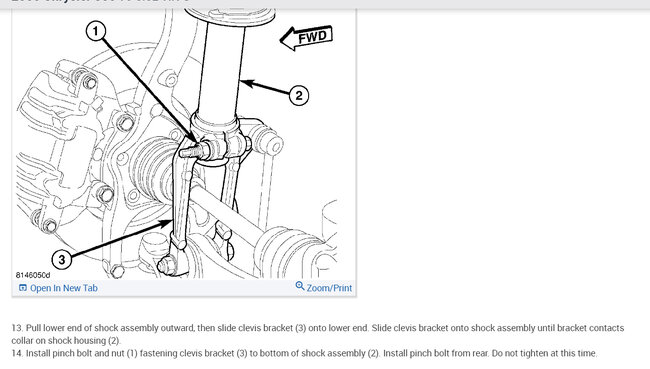

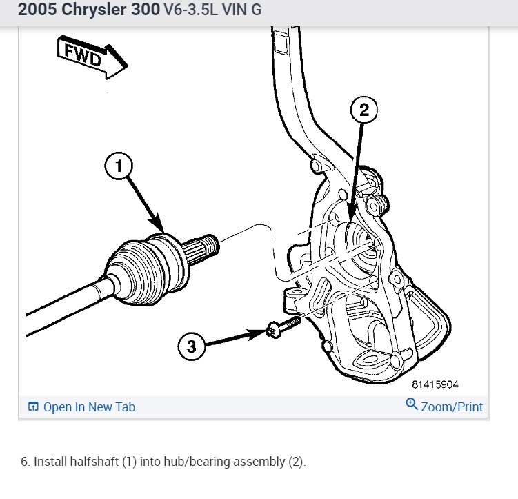

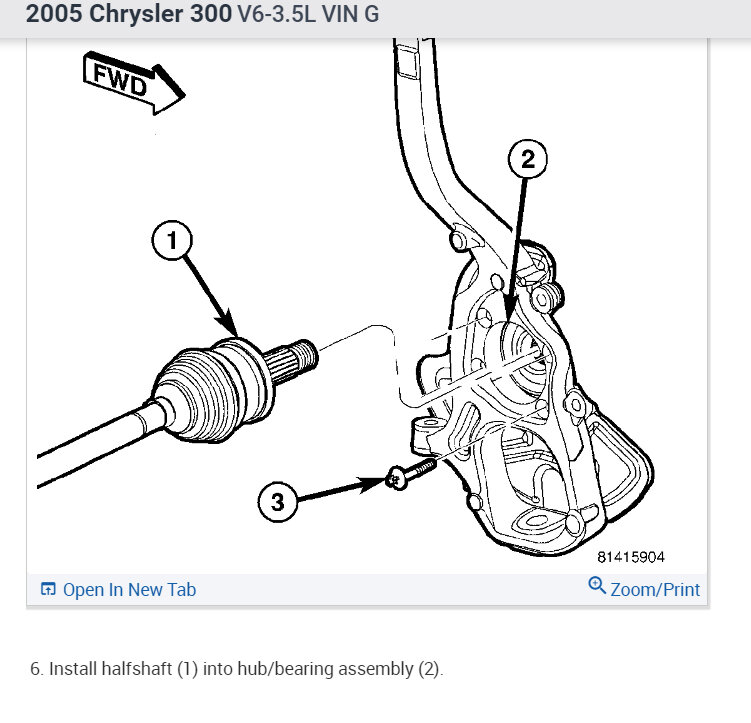

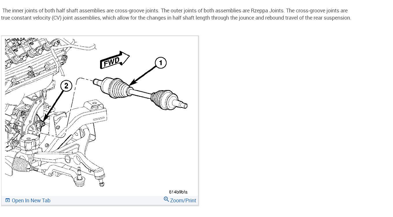

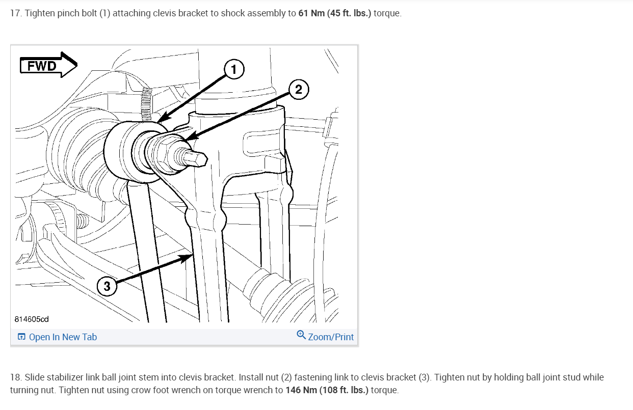

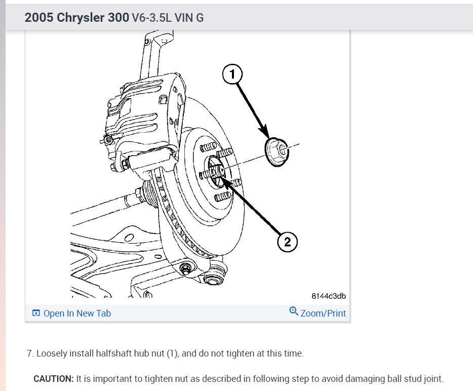

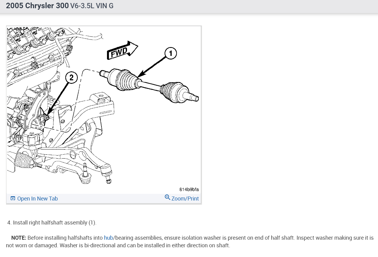

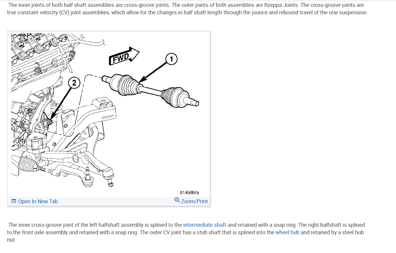

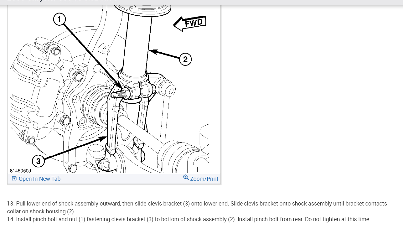

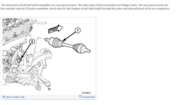

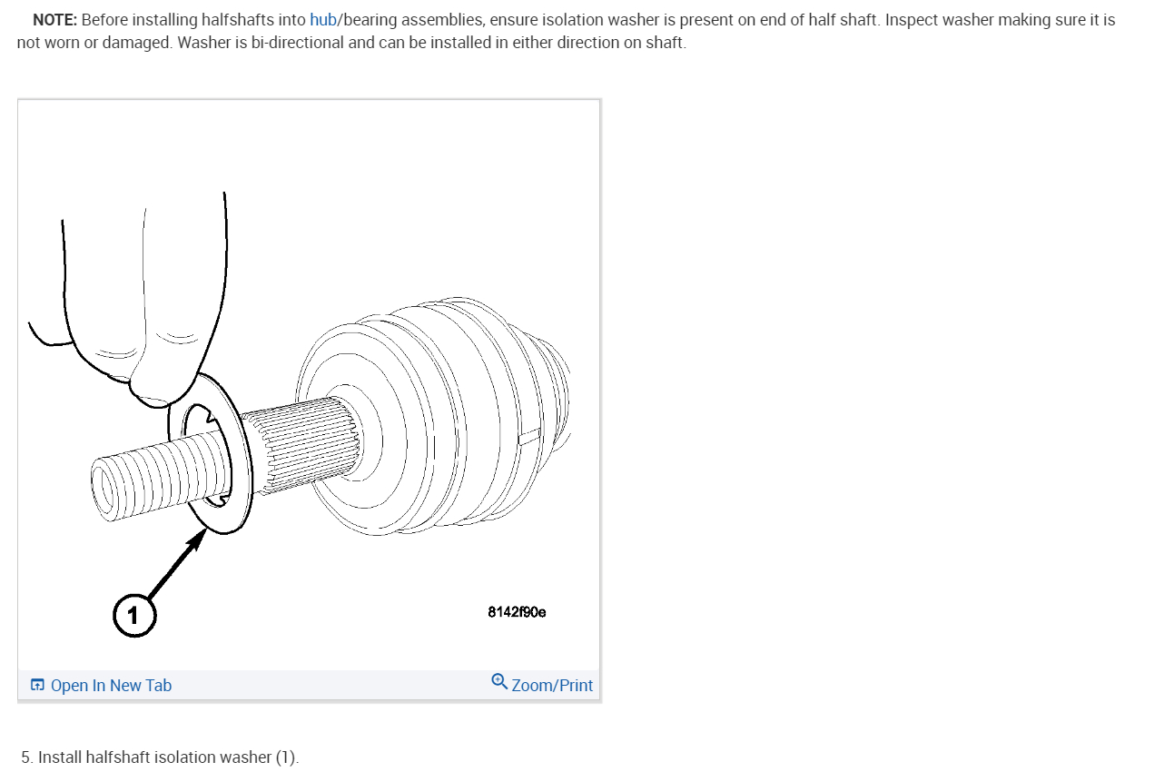

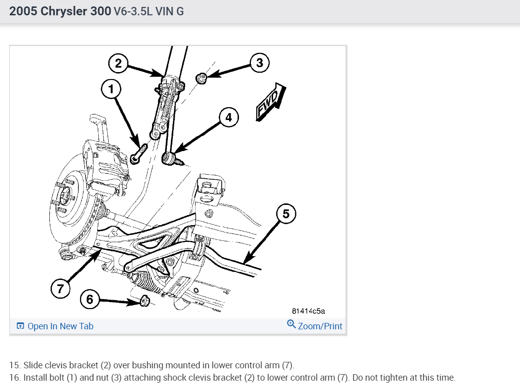

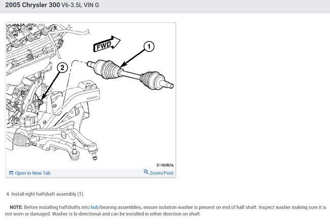

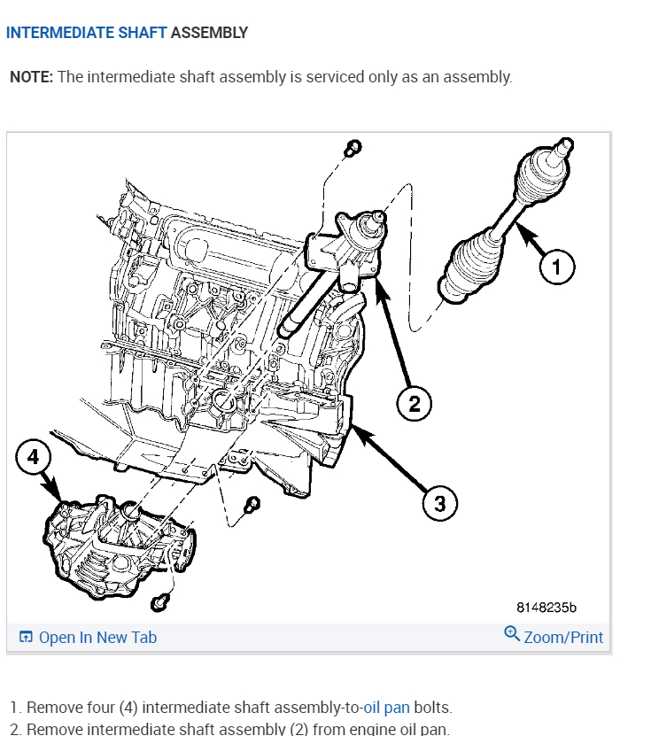

Yep, this is common when the CV axles need to be replaced.
Here is a guide to help walk you through the job with instructions in the images below:
https://www.2carpros.com/articles/replace-cv-axle
Check out the images (below). Please let us know if you need anything else to get the problem fixed.
