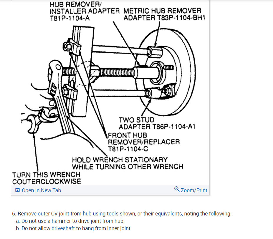

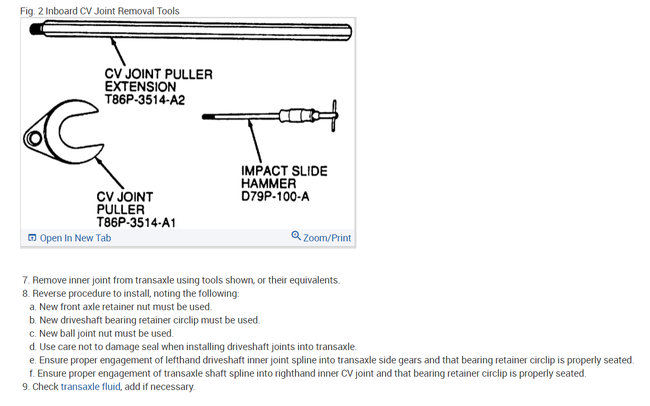

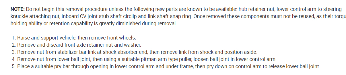

I would replace the entire axle assembly. They are reasonable in price these days. I attached the procedure for you below.

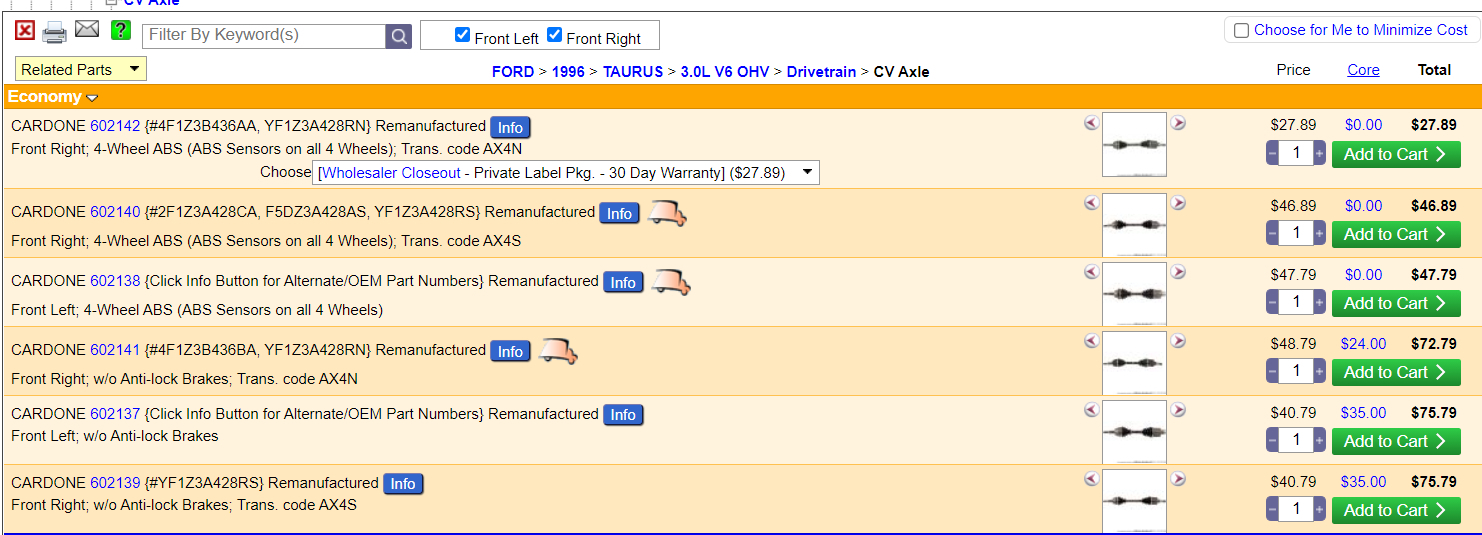

I also attached the axle shaft from Rock Auto for you to view.
