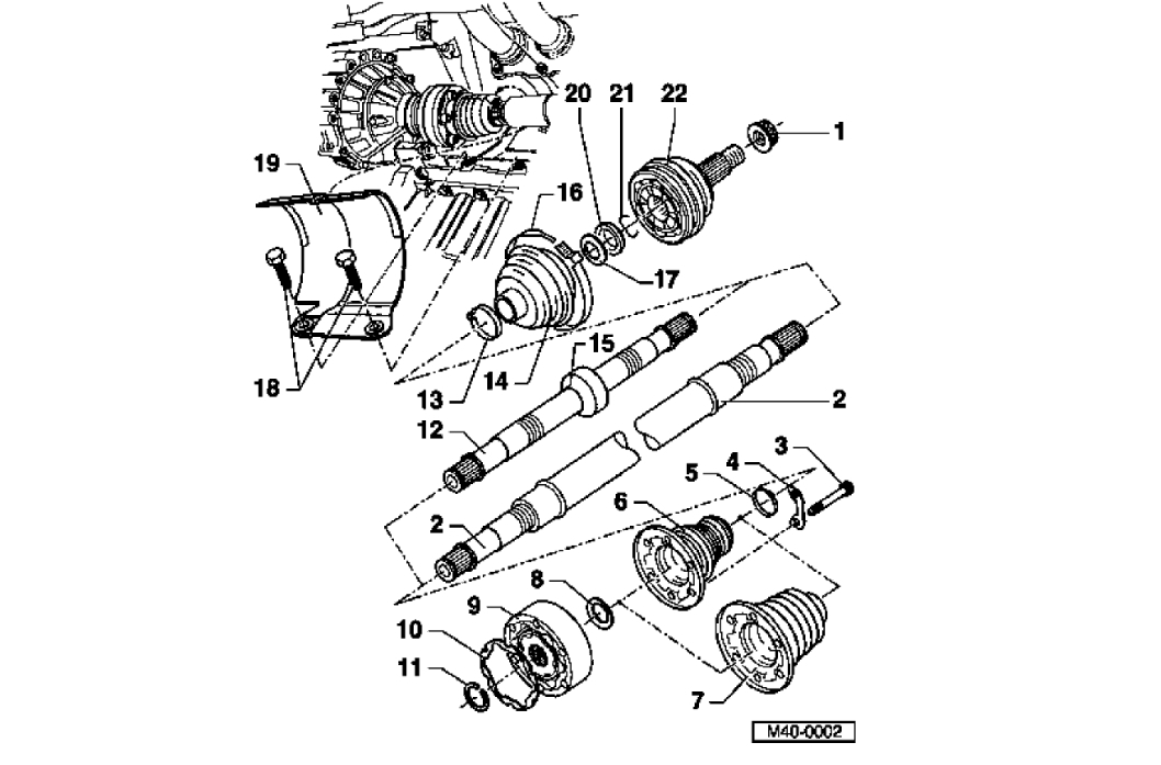

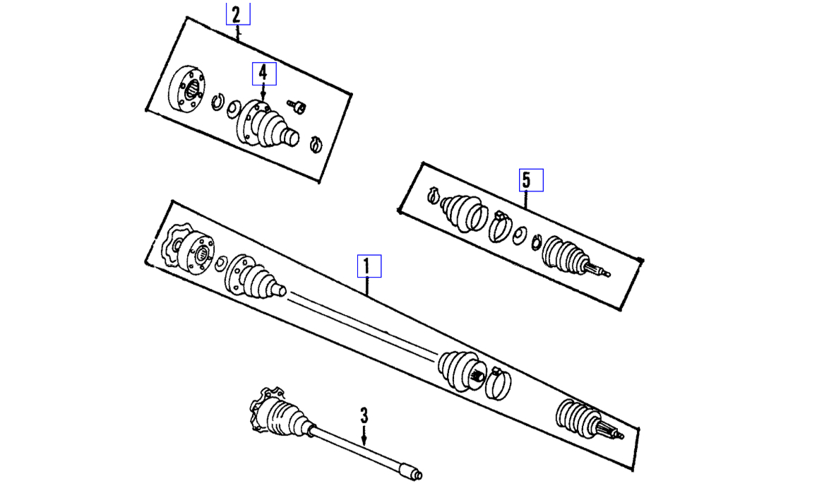

The axle assembly needs pried from the transmission. There is a clip that helps hold it in, but you can't remove it because it is inside.
I assume your vehicle doesn't have the flanged mount. If you look at the last pic, I circled the clip that is helping hold it in. When you reinstall it, make sure that the axle is fully installed otherwise, the vehicle won't move and you won't have park.
Here are the directions specific to your vehicle. All attached pics correlate with the directions.

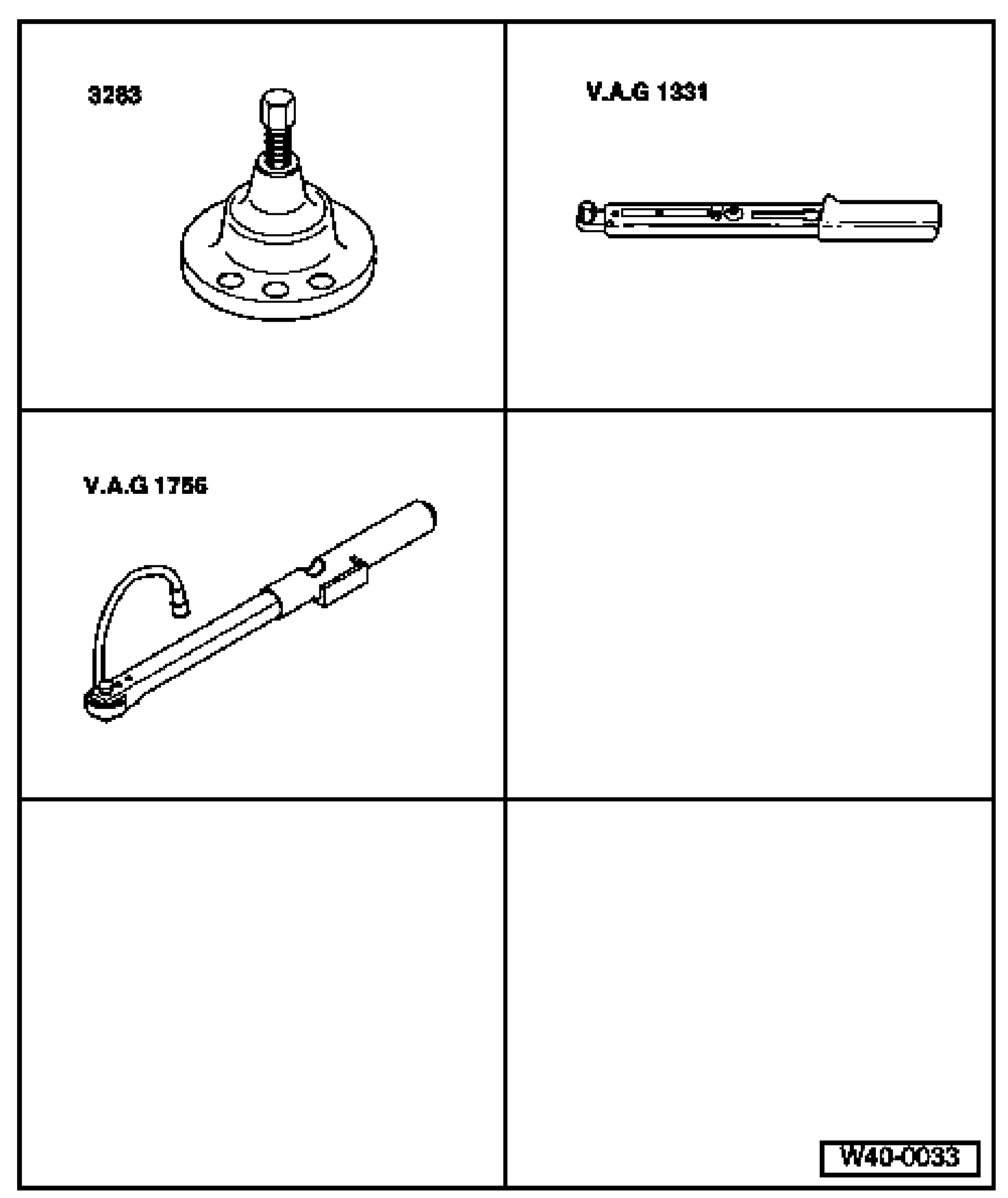

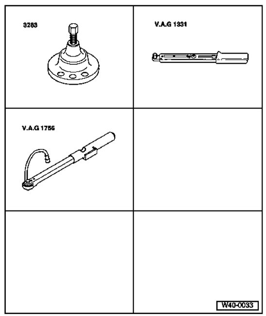

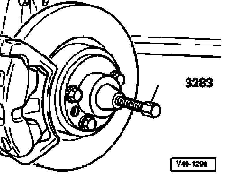

Special tools and equipment
^ 3283 Hub puller
^ VAG 1331 Torque wrench
- VAG 1756 Angle measuring wrench

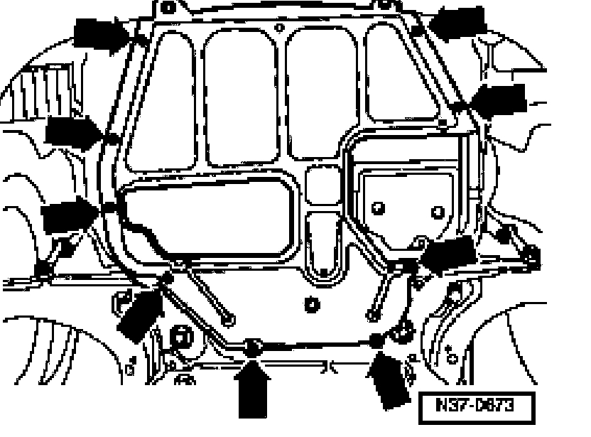

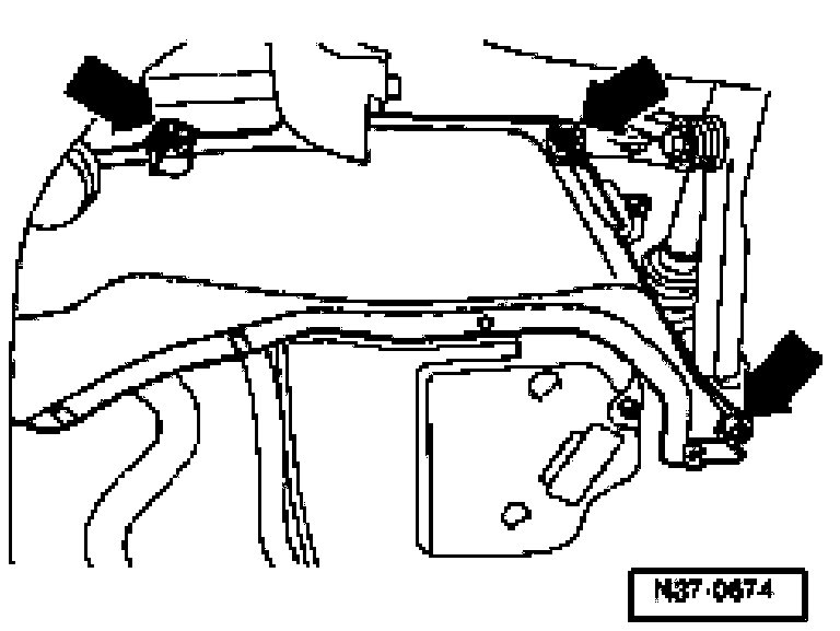

- Remove noise insulation panel -arrows-.

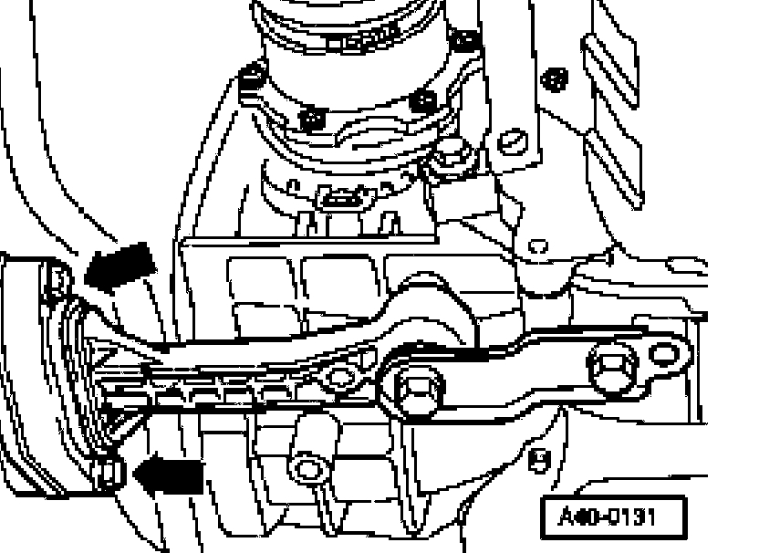

pic 3
- Remove left-side noise insulation -arrows-.

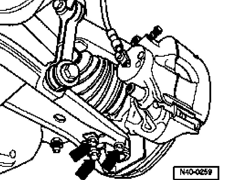

- Mark installation position of ball joint bolts on control arm.
pic 4
- Remove bolts -arrows-.

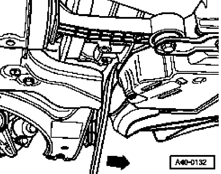

Vehicles with automatic transmission
pic 7
- Push engine/transmission assembly forward (i.e. using lever).
Now the triple roller joint drive axle can be removed
(The arrow in the illustration points forward)

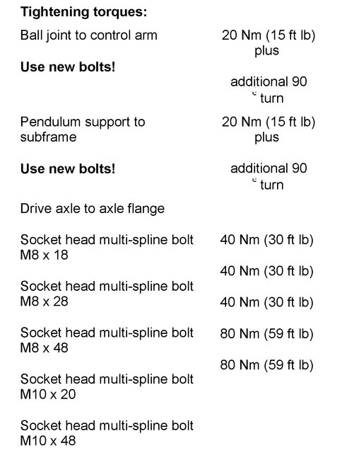

- Connect ball joint to control arm using new bolts on old marks.

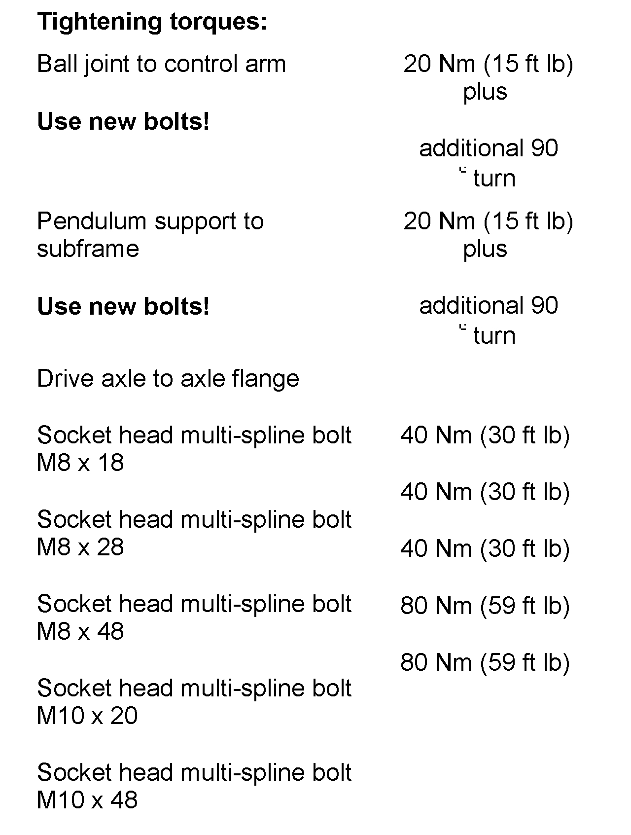

pic 8
- Tighten 12-point nut to 300 Nm (221.3 ft. lbs.) and then loosen one turn.

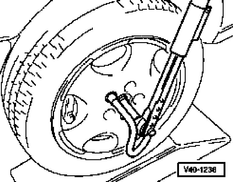

pic 9
- Tightening 12-point nut.
Tightening torque:
50 Nm (37 ft. lbs.) plus additional 45° turn
Note:
To tighten 12-point nut use VAG 1756.
Alternate final tightening of 12-point nut (if angle measuring wrench is not available):
- Lower vehicle until the wheels touch ground.
CAUTION:
The vehicle must be standing on its wheels when loosening or tightening the 12-point nut. Otherwise there is risk of an accident.
- Tighten 12-point nut to 50 Nm (37 ft. lbs.).

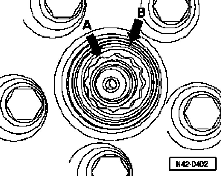

pic 10
- Mark point on nut with line -arrow A-.
- Mark a 2nd. line (arrow B) on the edge of the wheel hub above next point.
- Turn 12-point nut further until both lines align.
