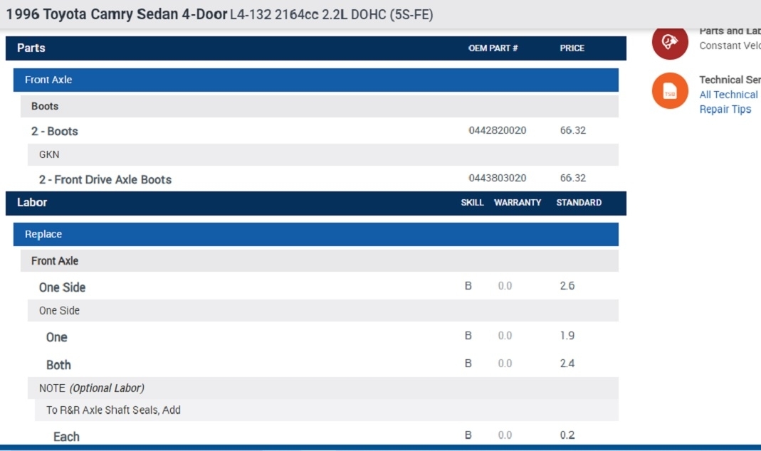

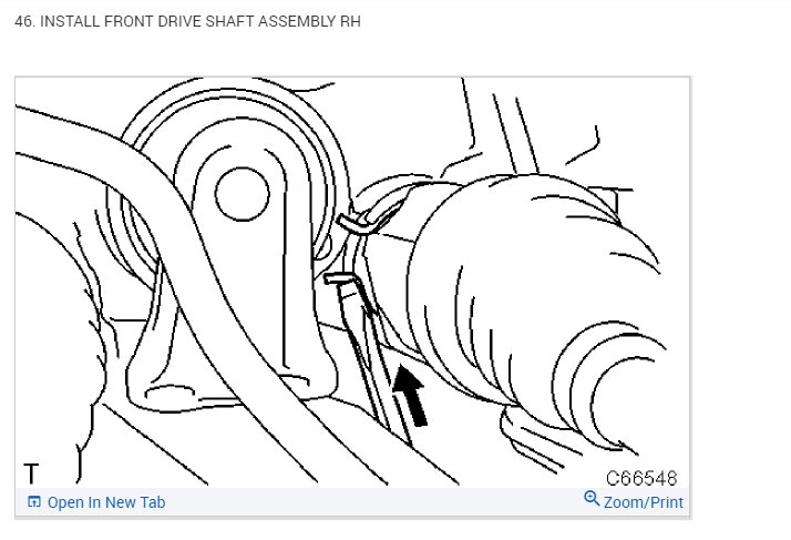

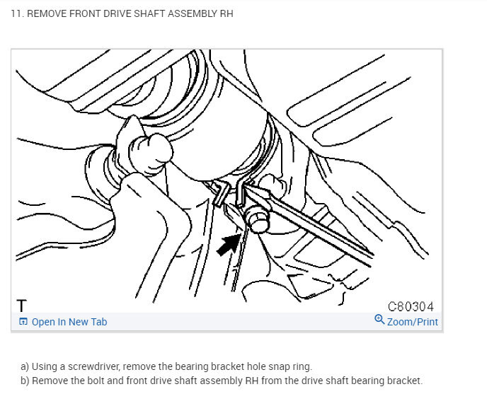

The procedure isn't listed on our online service manuals, but that's okay. There's a much better way to go, both for you and for your customer. One boot alone is listed as costing over $66.00 from the dealer. Expect the kit with grease to cost roughly half of that from an auto parts store. Compare that to the cost of a new half shaft, complete assembly. The most expensive one from Rock Auto is only $71.00. Doesn't show if that's new or rebuilt, but I did buy a brand new one for my '88 Grand Caravan a few years ago for $65.00. Why pay just as much for only the boot, then have to go through the work of replacing it?

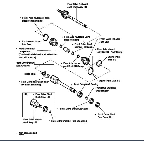

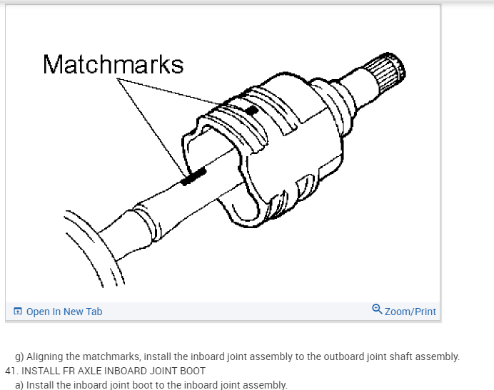

On a lot of imports, the inner cv joint can't be separated from the shaft. To replace an inner boot, you have to remove the outer joint and boot, then slide the new inner boot on from that end, then reassemble everything. It's a very messy job that's listed to take over 2 1/2 hours.

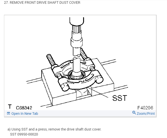

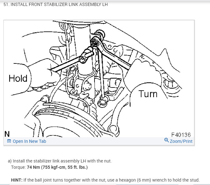

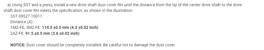

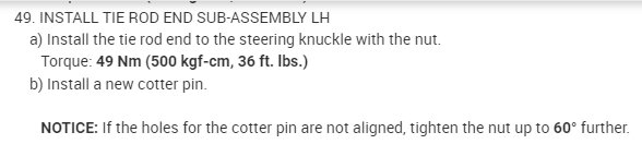

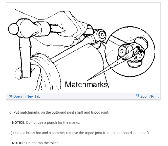

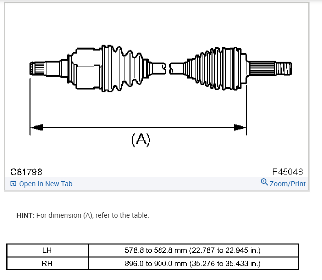

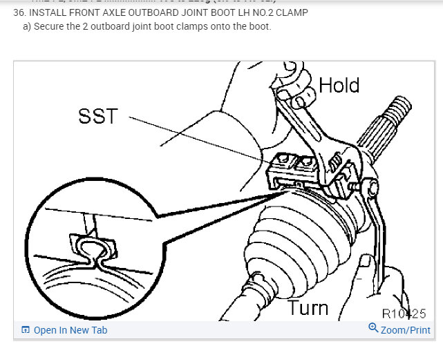

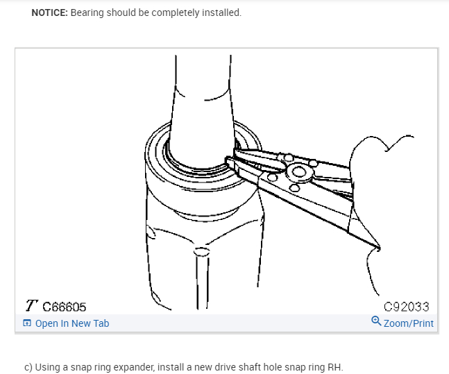

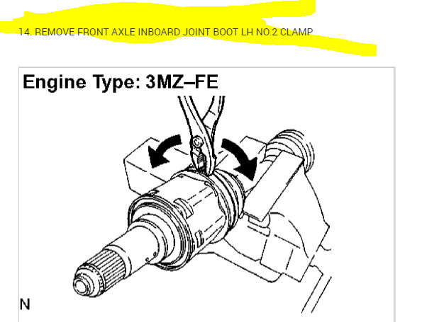

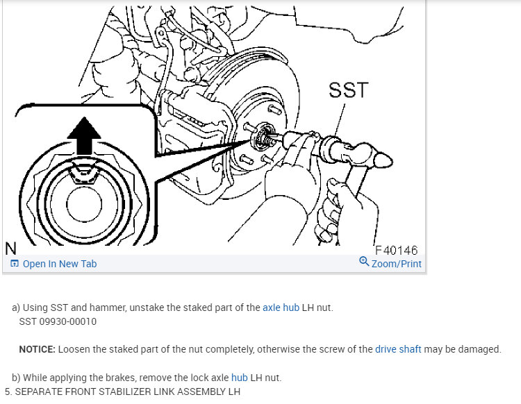

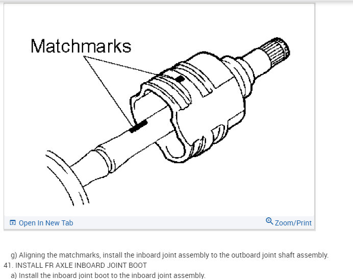

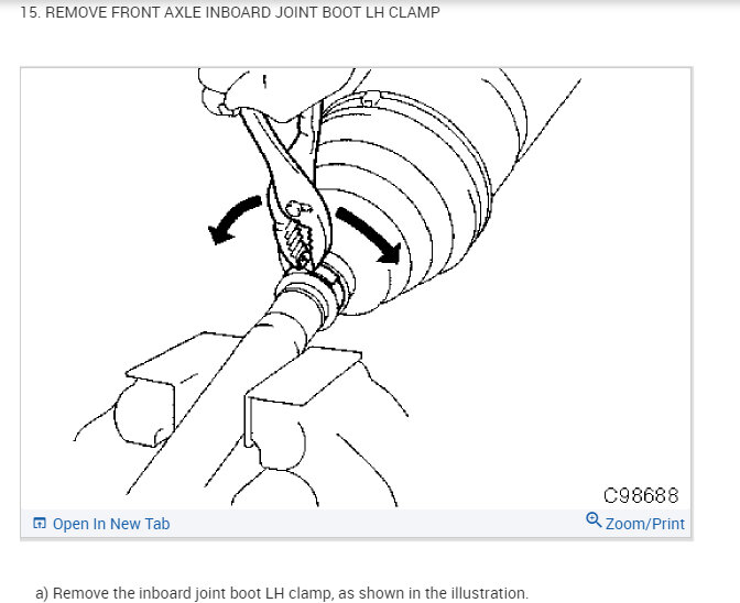

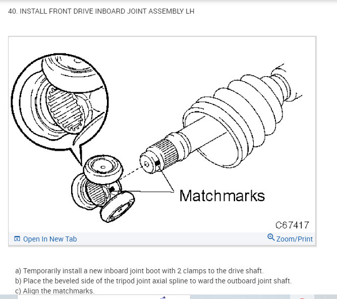

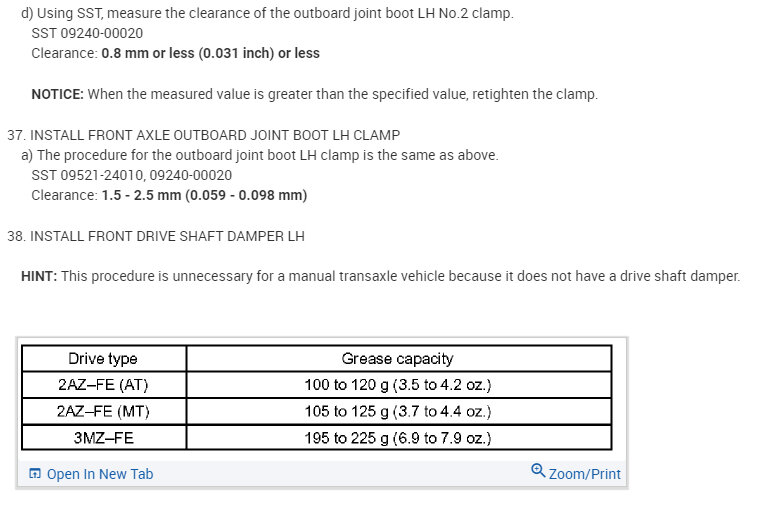

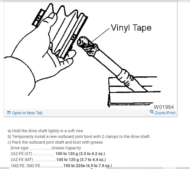

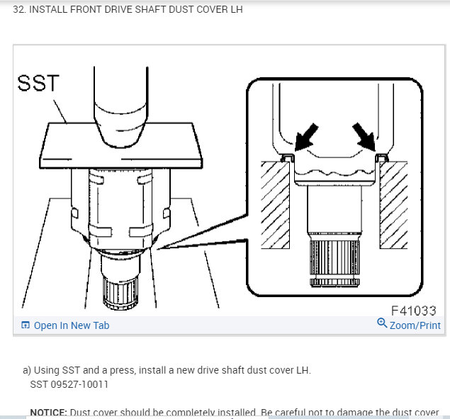

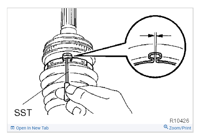

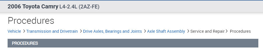

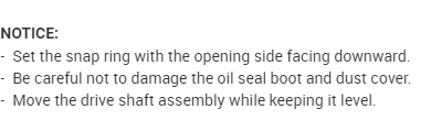

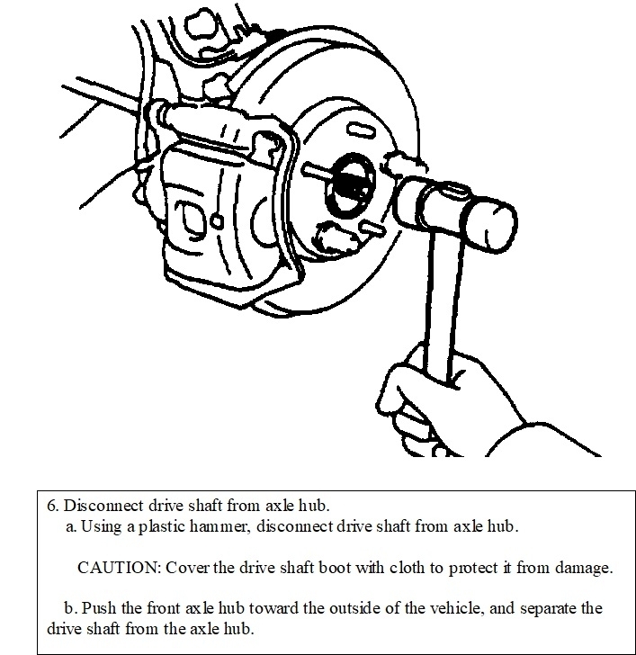

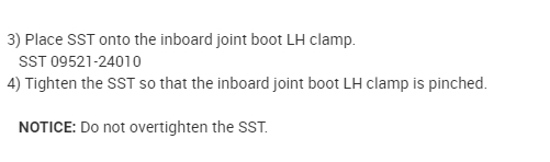

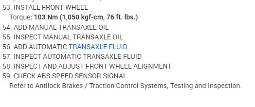

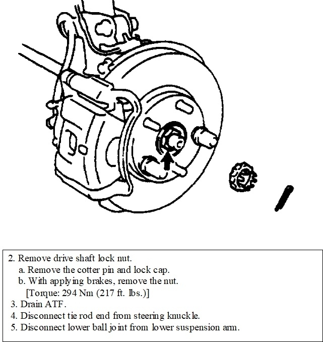

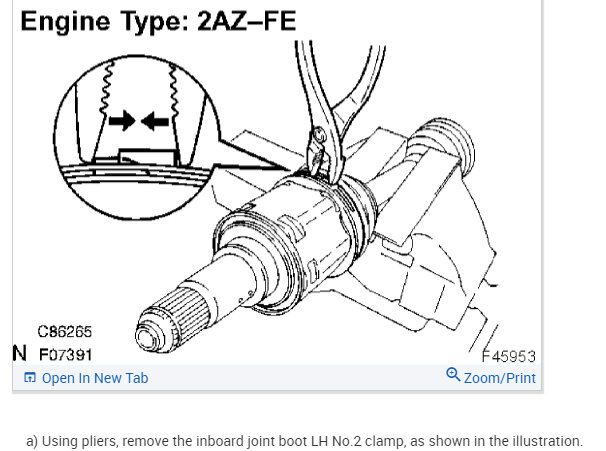

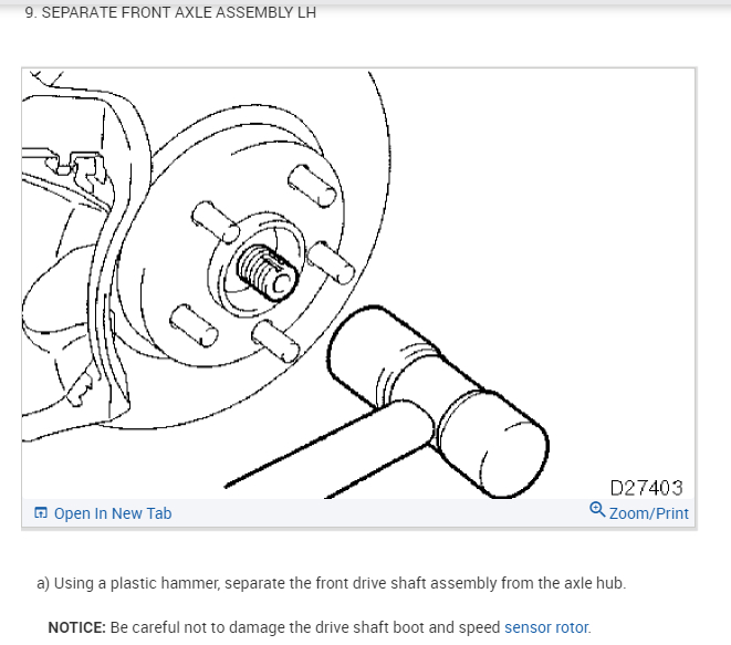

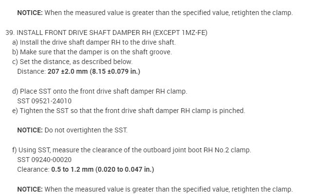

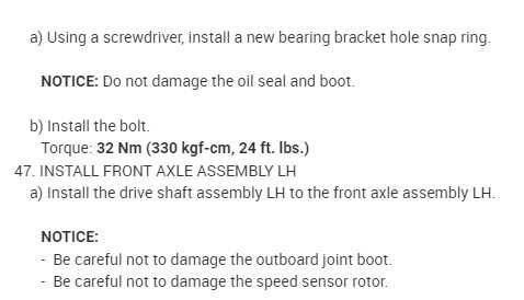

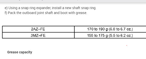

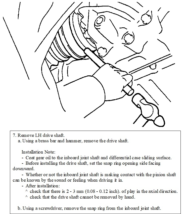

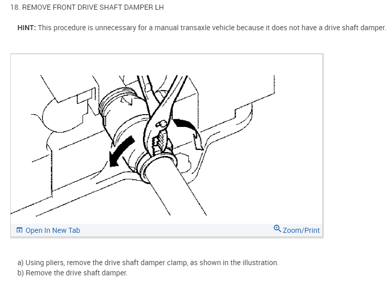

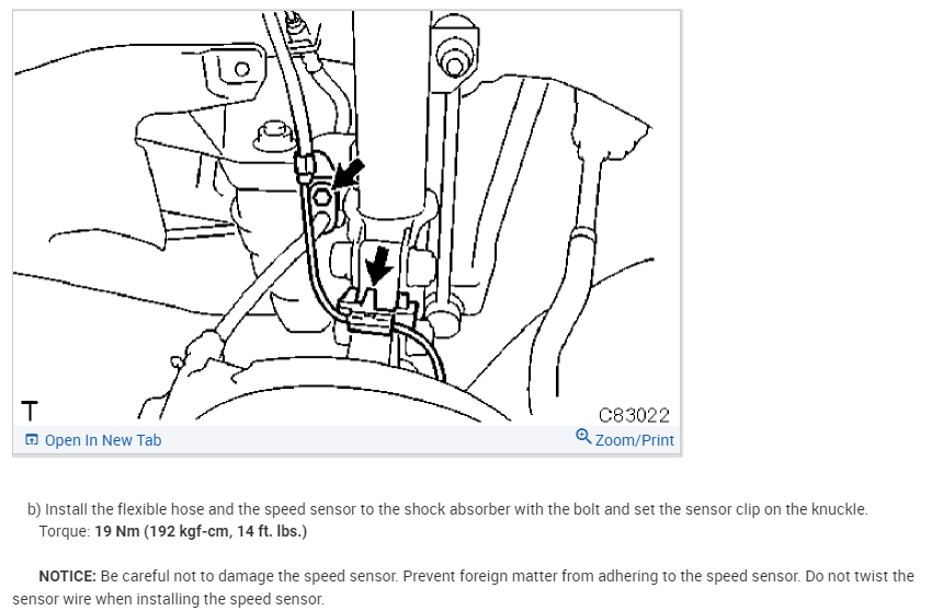

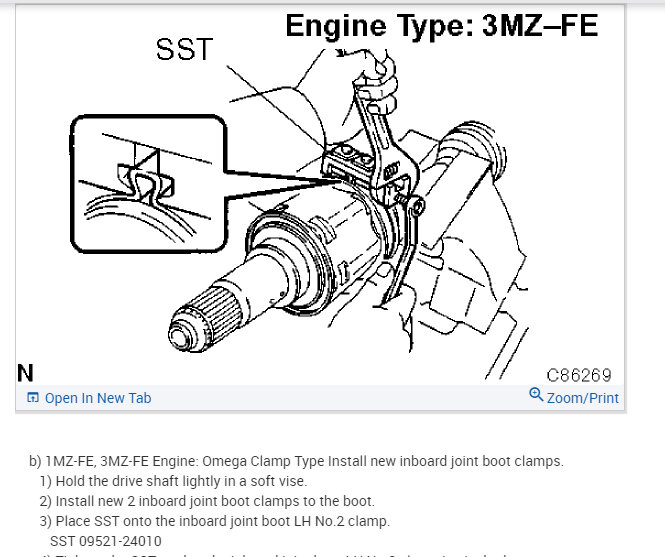

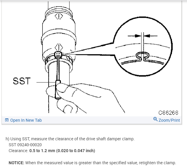

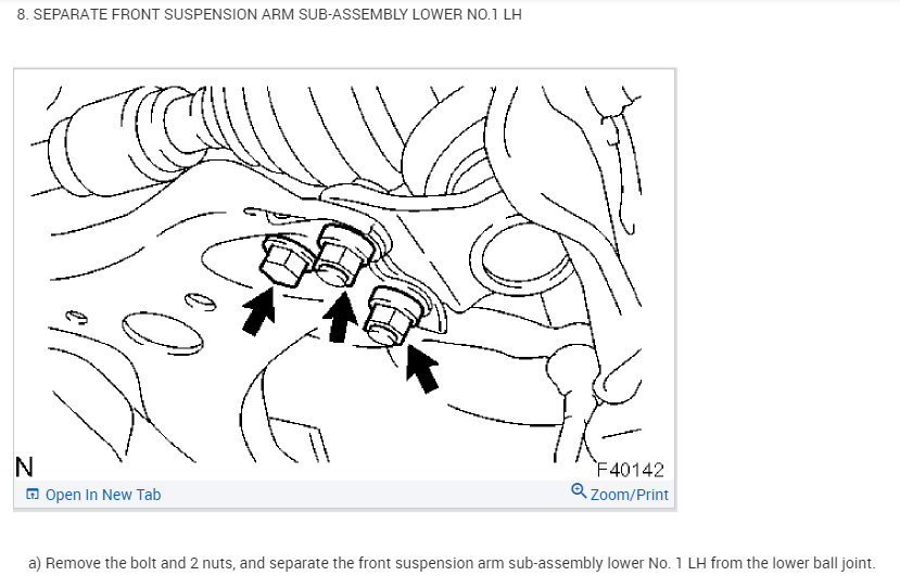

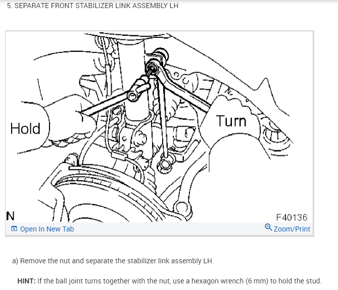

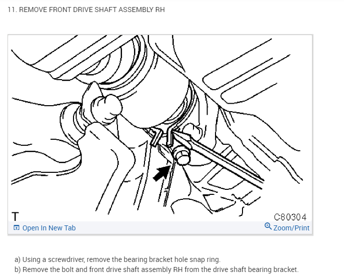

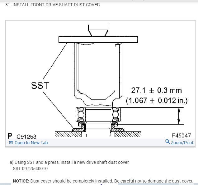

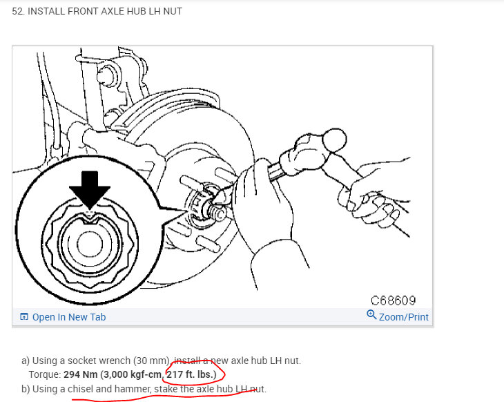

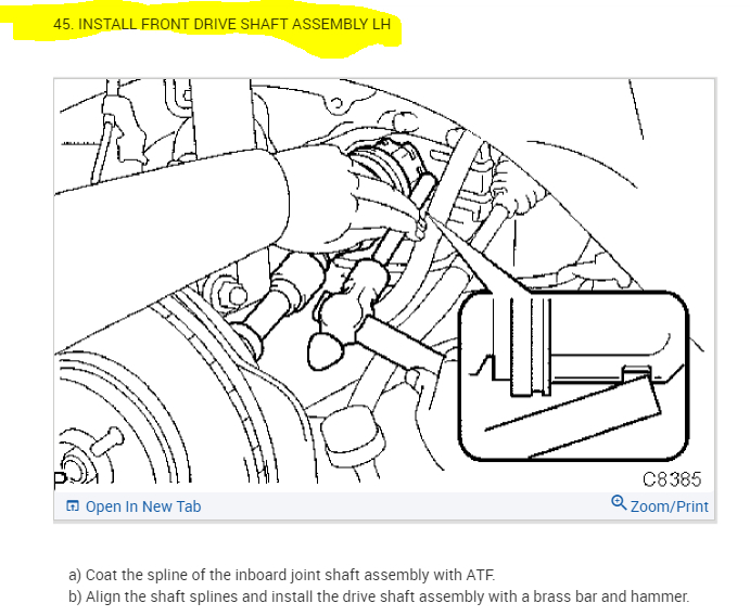

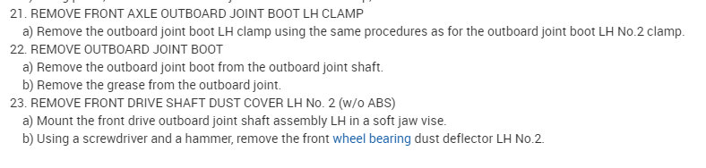

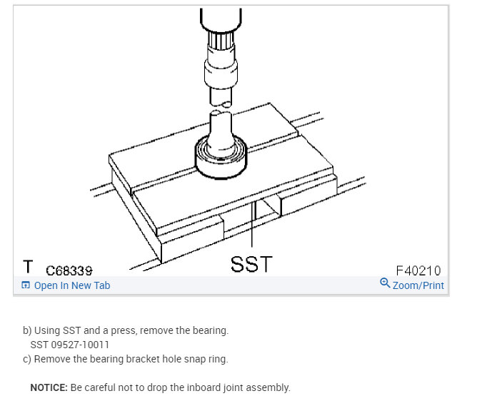

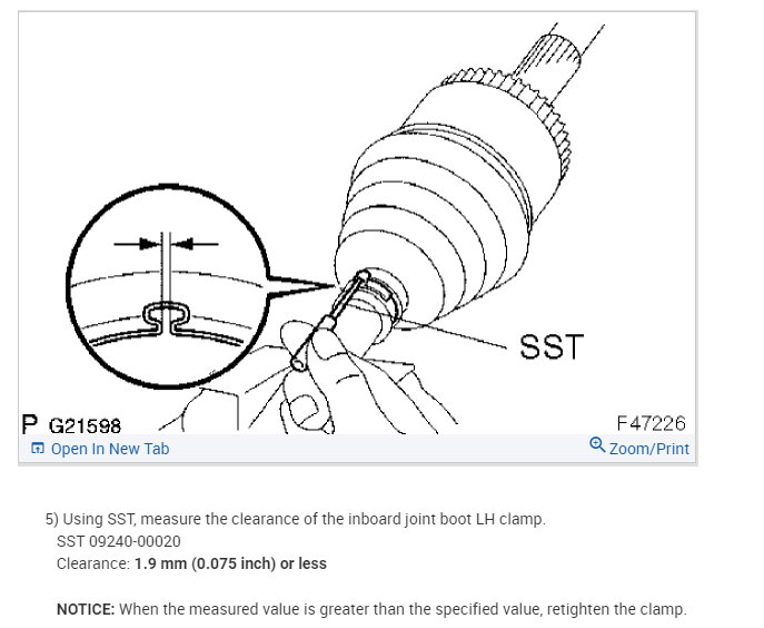

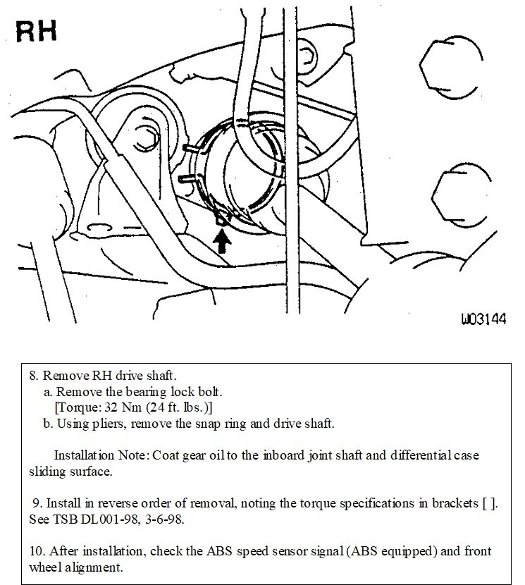

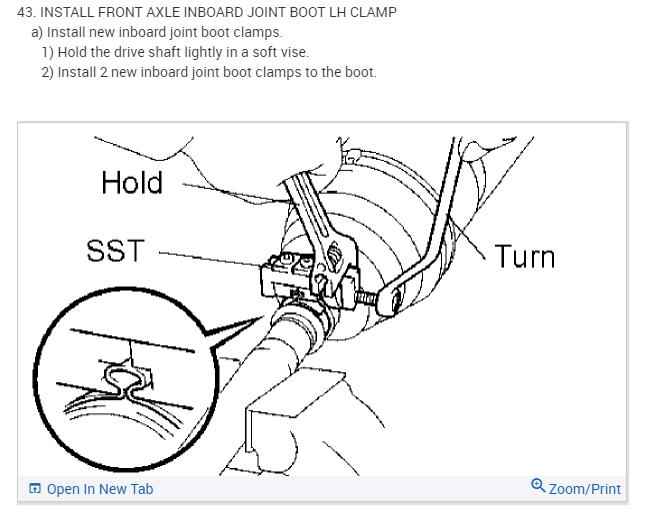

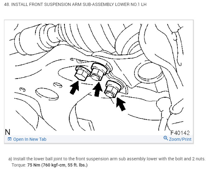

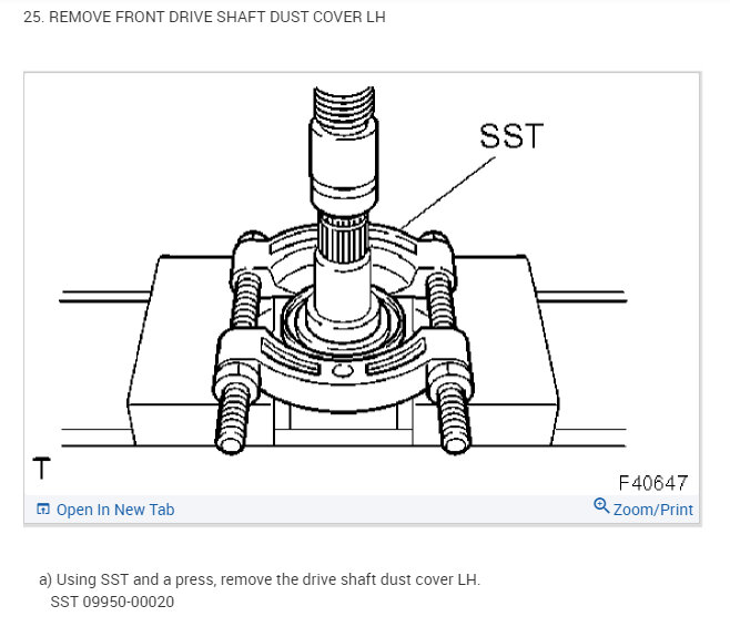

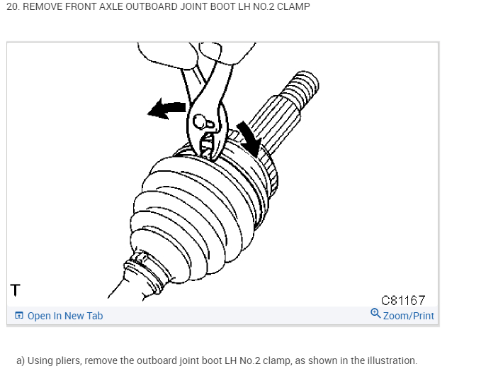

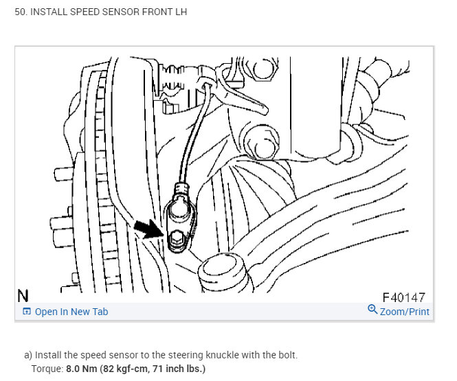

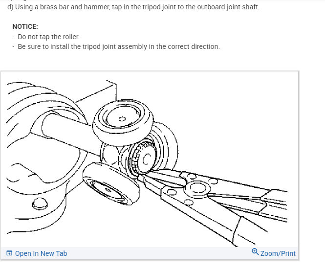

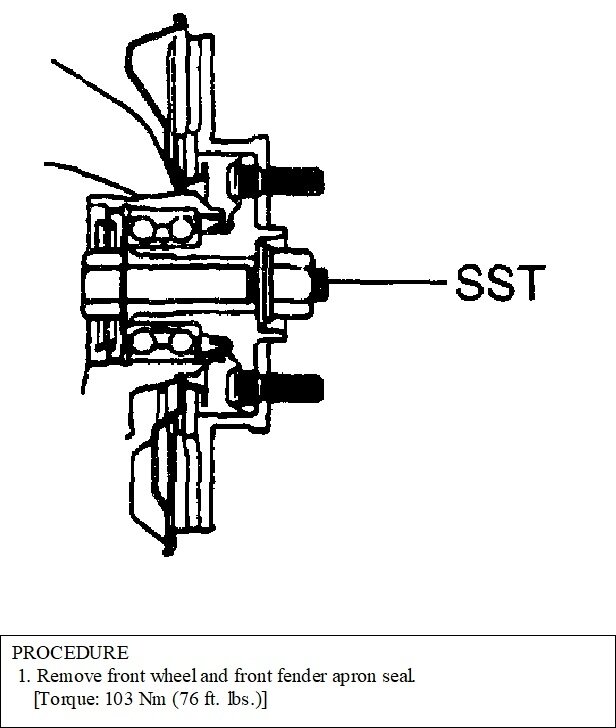

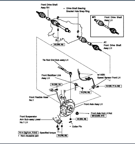

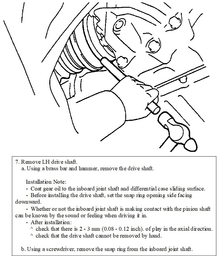

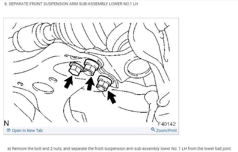

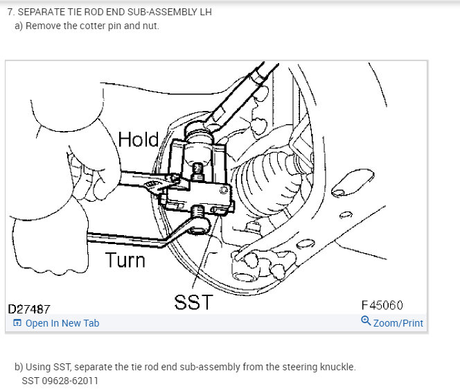

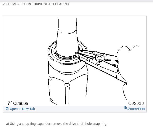

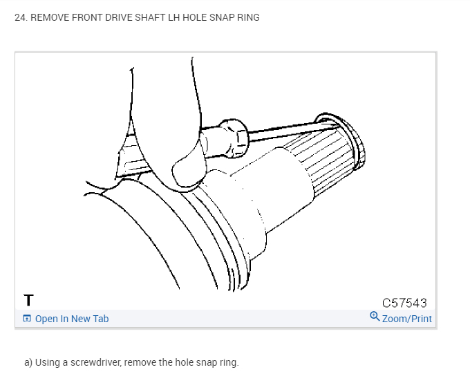

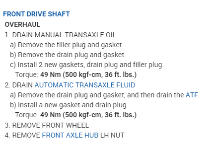

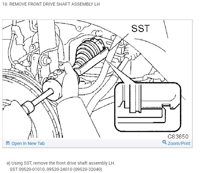

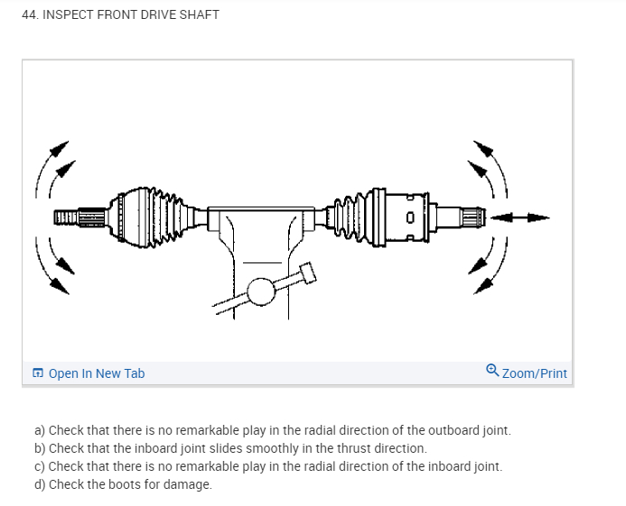

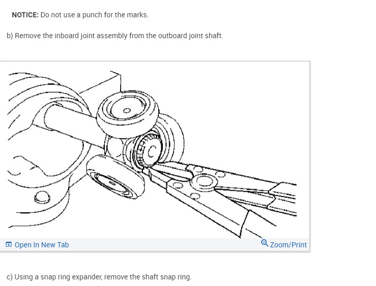

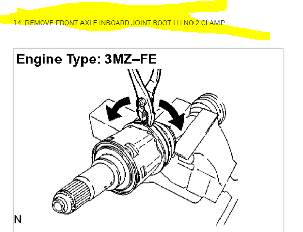

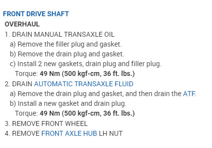

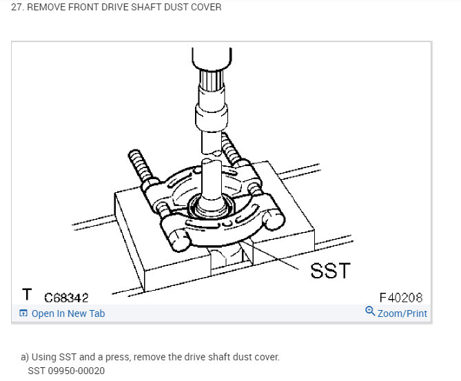

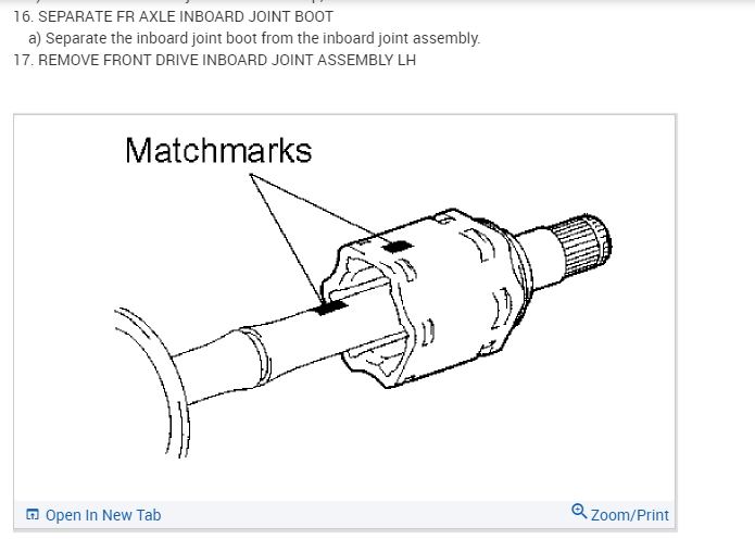

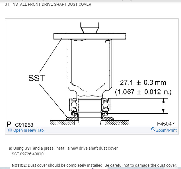

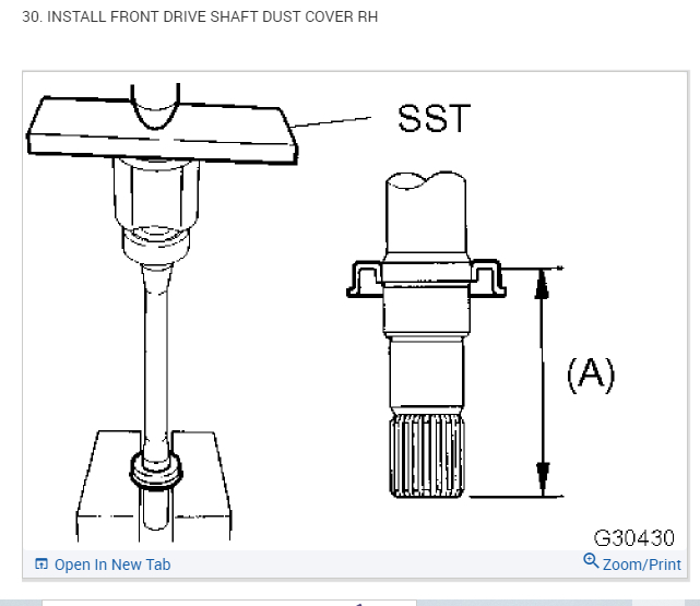

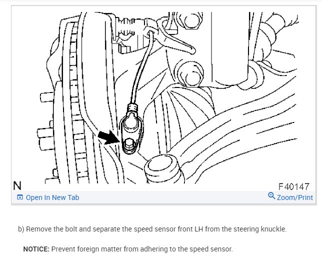

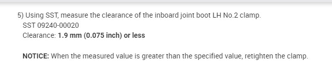

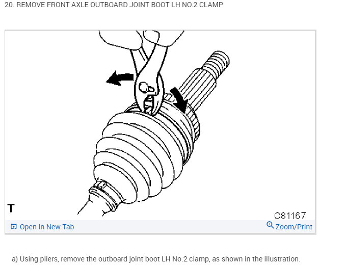

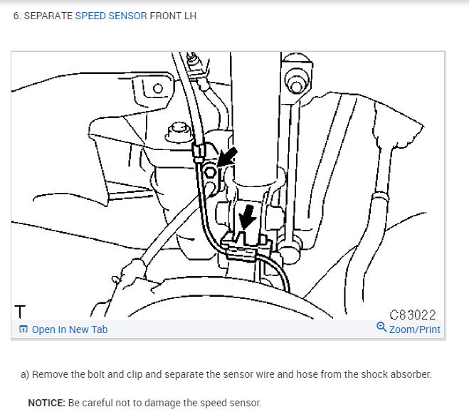

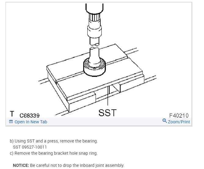

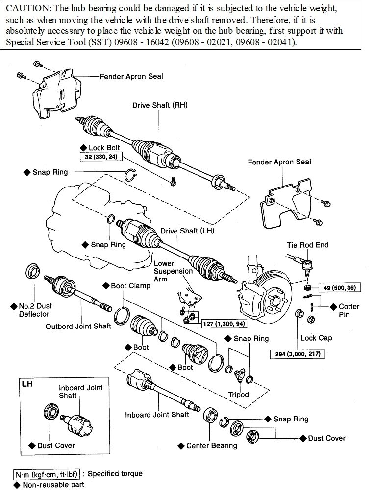

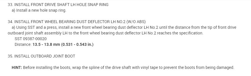

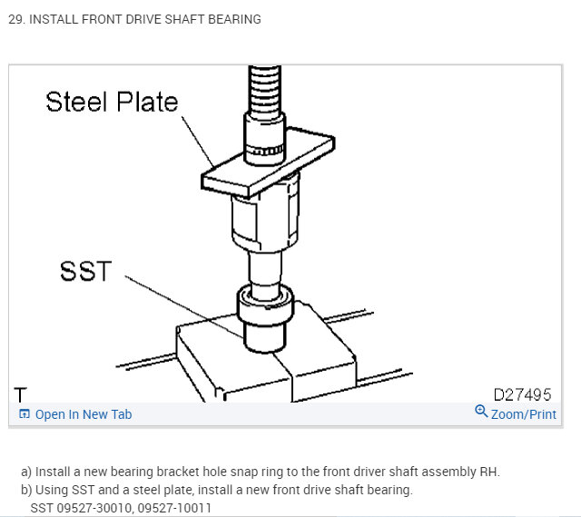

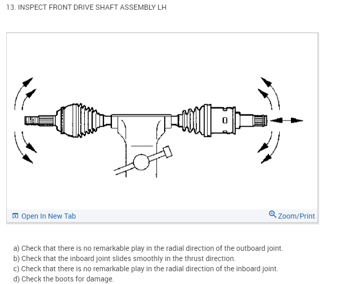

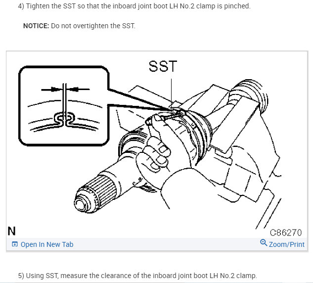

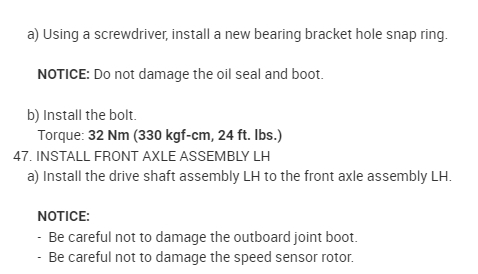

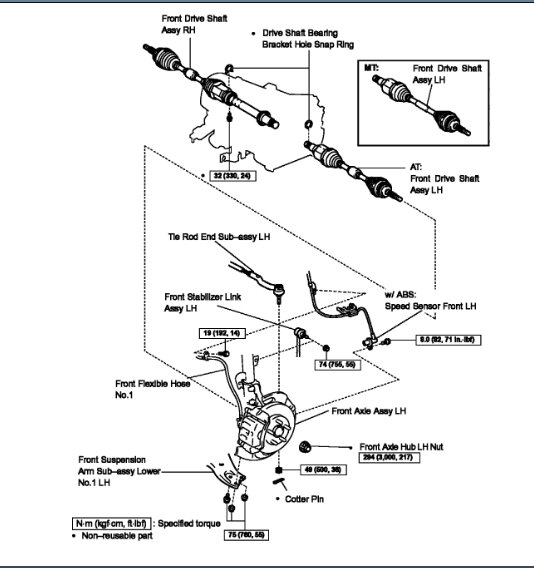

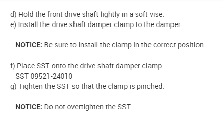

The steps to replace the half shafts are shown in the drawings below. Explain to your customer this will cost them less by requiring a real lot less labor time and give them a much higher quality repair. It will cost you about the same but make you a lot more profit with less mess and no special tools needed.

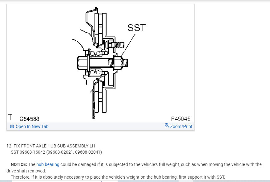

Note the warning at the top of the first page about placing no vehicle weight on the wheel bearing when the axle nut is loosened or removed. I've been preaching that to my students for years, but this is the first time I saw it in print.

Okay, to continue, if you aren't familiar with "flat rate", you'll want to use that in your business as it's fair to you and to your customers. One page of the huge book is shown in this first drawing I posted. Think of a barber who has a set fee for a haircut. Doesn't matter if it takes him five minutes or if you come in with ten year's growth. Cost is the same regardless of how long it takes. Flat rate lists every job or additional part of a job with two time allowances. The shorter one is for warranty or dealership work. Parts aren't rusted tight yet and they know exactly which tools to grab. The longer times are for the rest of us. When you write an estimate for someone, that flat rate time will be the same as used by another shop. The only variable should be your hourly labor rate. If you gain lots of experience, invest in expensive special tools, and invest in training, you'll get the job done faster, but you still charge the same amount. You can do more jobs per day. On the other hand, if you run into trouble, or have to study a service manual, or run for parts, the customer still pays the same amount. By working for yourself, you can be under less pressure to hurry up the job.
As for your cotter pin question, don't try to do this on a daily basis out of a car. They just don't come big enough to haul everything you might need. Use a full-size van or a small truck with a box high enough to stand up in. Put a workbench with a vise in there along with a small parts cabinet. If you don't need a new cotter pin on today's job, you surely will in the near future.
