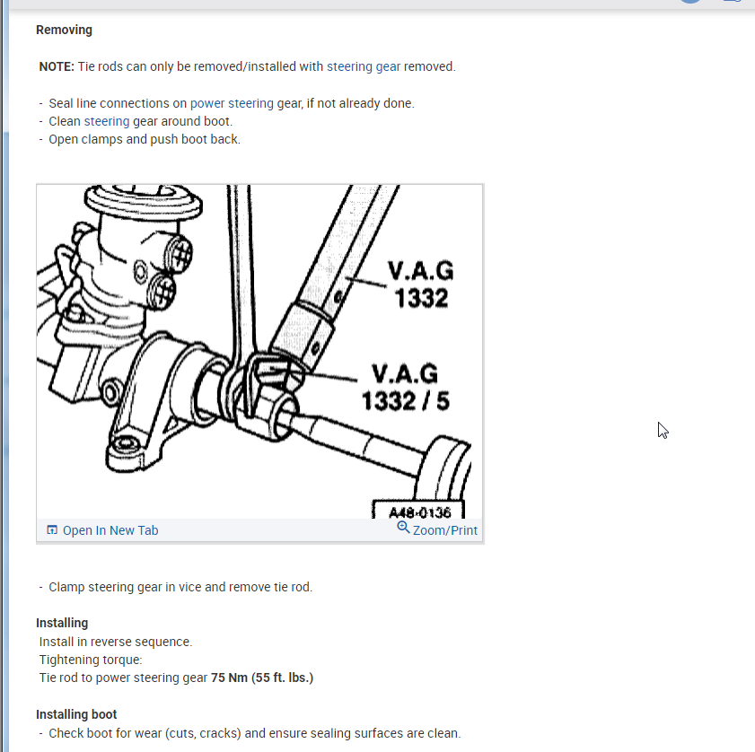

The easiest way to remove and reinstall my CV axles, lower ball joints, and inner and outer tie rods. All new parts. Also is there anyway to get the lower ball joints to release without having to remove the control arm?? Not replacing the control arm. If anyone could please help me... Thank you for your time.
