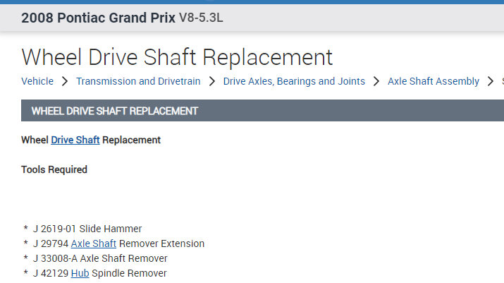

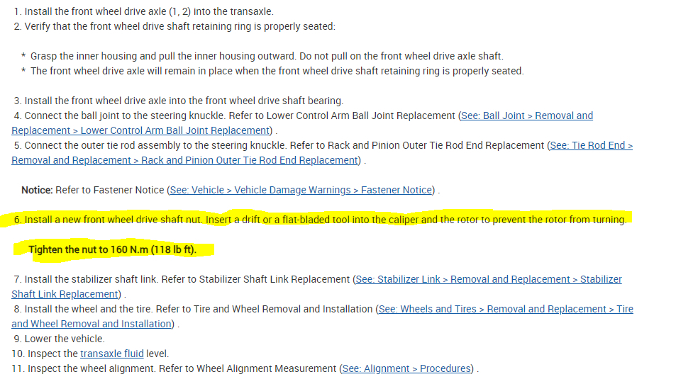

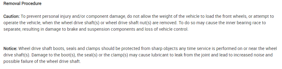

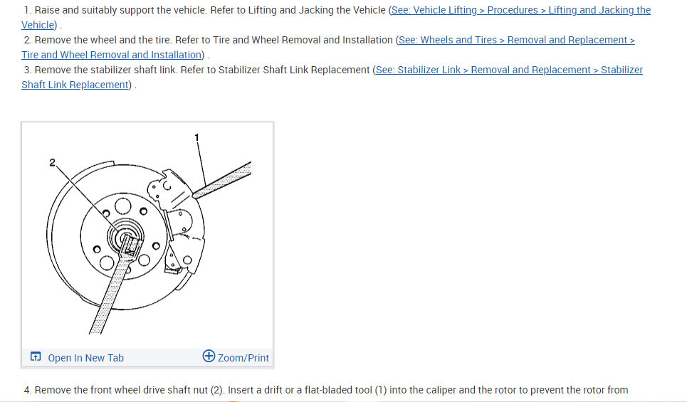

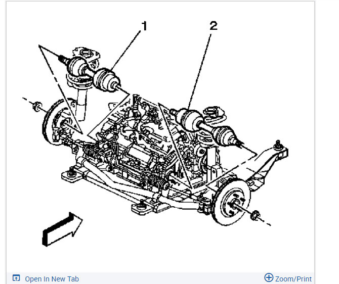

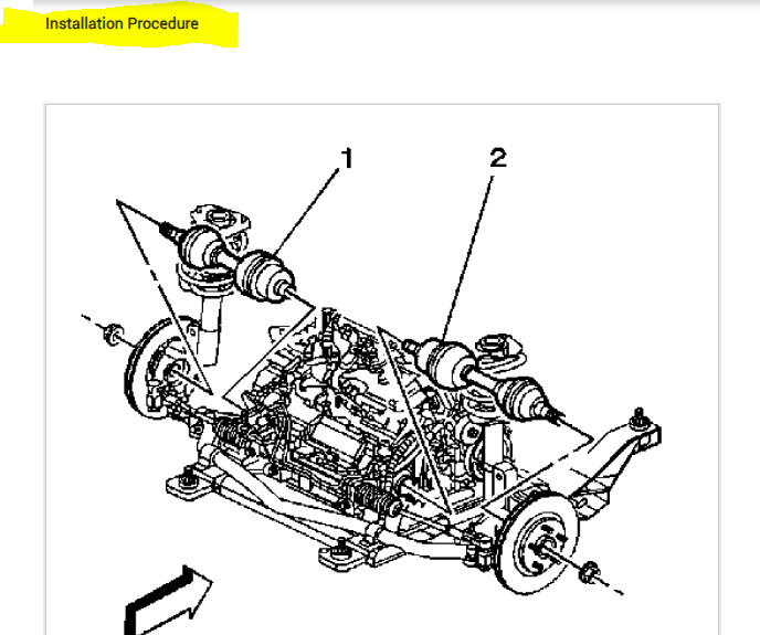

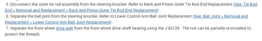

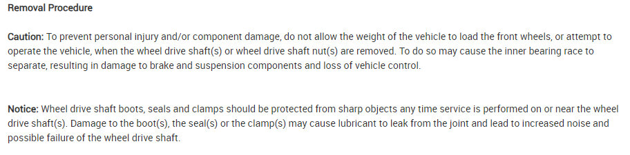

I attached the directions below for replacing a half shaft (CV Axles). There is one set of directions that is used for both sides.
Here is a link that explains in general how it's done. It actually will help because the factory directions are somewhat vague, and the link provides pics to help.
https://www.2carpros.com/articles/replace-cv-axle
Below are the directions specific to the vehicle. Take a look through them and let me know if you have questions. Also, make sure the axle nut is properly torqued when you put it back together. The torque specifications are included in the directions, and I highlighted them.
Take care and Happy Thanksgiving.
See pics below.
