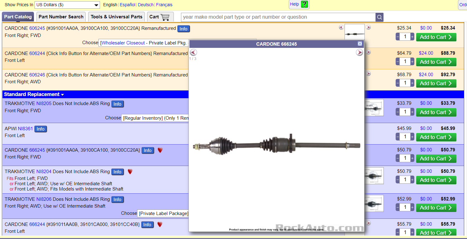

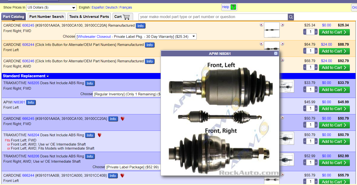

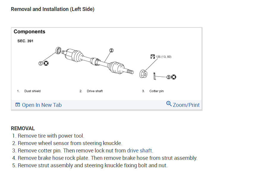

I have the vehicle listed above FWD and need to change the CV axles. I need to order the parts before I begin the work but I keep seeing different types of axles and something called an intermediate shaft. Do I have one of those? And some of the options I'm seeing say ABS ring not included. Do I need that? Would you be able to provide me with the list of things I need for the job along with PN's? Thanks.
Apr 18, 2021 at 10:52 PM

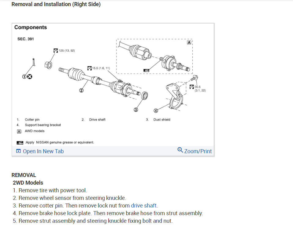

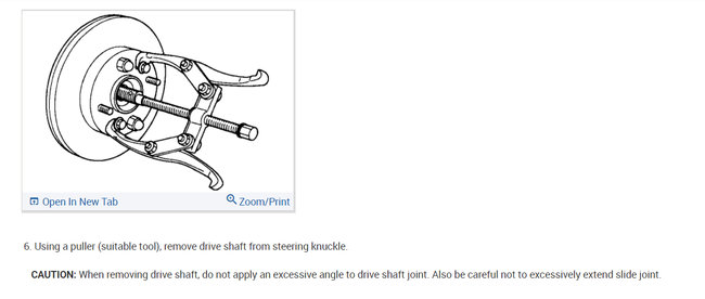

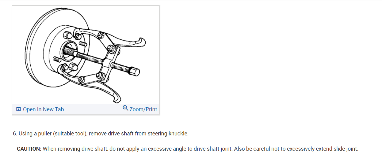

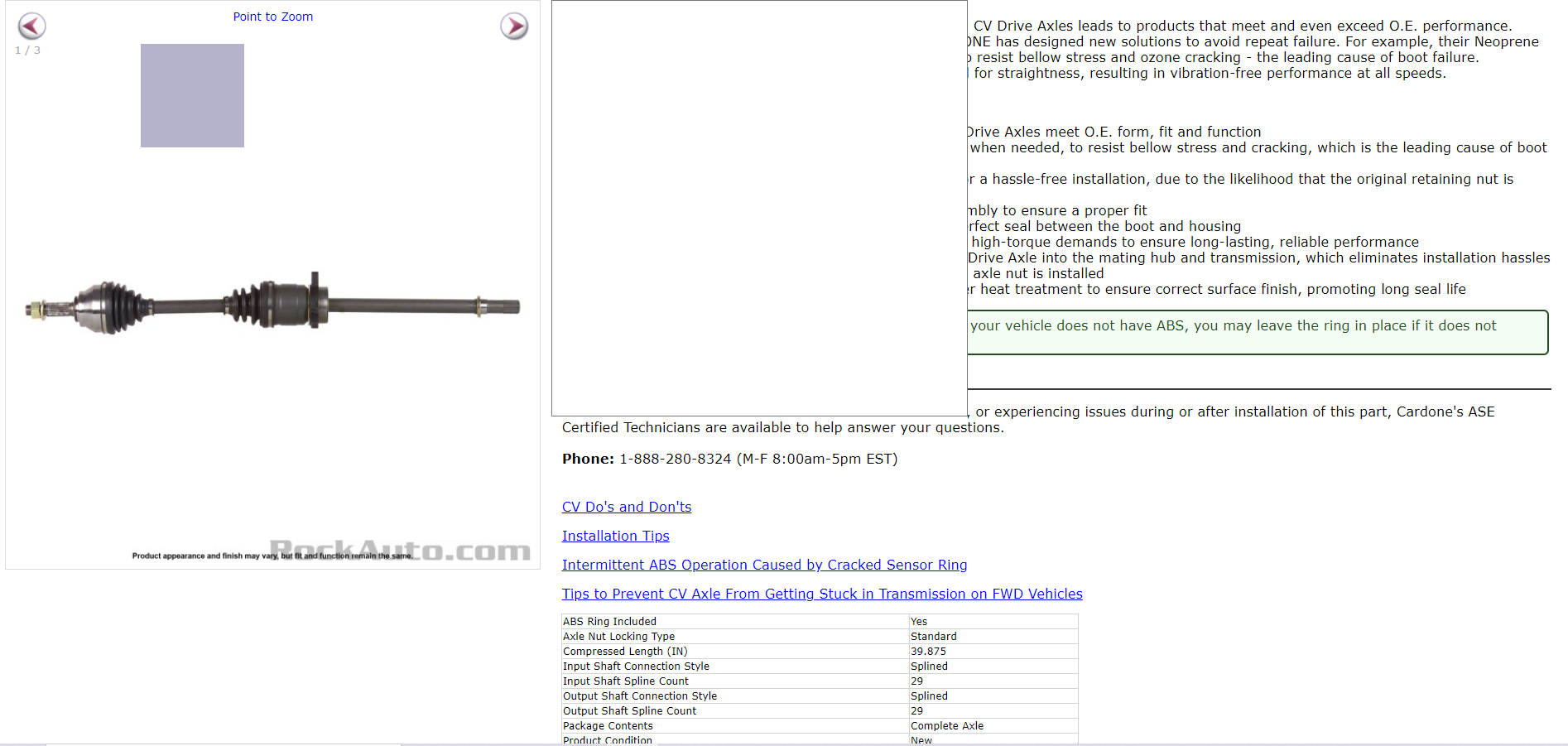

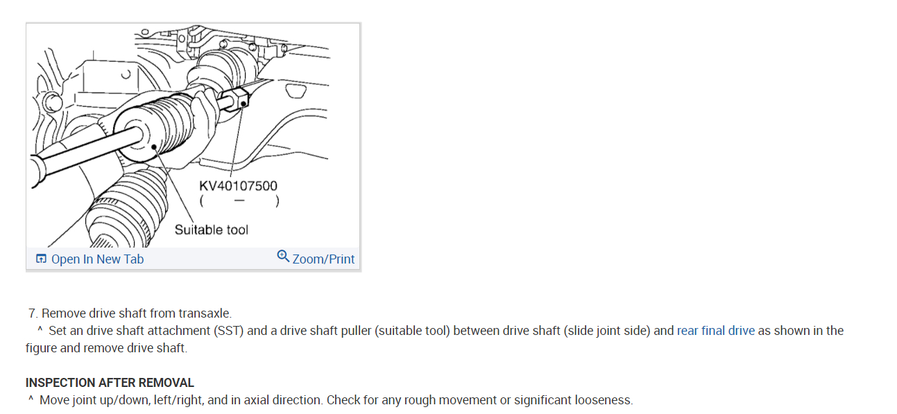

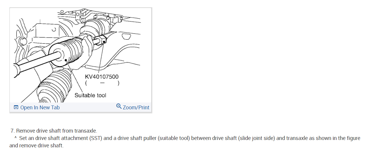

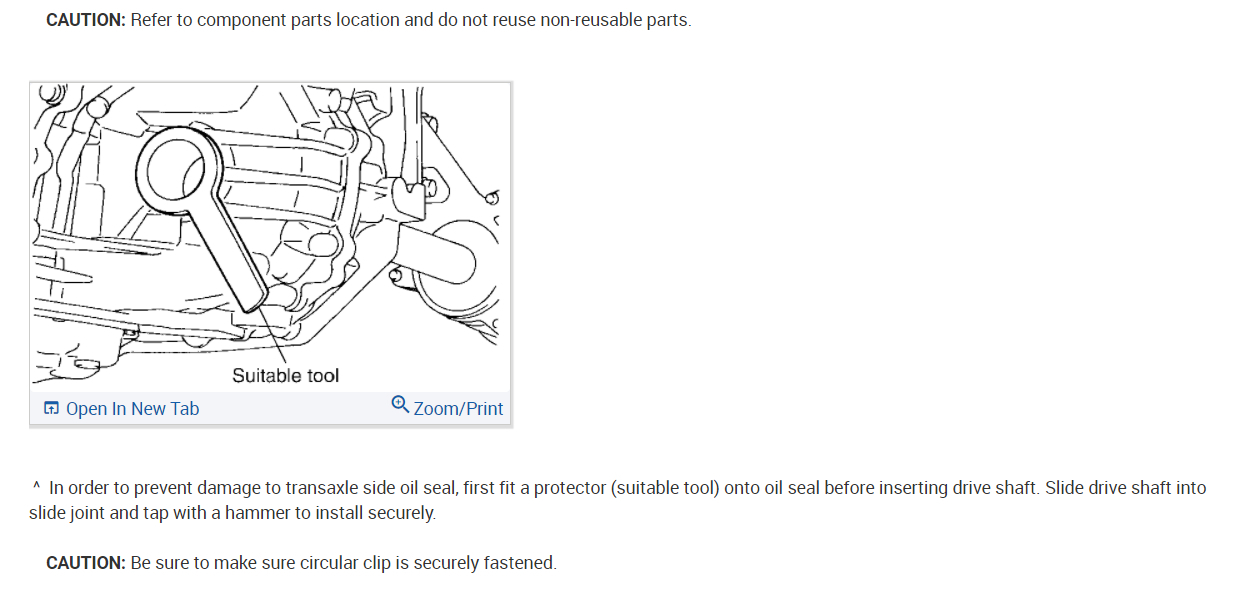

Good morning,

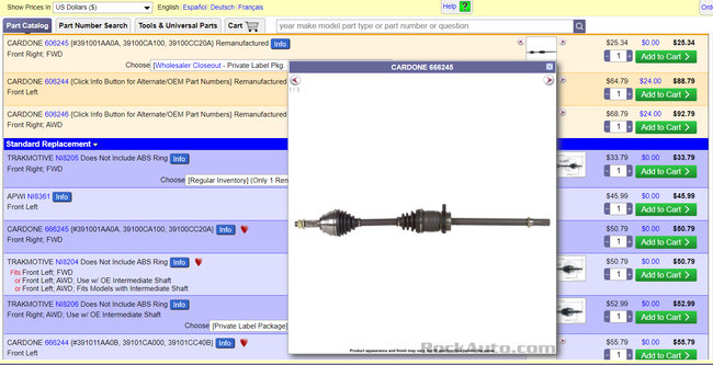

I attached the parts for you from Rock Auto for you for the repair.

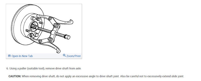

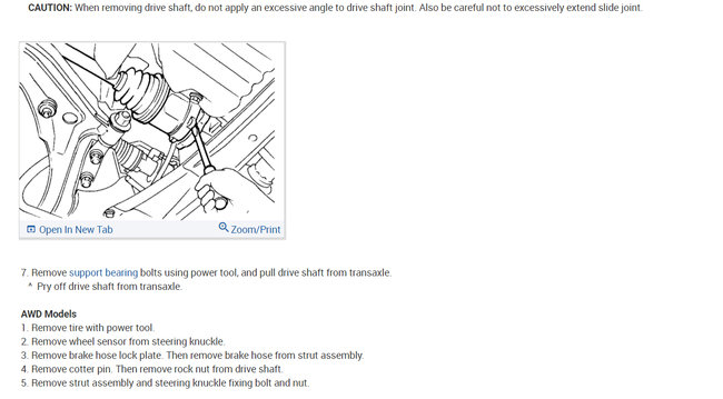

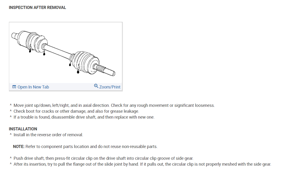

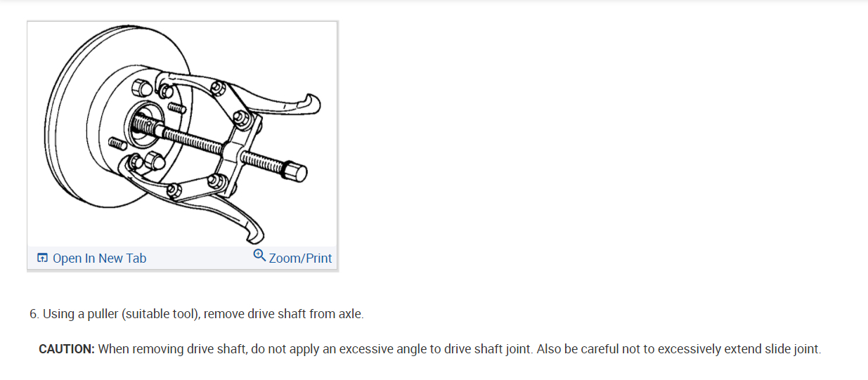

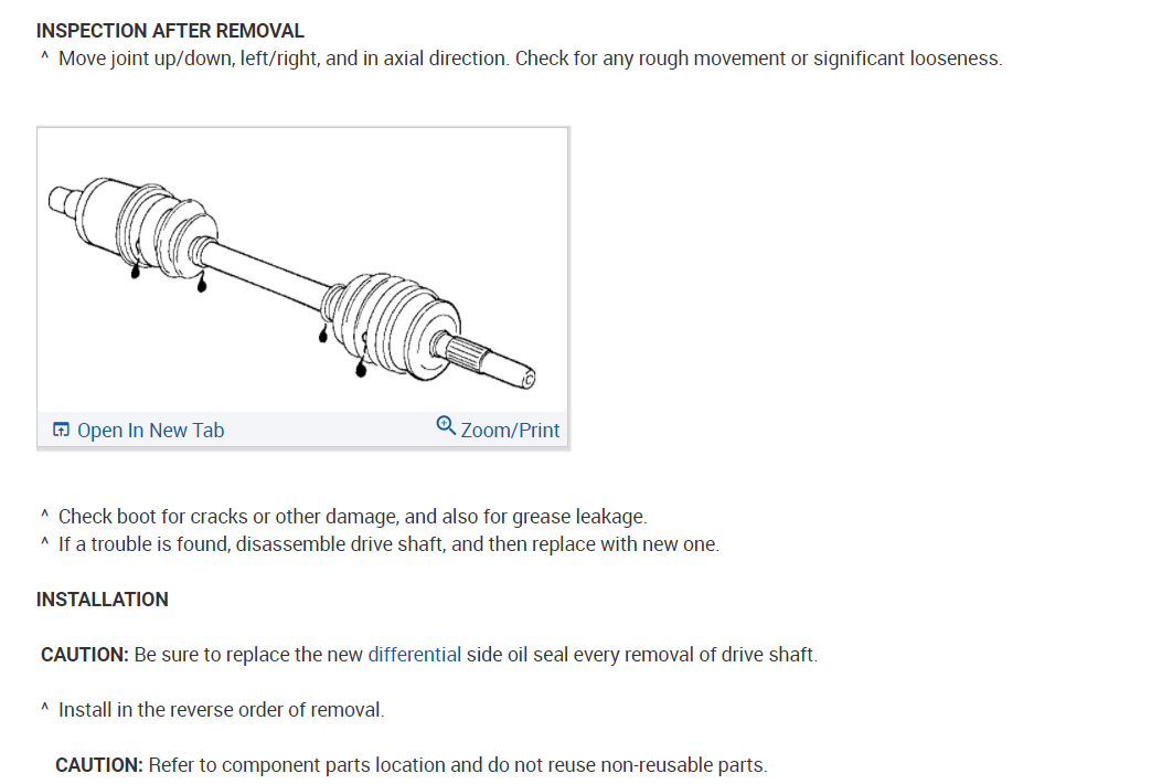

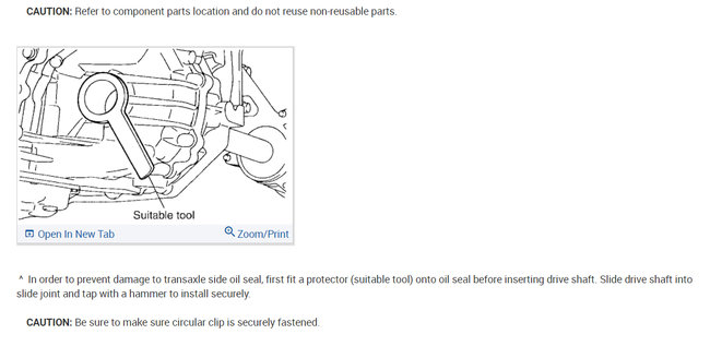

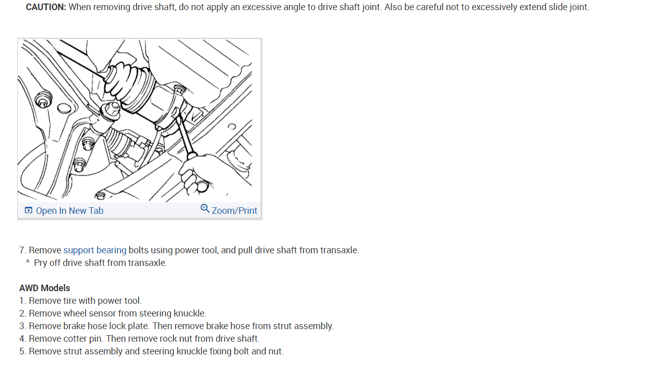

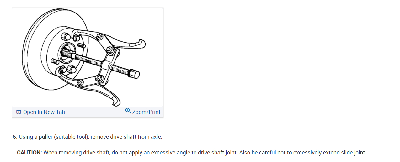

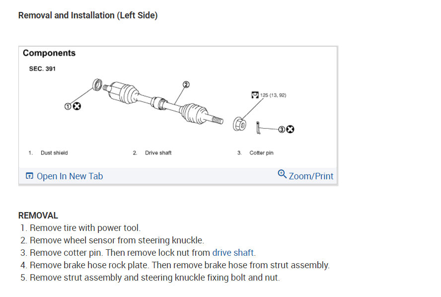

I also attached the procedure for the replacement as well.
https://www.2carpros.com/articles/replace-cv-axle
