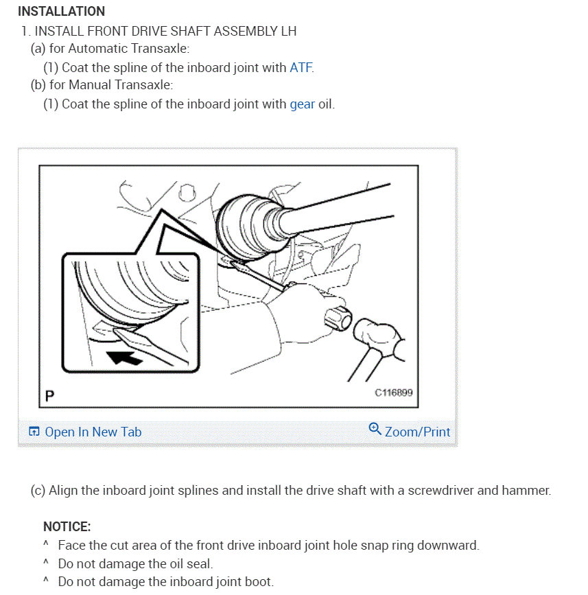

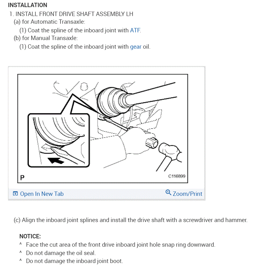

Replacing passenger side CV shaft. The shaft will not go in far enough to allow snapping to engage looking in the hole there seems to be a bar keeping the axle from going in. I have the snap opening facing down, still, it will not advance. I had no problems with the driver's side.
